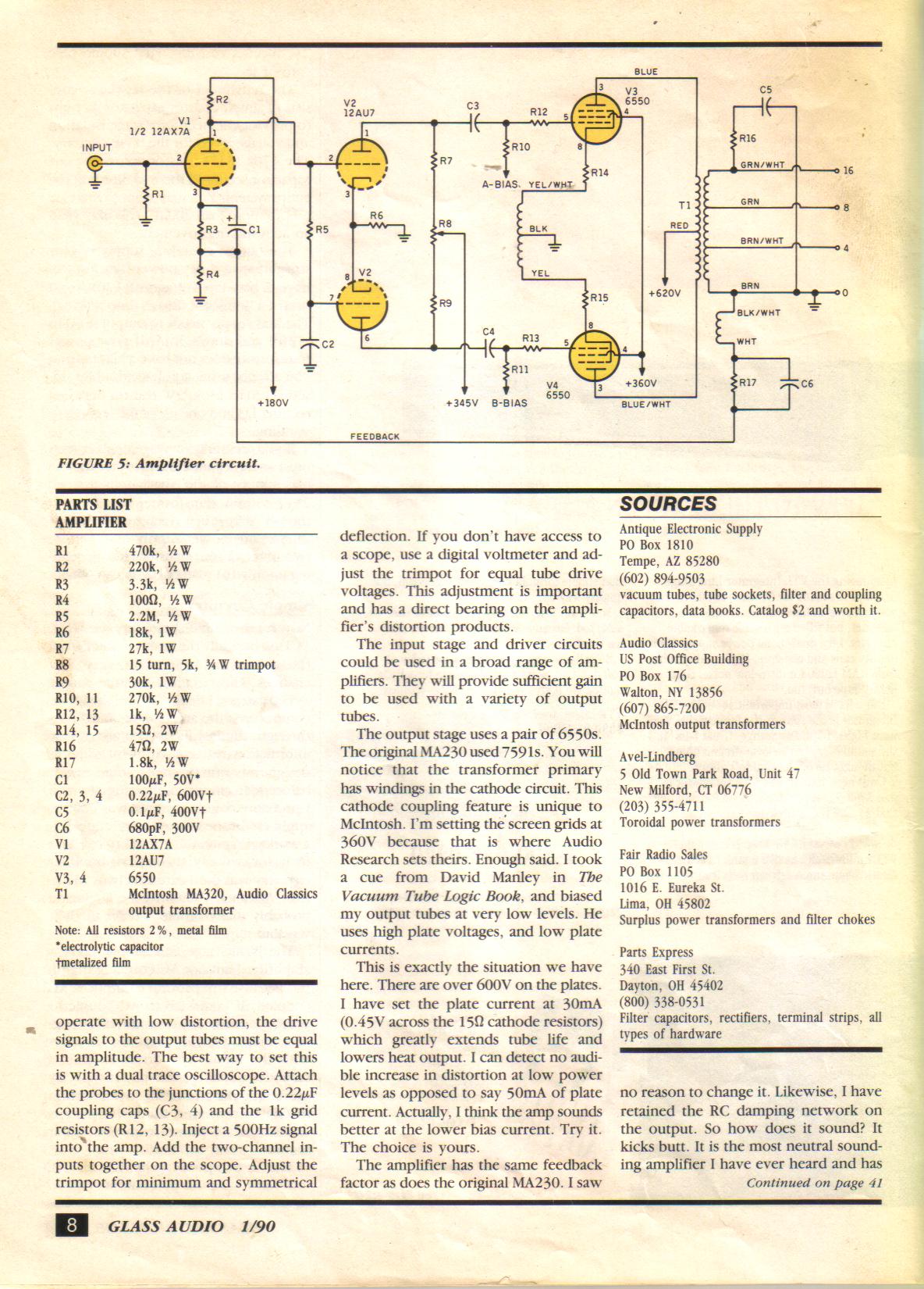

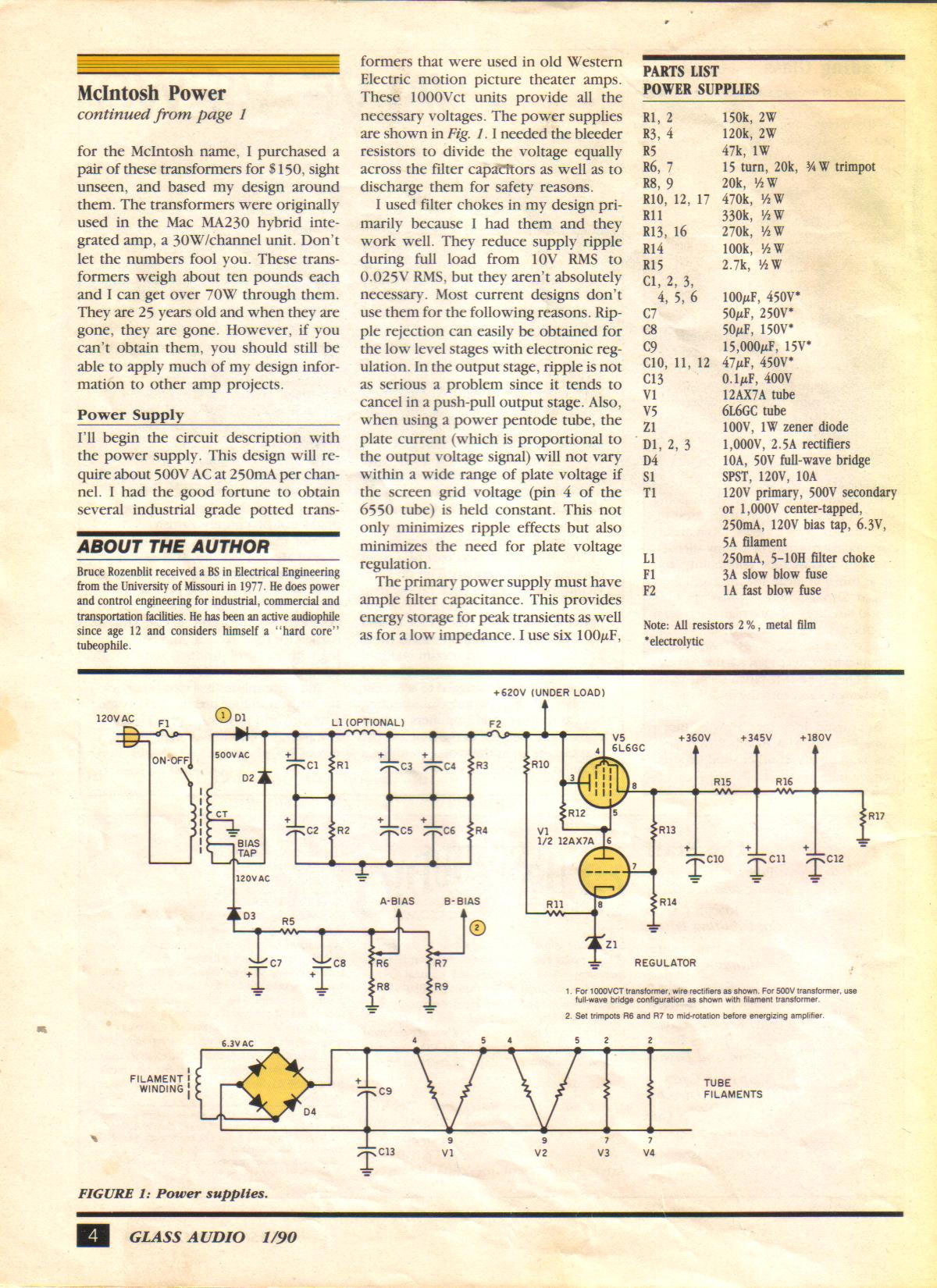

I have also built, using 6GM5 (7591 in nine pin socket), a unity coupled amp here using Vanderveen transformers
https://audiokarma.org/forums/index...rveen-vdv-1070-uc-output-transformers.937649/
In the thread above, you will note that McIntosh utilized a 4800 output impedance on the MC225. Dave Gillespie says this is a value he likes as well. That said, the MA230's would be a good match for 7591A tubes as McIntosh in fact did. I plan to build a 6L6GC amp with them. In my estimation, the transformer cores are good for 60 watts.
Attached is an article using 6550 tubes with these transformers for a touted 70 watts. Be careful. It appears the author kept the original MA230 schematic intact including 270k grid leak resistors. 6550's should have more like 47k.

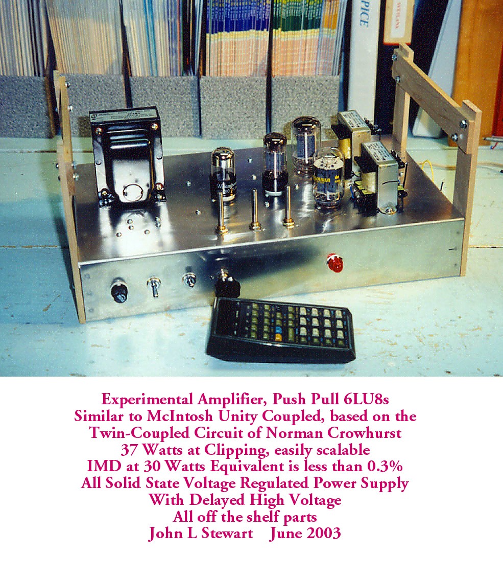

The 'Poor Man's' McIntosh. I built two versions about 20 yrs ago. This one uses a PP pair of 6LU8s,
The included triodes are used as CFs to drive the output pentodes, thus avoiding blocking.
The PS is all SS with a built in startup ramp circuit. The two-stage Diff Amp can be switched between
Crowhursts version & full differential. Its been here on DIY several times & published in Glass Audio.
Showing amp section only so we can focus on just the amp circuit. I have thought of acquiring a unit but adding a bypass switch so I can use it as a pure stereo tube amp. Obviously the input grids need grid leak resistors between 100K to 1M or you can keep the volume control and bypass the solid state line stage.
