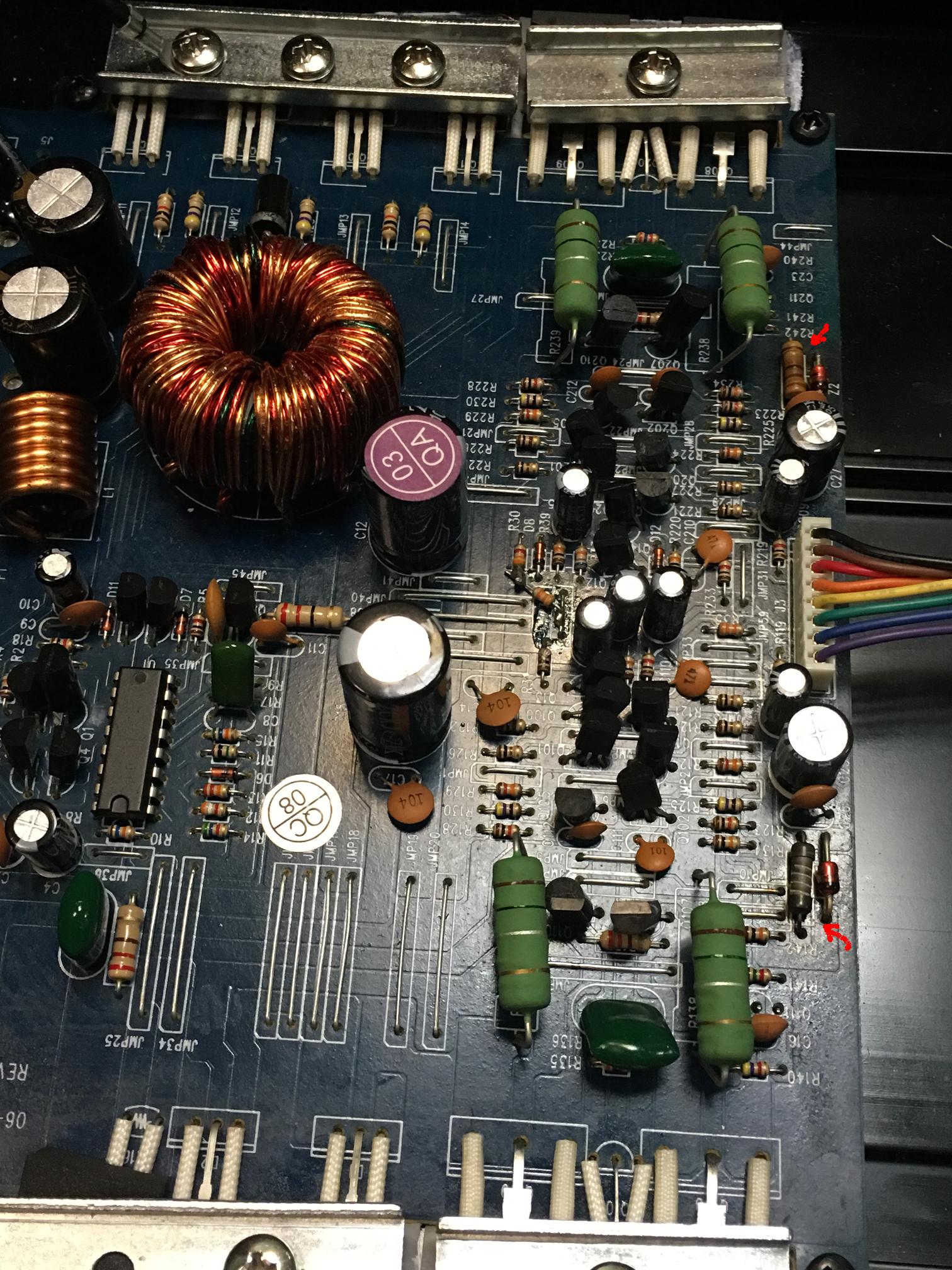

S S Merlington Member Joined 2012 2016-01-29 8:25 am #1 2016-01-29 8:25 am #1 Anyone know the value of these resistors? Attachments MD.JPG 526.5 KB · Views: 65 ultra Member Joined 2005 2016-01-29 9:09 am #2 2016-01-29 9:09 am #2 These are the resistors that along with the 15V zener diodes drop the rail voltage of the amp down to 15 for the preamp. They are in the low ohmic area. You can lift one leg and measure. From what i can see, theycould be 100 ohm. Status Not open for further replies.
