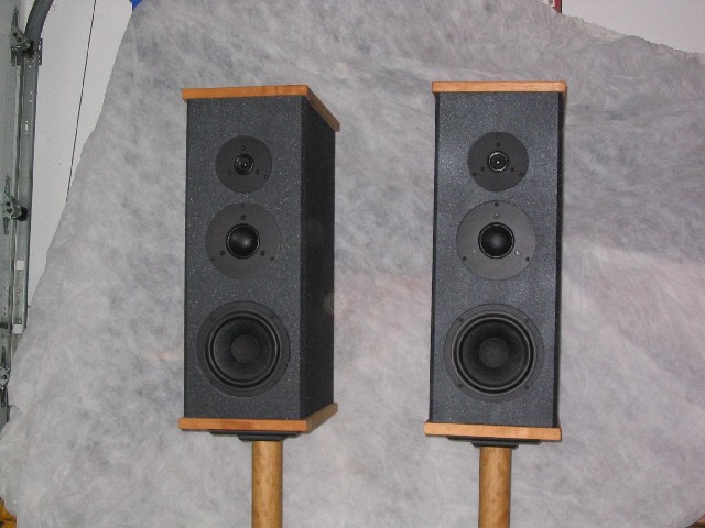

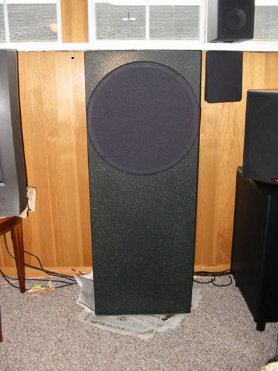

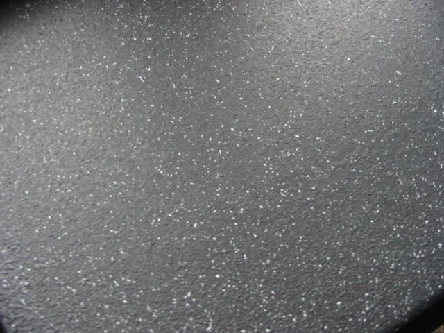

Cal Weldon said:If you like a texture coat, This is the "Stone Creations", black granite. Each can did 15 square feet or one can per cabinet in this case.

Paradise_Ice said:its a very nice but it takes awhile to dry out fully.
Ya, no sheep dip. Took mine close to a week to become tack free. Warm room too.
There is a paint called Hammerite, i dont know if this is the type of paint or the company that sells it, but its an extremly tough and glossy paint, very Toxic too. [/B]
That's another option but has a much different appearance. Seems to be quite durable, very hard finish as you mentioned, more so than the stone creations which is a lot like truck bed liner.
Cal
