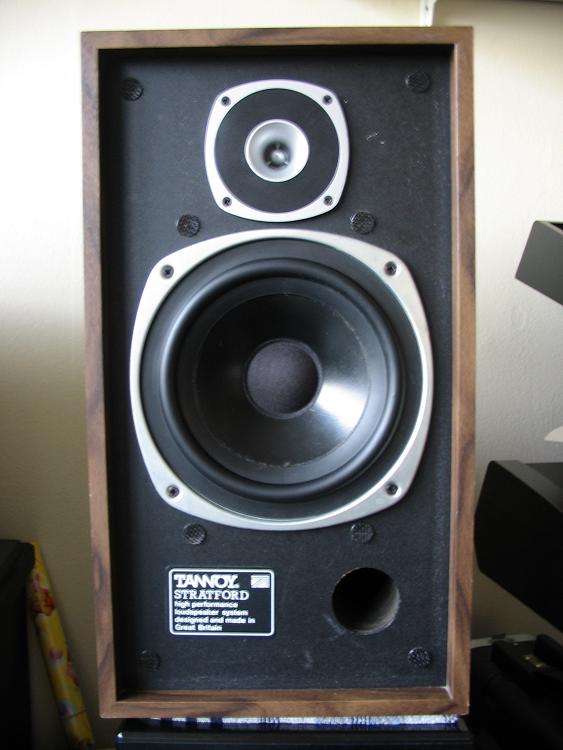

I'm currently working on a design for a small "mini-monitor" - about 36 litres, fitted with original components and filter from the Tannoy Stratford speaker. The woofer is a 6.75" driver and the tweeter is a 0.5" horn. It is a ported design, with the port firing forwards. The original Stratford is tuned to 50Hz, in my room there is a conciderable boost around that frequency. Simulations show a similar bump at aroud 45 Hz. My goal in designing a new cabinet is to tame that bump and to enlarge the bass response downwards. Maybe tune to somewhere close to 36 Hz. That means deep bass, so I would need to use MDF.
The tweeter is a very lovely horn - fast, transparent. To keep it's quality, I'd have to use plywood.
Would it be possible to make the cabinet out of 22mm MDF and the baffle out of 22mm + 8mm Plywood screwed and glued together? That way I have the qualities of both Plywood and MDF. I want to heavily dampen the inside by glueing bitumen (carpet tiles) on all inner walls, and stuffing it with fiberglass. Also, I've seen monitors with felt fitted on the baffle to minimize diffraction. I'm not sure if I'll use that, too. I plan to brace the cabinet internally.
Any ideas? Any input is welcome. Thanks!
I have used lead to line cabinets, tacking it in places with glue (not just any glue). The lead really goes to work on resonances. It has done well to tame those I couldn't fix with bracing...
