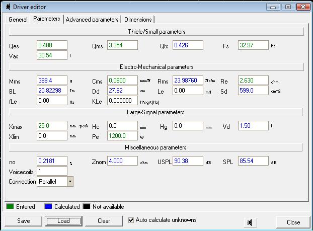

* f(s)= 32.97 Hz
* R(e)= 2.63 Ohms
* Z(max)= 20.68 Ohms
* Q(ms)= 3.354
* Q(es)= 0.488
* Q(ts)= 0.426
* V(as)= 30.540 liters (1.079 cubic feet)
* L(e)= 2.80 mH
* n(0)= 0.21 %
* SPL= 85.40 1W/1m
* M(ms)= 402.80 grams
* C(ms)= 0.06 mm/N
* BL= 21.19
Dual 1.4 ohm copper coil (in series). Built this up just for the sake of using some unique softparts I had laying around. Motor is Shocker Signature Series, originally made by TC Sounds. Same slug stack as 4hp but with very tigt gap, 3" coil, and copper shorting ring. They do very well for SPL applications in car audio scene, but this seems to spec pretty well with the soft suspension and much higher MMS than I'd usually use on these.
I have it listed FS on a couple car audio forums, but nobody is biting (I have a lot of money into parts and shipping will be a big hit). I figure I could scoop up a nice plate amp and put it to other use in the meantime.
Any HT gurus here think this would do well for HT applications?

Hi hispls,
When entering you T/S parameters into Hornresp, using an Sd around 500 cm^2 the Hornresp calculated Cms is 9.30E-05 m/newton, the Mmd=244.5 gm, and so on... In other words, there may be a problem with the T/S parameters. From what I can tell with the current data a tappe horn would work nicely with this driver (Vnet=250-300L), and provide high SPls; but that's without correct T/S parameters. For a small box a sealed box with low end eq should work.
Bart's simulation does not show which T/S parameters he entered into WinISD to make it accept the driver.

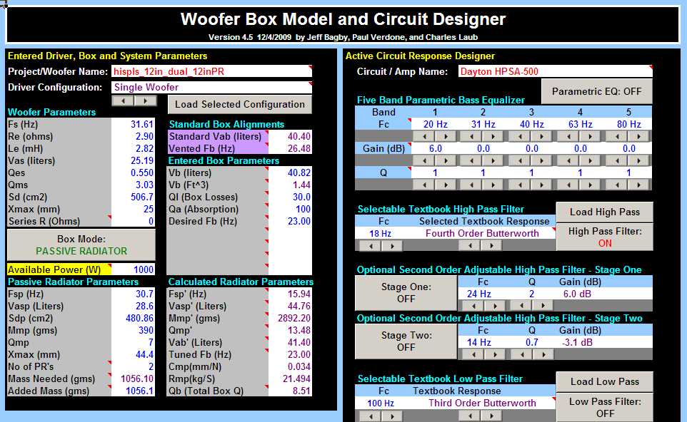

As to passive radiators, I like to use Jeff Bagby's software: Loudspeaker Design Software

Possibly I used the wrong piston diameter in WT3 when I pulled them initially. Did another run just now using 10" dia as piston area with these results:
f(s)= 31.63 Hz
* R(e)= 2.90 Ohms
* Z(max)= 18.81 Ohms
* Q(ms)= 3.035
* Q(es)= 0.554
* Q(ts)= 0.469
* V(as)= 25.190 liters (0.889 cubic feet)
* L(e)= 2.82 mH
* n(0)= 0.14 %
* SPL= 83.47 1W/1m
* M(ms)= 362.50 grams
* C(ms)= 0.07 mm/N
* BL= 19.43
Slight varience from stretching out the suspension a bit with some play and probably a little just in innacuracy of WT3.

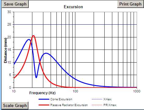

The best thing with WinISD is to enter particular parameters in a particular order, and let WinISD calculate the ones its wants to as it goes. WinISD is mathematically very specific (using exact maths rather than real world measurements), but entering parameters that way usually ends up in TSP's very close to the stated specs (close enough to model accurately).
I entered the parameters stated, let the software calculate SD, and used 1000 watts power and 25mm of one way xmax. Following the -6EBS design, I got 60 litres with a 15 hz tune and 1000 watts to work pretty well. The driver would remain within xmax down to 12hz (so you should get away without using a HPF) at 1000 watts, and the system would deliver about 110db in room max to about 14hz.
As for pr's, if you can choose an off the shelf pr with known parameters (Acoustic Elegance do some for example), we can model a cab. The cabs remarkably small anyway (for a -6 EBS design), so ported is probably the way to go for an LFE specific sub along the lines of an SVS Ported Ultra series type of subwoofer.
Just as an FYI, I have attached a copy of the TSPs I used. Those in blue are calculated by WinISD, and as they fall pretty close to those stated, I'd be willing to trust the sim personally.
I expect truth lies somewhere between measured and predicted TSP's. All in all, I think any varience will not audibly impact performance if it's < 5%

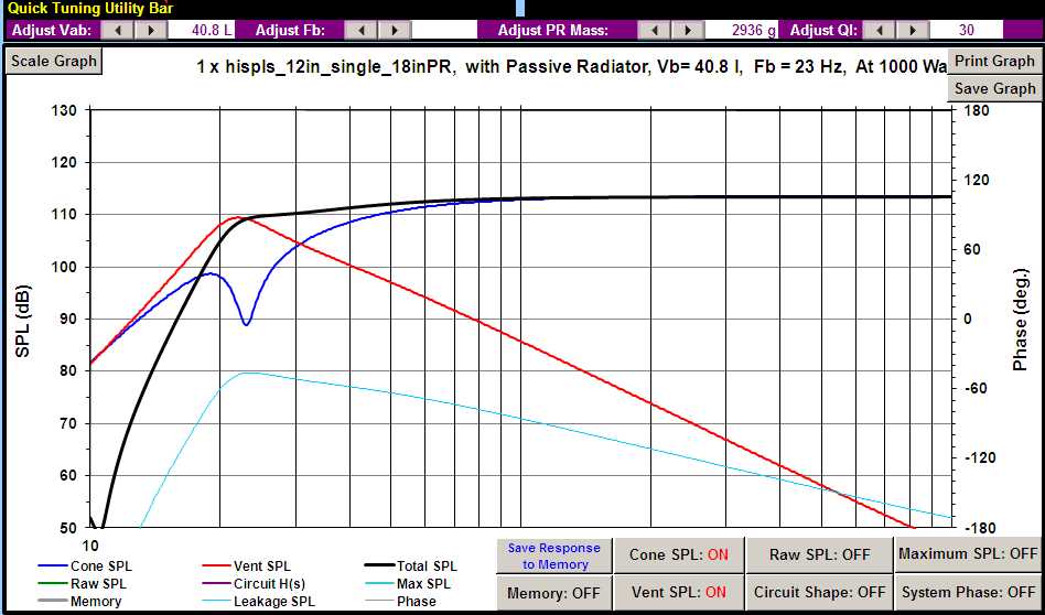

I tried the numbers in Bagby's program, and used two of the TC Sounds VMP 12" as a starting point (that'll give you something to look at): TC Sounds VMP 12" Passive Radiator 293-680
The old rule of thumb PR_area = 2xSd seems to work in this case (see also: Post #10 by Moonfly). Also, I like the way Jeff Bagby integrated electronic filters into his simulation. A PR box will need a low-cut filter.
The T/S parameters in Post #6 work better in Hornresp, so that's what I'll be using. Your new Sd is about the same as the TC Sounds Epic 12 (506cm^2).

This is definitely very similar dimensions to the TC 12" aluminum cone. Quite different surround than what's commonly on their drivers. More similar to the cone on the Lightning Storm woofers (a 3hp variant made for Rockford Fosgate)
SO in your example if I made an 18" passive radiator with mass of 1600g, how stiff or soft should I try to make the suspension? Is this important? My gut tells me soft, but I haven't handled one of the production versions.

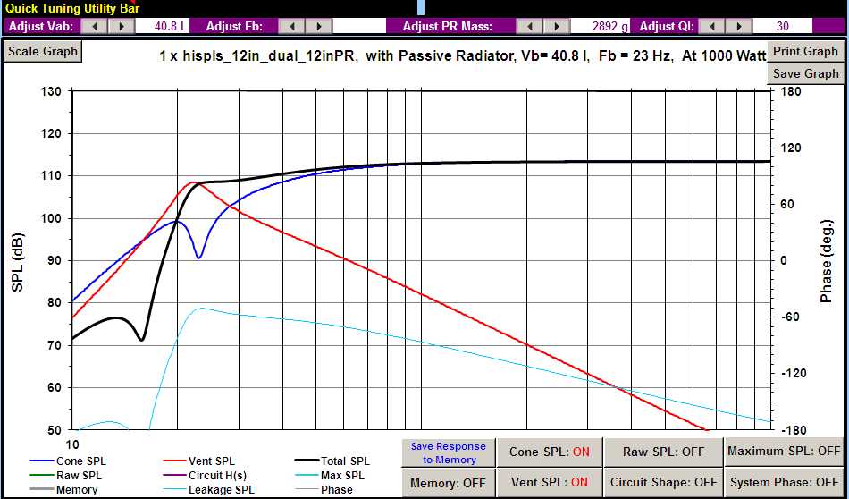

When you increase the surface of the PR you need to increase the tuning mass. As to the suspension, you need a self resonance in the PR (Fsp[Hz]) that is below the usage range of the enclosure. Usually the high mass involved with large PRs takes care of that. On the other hand the suspension has to be strong enough to support the high moving mass.
I started with the TC Sounds 18" PR in Bagby's software this time, it asks for a PR mass of 2936g. Again, note the low-cut filter.

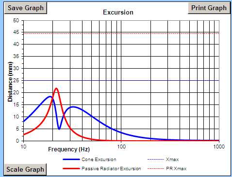

Wow 3KG is a lot of mass. Perhaps a stiffer suspension is in order to keep that under control (will that hurt system Q?)

Variable tune is nice in theory, I'm not really sure what I can come up with for masses that will be easy to pop on and off. Lead disks with a hole in the center would be best as I could just add a bolt to the center of my cone (with MDF plug in there) and fix on with wing nuts. I'm leaning towards glueing on say 2KG of mass or some number that I know I'll not need less of, then having the option to add or remove some smaller pieces....need to hunt around for likely looking objects to add.
Vertical PR is a good thought. I do have some very stiff spider packs that I will probably never use, but I think that would shoot me in the foot for efficiency (why I don't use them on active drivers)
If you keep the PR vertical you don't have to get crazy with suspension stiffness.
Thinking it won't be a bad idea actually. Will keep a smaller footprint that way.
I was also wondering if I'm tuning so low is subsonic filter really needed? Really how much sub 18hz material am I likely to run into?
Also consider the odds of me having more than a few hundred watts on this in the house any time soon are very slim
