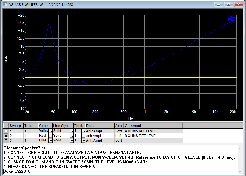

To measure the speaker Z, I use my Audio Precision. It is set as a 600 ohm (Current Source) and I use two fixed resistors to scale the graph. See the graph.
Before the AP I used the WaveTek 185 generator in sweep mode and a scope & plotter to do the same tests.
Duke
Duke

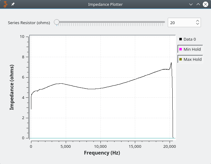

I put together a simple program some time back to look at speaker impedances.
You can read the story here.
The software is here.
You'll need Python 3 and GNU Radio.
This is a plot of the impedance of a car stereo speaker:
The speaker itself claims to be an 8 ohm speaker. It has a bass/midrange speaker and a tweeter with a two-way crossover.
