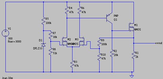

ok, i worked something out for you that might work.... you will need a transistor rated at the input voltage x 1.5 (safety factor) as well as mosfets with the same voltage rating. the circuit as-is puts out 71V (not bad for just taking a whack at it?). the actual regulator output voltage is adjusted by the ratio of R7 and R8. the zener is the primaty reference voltage, and R7 and R8 allow you to adjust the reference at the noninverting input. the output is compared to the reference and the feedback can be adjusted with the R9/R10 ratio at the inverting input. if this looks similar to an op amp, you're right...... it's a very large single supply op amp. this isjust a basic draft, but you should get the idea. any changes at the inverting input are corrected just like with an op amp
oops..... forgot to get the schematic.......
still getting used to linux......
i used LTSpice's default transistors because i don't have any 300V bipolars in the library.... if you're using a 110V source voltage, you can go with 150 or 160V devices.
actually as shown, 2k ohms is where the regulator just begins to lose control. at 3k the voltage is 72V. at 2k it's 71.4V. after a bit of checking it's actually because of the 100ma limitation i put on the circuit by using Rser=3000 in the voltage source
Thanks very much UncleJed for taking the time to develop a reg schematic for my project. Much appreciated. Can I request some add'l assistance in spec'ing suitable parts for the:

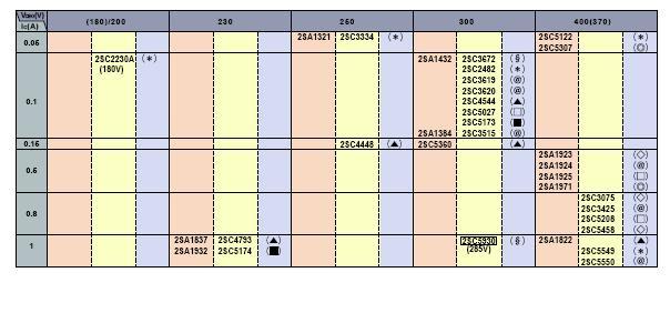

- PNP (I have BC560 on hand, but don't think that's adequate)

I have N-channel irfi820s on hand, will those work for the NMOS? They are rated 500V

led?
what's the voltage feeding the regulator? i was having trouble finding a suitable pnp, but a pnp video output transistor for a TV or computer monitor might do the job.... i found a page of video output transistors from a toshiba data book... try some of the 2SA series on this page there are 300 and 400V types listed
