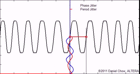

Phase jitter: Phase jitter is the term used for looking at the phase fluctuations themselves, i.e. the deviations in the position of the phase against what would be expected from a pure signal at any given time. Accordingly phase jitter is measured in radians.
https://www.google.com/search?q=pha...0i390i650l4.5838j0j1&sourceid=chrome&ie=UTF-8
Phase jitter versus period jitter animation attached (hint: open attachment in new browser tab).
