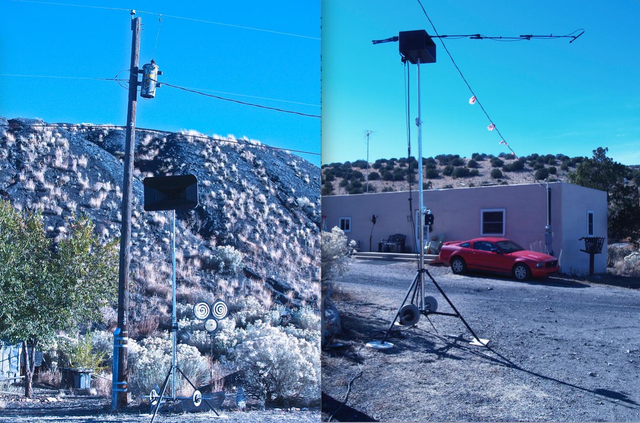

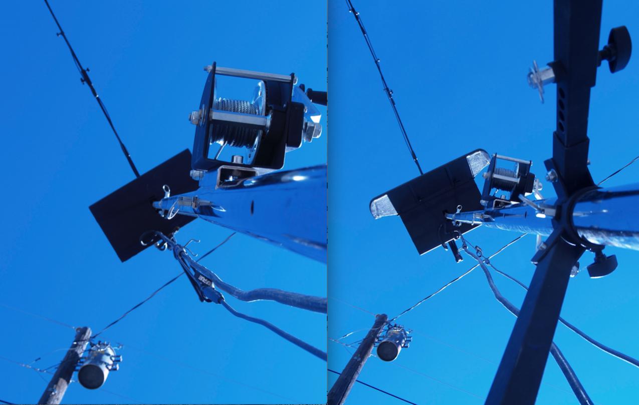

Test # 1) Speaker on platform ~ 8.5 feet off the ground; window to about 13ms with accuracy down to approximately 100hz.
Speaker flush with front of platform (picture was taken before I began tests). Mic at 1m; signal 2.83v. Note: I don't care that the mic stand can cause a reflection for this measurement; this is just a test of a test.
Pros: This method has the benefit of having very high resolution as you go above 200hz.
Cons: being subject to the elements (cold, wind, rain; external noise not really an issue in my area) and having to hoist a speaker up 8.5 feet in the air and risk throwing out my shoulder should I ever test a floorstanding speaker.
Here's a photo of the setup:

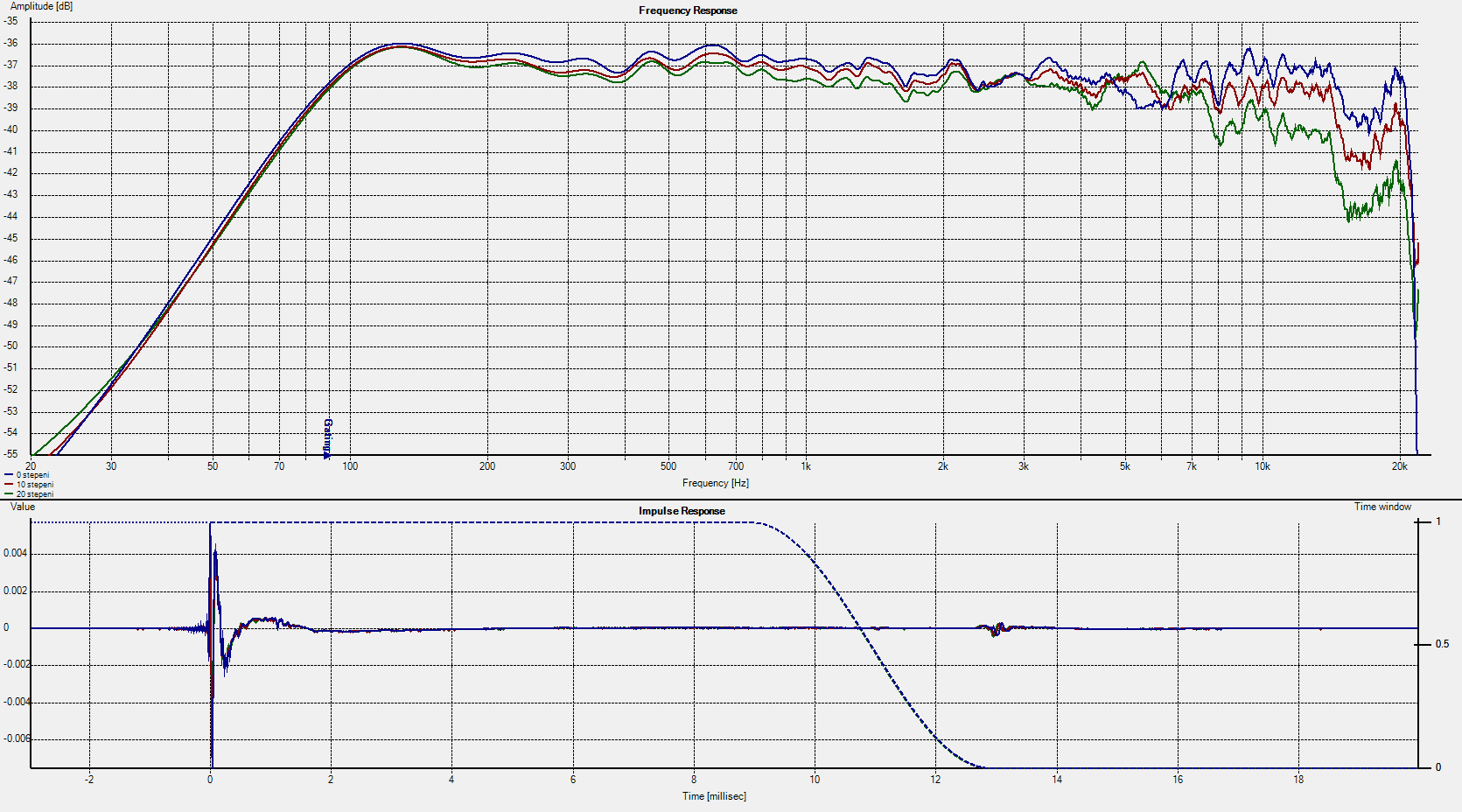

Here's the result compared to Amir's. You can see some decent differences namely above 1khz. Notably the 1-2khz region.
Now, I wouldn't say that test was 'final'; it was just a "proof of concept" and I suspect that I could probably get better accuracy with an additional test and higher # samples that feed the average. Given the hassle of setting the speaker up high I thought I would try a few other methods out to see how they compare.

Test # 2) Measurement on a 5 foot stand in my garage; gating was about 4 ms.
Same stand used below but inside my garage with a ceiling height of about 10 feet. The speaker was positioned about 5 feet above the ground with the tweeter at about 10" off the platform. Mic at 1m; signal 2.83v.
Pros: Don't have to worry about the elements nor do I have to hoist the speaker 8 feet in the air.
Cons: Poor resolution below 1khz. I don't think I would even bother posting this data. For a single drive unit it's fine. But, speaking from experience, I need good resolution to determine where to merge LF response data of ported loudspeakers.
I didn't take a picture of this setup.
Here's the result compared to Amir's:
Test # 3) Outdoors on stand. Same stand as before. Window ~ 7ms.
Pro: Better resolution than garage measurement since ceiling reflection isn't there and thus gating is extended an additional 3ms or so. Don't have to hoist the speaker up 8 feet in the air.
Con: Outoors; weather/environment. Still not as reflection-free as the 8.5 foot platform or ground plane measurement (see below).
Test # 4) Ground Plane Measurement: Speaker Angled ~ 8 degrees; window out to 40ms before first reflection.
Speaker was angled at about 8 degrees so that the tweeter would be pointing on-axis with the microphone (well, as on-axis as it can be without burying the mic and pointing the mic at the DUT). Mic at 2m; signal 2.83v. Note: Though the response was gated here, if I were to actually use this method I would move to the back yard where I could get the nearest reflection about 40 feet away which should get me down to around 20hz.
Pro: Invulnerability to reflection; I can get ever further out in my backyard. High resolution in to the very low frequency region.
Con: Outdoors. Diffraction effect of speaker changes due to the baffle doubling (via the mirror image effect). HF > 10khz seems to be a pain. From my research that's generally accepted as questionable. Though, I had decent results.
Phone placed at tweeter on baffle and used in 'selfie' mode to make sure the microphone was at the center of the image (trick I learned on another website).

I have some comments about your setup. Let's look at this picture for example:
You have a huge yard. Why not use it? What is important is the closest distance of a reflecting surface. There is a shadow in the foreground that makes me assume you are next to your house or other building. That's a reflecting surface. Get some long extension cords and make your measurement halfway between your house and the fence int the background.
Next up: the speaker stand and what lies below. Note that the stand is set up on a patio or concrete pad. That is an excellent reflecting surface. This is probably limiting your resolution: the difference in time from speaker to mic (direct thru air) and the time it takes for sound travel from speaker to pad and back up to mic. If you could elevate your speaker even more and/or put the mic closer to the speaker, that would delay when the first reflection arrives and you will get better resolution. You only need to have the mic at least 3 times the larger of the baffle width or height away I think.
Also: if this was set up above the grass instead of a concrete pad you would get less high frequency reflection because grass and earth will partially adsorb higher frequencies. You can also put something like pillows on the ground where the reflection will take place to help with this.
You mention that the stand might be an issue. I agree. No need to have that top late or shelf that is wider than the base of the speaker. It's probably causing some of that ripple you see at higher frequencies in your measurement. Can you modify it or make a slimmer one? One option is to use the top step of a 10' ladder. The top is usually slim enough to not protrude past the speaker baffle and you can walk up to place the speaker. Do a stability check first!
If you have to use that stand (old basketball hoop?), I would try to place the speaker on top so that the baffle plane is aligned with the edge of the shelf. That will certainly be better than the exposed "lip" sticking out past the baffle that you have now. And if you cannot go way out into the grass, you could at least do the measurement from the other side, with the mic stand in the grass, looking back at the home/structure that is generating the shadow.
Honestly you are already doing many things right. The above advice should help you get the most out of this kind of measurement.
Charlie, thanks for the reply. Though, I think you missed some comments I made in my OP.
I stated that if I decided to go with the ground plane measurement route, I would measure in the backyard for ground plane measurements.
Yes, but it would be of little consequence. The window is already about 13ms, as I mentioned. That’s the first reflection based on the PLD from speaker/mic vs speaker/ground/mic. 13ms is about 80hz; doubling that provides me a lot of flexibility above 200hz.
You mention that the stand might be an issue. I agree. No need to have that top late or shelf that is wider than the base of the speaker. It's probably causing some of that ripple you see at higher frequencies in your measurement. Can you modify it or make a slimmer one? One option is to use a 10' ladder. The top rung is usually slim enough and you can walk up to place the speaker. Do a stability check first!If you have to use that stand, I would place the speaker so that the baffle plane is aligned with an edge of the shelf. That will certainly be better than the exposed "lip" that you have now. And if you cannot go way out into the grass, you could at least do the measurement from the other side, with the mic stand in the grass, looking back at the home/structure that is generating the shadow.
Mentioned this in my OP as well. 😉

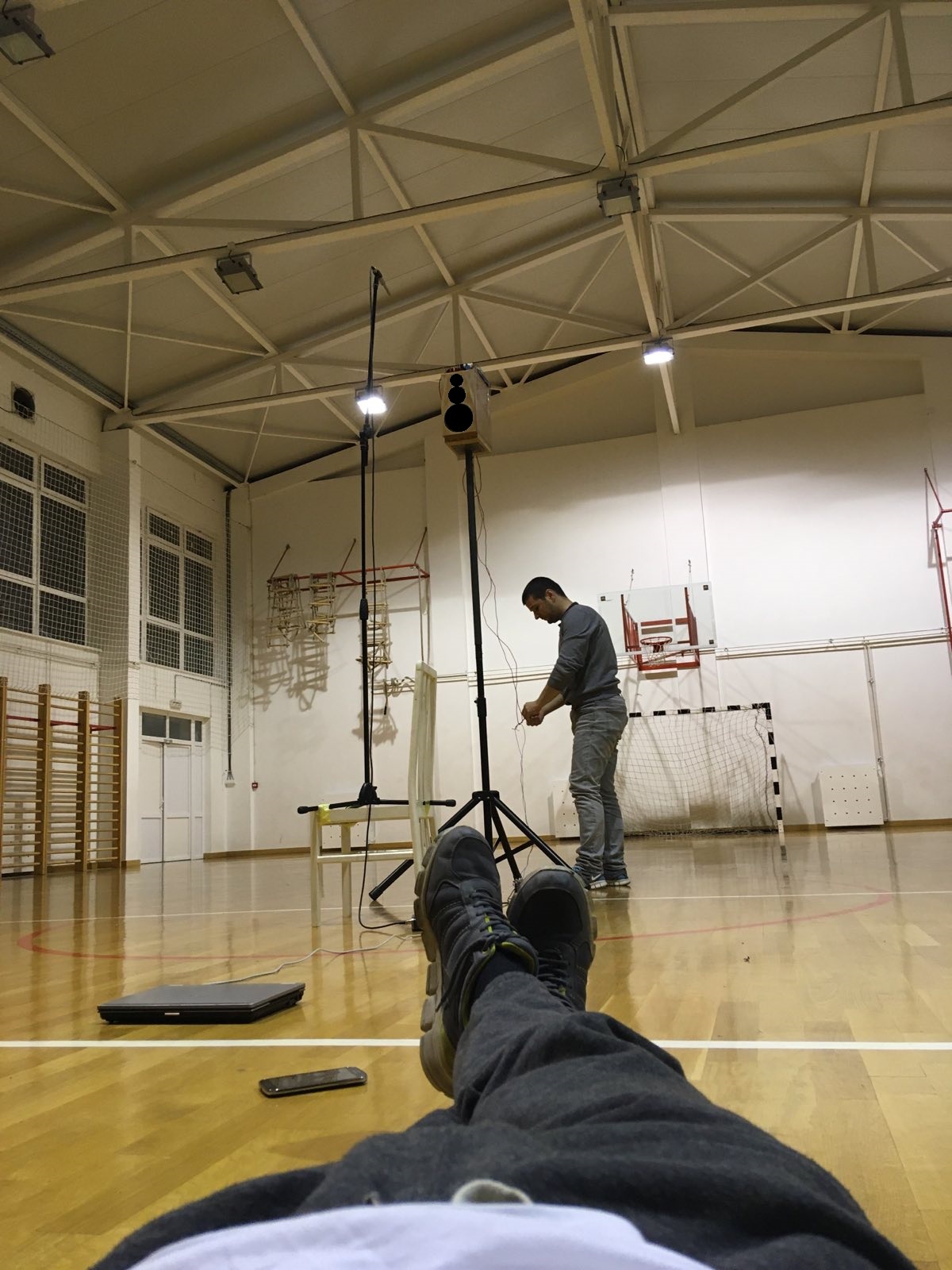

If you want to get the most accurate result (although dependant of outside conditions) you need a crane or some kind of construction that is 8m high. You turn the loudspeaker face down, and flush mount the mic in the ground. That will give you resolution to about 20Hz. That is how they do it in Kef when they want really high resolution measurements and very long gate to get the most accurate results.
I'm doing essentially what you are doing but in nearby school - at their basketball court. It costs about 20 euros and they let us use it from 22:00h to 05:00h. This pic is made this winter when temperature outside was -3 degrees Celsius. Loudspeaker is at height of 3 meters which gives me about 11-12ms gate time and good resolution down to 80Hz.
![Zvu.jpg Zvu.jpg](https://www.diyaudio.com/community/data/attachments/753/753508-ac491cd0683fa9c6201d5537203bdb91.jpg)
As for really low stuff - under 100Hz, i just do the simulation in one of sim programs (Unibox, Winisd) and merge it to my measured data. Simulators are very precise down low. As Andrew Jones said - if you give me ts parameters, i'll calculate your response under 100Hz with 0.5dB error.
About mic stand reflections. I did mount some damping material around it and made measurement before and after. The results were so similar that i gave up on taping it to the mic stand every time i do the measurements. Here are fer pics of my measurements:

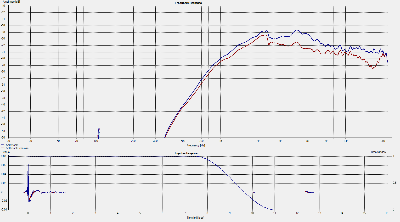

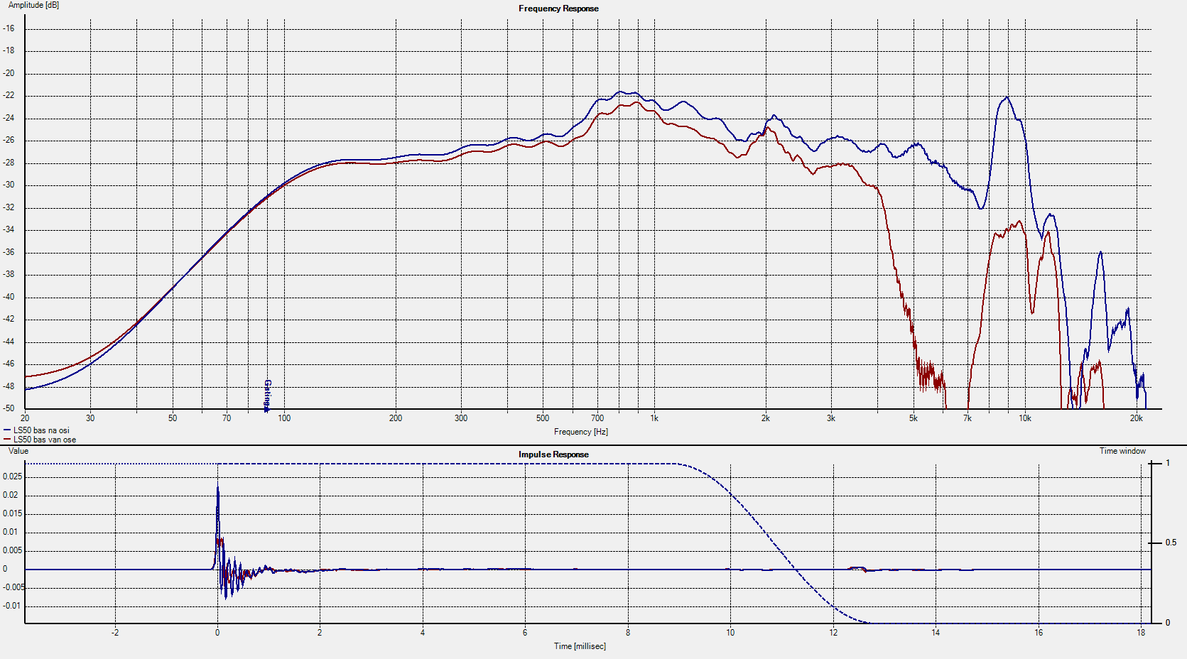

Kef R300 woofer raw in cabinet - very hires baffle step effect visible 2dB grid resolution
Kef LS50 midwoofer raw in cabinet on and off axis 2dB grid resolution
Kef LS50 tweeter raw in cabinet on and off axis 2dB grid resolution
Small three way speaker i worked on 0-10-20 degrees 1dB grid resolution
0 and 90 degrees off axis 5dB grid resolution
![0-10-20.png 0-10-20.png](https://www.diyaudio.com/community/data/attachments/753/753518-baf130193b2236283cb8d2a605b9ed2e.jpg)

Wind gradients alone can easily cause well over 360 degree phase rotations at 16kHz measured real time with a dual channel FFT.
On top of the wind gradient refractive effects, the ST-132 at full extension is literally "waving like a flag", that movement can easily be several wavelengths long at 16kHz.
In the photos below, looking up the ST-132 at full height, it is easy to see the deflection backwards (toward the speaker and mic cord) and forward. Those static deflections simply from the slight COG (center of gravity) difference between the test speaker (SynTripP) with and without it's horn extender are small compared to the 100+ millimeter rotations visible with relatively light wind gusts.
Art
Mark,
Art
