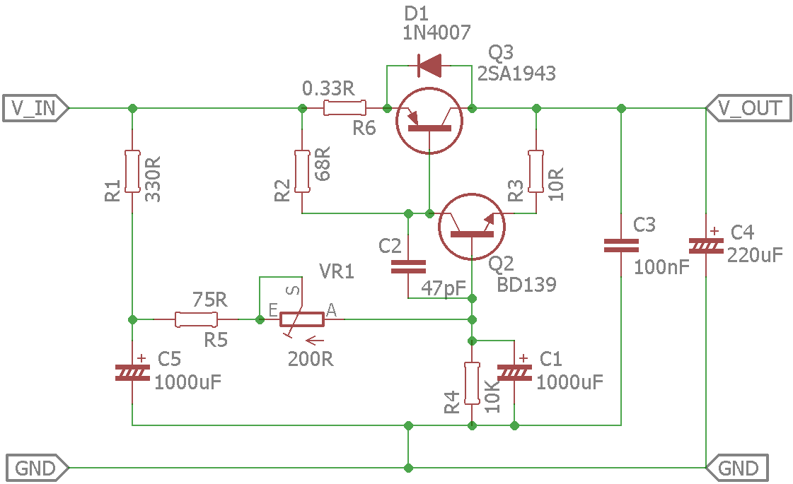

I wish to make a cap multiplier for class A amplifiers.
I found various attempts in this forum and decided to focus on Smooth Like Butter cap mux, based on Complementary Feedback Pair configuration [aka Sziklai]. (LINK) In that thread I saw posts about the possibility of CFP oscillations, and I am concerned that it might be serious.
Can you please suggest a good yet oscillation free Cap mux? Or help me to refine the SLB with components for making it more stable? I noted the following:
1. Ballast resistor in the emitter of main pass transistor -- 0.33R is enough?
2. The expression "gm degeneration" was mentioned, but I didn't understand.
For a Class A amp with reasonable PSRR, there is no need for a low Zout cap multiplier.
Certainly not worth the oscillation risk of a Sziklai pair, which can happen with one amp and not another.
I personally would just use a simple one like that on the JLH Class A Amplifier Site.
There are better choices of active devices, like Darlingtons from Sanken or Onsemi.
Although I do not think they will make a huge difference either.

The objective is to reduce he amount of capacitance in the PSU without causing hum in the amplifier.For a Class A amp with reasonable PSRR, there is no need for a low Zout cap multiplier.

Rod Elliott in his Project 15 recommends Sziklai pair for lower dissipation and improved performance.
This has been implemented successfully by the designers of SLB and it works well; with a minor possibility of oscillation.
Then why ask for alternatives ?
The famous Salas Shunt love by many here, for example, oscillates wildly in the F5-HA, as found out by Stixx :
https://www.diyaudio.com/community/threads/f5-headamp.271926/post-4848225
No such problems with a normal Darlington cap multiplier.
Patrick
This is a very elaborate power supply. How much current does it need to provide?
30,000uF per rail is enough (USD $48 to $208-worth quan-4, 63V / 80V at DigiKey) that some reasonable people would not see the need or benefit to the capacitance multiplier, even if it did not pose an instability risk -- especially serving a Class A amp.
In addition to the considerable component cost, your time spent building and testing it, while probably enjoyable, still represents a cost.
If you persist in building this, please consider lower values for C15, C17, C16, and C18. Am also puzzled by the trimpots -- what do they do?

It seems that you never built a high power cap multiplier using a darlington...it needs either huge heatsinks with a large input to output voltage difference or huge capacitors...Then why ask for alternatives ?
Patrick
For ringing a ferrite bead on base pins or some 10 windings of ennameled copper in the air in the transistor's base can solve the problem.Actually even normal darlingtons need ferrite beads as they can oscillate from time to time too.A darlington behavior in a power class ab amplifier isn't very far from one in a cap multiplier.Harman kardon pm665 vxi is an example and actually most famous harman kardon amps would have those inductors.If in pm645..665 you have a sziklay pair driving the final transistors, in hk990 you have normal 3ef stages using the same inductors paralleled with 10 ohms resistors...pm665 also have a 15 ohms resistor inside the sziklay pair...Besides most amps have zobel networks that prevent ringing due to the load...a cap multiplier might very well need a zobel too.It all depends on the nature of the load.
A conventional Darlington cap multiplier will reduce LF ripple by 30-40 dB, and bit more in the mid band. It does little at frequencies above 100-200 kHz.

The standard Darlington configuration is reliable and with a base stopper not readily prone to oscillation. Be aware, a cap multiplier raises the power supply output impedance above that of a straight repetitive+ cap bank.

I'd say that sziklay pairs need to be treated accordingly as in any power amp using them and they should be fine.
