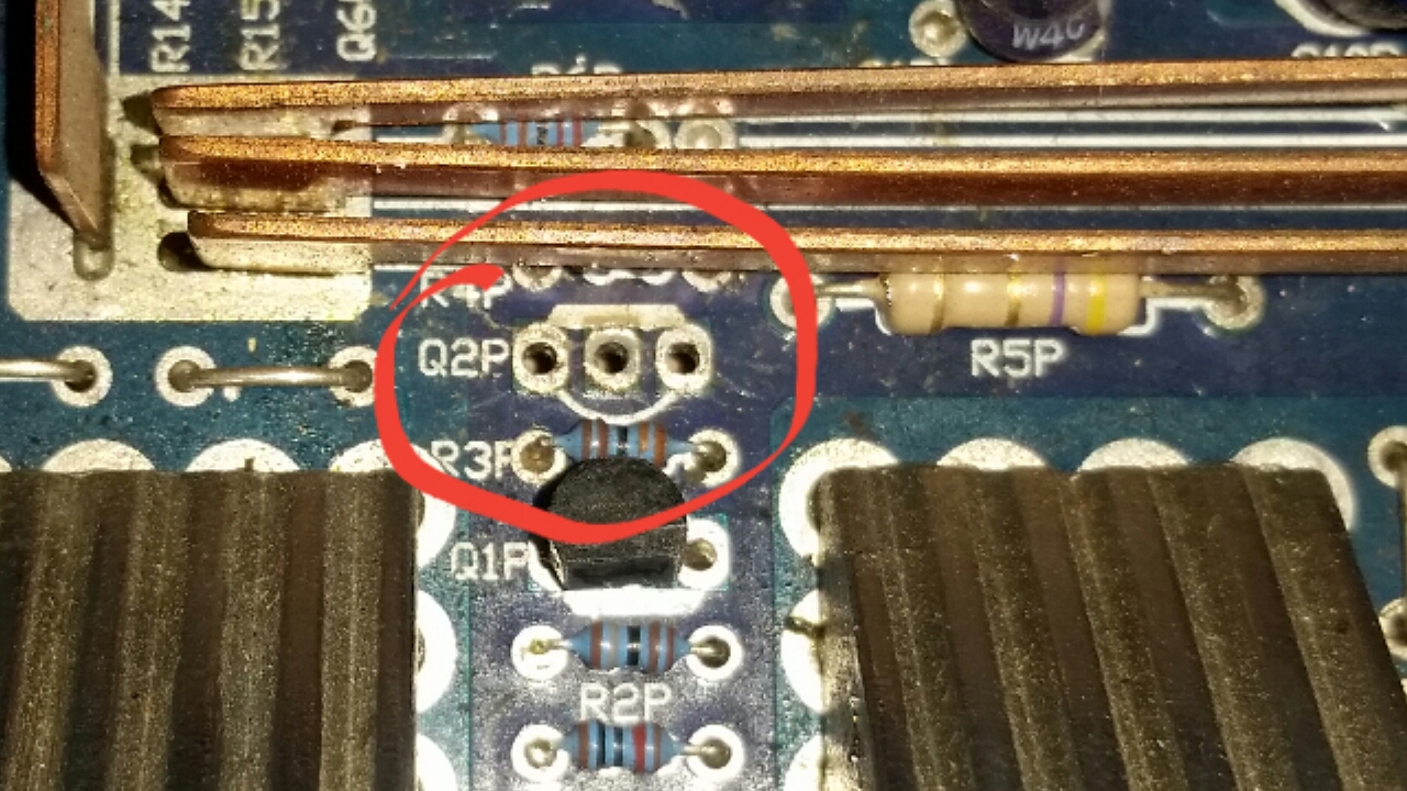

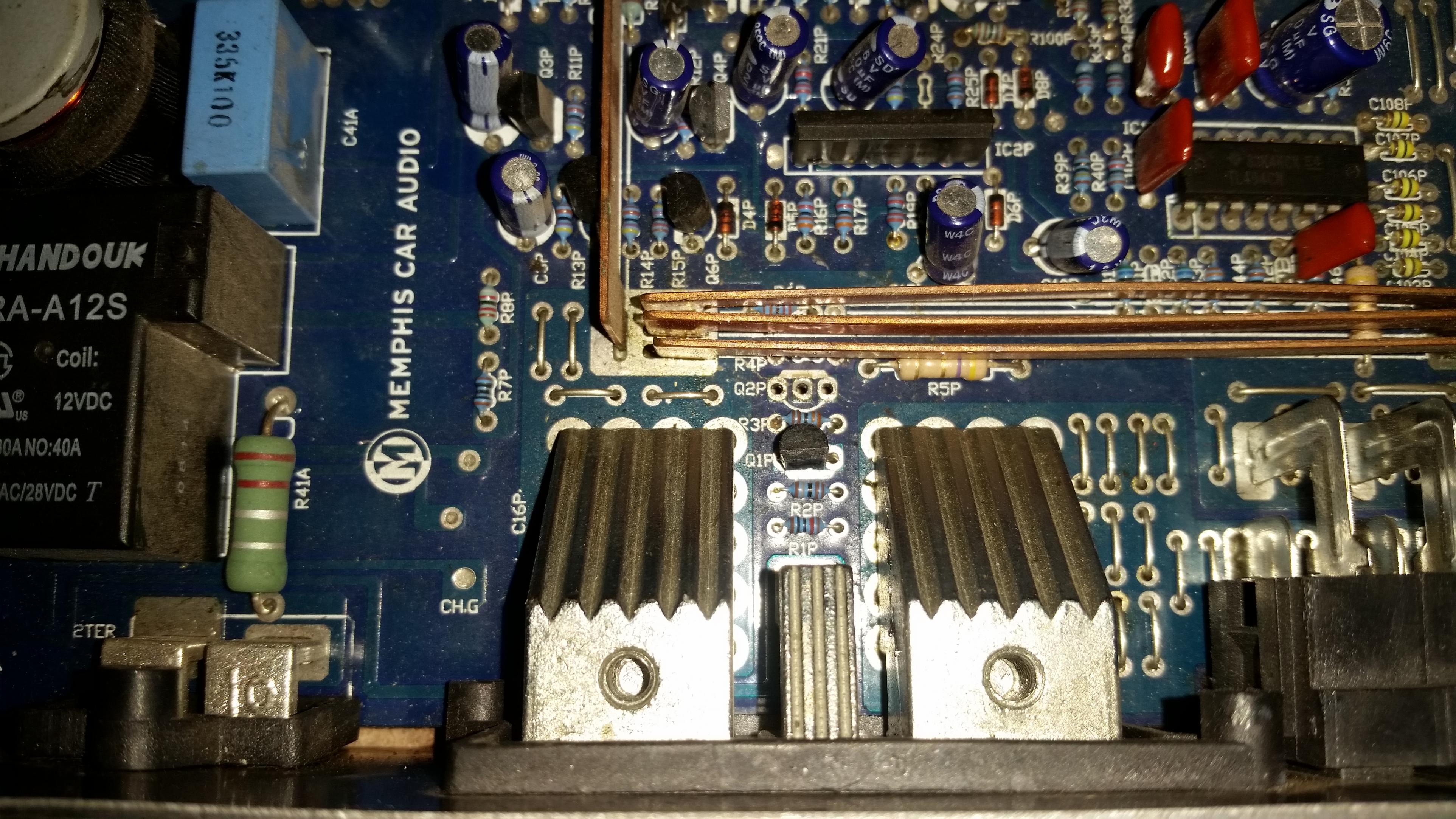

hello friends I hope you can help me I am looking for a transistor for my memphis pr 1.1000 is the one marked with a red circle (transistor Q2P) if someone had the diagram I would appreciate it or have the amplifier itself that can tell me that transistor goes there greetings and thanks
It's likely a PNP transistor. If no one has a definitive answer, power the DC voltage on all 3 legs with the amp hooked up with remote voltage applied and again with no remote voltage.
if it starts by applying the remote in the intermediate terminal and in the lateral terminals there is 12 volts is it normal?
Having the voltages w/without remote would have been more definitive. Something like a BD140 may work.
