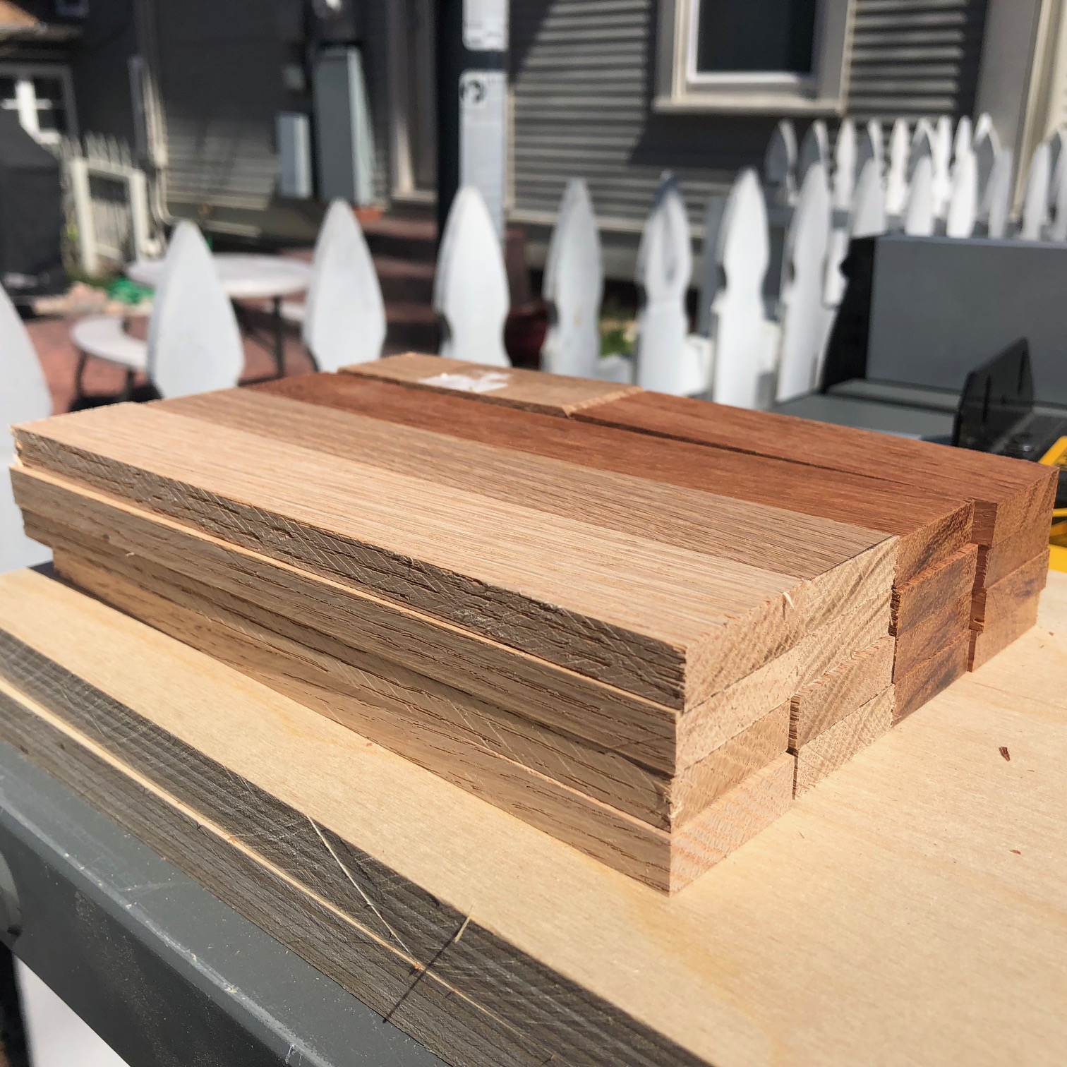

Material is 15mm Baltic birch, along with three 9mm boards of red oak and Brazilian cherry for the vent spacers. The different colors will make for an interesting pattern on the baffle, though I might end up veneering these. We'll see.
All panels were cut to rectangles today, with the width slightly wider to allow for margin of error when making the bevel cuts (will figure out how to do it on scrap first). The cut list in the plans made this really easy!

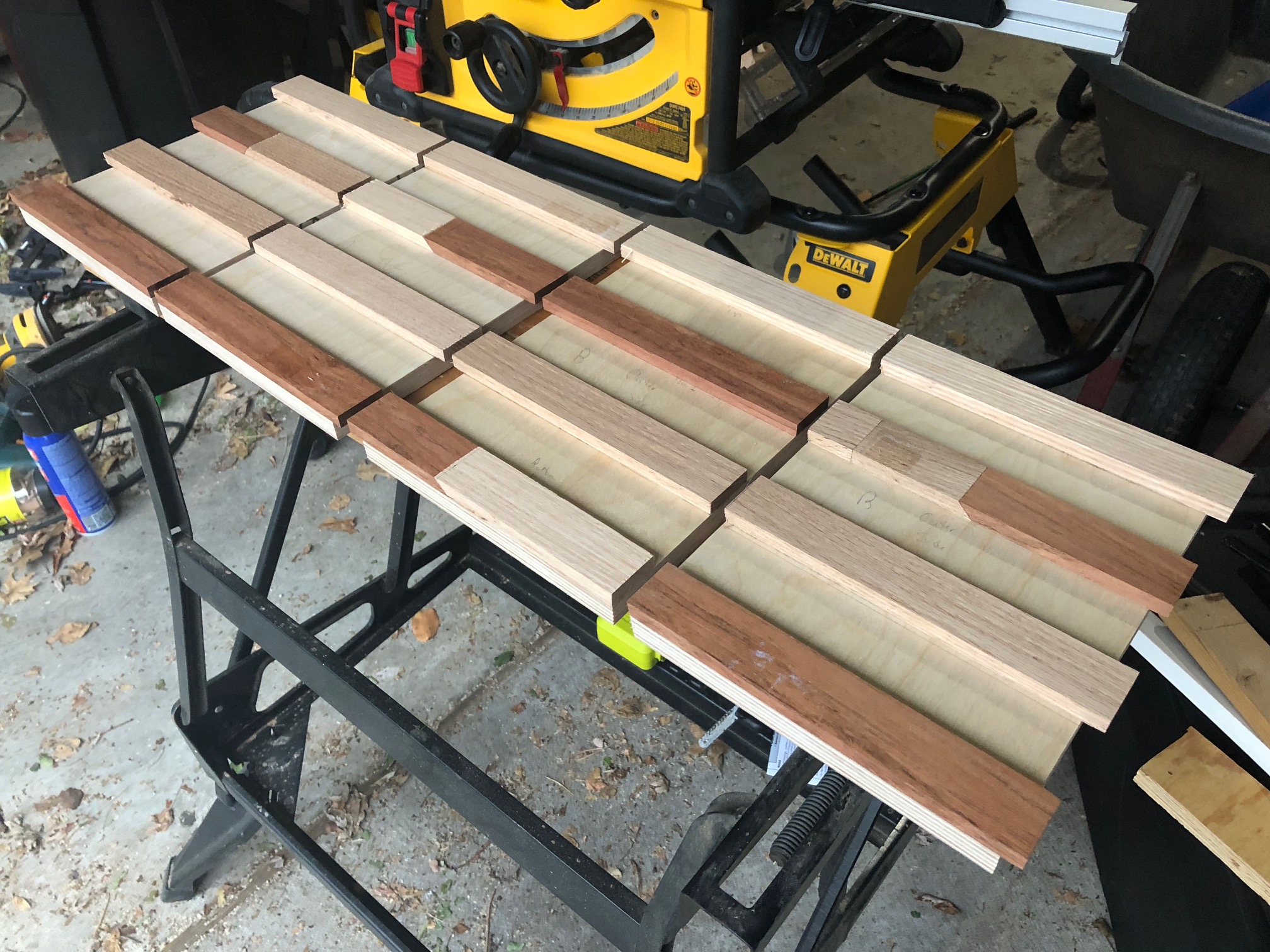

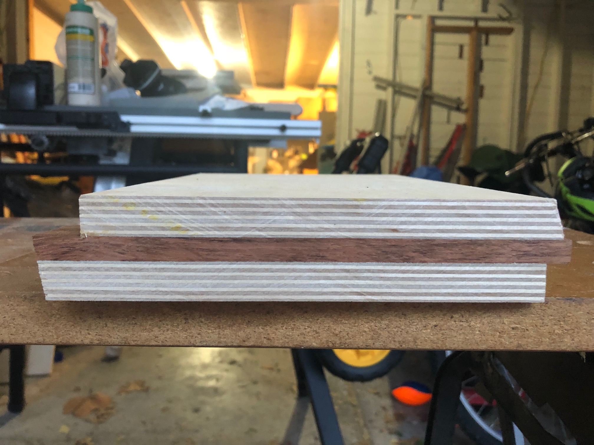

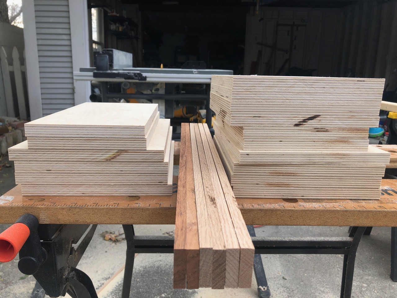

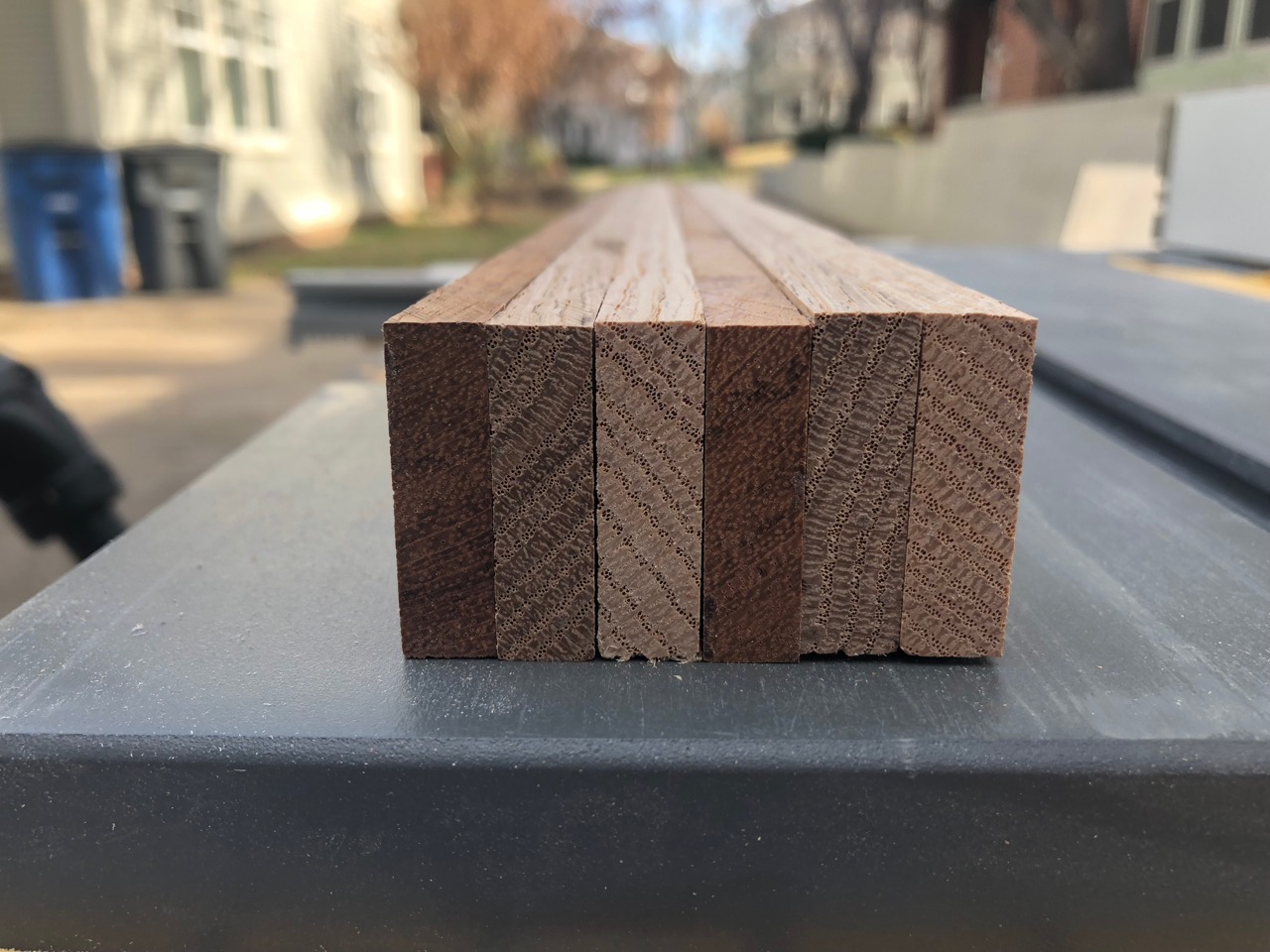

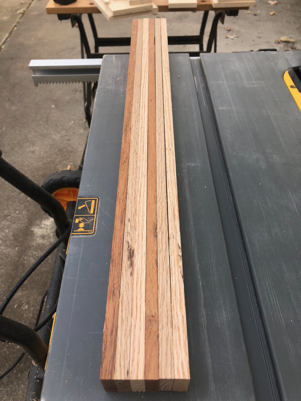

I started with the exterior side panels and vent spacers, cutting them to lengths that will turn out correct when I cut the big 45* chamfer later.

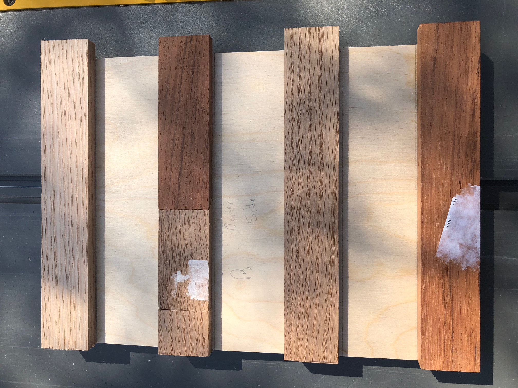

The spacers are 9mm (3/8" oak and Brazilian cherry from Woodcraft. Some of the oak is a hair thicker than the other material, so I might need to sand or plane it, or else insert paper shims where it seems there might be an unclosable gap with the interior wall.
Also, I had to make some spacers from two cuts of hardwood in order not to have to buy more material
Next I'll make the front baffle, rear baffle, and braces. I cut the brace panels 1/2" larger for inserting into dados for maximum strength and rigidity.

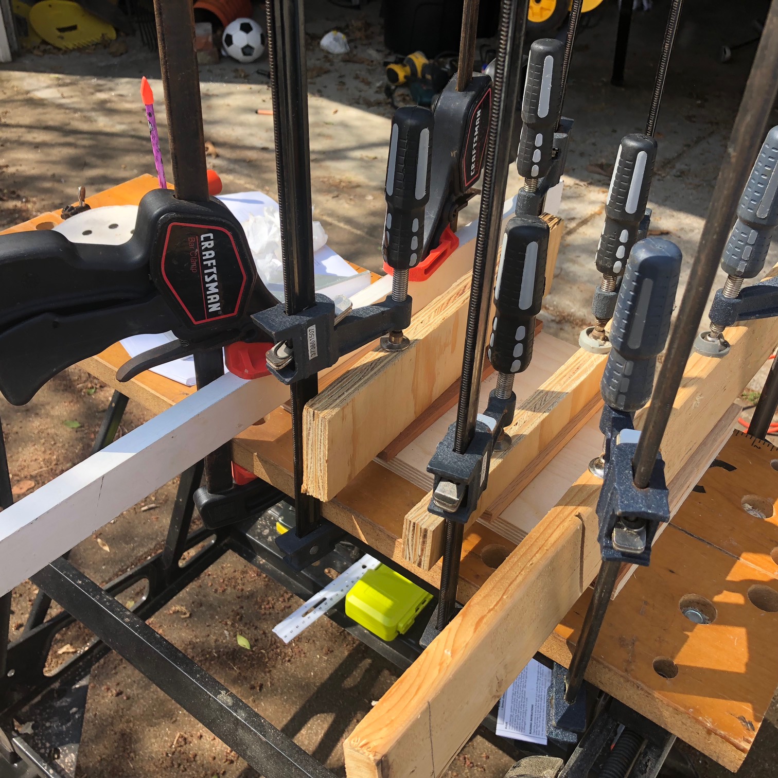

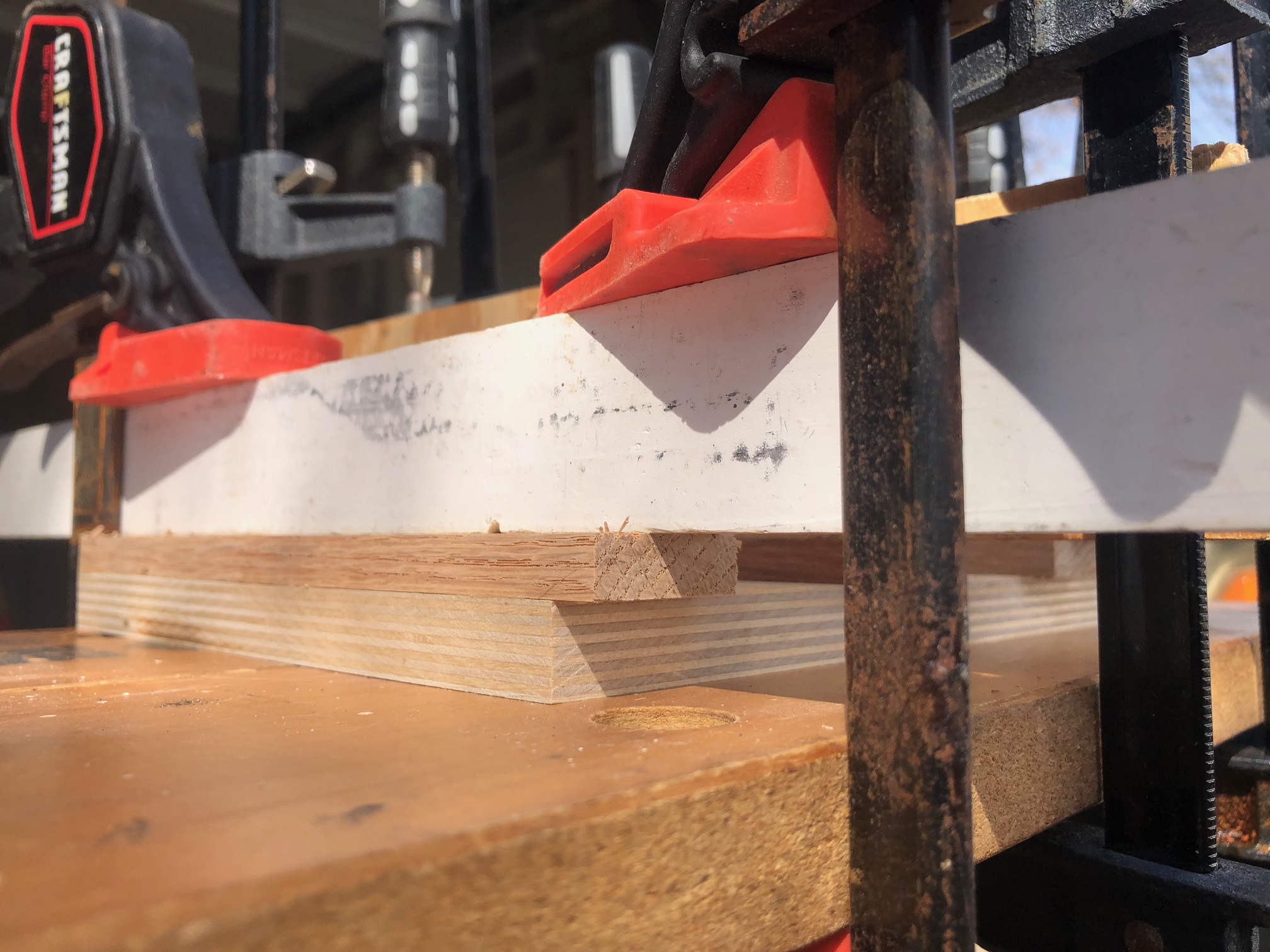

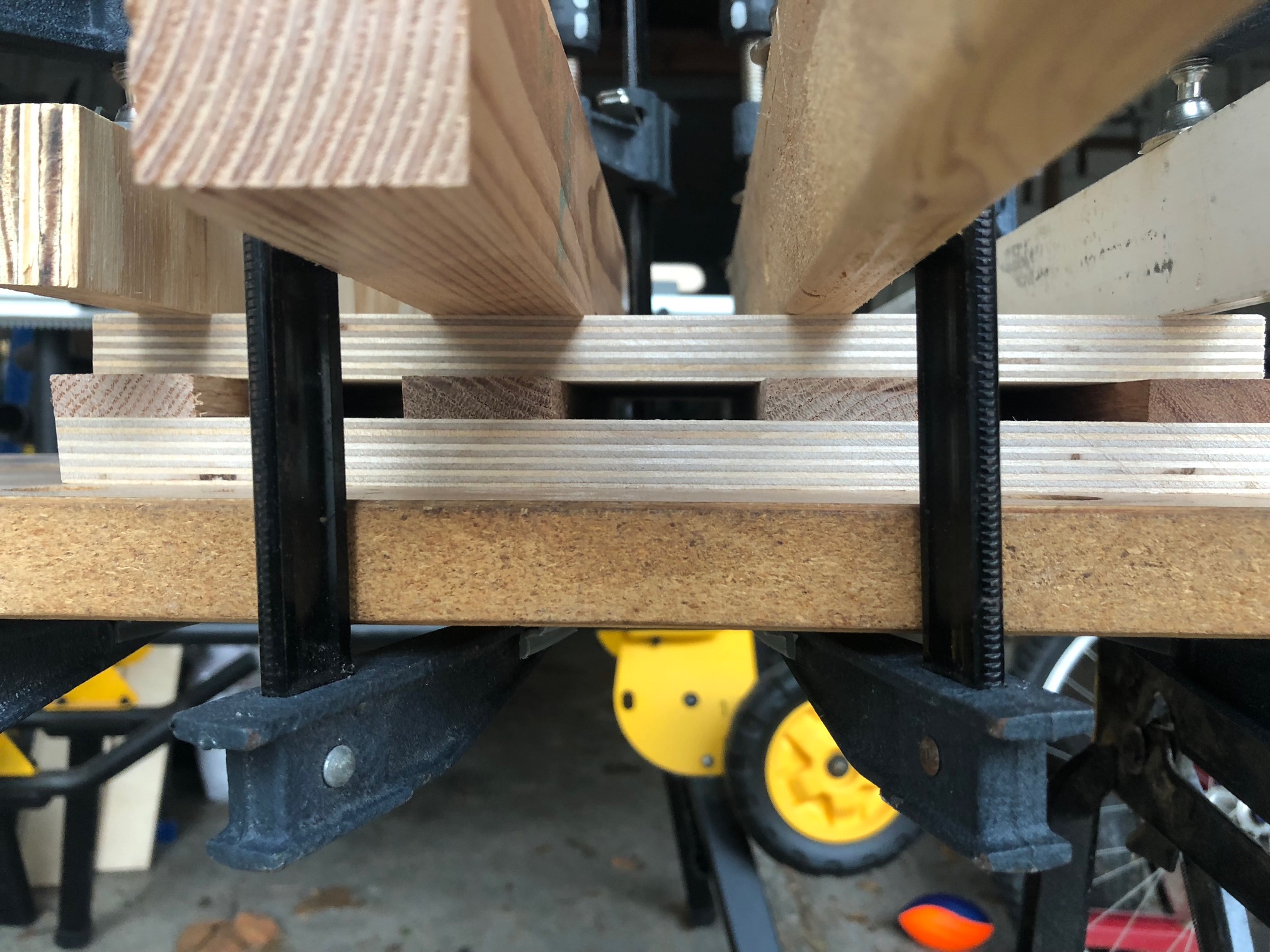

Sandwich press.

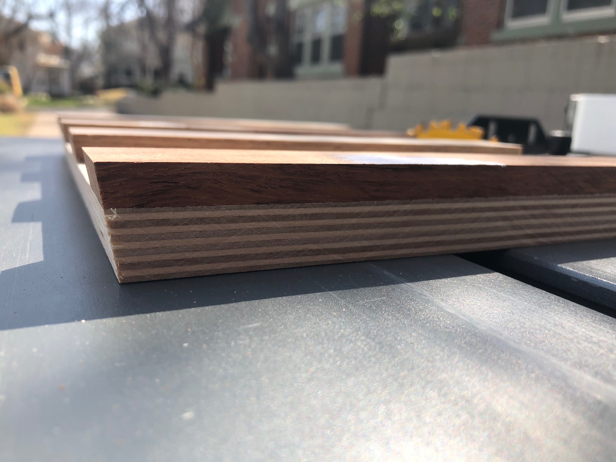

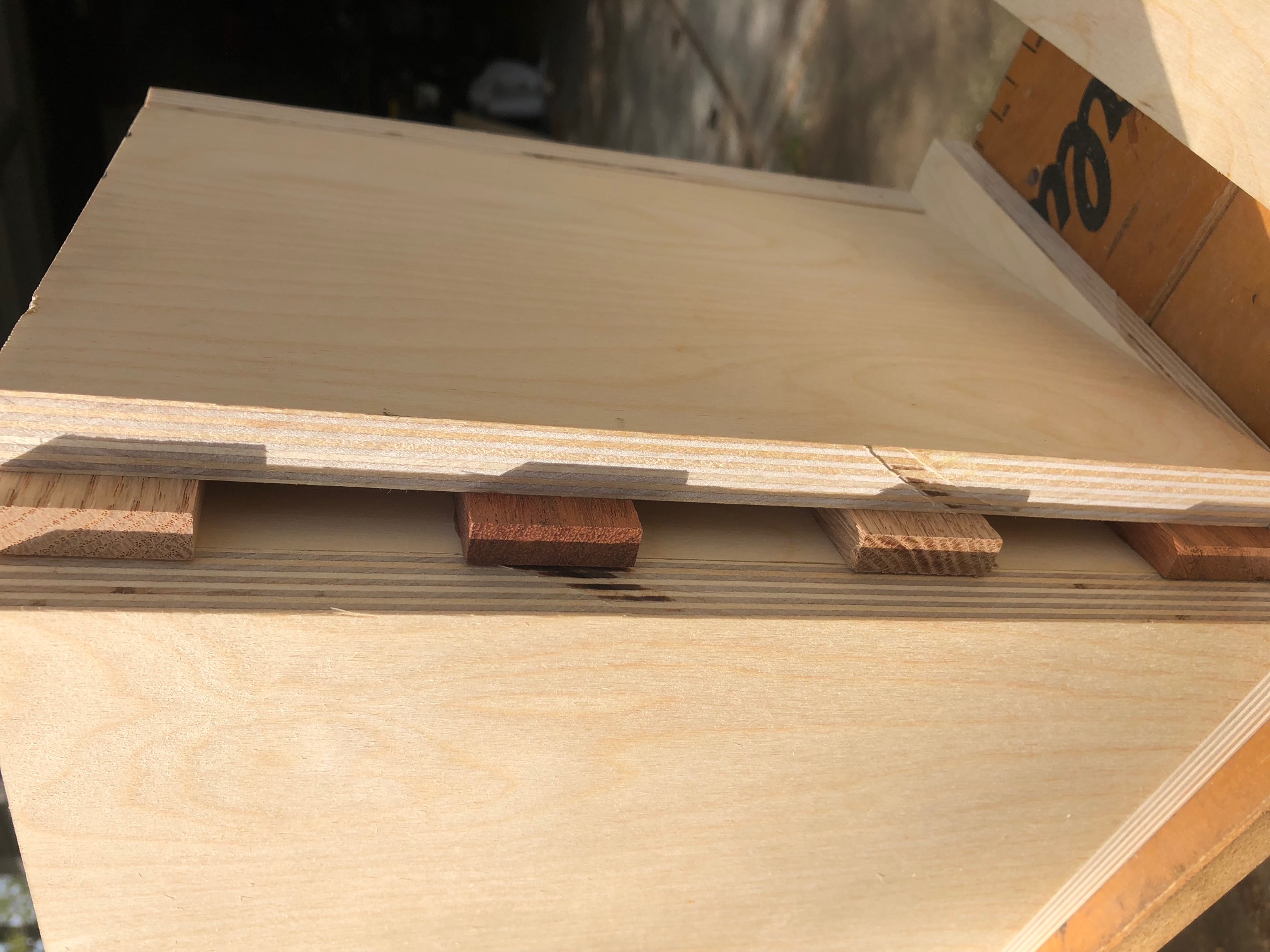

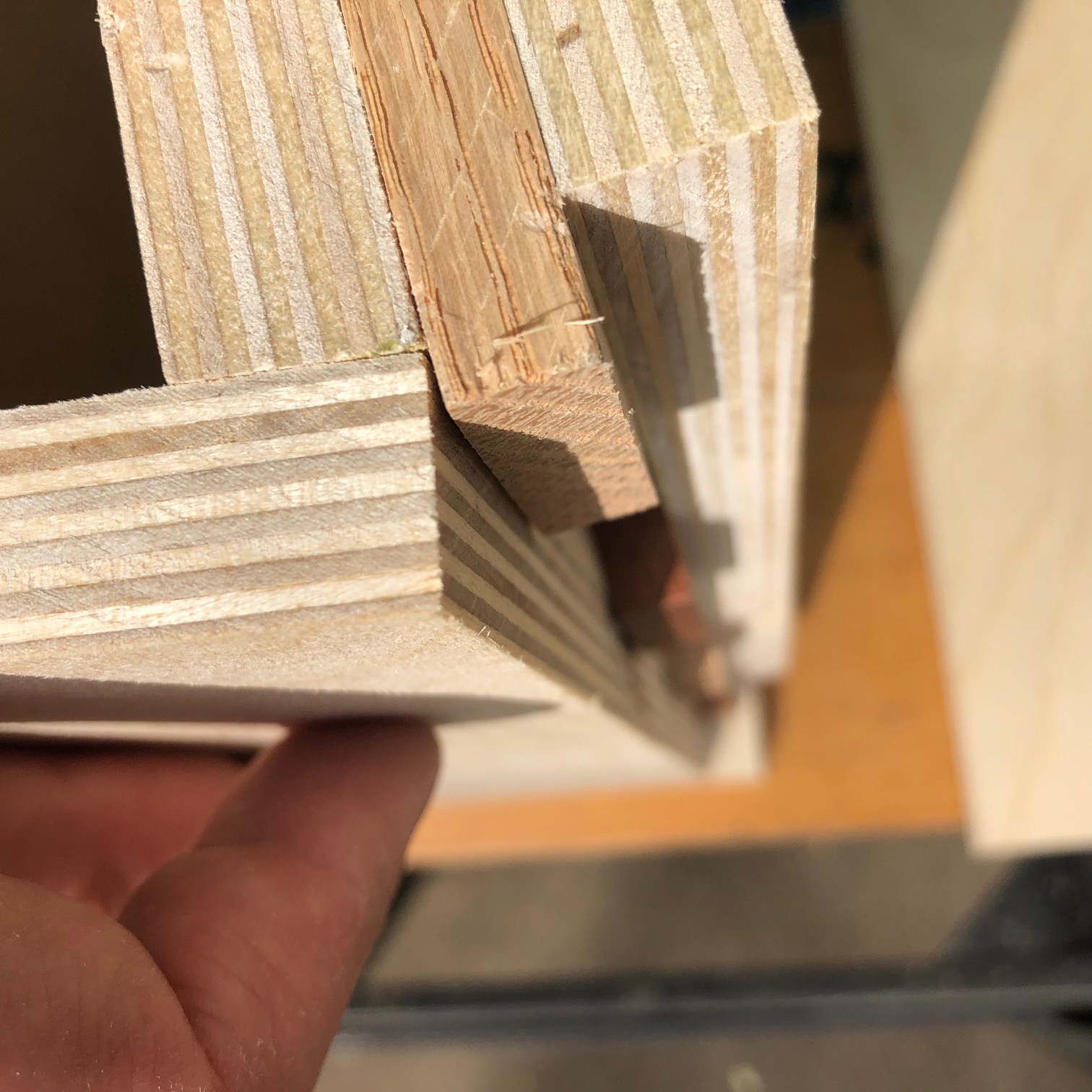

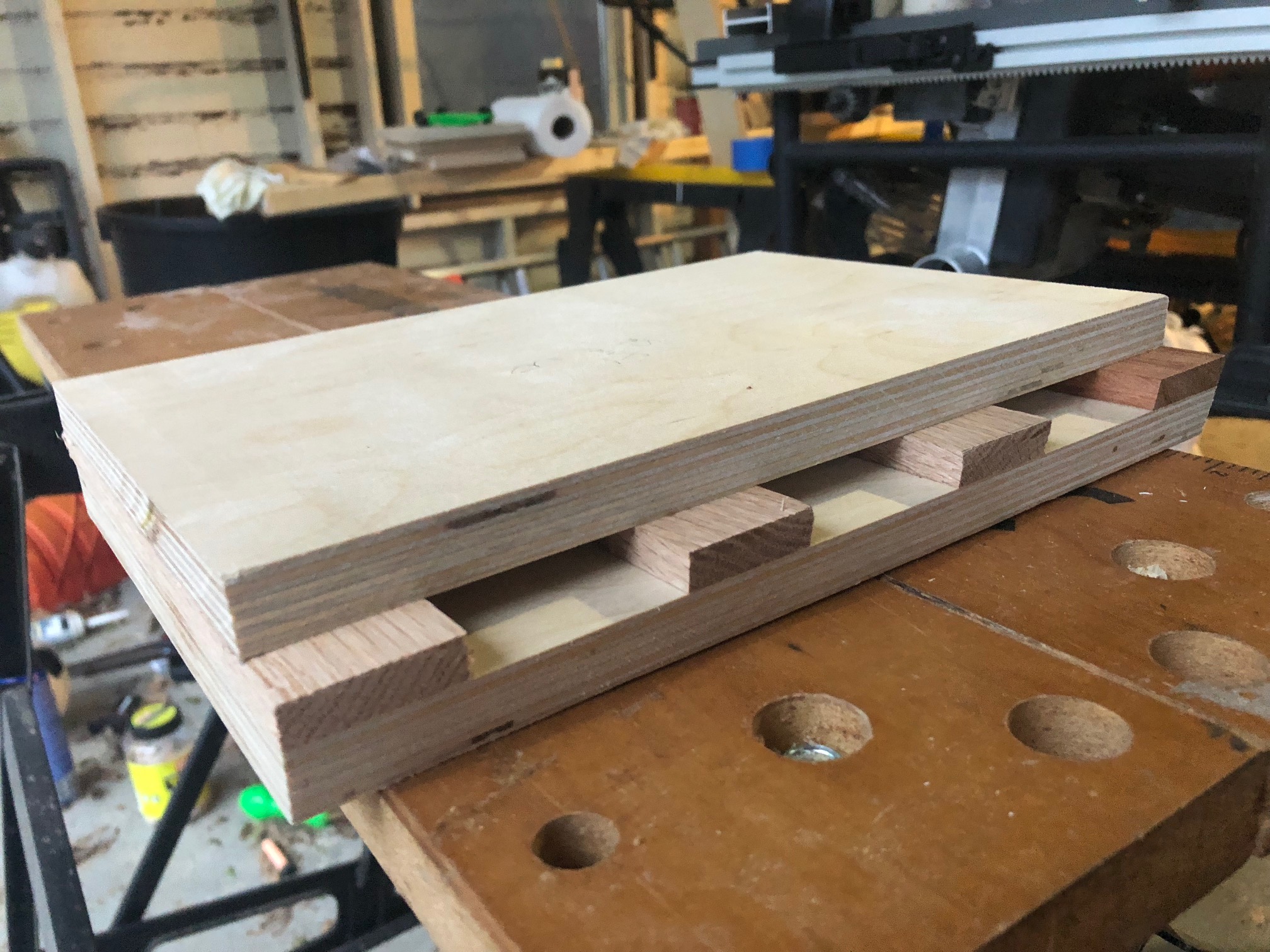

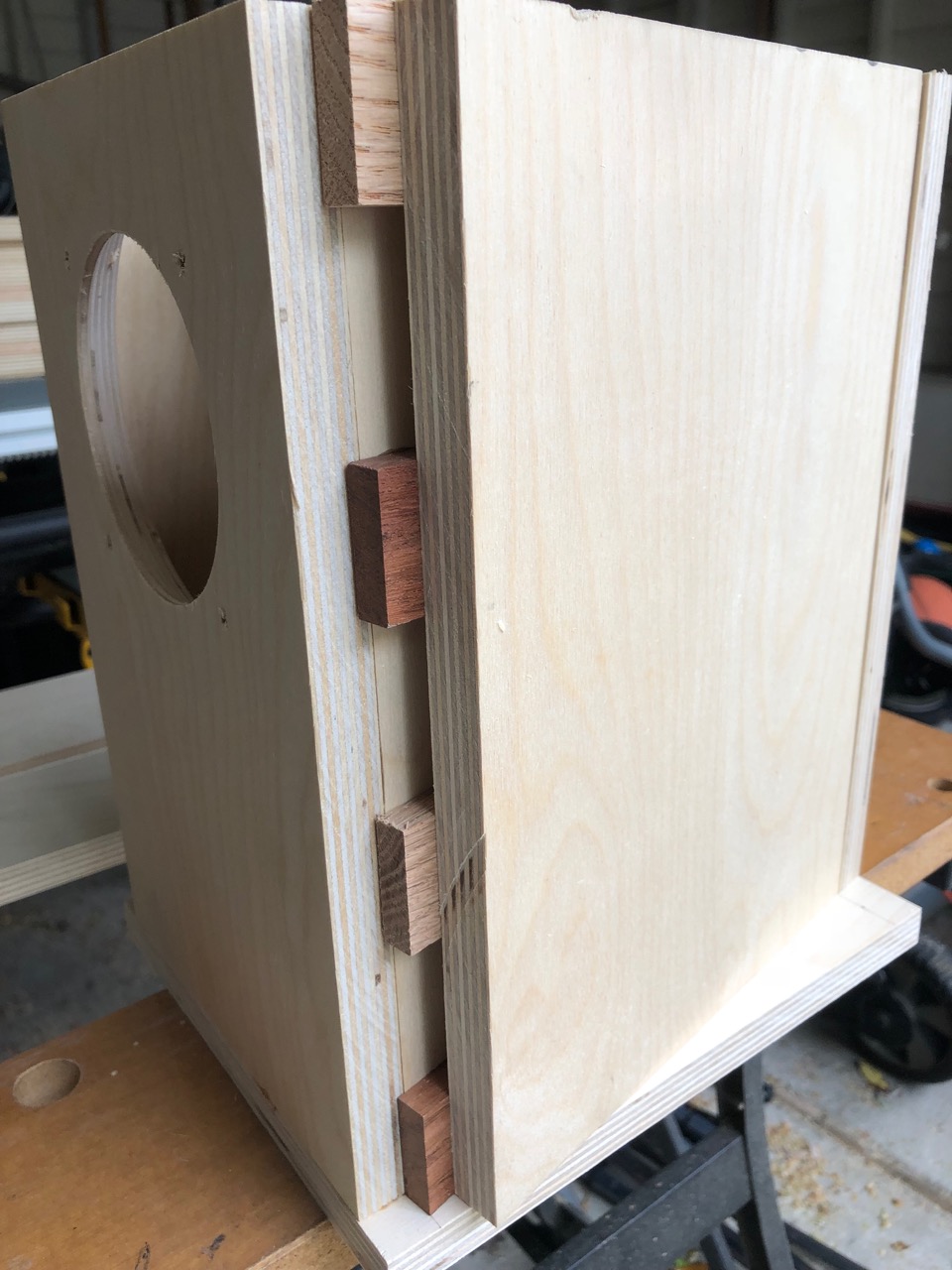

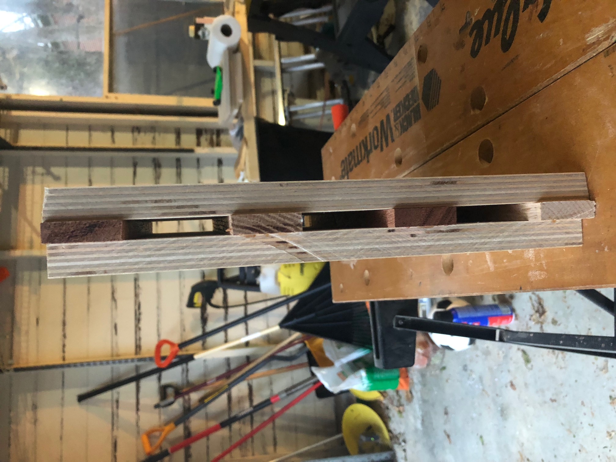

In post #3 there's a picture of the beveled edge of the glued outer side panel and spacers. To do that, I glued the spacers on and then did the bevel cut by using the miter head (not the rip fence), incrementally moving the workpiece closer to the blade with each pass until the entire edge was beveled. The goal was to stop as soon as the bevel met the top edge, so as not to shorten the width of the workpiece too much. All dimensions measure *exactly* what's in the plans, leaving no wiggle room.
After gluing together the outer side walls and spacers, I prepped the interior wall panels. For all panels requiring bevel edges, I cut their "blank" panels about 1/2" wide in order to leave room for mistakes during beveling. The interior side walls only have one beveled edge, so I cut that edge first on all four panels as in post #3, put the saw blade back to 0*, set the rip fence for the width of the longest edge, and then made those cuts. Very easy.
During dry fit, some of the cherry vent spacers did not meet flush with the interior wall because one of the oak boards was a tad thicker than the other ones. On spacers that came from that board, I used a hand plane and then orbital sander to reduce the thickness so that al the vent spacers met flush with that interior wall. It wasn't hard to do (the sander was faster and generally better), but it took a little time.
Now I'm gluing the interior walls to make all the 3-layer sandwiches.

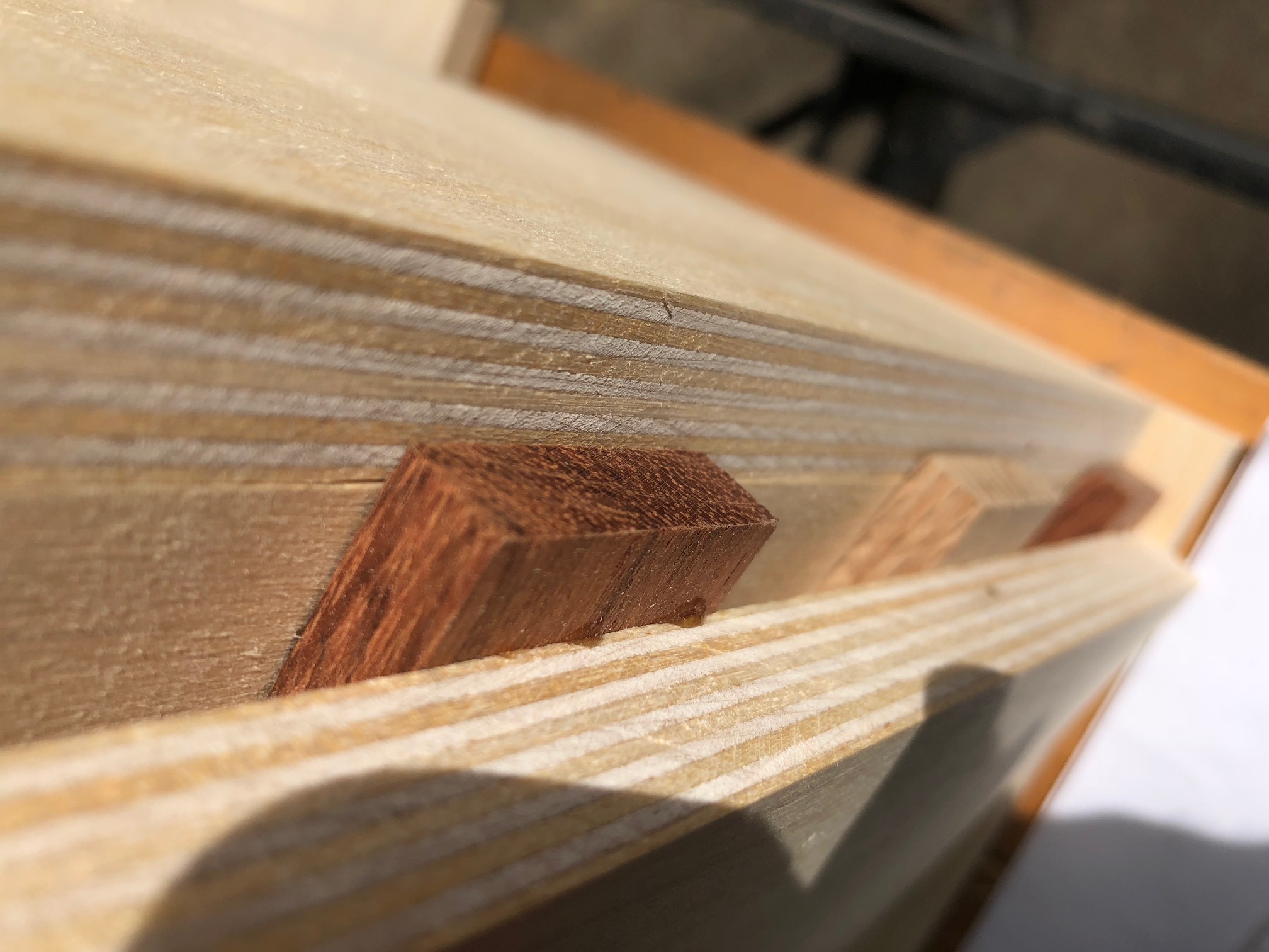

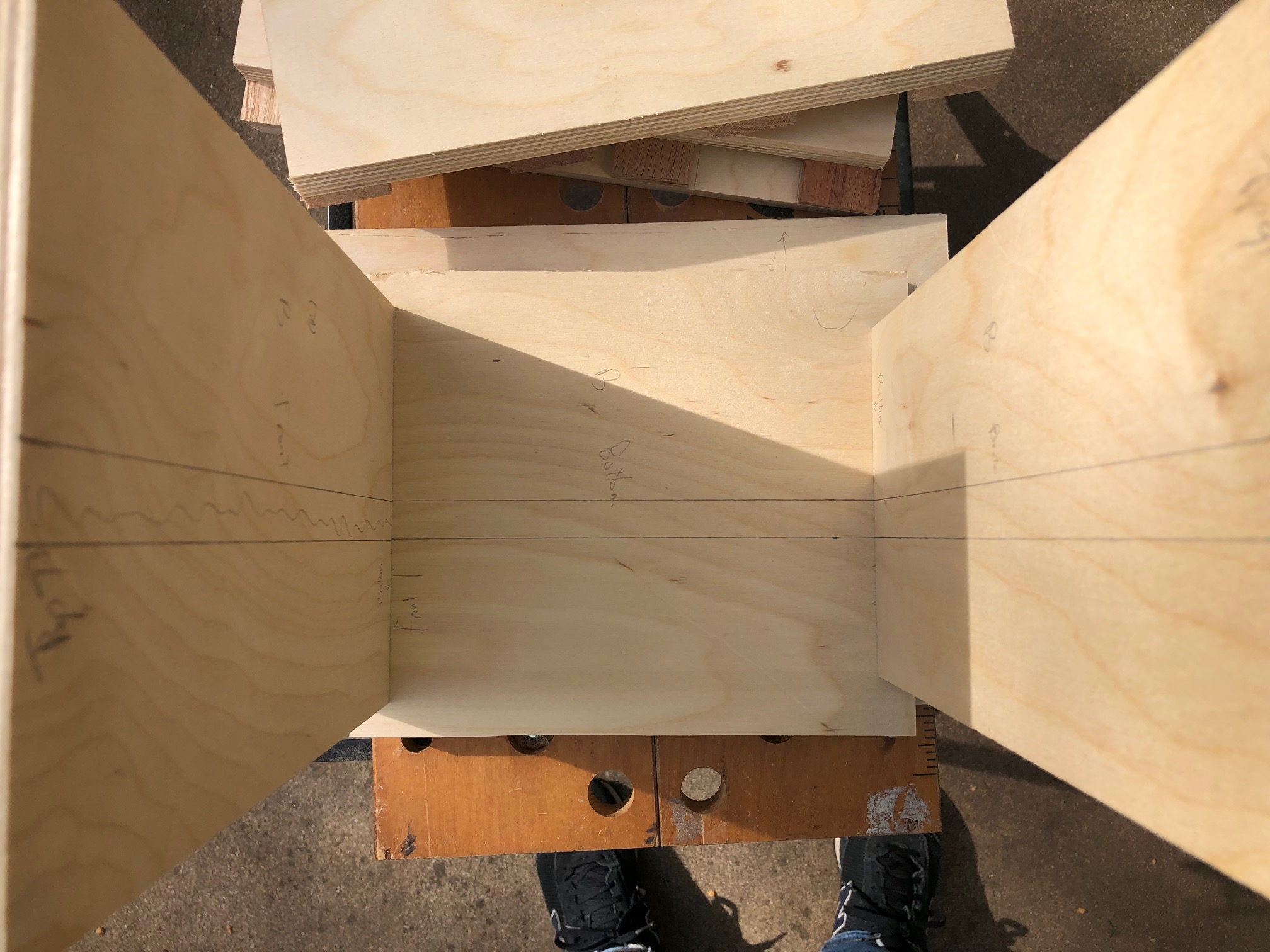

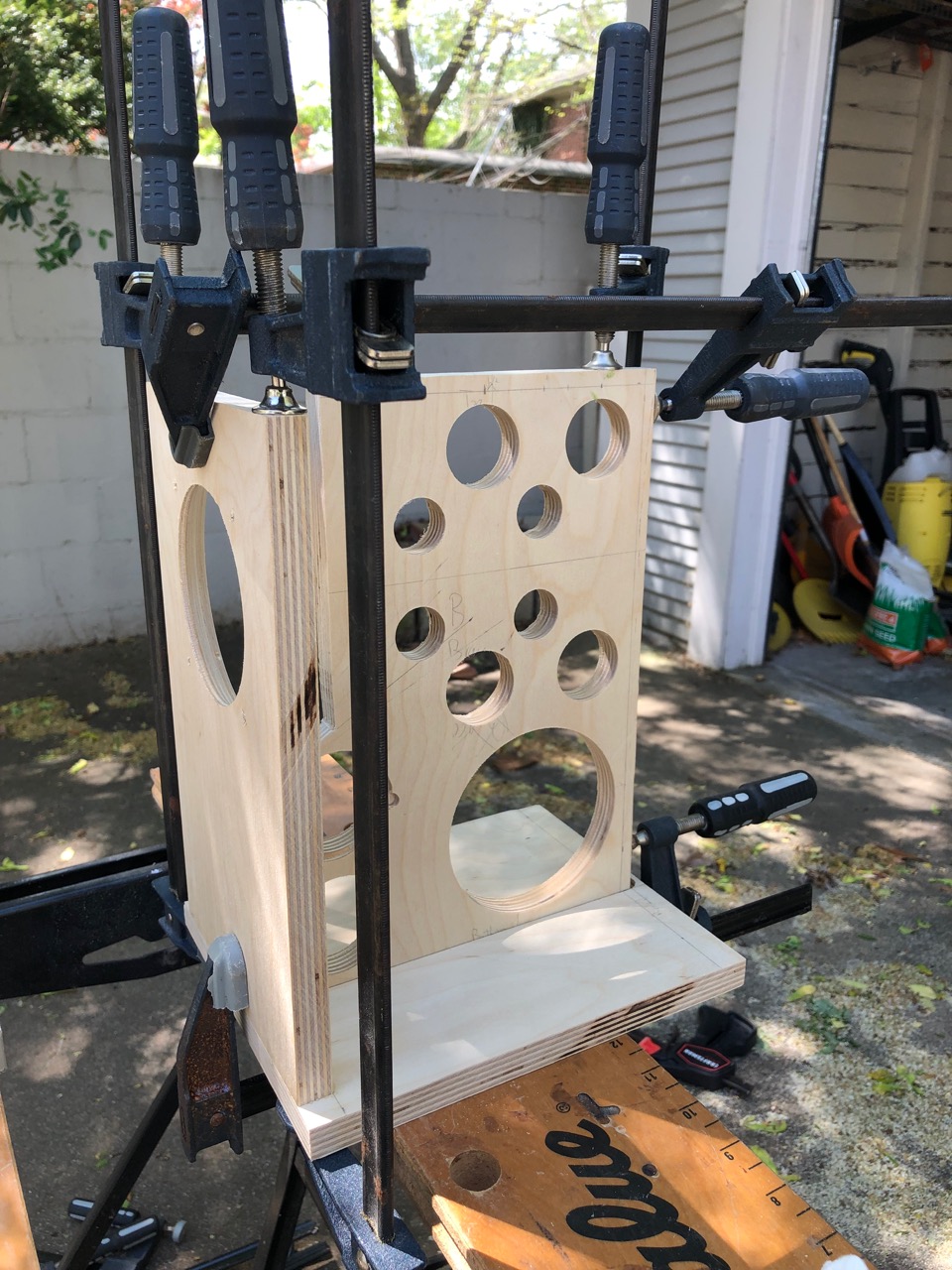

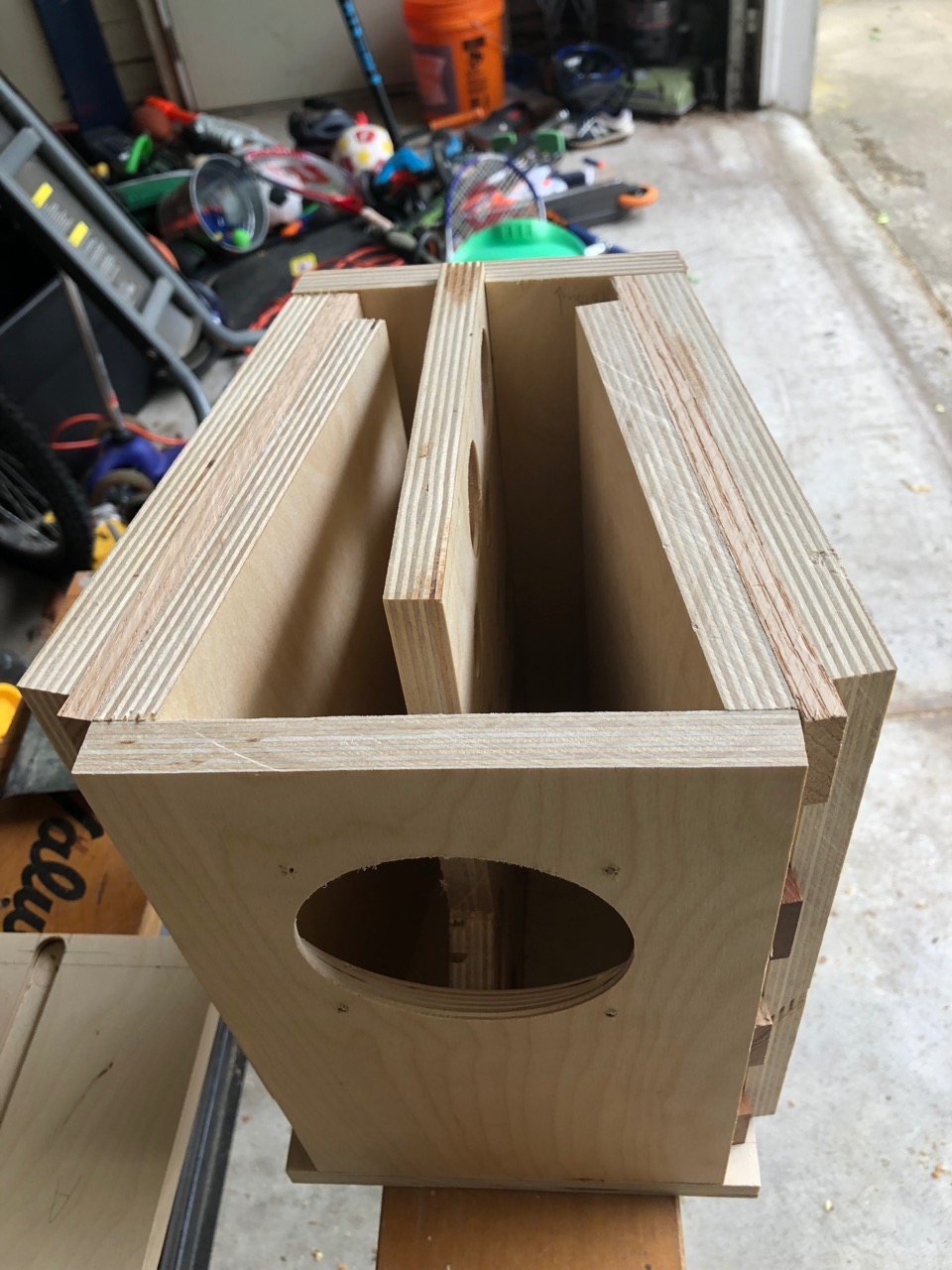

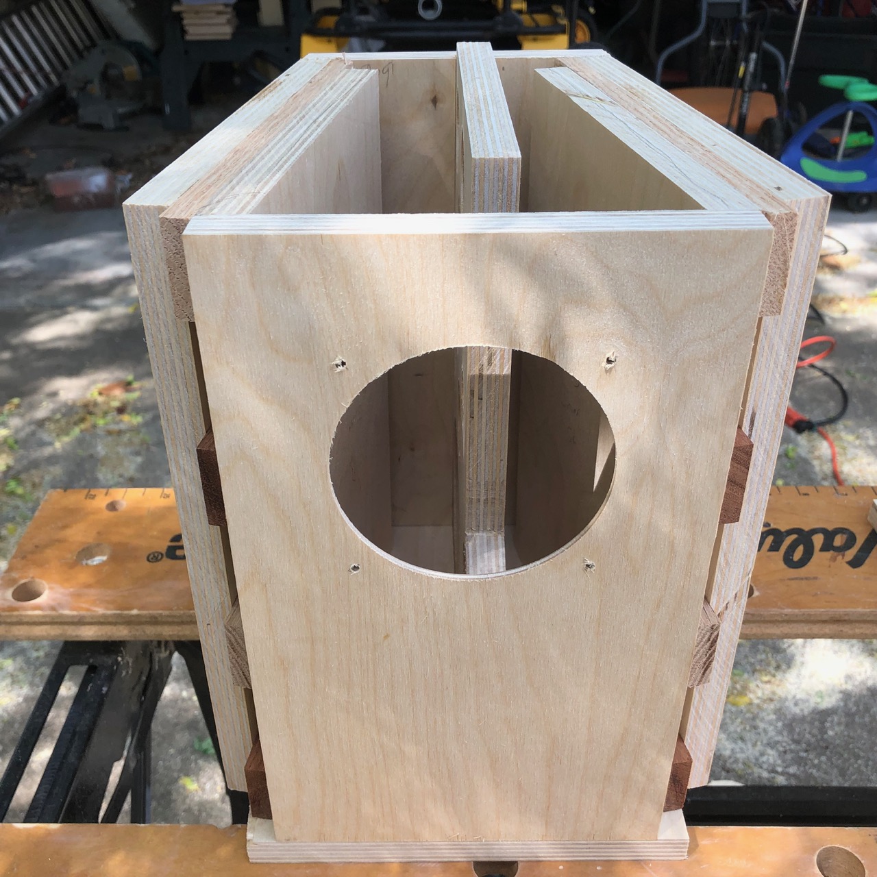

Thanks! Today I tried a dry fit of the sandwiched side walls, front & back, etc., and then cut all the circles. I also started cutting the dadoes that the brace will fit into.
In the side wall pieces, the vent spacers hang over the front baffle a little, to help with alignment when gluing. I didn't cut the front bevel on the spacers or exterior wall, leaving that for the big chamfer to be done on the table saw after assembly is complete.

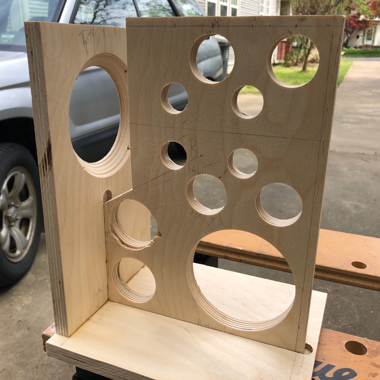

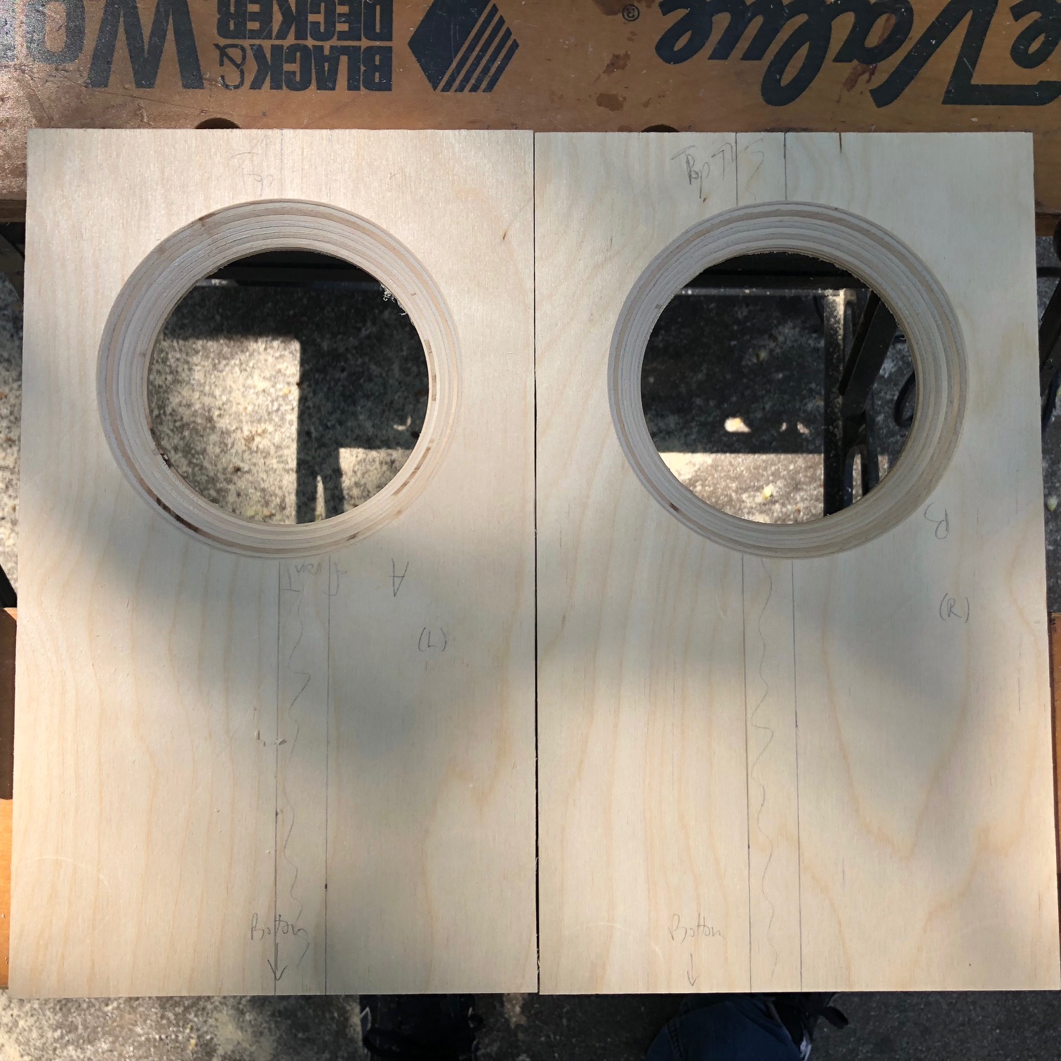

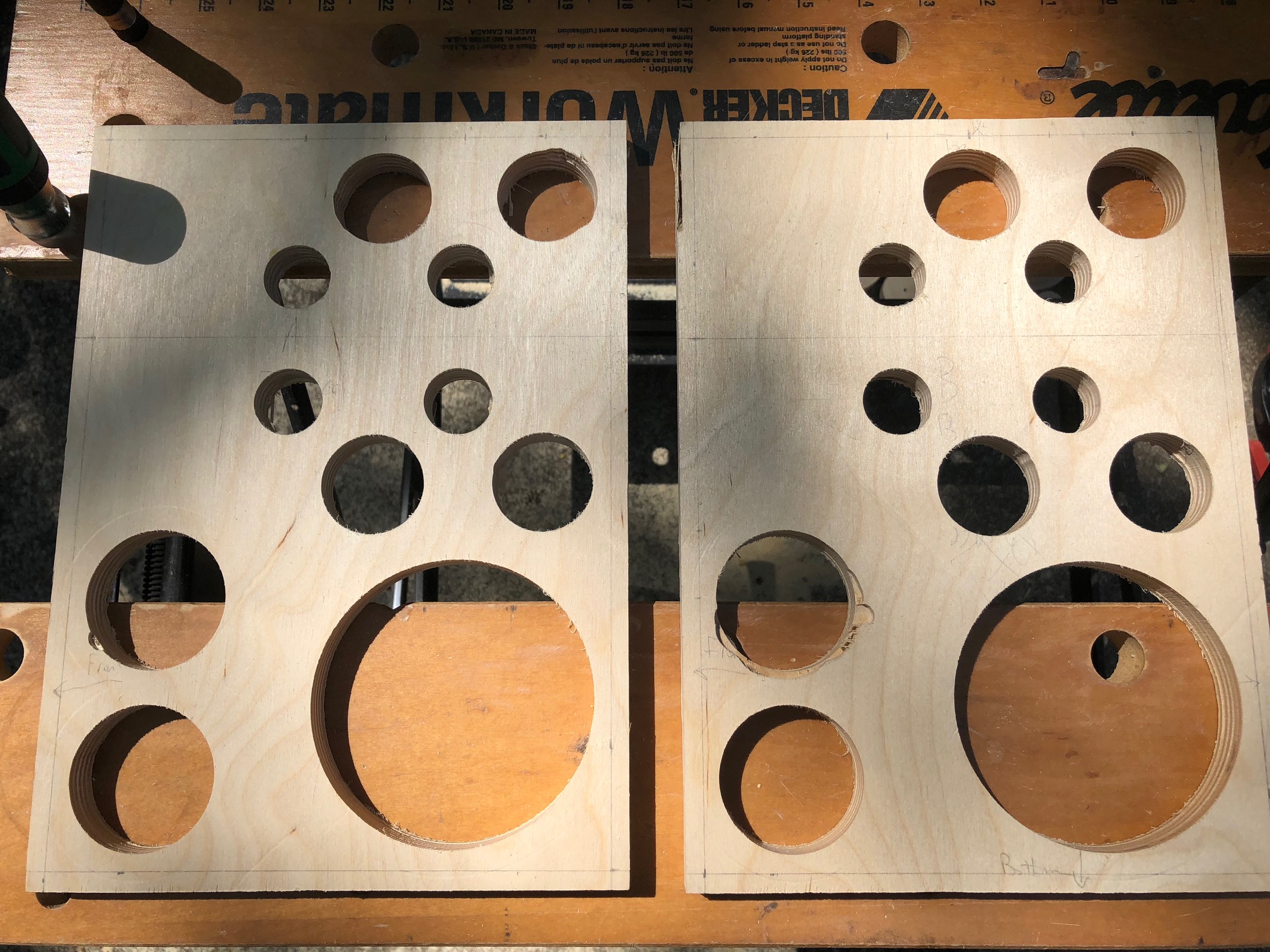

Today I cut the driver recess in the braces and glued the skeletons. Figured it would be best to start with the front baffle, brace, and bottom, since everything else gets attached to those.
Then I did a dry fit to make sure everything lines up. There's about three inches of minor damage on the top rear edge of one of the side wall sandwiches, the side that glues to the back panel. The interior meets the back panel fine, but I could use advice on a product and best practices to fill what will likely be a ~1mm gap at that spot.

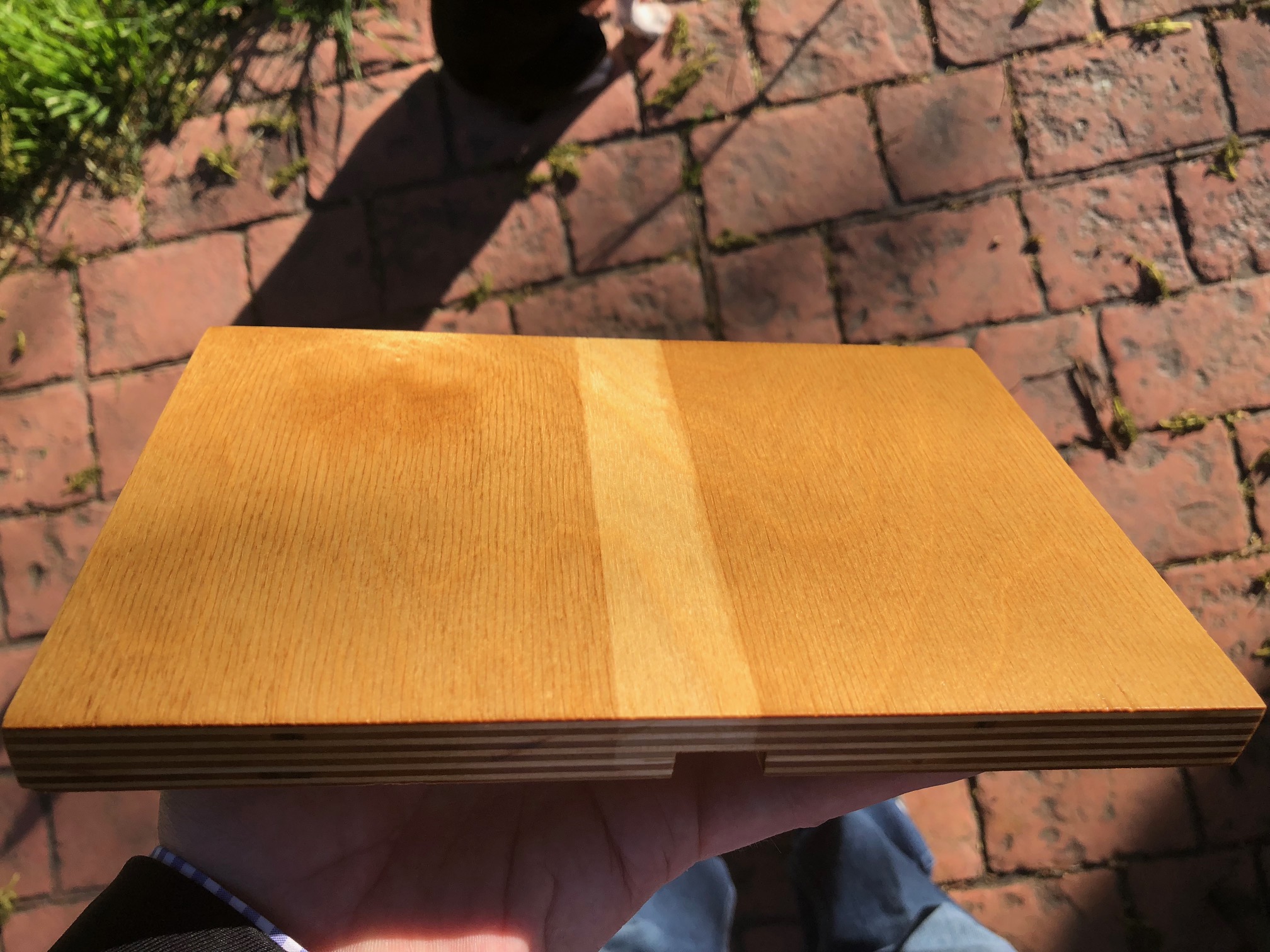

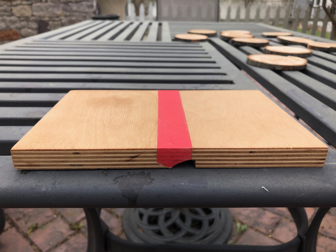

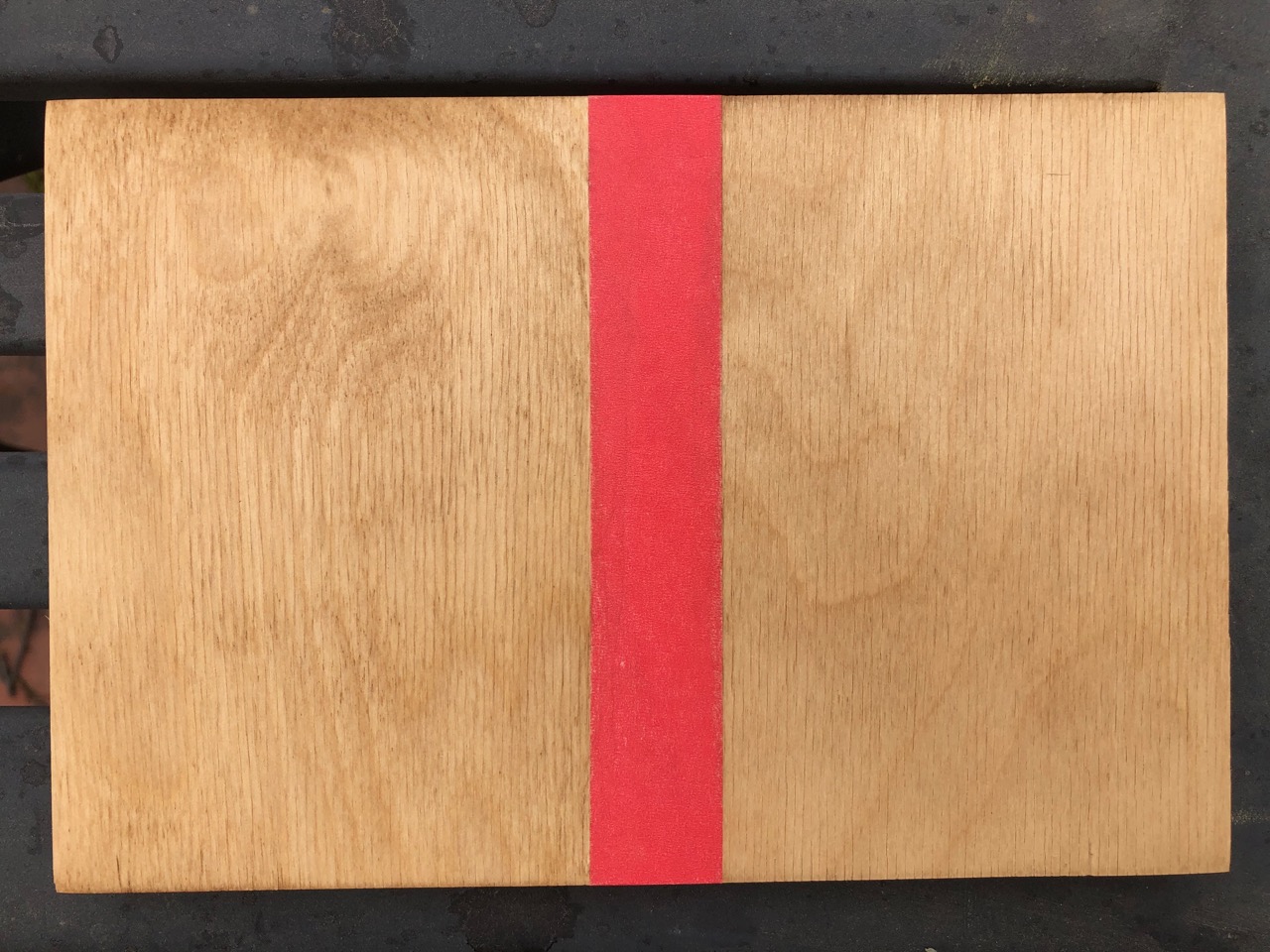

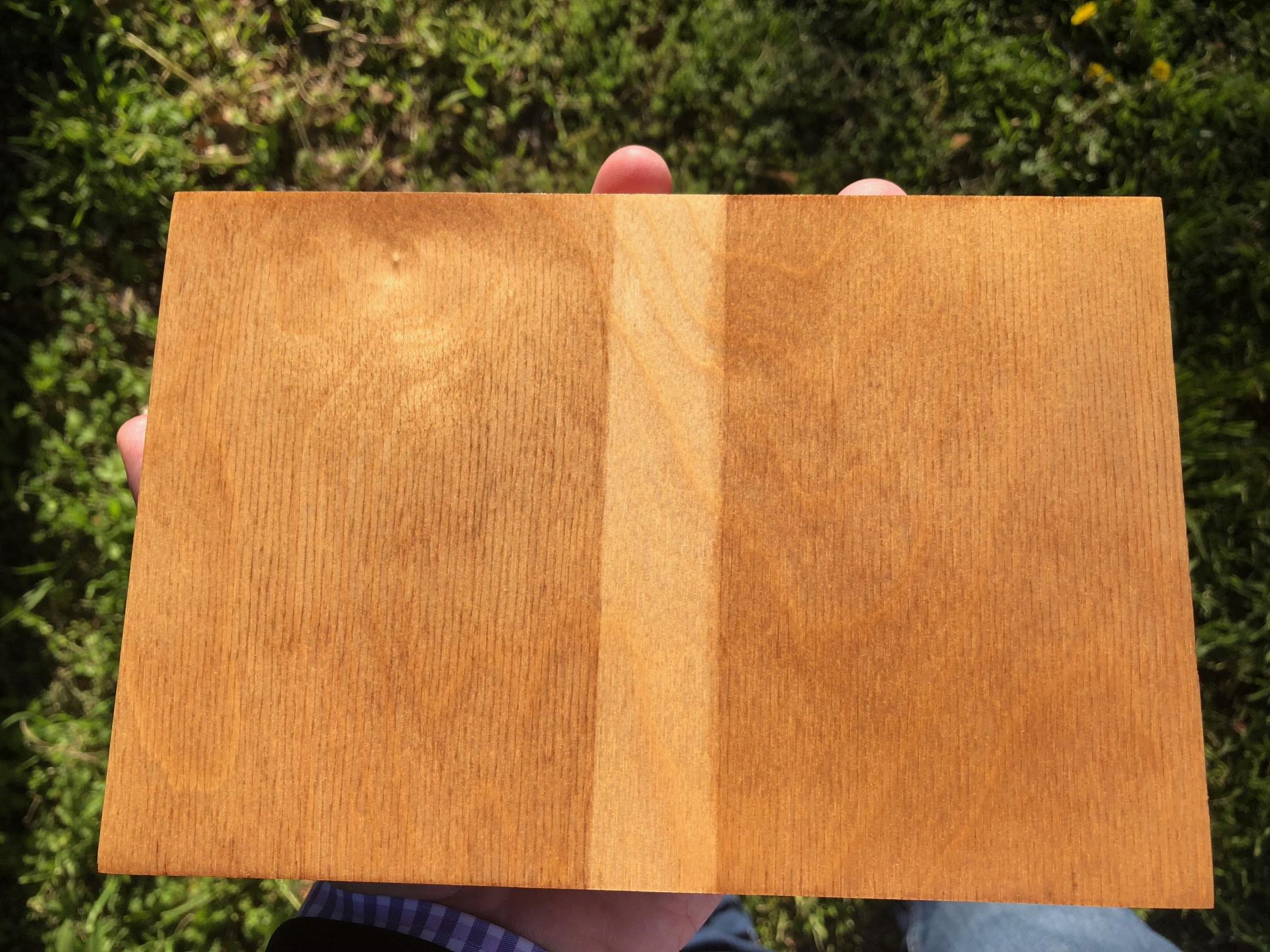

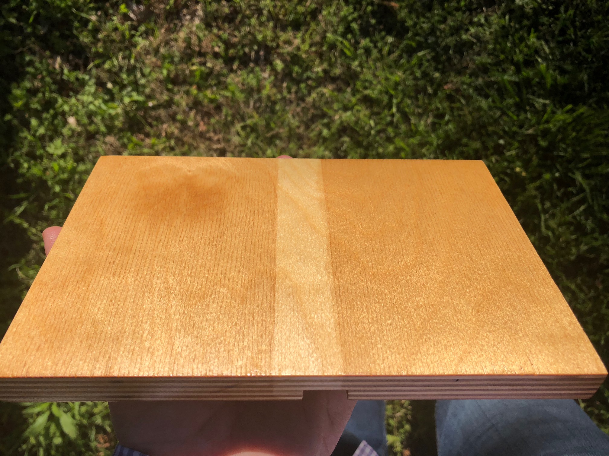

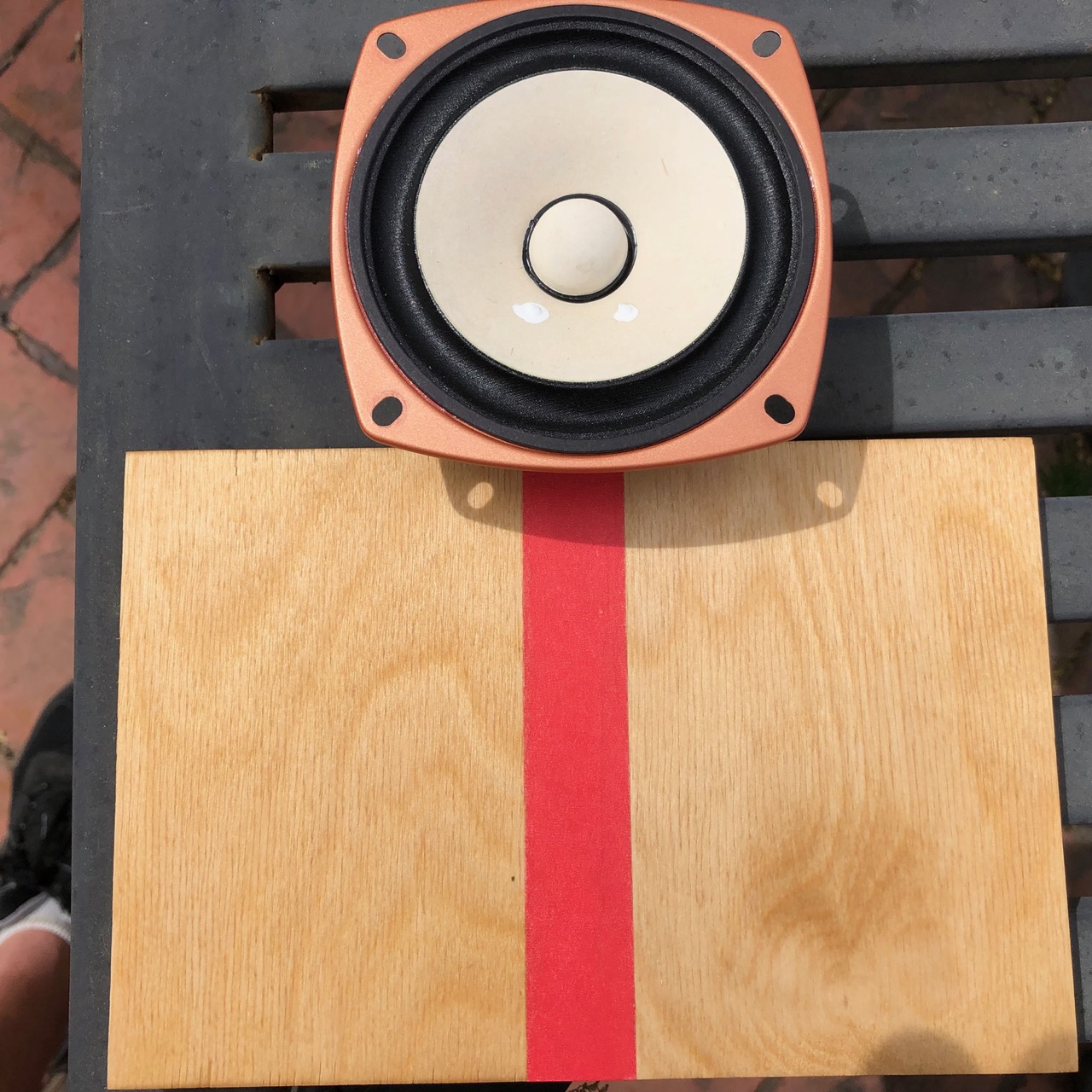

Curiosity got the better of me and I grabbed a piece of scrap and tried staining it with coffee. I like the results. It seems there are two ways that people tend to make coffee stain: (1) brew a strong batch of coffee (or instant coffee) and simply apply that to sanded wood, or (2) mix about 1/4 cup of used coffee grounds with 1-2 cups of vinegar, toss in some steel wool, and let it all brew overnight before applying. The first method tends to result in a light thin stain, while the latter flows on darker and more concentrated. In my mind's eye I saw this as light and thin, so what you see in the pics is the result of five coats of normal strength Trader Joe's French Roast.
The left side is treated with pre-stain (I know, don't mix oil and water), while the other was untreated (the sides are reversed in the pic with the driver). There's little perceptible difference except that the treated side shows the stress lines more and exhibits slightly more contrast over the coverage area. I like the even tone of the untreated side. It doesn't have depth like an oil finish, but I like the modern look and it goes well with the copper bezel and creamy cone of the FE103Sol.
The test piece currently has two coats of polyurethane that's curing in the garage. That turned it a slightly darker amber, and I don't think I'll like it. My instinct is to try the coffee stain with an eggshell or even matte clear coat that won't affect the color. Any products to recommend for that?

I just checked the test piece from yesterday. It looks better than I thought. Again, this is five coats of regular strength French roast coffee applied with a foam brush, with two coats of Minwax satin polyurethane. Doesn't have the depth or pearlescence of oil, wax, etc, but I like the color. I'd like to look for an eggshell or matte clear coat to try with this.
If I go with the coffee stain, I'd still probably need to veneer it with birch, as the vision in my imagination does not incorporate all the end grain at the chamfer. I'd have to cut hardwood faces for the vent spacers and sand flush with the veneer, if I want to go for that look. Seems like a lot of fuss to veneer something with the same construction material, just to make it look a little different.
