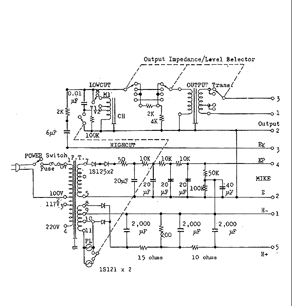

I'm just wondering if the same design rules apply to valve mic output transformers (say 4:1) as to se valve amp output transformers as far as the insulation between layers goes. Is the enamel /poly insulating enough with such small voltages to not require paper? And do they still need an air gap?
Please show the actual schematic.
IF said transformer is part of a miniature "power amp" and primary carries tube level voltages , it will need proper insulation.

AS shown, the 6uF capacitor blocks DC and there is a DC path to ground after it, so no DC on OT primary. Good.
No gain stages involved either, so voltages present will be "microphone level".
A big condenser capsule driving an ultra high impedance preamp as this one and picking up a floor drum hit hard WILL produce a HOT signal, but still microphone level, maybe 1 V or a little more, no problem as far as insulation is concerned.
Personally I would not try to hand wind one but use a good quality commercial one, think Jensen Transformers or better.

No dc so no airgap.
As far as i know yes same rules applies.

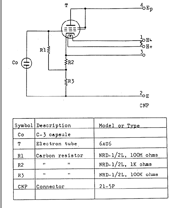

Hi , many thanks for the links . The valve will be 6au6 as per this model mic , and I'm going for an outboard in the first instance as my interest was aroused by people who'd owned one of these mics saying the mic ot was as big as a small amp ot , so I thought I'd try unwinding the primary from an old radio se ot having figured out the winding ratio , and rewind at 4:1 with suitable wire , just as an experiment - I realise it wouldn't compare with a Jensen etc.
6au6 might not be the 'best' choice as the original required very high b+ for a mic (270v iirc). Without an original capsule you'll have issue with capsule biasing. Better be inspired by the circuit and build one from scratch imho. I would lower B+ at 120v or 180v and capsule bias around 60v. As JmFahey explained you won't see anything greater than 1v at cathode follower input so the 120v b+ is more than enough in my view.
Any triode able to put a bit of current is a wiser choice imho, what matter for this kind of aplication ( mic) is that the tube is non microphonic ( the least possible) and it accept 'weird' grid current ( with 1g or more grid resistors for some circuit it is 'fringe' design) and low currents ( between 0,5ma to 3ma is the range for the circuits i played with- i found CF allowed a bit more current than grounded cathode) and the cathode to be 'non polluted' ( if you encounter intermitent popcorn noise, ploc,... it might be worth trying 'rejuvenating tube' as it will be unusable for mic circuit if the symptoms are presents anyway...).

Why do you want to use a 4:1 ratio?
It should be defined from the output impedance from your cf in my experience. But it is non critical ( tube circuits are forgiving).

I have a mic body , plenty big enough. I've been looking at subminis and that would seem a way to go if I want to do more with mics. This schematic has heaters rectified to dc and at 2/3 of B+ so I'll probably do the same to start with.

We don't try to "match" a CF. Here the Zout is about 2K pull-up and 100K pull-down. For BIG signals we would try to load in over 200K (not practical in wideband transformer). Since signals are a small fraction of supply we may not clip. We still want hi-Z to reduce THD, low-Z to increase output level (though this is rarely a problem). Higher current in the CF improves the electrical situation but cooks the poor diaphragm.should be defined from the output impedance from your cf in my experience.
Yeah, throw in 4:1 (3200:200r) and call it done.
... Higher current in the CF improves the electrical situation but cooks the poor diaphragm.
Hi PRR,
Are you talking in general or about the C37 circuit?
For C37 i see cooking of capsule could happen from the very high b+ (diaphragm could be 'sucked' to backplate) and indeed higher current means higher grid current leakage, so damage could come from this?
