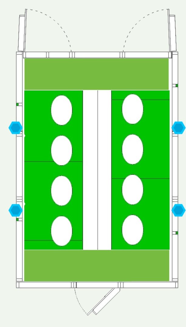

Hi all, extremely keen on building a tiny tiny listening bar. I’m a visual artist and intend to transform a tiny self built pavilion into a listening bar.
The purpose: set up the bar in exhibition spaces, collaborate with artists, dj’s to concoct weird drinks menus and musical explorations.
The place is already built: 18mm plywood room (floor and walls) with a paper/wood cassette ceiling, dimensions 220x330x230 cm LWH.

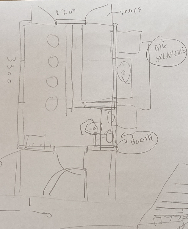

It will feature a bar and 4 fixed stools, and a booth for 2. (See plan sketch)
What isn’t there: the bar, sound system, drinks&vinyl shelves etc.
My skills: sculpting, wood.
My interest: building speakers (I like large speakers in a tiny room!), to set up a weird but also nice experience for visitors. Afterwards also building some more if it turns out well.
The speakers could be built into the wall, since there is space around the pavilion, like backpacks hanging from the wall exteriors.
Almost no budget, so looking for diy or assembled parts to build with.
Curious!

Do you want large speakers just for the visual effect or is there something else you're after? If you want very low frequency response at highish levels, that needs to be part of the design.
The room is very small, and the listening distance is short. SPL that would run you (or the workers) out of the room would be easy to achieve with relatively small speakers for midrange and up.
Some of this will also come down to what you prefer in general: horn loading, "full range" designs (single driver covering the majority of the audible range), multiway, etc.
Reactions: UnkleUncle

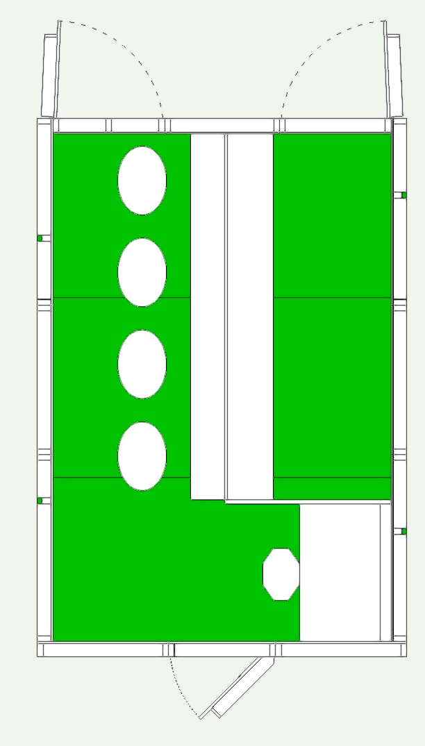

This is the space (18mm plywood on wooden frames, 2200mm tall). The “loveseat” by the door at the bottom won’t benefit from the greatest sound in any case, but I nevertheless want to squeeze it in!
I suppose the route of multiway w/ potentially low end placed elsewhere, can be taken?
Generally this is a good idea. As long as the cross point is low enough or the subwoofers are near the main speakers you should be OK.
If you want to use horns and a low power amplifier for the main speakers, separate amplified subwoofers are also handy. You can typically get high voltage sensitivity with reasonably sized midranges/tweeters, but in the low bass range things get massive if you want high sensitivity. Modern high excursion subwoofers with high powered amplifiers can be quite small and still produce very low frequencies. Many include built-in equalization features which are also nice.
Separate subwoofers might also let you build them into the bench, counter, or loveseat. Your description makes it sound like this is going to be somewhat portable, so the more you can build in and wire essentially permanently, the better. You don't want to have to dismantle and rebuild a bunch of stuff for each move. Of course things need to be replaceable also in case of failure, so that should figure into how you build and mount things.

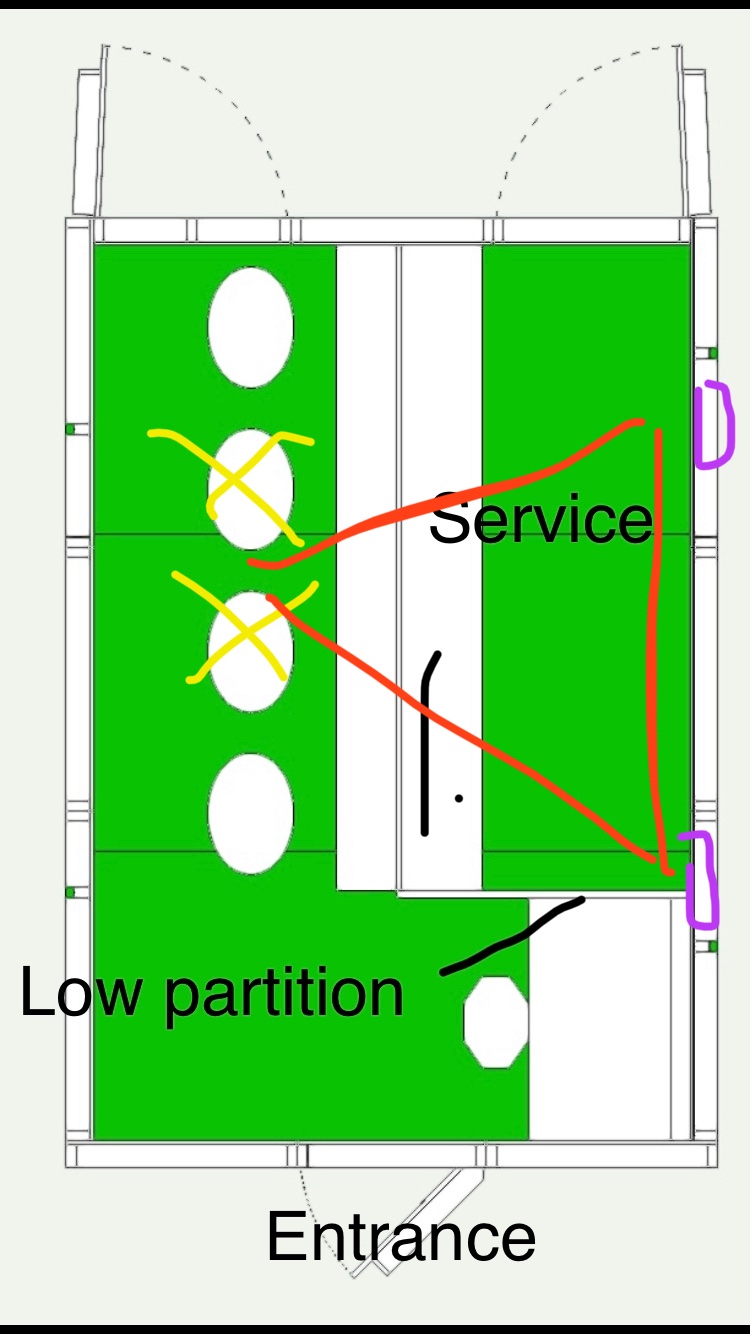

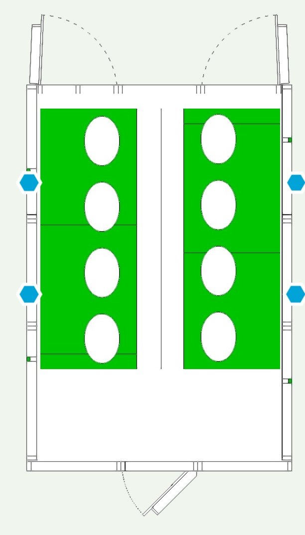

What about getting rid of the booth and having central bar, speakers on both sides and service, playback equip at one end or centre the array on the long axis as well and service from both ends?

That would mean building bass into the counter at a very low height 0-100cm? Does it not get obstructed by the actual guests sitting? Or behind them in the back wall?
I could build the speakers into cabinets that can be inserted in specific openings in the wall, and unbolt/take em out when dismantling.
In that case: the bass cabs could potentially be massive, since their backs are hanging out of the actual pavilion 🙂
I’m intrigued by the unity horn concept, especially since I love to build cabinets. How to combine w the bass and positioning.. 🙂
Hey!

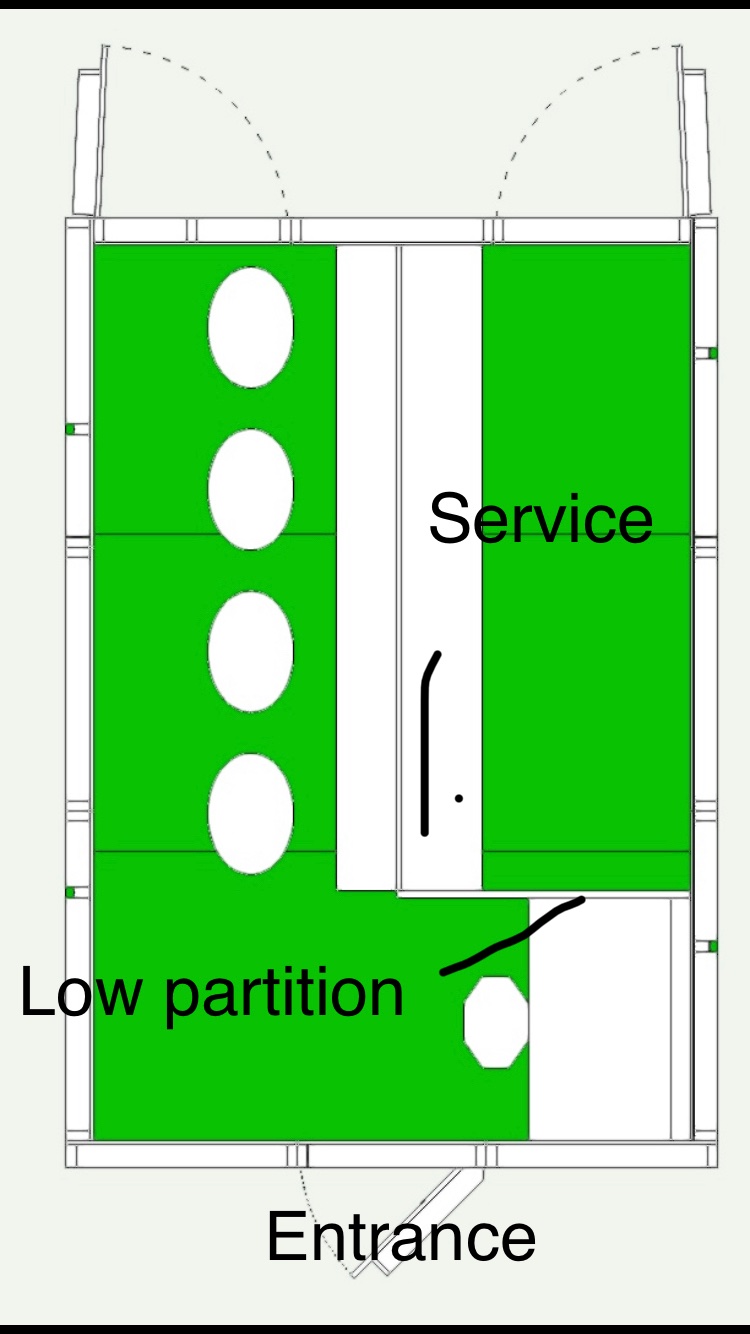

Well, entrance is at the bottom, and service on the right. I kinda love separation between the crowd and the barman, and the theatricality of these separate entries/exits. (the top left leads you into a large studio space and lets you discover the “backstage” of this pavilion)
So in a way the layout cannot be altered much. The loveseat is more of an idea coming from classic bars such as the Kärntner bar in Vienna by architect Adolf Loos. It’s a reference/sample 🙂
A low wall (120cm) isolates it from the service/bar area, so speakers can be above that horizontal marker anywhere.
Not to any significant degree, as long as you keep the cross point low. 80-100 Hz is the typical crossover range for subwoofers. Below there, the sound is omnidirectional and difficult to localize. As long as you don't significantly obstruct the speaker with a solid, sealed barrier, the bass tends to just go around any humans or minor obstructions. Down-firing subwoofers are a good example of this in home audio.

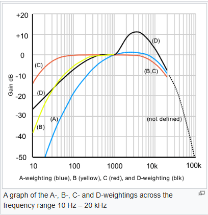

It depends on what SPL you are targeting in what frequency ranges and the distances from the speakers to each person. Hearing damage estimates and workplace exposure limits are normally based on A-weighted measurements. Ears are damaged more easily by midrange and high frequencies. Most people can take a lot of bass without trouble though.
https://en.wikipedia.org/wiki/A-weighting
The EU has a bit stricter regulations than the US for noise limits. Here's a snip from Google's AI summary on the topic:

In a case like this, I'd be inclined to set up 2 convenient speakers (of about the size you're considering) in the space and take some measurements while moving around and listening at your intended level. Once you get through some initial listening/placement tests, get another person in there with you and try to have a conversation from the various positions of workers and patrons with music playing.
