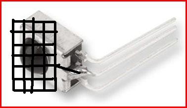

When I was trying to find why my Stage 2 wouldn't work with "learned" commands from other remotes I 'scoped the output from the IR receiver and it was permanantly "noisy" with odd random changes in output 1-0-11-0-10-1 etc, although that didn't effect the operation with the original remote.
I added a 10uf tantalum cap across the supply pins to it on rear of PCB and added a grounded wire mesh over the front of the IR sensor... which I got from another old IR receiver I think... that's an old technique.

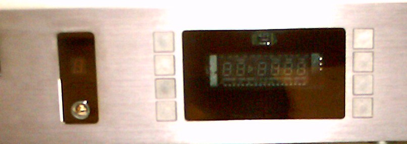

It's behind a really dark window so even with flash it's hard to see. Just above the display.
Can you give me some picture of this?I added a 10uf tantalum cap across the supply pins to it on rear of PCB and added a grounded wire mesh over the front of the IR sensor... which I got from another old IR receiver I think... that's an old technique.
That thing with grounding wire helped but still reacts on other remotes, and its less sesitive...Today I found this :
