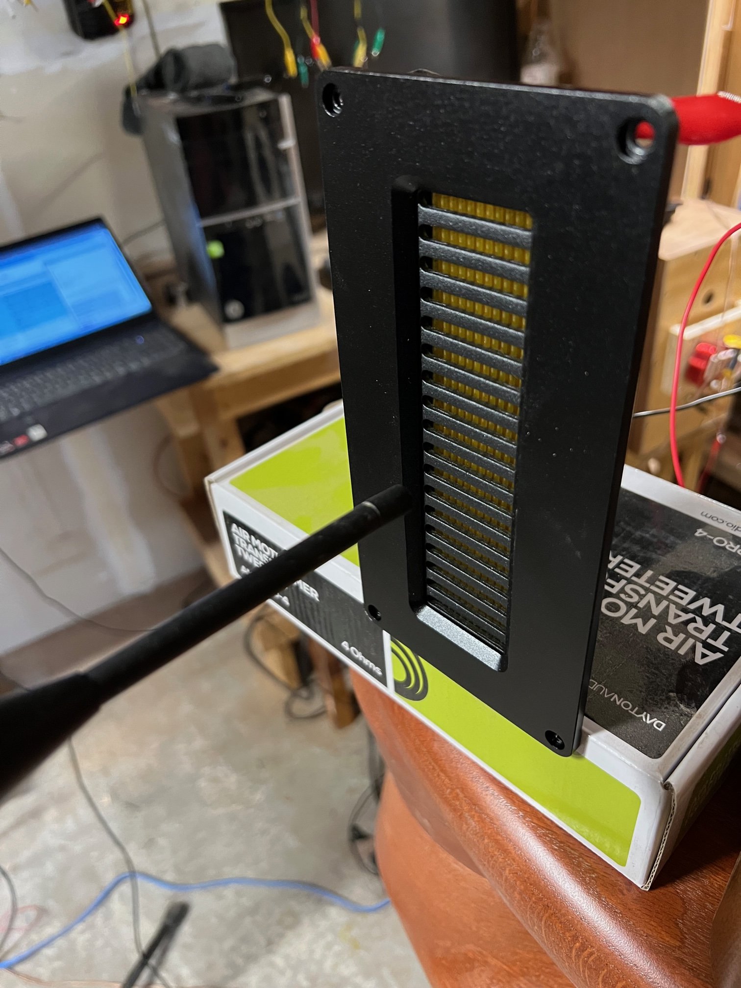

I would like to share my latest blog where I test microphone distortion between four different mics.

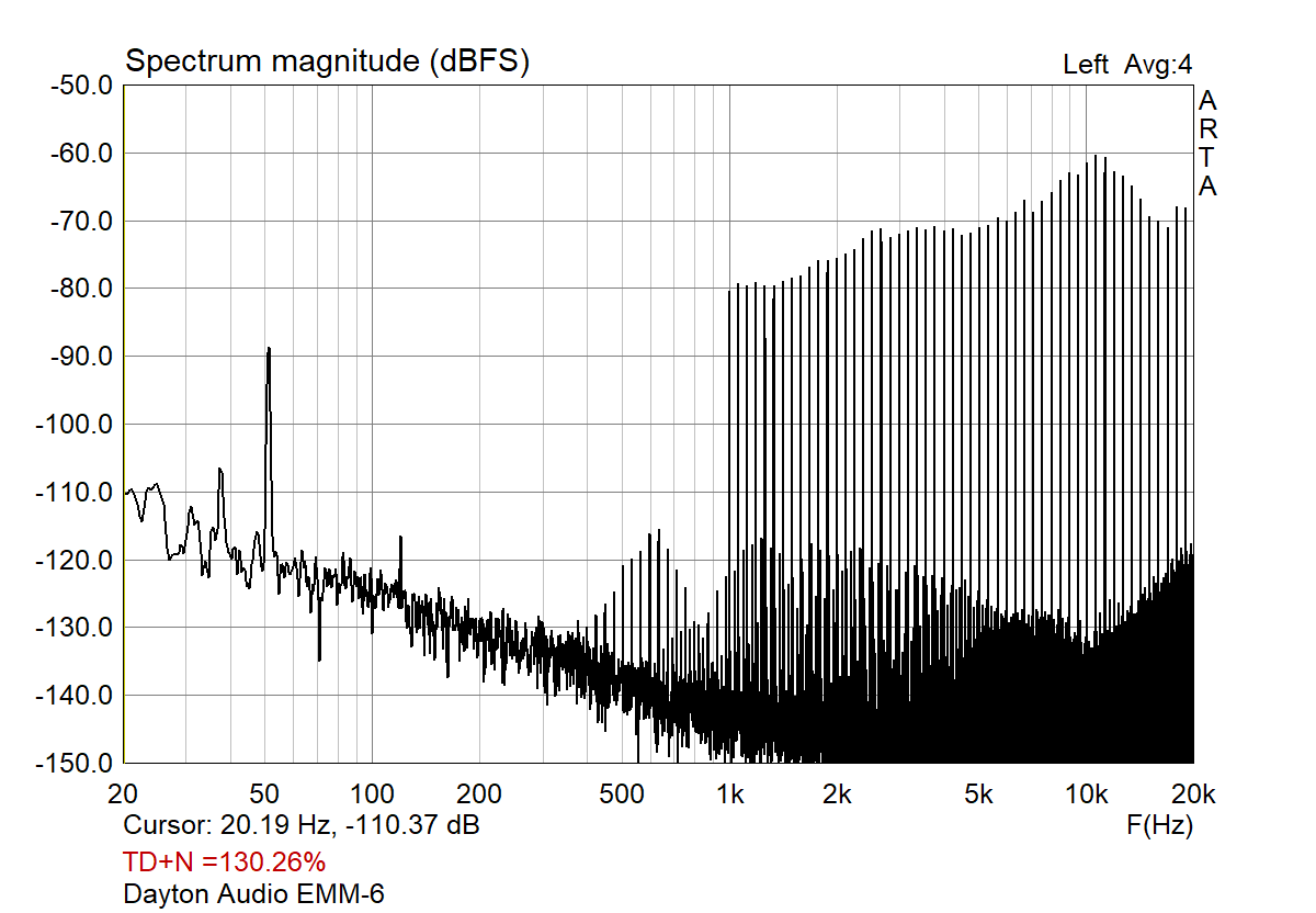

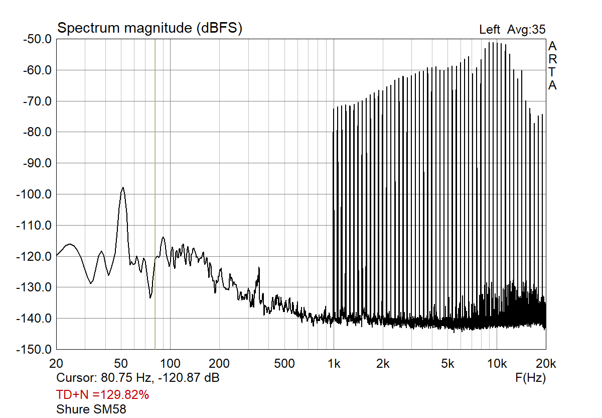

Joseph,
In your blog you wrote:
"To interpret the results I compare the peak of the test signal against the black "grass" in the noise floor. The grass represents the intermodulation side band products. Normally this would be generated by the loudspeaker, however as we shall see, it is actually the microphone."
I can see a higher black noise floor on the two Dayton mics compared to the AKO Pacific 7052 and SM58, as well as their higher "grass" level relative to the lower grass level above 1kHz.
Having read through to your concluding remarks, I don't "see" how the microphone IM side band products been actually isolated from those generated by the loudspeaker.
Could you explain?

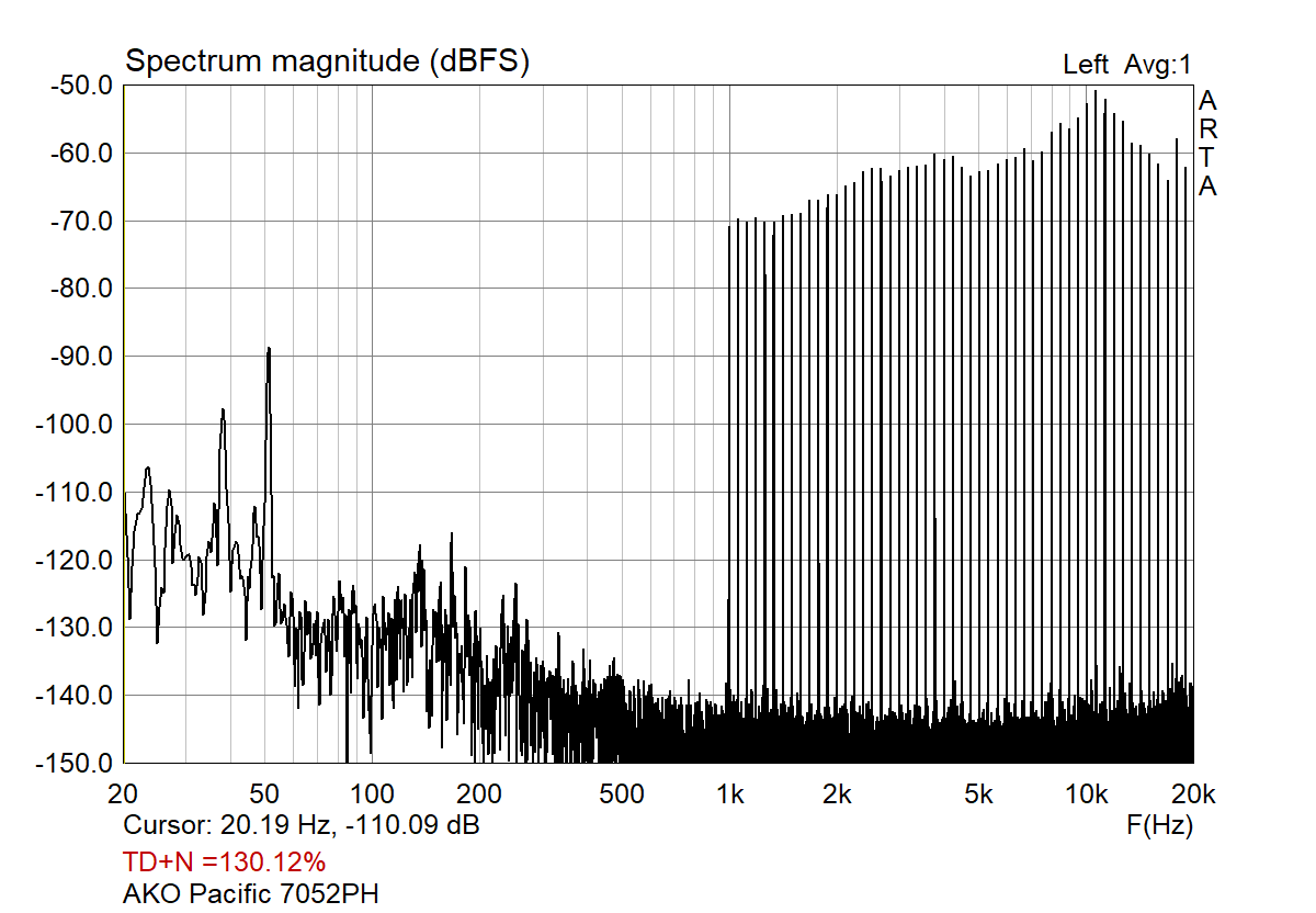

yes where is driver distortion and where is mic? For AKO pacific case it’s unclear. To see which part distortions dominate you could by changing mic distance to driver
The test involved simply swapping out the various mics while all other test parameters remained the same including the test signal. Any change in the IMD is a result of the mic quality. I did a lot of testing with various tweeters and levels to come up with a test setup that provided a low distortion loudspeaker as a source which allowed me to do a test like this. Otherwise loudspeaker distortion would dominate and I would not see a difference in the microphone's performance. There are other ways of testing microphones but this seemed to do the job well that was easy to display and demonstrate.Joseph,

Understand , for higher distortion mics its ok.but for the mic with lowest distortions you still don’t know is this drivers or mics distortions you seeThe test involved simply swapping out the various mics while all other test parameters remained the same including the test signal. Any change in the IMD is a result of the mic quality. I did a lot of testing with various tweeters and levels to come up with a test setup that provided a low distortion loudspeaker as a source which allowed me to do a test like this. Otherwise loudspeaker distortion would dominate and I would not see a difference in the microphone's performance. There are other ways of testing microphones but this seemed to do the job well that was easy to display and demonstrate.
If you increase the distance, and the distortion is unchanged, it must be the source. If the distortion falls with distance and reduced level, it is the microphone
Correct 👍If you increase the distance, and the distortion is unchanged, it must be the source. If the distortion falls with distance and reduced level, it is the microphone
I had speakers with AMTPRO-4 and in my measurements it is not speaker with lowest distortion.
Had you made measurements with less frequencies per octave? Now it seems test signal can mask actual distortions and result is mainly mic noise levels comparison.
AMTPRO-4 had significant THD but it is not visible on your measurements.

I tested a variety of tweeters for IMD before settling on the AMTPRO4 because of its performance. I did not however look at harmonic. I will be doing a full test on the AMTPRO4 in the near future so I will look at harmonic. It’s possible that H2 rises quickly at higher SPL with H3 and H4 remaining low, that’s what I’ve seen from other tests. I’m not sure about the subjective offensiveness of this.I had speakers with AMTPRO-4 and in my measurements it is not speaker with lowest distortion.

Electret preamp noise does not seem to be affected by input level. It’s just this consistent fixed noise at, for example, -65dB against the test signal level input. So moving the mic away is not a valid test. This is something I discovered in the last year. Keeping the mic close, however, does help improve S/N against environmental noise.Correct 👍

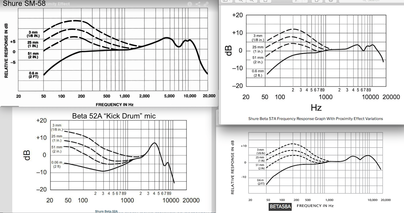

Dynamic cardioid mics such as the Shure SM-58 have a proximity effect that varies the amount of low frequency with distance, as well as "presence peaks", an rolled-off low frequency response.So can the SM58 be be used as a loudspeaker measurement mic ?
Those features make the SM-58 a popular vocal mic, but a poor measurement mic regarding frequency response.

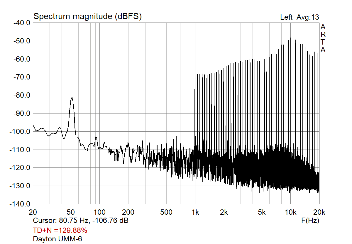

Although placing a mic closer to the source improves S/N relative to external noise, the increased SPL also results in increased harmonic and intermodulation distortion in the microphone response.Keeping the mic close, however, does help improve S/N against environmental noise.
That said, the Dayton Audio EMM-6 maximum SPL for 1% THD @ 1000Hz is 127 dB, the Dayton Audio UMM-6 maximum SPL for 1% THD @ 1000Hz is 135 dB while the 7052PH can take 150 dB SPL @1% THD, so no surprise to see the inexpensive electret condenser mics exhibiting more distortion, even at the relatively low (around 110+dB SPL at 5 cm) test levels.

Indeed they have. In fact any microphone that is not omnidirectional has proximity effect.Dynamic cardioid mics such as the Shure SM-58 have a proximity effect that varies the amount of low frequency with distance, as well as "presence peaks", an rolled-off low frequency response.
