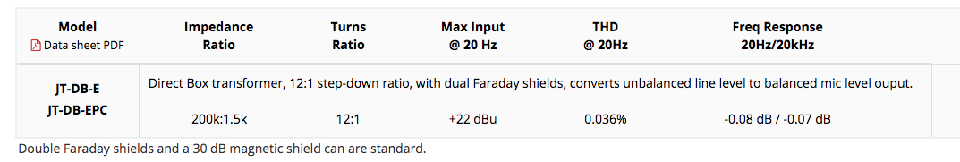

The 10/1 ratio of the transformers you bought should be similar to direct box transformers, though may not handle the voltage as well, you get what you pay for, specs and Mu metal shields that can match a Jensen usually cost more:

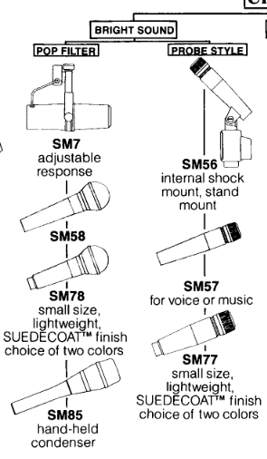

Few people remember the 28% lighter "Starmaker Series" SM77 and SM78 introduced around 1980 anymore.anyone have any info on SM 78?
i don't want to say that Mr Welter is wrong but i've never heard or come across that model before.

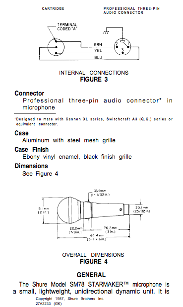

They are listed in the 1981 Shure catalog:
https://www.musikding.rocks/index.php?file-download/13515/
I was surprised that Shure evidently was still making the transformerless SM-78 as late as 1987:
The "internal connections" show the direct connection from the cartridge to the XLR.
In 1989, the SM77 and SM78 were no longer listed in the Shure catalog..

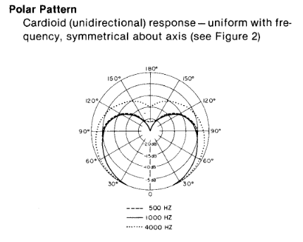

Those three mics all have cardioid (heart shaped, unidirectional) not dipole (figure of 8) patterns:So far it's Shure WH20, SM10 / VR230 style dymanic headset microphones. These are dipoles, as they're clearly vented on the back side and pickup sound from both sides, each being 180 deg out of phase from one another, of course.
A dipole picks up equally on either side, many studio recordings are made with singers on both the front and back of the diaphragm, but not on the sides, where the null is located.

i did find it amongst the discontinued archive on Shure's website. there's no mention that it's transformerless, which you would think would merit a mention,no?

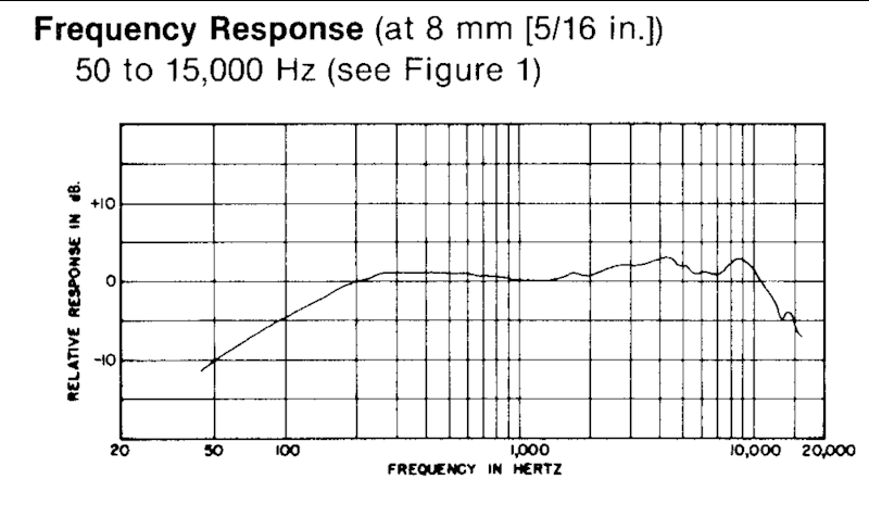

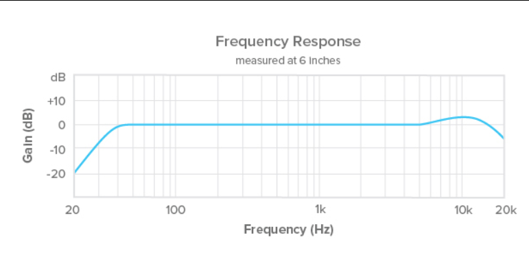

those headset mic's the SM10 and WH20 have upper mid boosts and tailored low to deal with extreme close proximity effects and less than adequate placement problems. i can't see them making good acoustic guitar mic's.
What I'd always assumed about these mics, without a high-Z output... But along with other assumptions, not the case.The "internal connections" show the direct connection from the cartridge to the XLR.

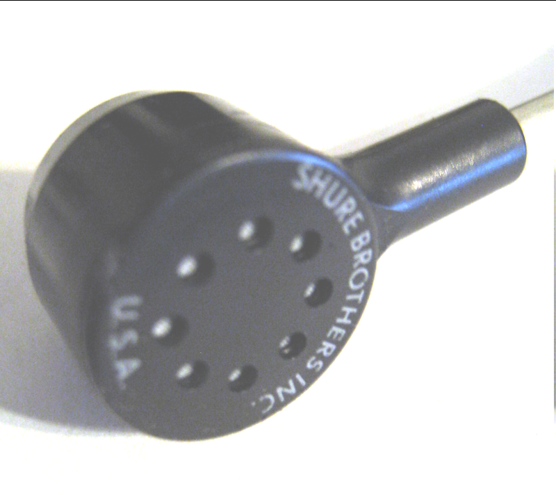

Unsure why they spec Cardioid. The holes in the back, right at the null or 180 around from the front screen; if you speak into them, sound comes through. Not as sensitive as the front side, but not zero by any means, as it would be if that side were solid plastic. Basis of that assumption there. Similar to their electret version of headset, where both cartridge and capsule inside had these vents.
+2.5 @4k and 8.5k? I suppose...

The placement of the holes behind the diaphragm make the mic a cardioid.Unsure why they spec Cardioid. The holes in the back, right at the null or 180 around from the front screen; if you speak into them, sound comes through. Not as sensitive as the front side, but not zero by any means, as it would be if that side were solid plastic. Basis of that assumption there.
If the back was sealed, the mic would be an omni.
If the back was open, the mic would be a dipole (figure of 8 pattern).
