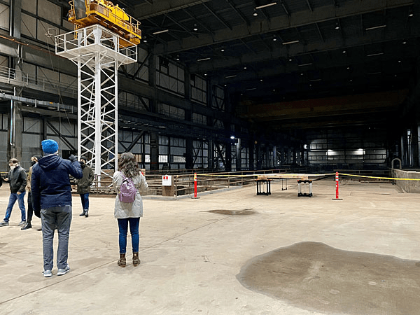

As large as possible with the speaker/microphone group centered in all dimensions of the room. In practice, gating/windowing of the signal will be necessary to eliminate sound reflections from room surfaces. This is quasi-anechoic measurement. You should read about it thoroughly. Basics are discussed here: https://www.stereophile.com/features/103/index.htmlWhat should the room be like for speaker measurements?
Outdoor measurements are another possibility if you don't mind dragging all your equipment outside, if it's quiet where you live, if you don't have neighbors that will get annoyed with it, etc., etc.
For a funny extreme example of room size, an old power plant building is handy
https://www.stereophile.com/content/nwaa-labs-measurement-beyond-atomic-level-page-2
"NWAA's free-field room is the size of four football fields—so large that there's no need to gate impulse-response measurements."

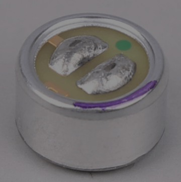

I had just purchased the Panasonic WM-61A, should I refund it?Sorry but this advice about directional microphone is the worst you can give for measurements.

I don't know this capsule so can't say if you must refund it or not.

It's an electret so should incorporate a preamp making it less sensible ( preamp have lower output z).
Buy some isopropyl alcool ( 99.9%) to clean flux and solder residue and work with nitril gloves, it should do.

If this is a genuine WM-61A, you have a treasure beyond price as these were the most reliable and consistent 6mm electret capsules. They were used in Measurement Mikes from early Behringer ECM 8000s to $$$ Earthworks.I had just purchased the Panasonic WM-61A, should I refund it?
audioimprov.com/AudioImprov/Mics/Entries/2017/12/13_A_Simple_Reference_Mic.html
shows how to make a P48 version which will almost certainly be flatter than an ECM 8000.
The theory behind it is at https://groups.io/g/MicBuilders/files/Ricardo/SimpleP48
You have to join.
If you don't have p48V phantom power, you can do this but you need a mechanical arrangement similar to Henry's XLR so you can hold it in a microphone clip & stand. But the P48 version has MUCH better performance.I had plans to use a 2.2kΩ or 10kΩ resistor and a 10µF capacitor
