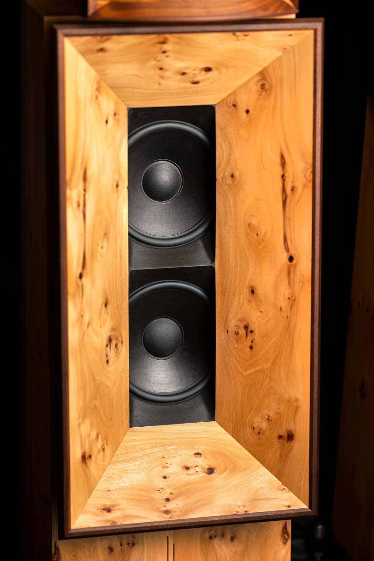

After auditioning the Blumenhofer Grand Goia at an audio show, I've been researching these kind of speakers. Speakers with some kind of horn/waveguide on the bass section.
I hope somebody can answer some questions I have about these.
What is the effect of these kind of 'horns'? Are they there for directivity control, improve efficiency or both? Or something else?
In some of these designs, a part of the driver is covered by the mouth of the horn. I don't question there is a good reason behind it, but intuitively, it doesn't make sense to me.
Don't you lose Sd, efficiency, SQ like this?
What are the rules/formula(s) to determine the size of the mouth of the horn, or what portion of the driver to cover?

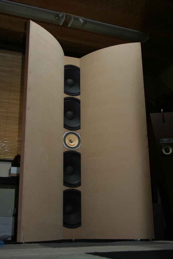

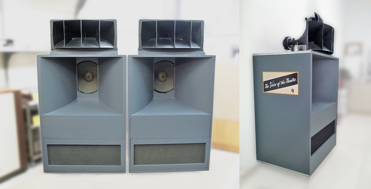

Do you mean like picture 1 where the bass drivers are covered at the horn throat, or like picture 3 where the tweeter horn mouth casts a shadow over the bass drivers?
These are nice examples of front loaded horns with vented chambers.
I've been reading about these recently and want to try and build one (80Hz - 600Hz).
I'm a novice and slowly learning HornResp. I had the same questions and this program helped me understand more than reading, changing the various parameters of horn size, driver, chamber and then viewing the expected results.
They are for directivity control and improve efficiency to frequencies above the horn cutoff.
The port vent is tuned to compliment (match) the horn loaded portion, extending the drivers range.
Partially covering the driver is fine when crossover point is low enough. If crossover is higher (above 1kHz or so) there would most likely be phase plugs in front of the drivers.
As for rules, don't believe there are hard rules. Size of horn mouth, depth of horn, choice of driver all factor into your target frequency range.

This concept was also used in the Altec VOT, apparently using woofers specially designed for high compression ratios. The main reason being efficiency.
In the linked article, there's this:
"The bad news about this is that very low bass extension was not possible, because with a bass horn, the lowest possible frequency was limited by the horn’s exit width. Once the wavelength becomes wider than the horn exit, the response precipitously drops."
That would mean if the exit of the horn is say 1m, frequency would drop rapidly at 343hz. Sounds very high to me, any thoughts?
https://audioxpress.com/article/altec-lansing-s-voice-of-the-theatre-speakers-what-you-need-to-know

The altec horn loads to around there then transfers to being a direct radiator…..
Jbl cabs that are similar shaped, their own graphs show the same thing.

The boxes in the first post and, from what I can gather from info on the Altec VOT designs, are reflex boxes with a horn added. I don't know if the port is the only reason these have decent bottom end, but all of those do a good ~50hz
