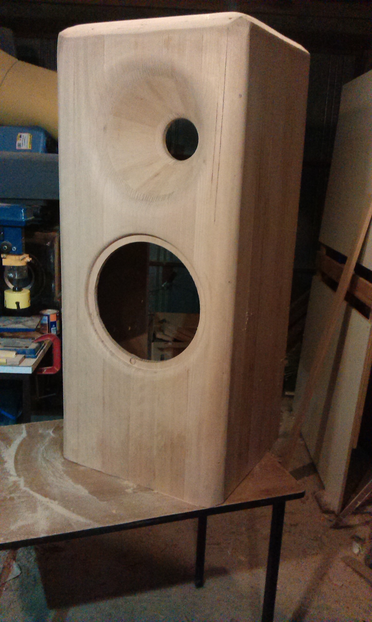

This was built around an Ikea item SEKIN Serving bowl, birch and 4" drivers. The TC9s might be better.
http://www.diyaudio.com/forums/atta...7d1448710816-horn-fast-timber-imag1174-1-.jpg
Again, baffle layout like this = best with a DSP, for delay.

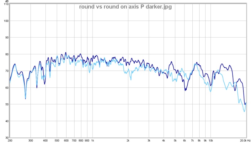

http://www.diyaudio.com/forums/atta...conical-horn-round-vs-round-axis-p-darker.jpg
dark blue = P Audio
pale blue = Fostex
dark blue = P Audio
pale blue = Fostex

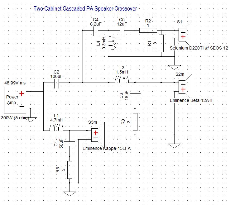

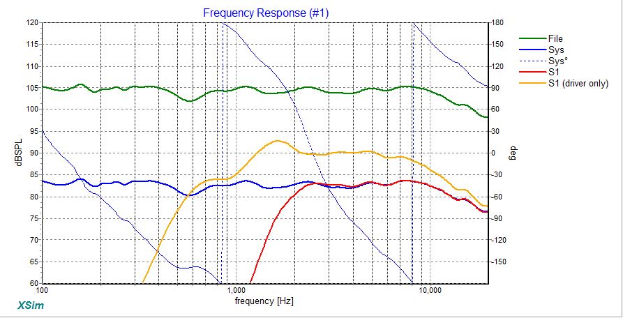

I don't mind CDs here a pic of my Selenium D220Ti w/ SEOS 12. It's measured, over raw, over sim in Xsim.
That's way more patience / skill with crossovers than I have.
