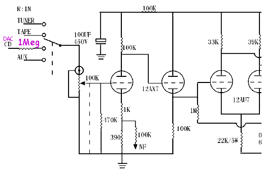

Hello all,
I've bought second hand integrated amp MingDa MC-34A. It sounds good, but it have way too much gain... I'm even below 9 o'clock on volume control in normal listening levels.
Can somebody please give me advice, how to properly lower gain in preamp stage? Schematics attached.
Just lower 12ax7 100k plate resistor to 47K? Or maybe even omit second 12ax7 stage completely?
Thank you in advance 🙂

Don't change the circuit, you need all the stages.
Do you have test equipment? Lowering the NFB 100k resistor to 15k should do it,
but you will need to add compensation for stability to prevent oscillation.
Otherwise, you can just add a resistor from the volume control wiper to ground.
Choose the value so that the normal listening level is around halfway up.
Try starting with 5k.

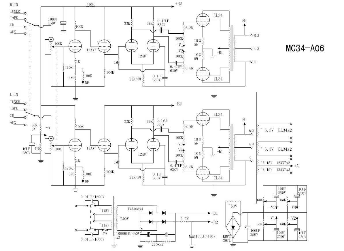

Increasing feedback by a factor of 6 will be severely testing the quality of the OPT. However, if it is good enough you might be able to make it stable with some compensation.
That amp circuit shows two common shortcuts; why do commercial amps save a few pence on components yet expose the user to future problems?
1. There should be a coupling capacitor between the volume pot wiper and the first grid. This reduces pot noise and lengthens pot life.
2. There should be a safety resistor by each bias pot so when the wiper lifts off the track the output valve still gets bias and doesn't overheat.

Replace the 12AX7 with a 12AU7. That will reduce the gain of that stage from a possible 100 down to about 19.

Jon, the 'X7 voltage amplifier is inside a GNFB loop. So, inserting a 'U7 there will not work. The NFB resistor pair controls the closed loop gain, provided open loop gain is sufficient.

DF96: Thank you for pointing me faults of design, I'll put coupling caps there. What value of safety resistor do you mean?

There is much to criticize on this amp. I think it was designed by dartboard. Implied input sensitivity of 62mV is FAR too high for most systems. The bias pot allows you to dial bias down to *zero*, which would be disastrous. DF96 makes good points.
If you are "stuck" with this amplifier, accept it and adapt it.
You can't trim the NFB much. Actually I am not sure it even has NFB. The first stage has 1K in cathode so gain is like 25; 2nd stage is SE long-tail so gain is like 8; gain of 200 to this point. The final stage has gain from one grid to 8r speaker of like 0.57. Gain from input to speaker is like 114. NFB network ratio is 100K:390r or 257. There is not enough gain to satisfy the NFB, nominally. So all the NFB can do is limit the rise at bass resonance and treble rise. It may be a fair guitar amp, where we *want* the speaker to be "loose", add tone to the sound.
The actual input sensitivity is like 0.16V. This was not an uncommon figure for older systems and their analog sources. However a straight DAC directly outputs up to 2V, and modern recordings fill that up all the way. You may have 10 times the gain you really want.
(BTW: we do not "painfully amplify DAC signal". It comes out of the digital bits already at high voltage, from 2.8V or 5V references. The post-DAC stages are typically unity-gain filters, not boosters.)
I have a raw guess that the 100K NFB resistor could be 22K without instability. That is *assuming* it is even wired correct phase; the other sloppy-bits suggest they had little idea what they were doing. (It may be 100K because anything less caused PFB and howled, and they didn't know why.)
Short of some major re-build, _I_ would just pad the input. The 100K volume pot is not so very high. We can just add a series resistor.

For a bias safety resistor use something like 10 or 20 times the bias pot value. Connect from bias pot wiper to bias negative supply rail. You will then need to adjust bias.

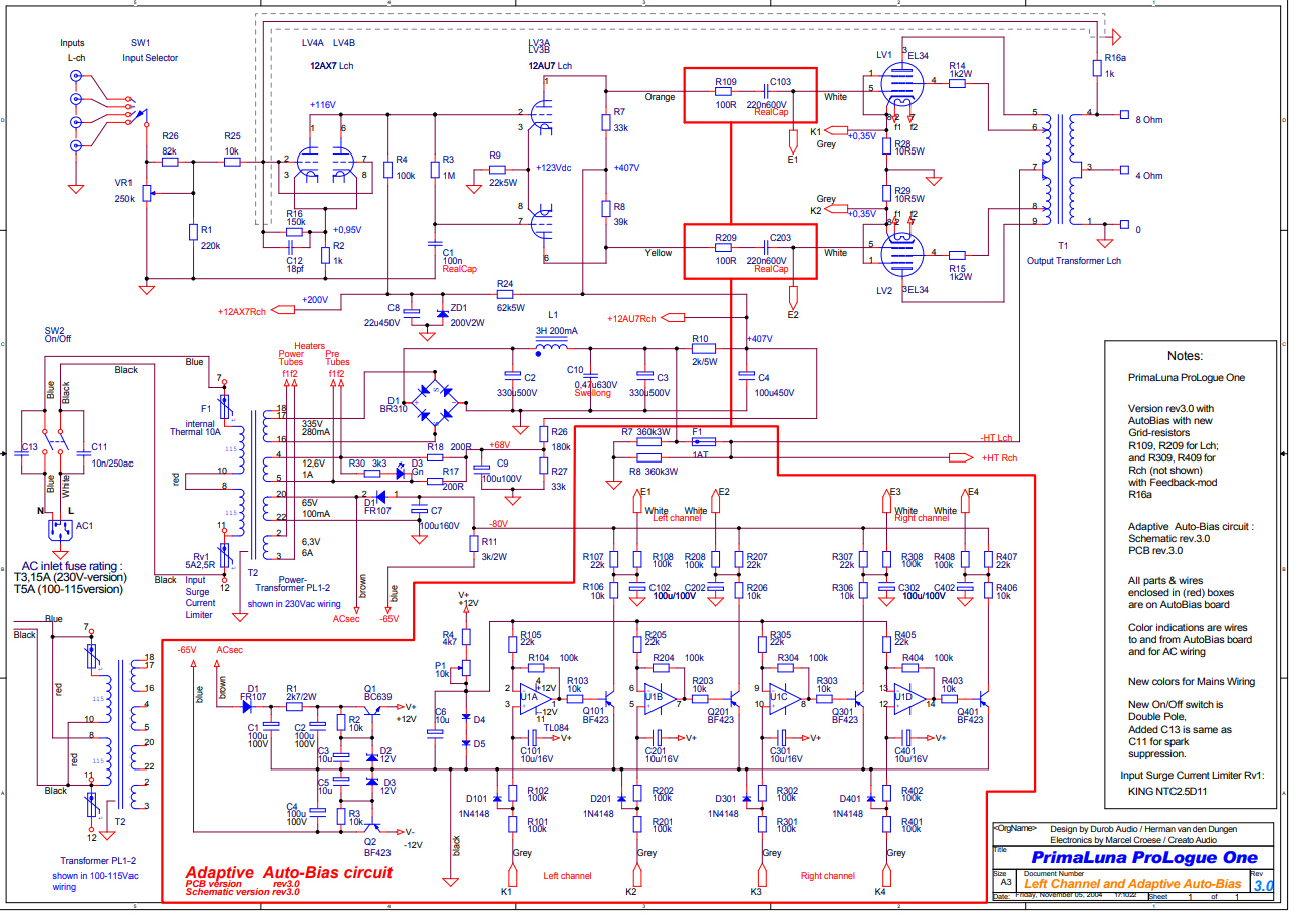

The published sensitivity of the PimaLuna is 300mv and the Mingda is 200mv.
I have the version of this amplifier with the preamp output. I am not happy with the sound. I plan to put it on the bench and check/adjust the output tubes bias.
Can someone comment about replacing the 12ax7 with 5751 tube? If I did this would I need to adjust the feedback?

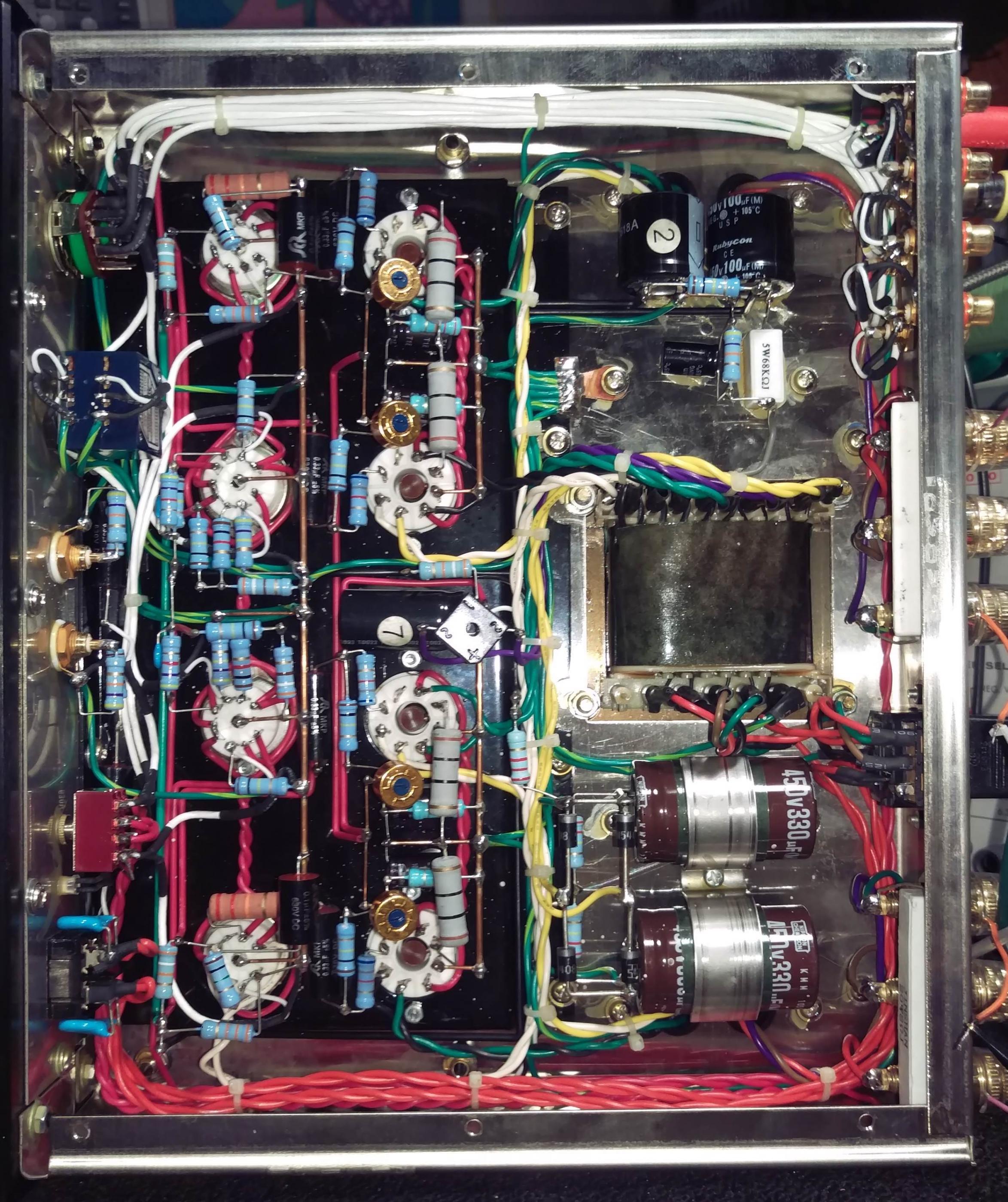

I opened up the Mingda MC34-A-2000 chassis.
The output tubes bias was off more than 15ma between tubes in each pair. That may be part of the reason I was unhappy with the sound. Only a few minutes of fiddling with the grid pots and each pair matched within 0.1ma at approximately 42ma.
I put it on the scope. A 300mv input produced 28 volts peak output on the 8 0hm tap to a load resistor at 30hz, 1khz, and 20khz. At 20hz the waveform began to distort badly at 15volts peak. The 100 watt load resistor measured 8.8 ohms so ~44 watts single channel driven.
I put a 100k ohm pot in parallel with one of the 100k ohm NFB resistors. I adjusted it while viewing the output on the scope. And then tested without load to see if it would oscillate. I settled on 22k ohm in parallel with the 100k ohm NFB resistor. I reran the power tests and got the same full power with an 800mv input level.
Next I subbed in a pair of 5751s for the 12AX7s. As expected sensitivity went down to 875mv for full output. Everything else seemed the same. Nothing about the sound was noticeably different out of the one cheap speaker I used for the test. I put the 12AX7s back in.
