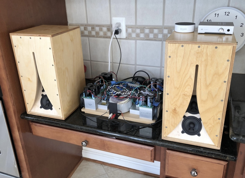

Edit Jan 16, 2021: A beautiful example of dual 3FE25-16 Karlsonator by Ripson. He went all out and covered them with repurposed antique pine from a barn and made grill too:

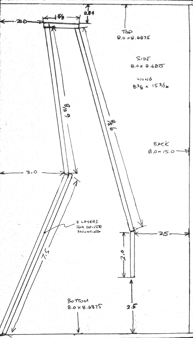

Edit: Feb25, 2018 - New "Score and Fold" CAD plans of 0.53x Karlsonator by Mudjester in metric and English units! A huge thank you to Mudjester for making this very comprehensive planset - one of the best I have seen ever!. These plans are in 1:4 scale in case you want to print out and use a ruler to measure and scale. Thread discussion here.

Edit (Apr 29, 2015): Latest 0.40x K'nator Score-N-Fold Plans by Mudjester available here: https://www.diyaudio.com/community/attachments/0-4x_karlsonator_plans-pdf.1027626/

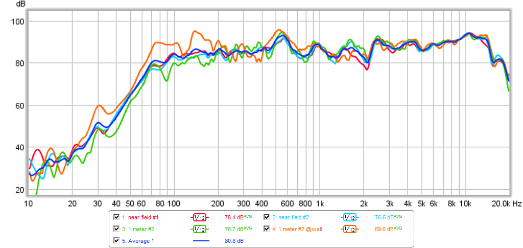

0.53x with PA130-8:
474550d1427659994-mini-karlsonator-0-53x-dual-tc9fds-0.53x-knator-pa130-8-photo-k.png
Here is the measured response of the PA130-8 in the 0.53x (at 0.5m with speaker in 29in high stand) - the red trace. Note that scale is 5dB/division and this is gated to 4ms and 1/48th octave averaging. The performance of about +/- 3.5dB is very good for a K aperture and good for many speakers in general:
474642d1427700312-mini-karlsonator-0-53x-dual-tc9fds-0.53x-knator-pa130-8-phase-0.5m.png

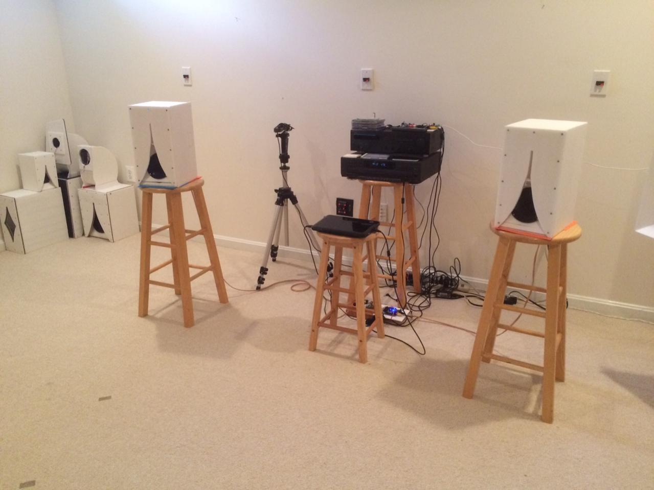

In stereo as a stand-mount speaker the imaging is fantastic and with a wide sweet spot afforded by K aperture:

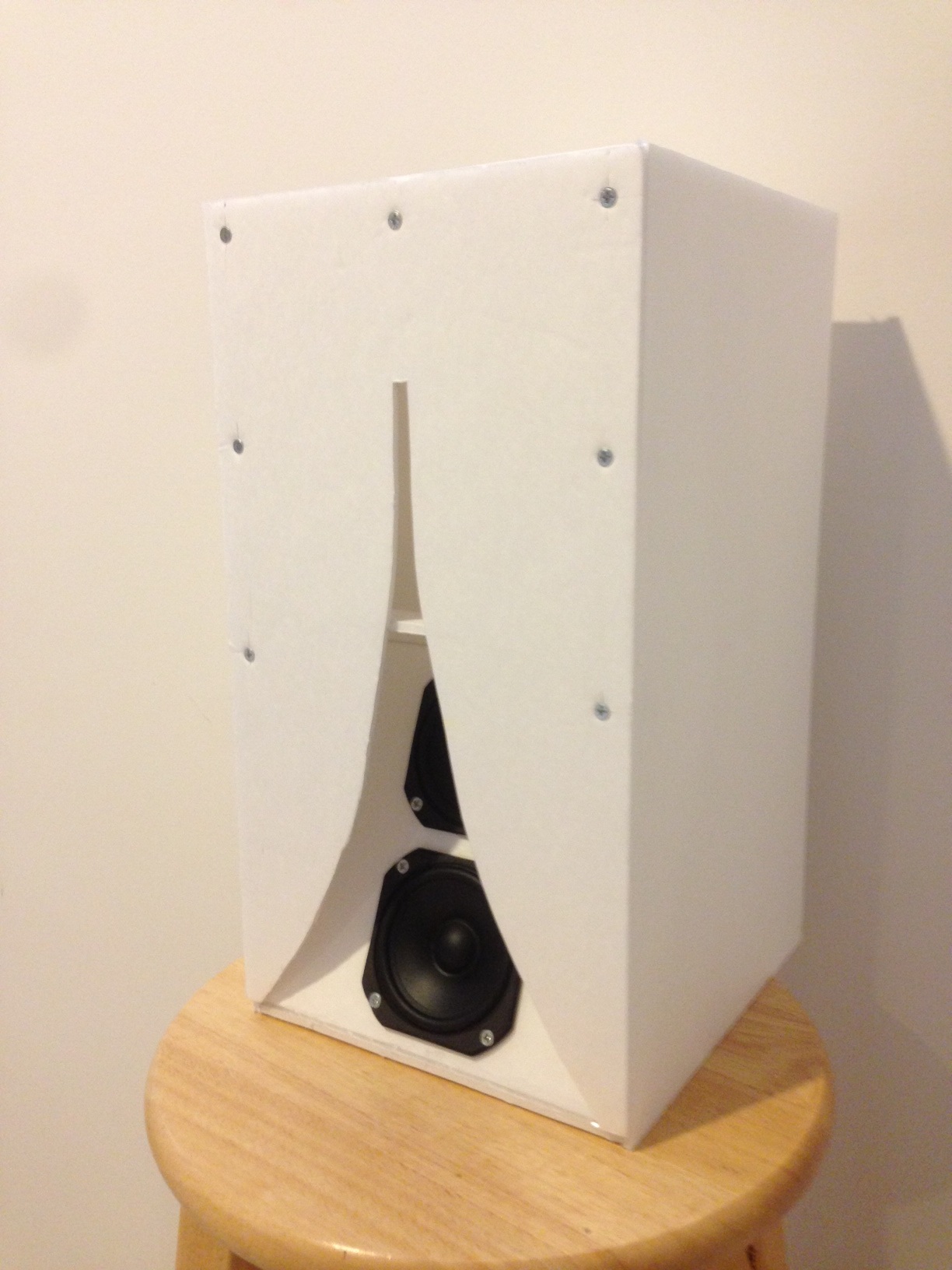

Here is a photo of the 0.4x
Here is the predicted response of the 0.4x with a single TC9FD with 2 watts power and listening near field at 24 in (on a desk for example) and a wall located 5 ft away.

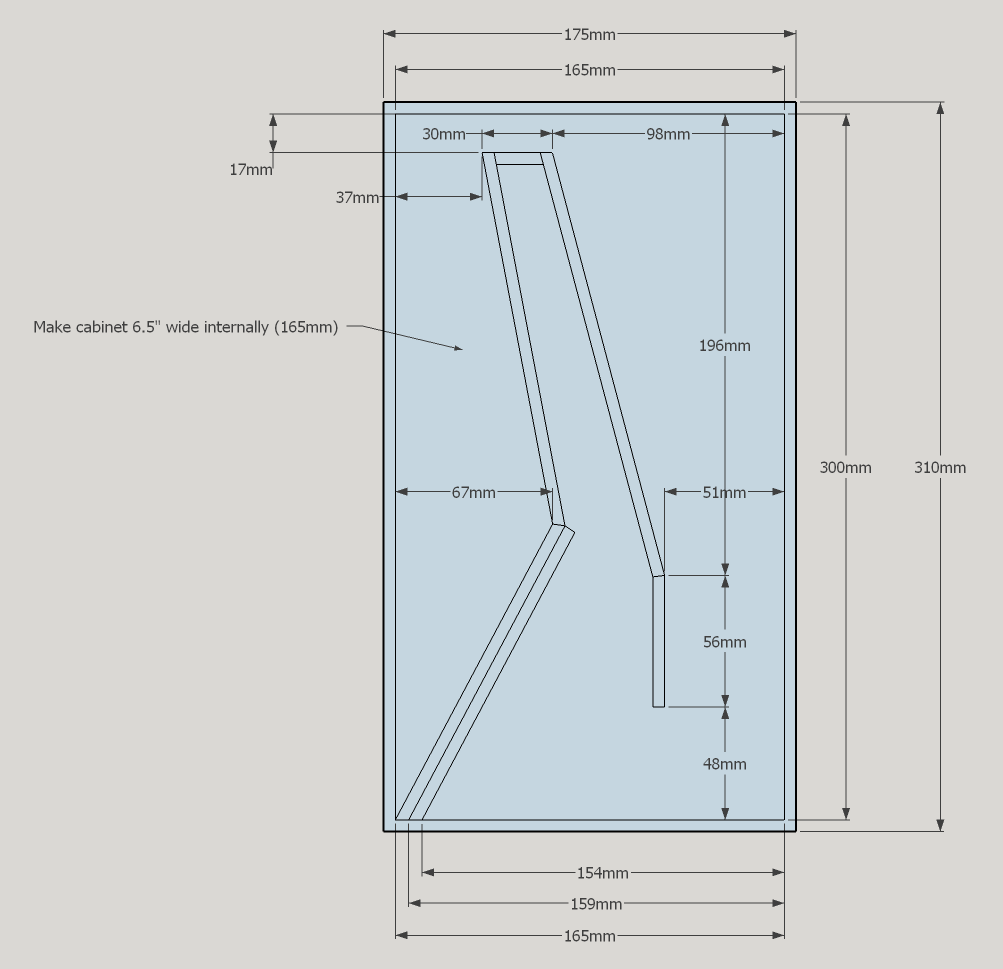

Edit: Sept 18, 2015 - Plans for 0.44x tall x 0.44x deep x 0.55x wide K'nator for FE103SOL or FE103/RS 40-1197: https://plus.google.com/photos/1005...6195254979670171890&oid=100545049816297868412
Here is the post showing details of the build process for a Score & Fold 0.4x:
http://www.diyaudio.com/forums/full...onator-0-53x-dual-tc9fds-115.html#post4139973
Post 198 has a nice CAD drawing of the dual driver 0.53x plans by Tb46.

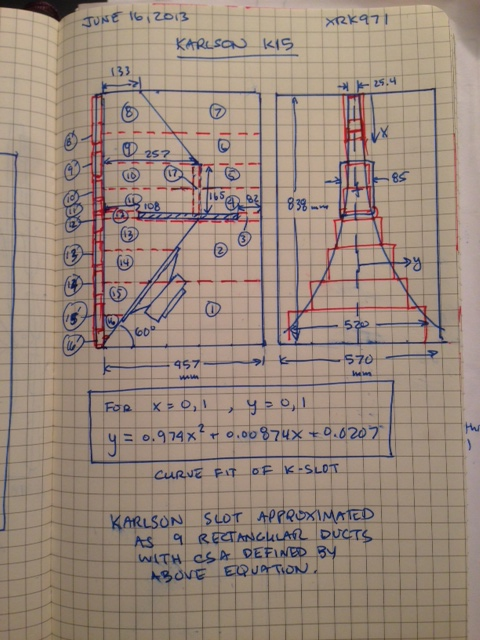

I started this idea in the Speaker that Kicks Butt thread here:http://www.diyaudio.com/forums/full-range/237948-speaker-kicks-butt-large-spaces-19.html#post3553874 , and found that the speaker I built worked so well, and there has been interest shown by others for plans and construction details that I thought it deserves it own thread. I have to give credit to GregB who designed the Karlsonator (full scale) as this speaker was simply scaled down in size by approximately 0.53X to accomodate the dual drivers on a vertical orientation. The Karlsonator original plan can be found here:
https://lh3.googleusercontent.com/-...ABik/txissf4J4PI/w678-h524-no/Karlsonator.png

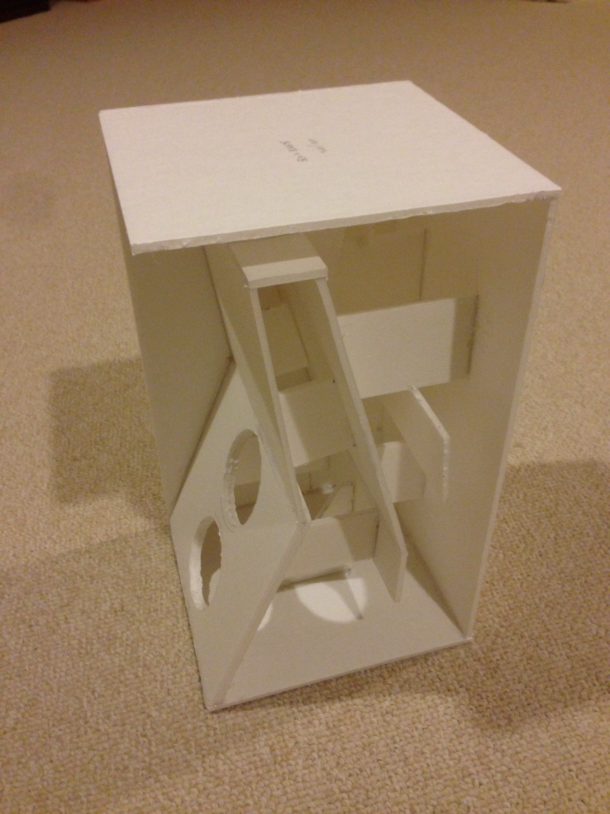

This speaker could be built out of plywood certainly, but as a foam core build, it was very easy to make (about 2 hrs) and is a very cost effective great sounding speaker. If you are familiar with my work, you will notice the recurring commonality: the Vifa TC9FD driver. This is a great sounding inexpensive little driver and I was surprised that it works in this type of enclosure given that it is relatively high Qts. I would not have built it had I not simulated it in AkAbak first (http://www.diyaudio.com/forums/full-range/237948-speaker-kicks-butt-large-spaces-19.html#post3553874)
The initial sim shows a nice punchy bass shelf down to about 70 Hz:
358812d1373293761-speaker-kicks-butt-large-spaces-karlsonator-8x-dual-tc9fd-freq-3m.png

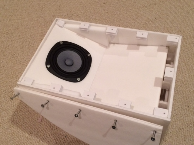

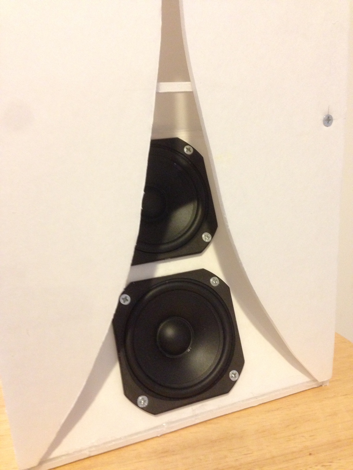

I then proceeded to build it in an evening, and it was quite a fun and easy build that can be done with exactly 2 sheets of $1 foam core board from the dollar store.
Here is the finished speaker:

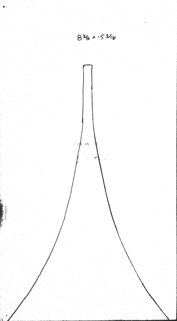

The plan, optimized for standard 20 in x 30 in x 3/16 in thick foam core material looks like this:
And when I plugged it in and turned it on, WOW! Even in pseudo mono (left channel to top driver and right channel to bottom driver) I was just amazed at the clarity, depth, and naturalness of the sound. The bass was tight and punchy, and easy - not strained. The sounds from vocals was just wonderful, and bass guitar and bowed double bass just had a very natural presentation. The other thing I noticed was that the speakers were very efficient (that is quite loud) with very little cone movement compared to some of the other cabinets that these Vifas had been in before. I immediately just loved the rich natural sound. It works very well with classic rock like Dire Straits as well as female vocals, and jazz. So you may wonder how it really sounds, well I recorded some sound clips and zipped them so they can be uploaded here. Check them out and see for yourself, they are recorded with a Zoom H4 with XY mic at 3 meters away and stored on pretty lossy 128 kbit format so that I could fit them into the max file size limit. The full size files sound even more amazing.
I highly recommend this build, as it sounds great, is inexpensive, easy to build, and gives you the unique opportunity to experience what a Karlson type speaker is all about. I would not have gone about doing this had it not been for my extensive modeling and simulation of a Karlson, which led me to see (on paper) the unique capabilities: wide spatial dispersion, high efficiency, natural lifelike sound, punchy bass.
I will continue this thread with a build log of the second speaker box so that I will finally have a stereo pair and I will document the build process for you to follow.
I hope you give it a try - you will be pleasantly surprised, and you will have a unique speaker that can be used for a variety of purposes. It excels as a table radio in pseudo stereo for great background music that fills the room with a rich full lifelike sound.

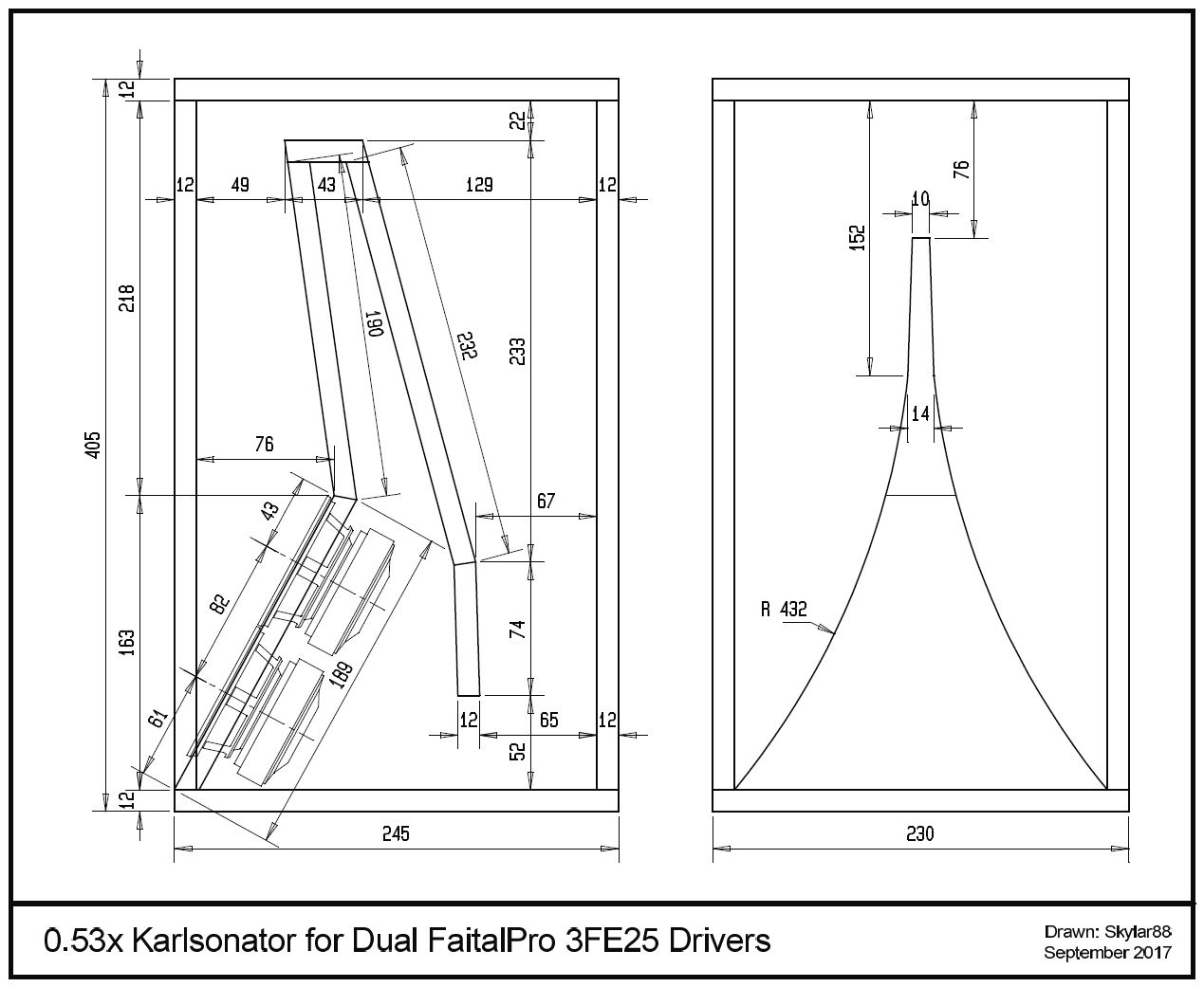

Edit (Aug 23, 2018): Skylar made some nice 0.53x dual 3FE25-8 plans here:
http://www.diyaudio.com/forums/full...onator-0-53x-dual-tc9fds-286.html#post5523965

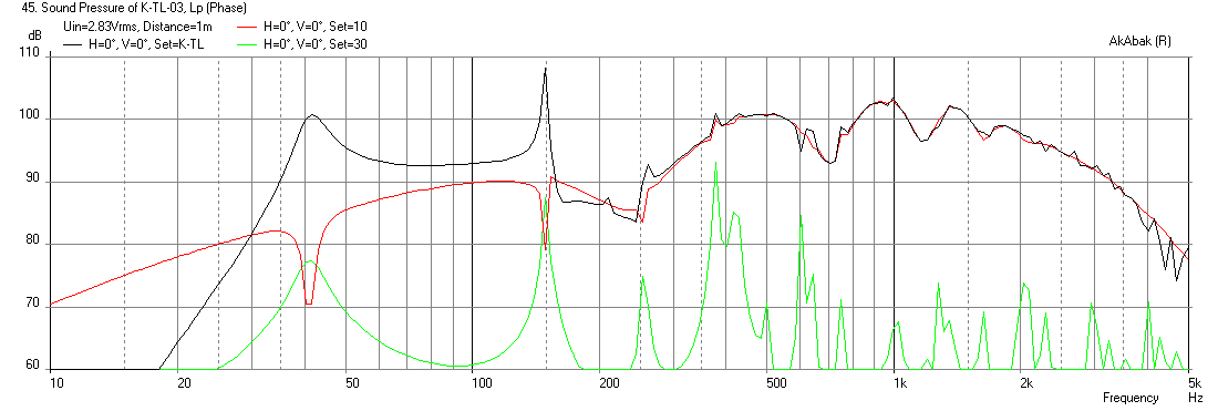

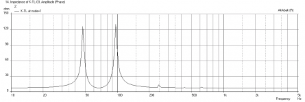

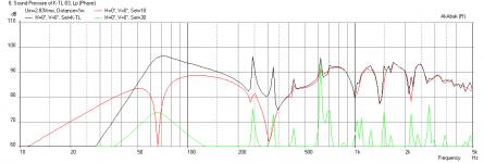

Bob,
Hey glad you are on board! 🙂 I will run a sim of the Aurasound - you will probably only need one, unless you want a larger box for two. This cabinet is very forgiving with a variety of drivers. One thing with the NS525's is that they don't have much of a top end, and you need that to balance out how powerful the bass is on these guys. Although you can do what you did with the DNA Decware horn and add the tweeter on top. That will let you experiment with a K-tube attached to your tweeter, which I have heard sounds really good. Can you send me a couple of those Vifa's while you are at it? 😀
As reported, I agree the NS525 is an exceptional value but needs help on top. I would lean toward just one of those because I suspect two would require the 1/2" foam to avoid excessive bracing. That's not really a bad thing, but being able to get really good base using the standard thin foam core is what makes all these projects so special.
Watch your mailbox for the free Vifas, and if they don't show - just keep watching.:whazzat: 😀
Next FC challenge: a 3x3 array of TC9F in a 12:10 Karlsonator scale-down! 😀 (works out to a ~10" if adding Sd)
Doing a serious build and trying to get a fair balance of bass extension versus cabinet bulk, I'd probably go with GregB's suggestion on the Fullrangedriver.com forum and use a Fostex FF165WK. It would need some help on top though.
IG

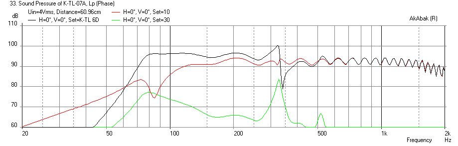

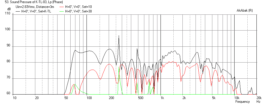

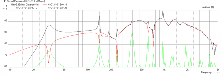

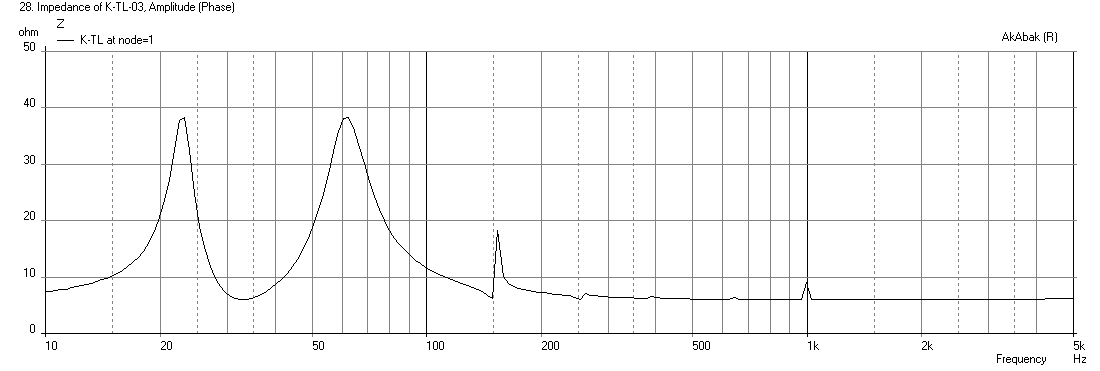

0.6X Karlsonator with Single NS525
It looks like it can work if you scale cabinet up to 0.6X (9/15). There are some big dips though as you get farther away from the speaker. Up to you...

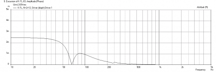

First plot is 1 m, second is 3 m, third is impedance (a little high - may be a problem for amp), last is cone displacement - seems well controlled.
Go for it! 🙂

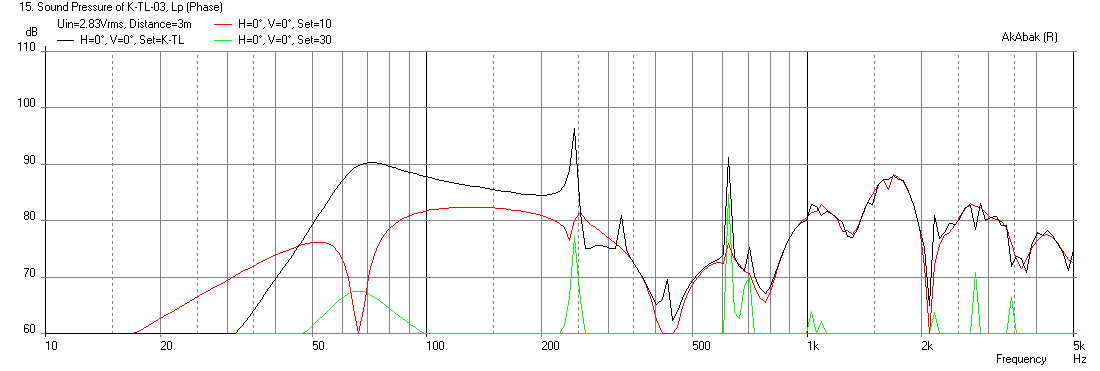

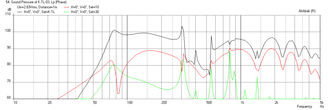

Bob,
If you want some deep bass and want to go with the NS525, scale the top channel by 0.25X (sounds very small) but still manages to produce 90 dB at 40 Hz. And to top it off, the flat bass shelf goes all the way 250 Hz. That is pretty wide bandwidth for any speaker. To hear the low string on a 4 string bass will be pretty cool, all the way to 250 Hz.
Here is the sim.

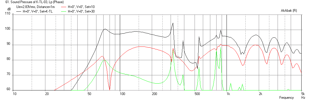

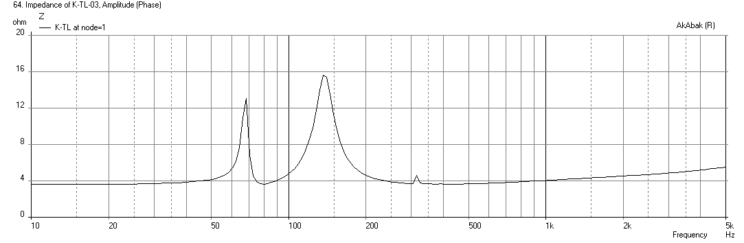

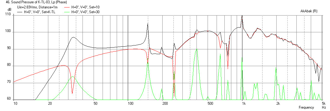

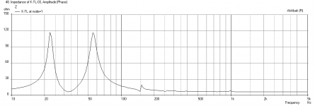

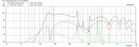

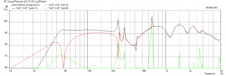

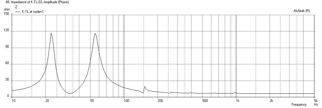

Hi xrk971,
I have a few drivers on the shelf that might be of interest in a Karlsonator: the Fostex FE206e (8" NOS) and Aurasound NS525-255-8A (5.25" @ Madisound for @3.60 ea.). Would those show any promise in a simulation? Also, could you share the section of your AkAbak script that describes the front chamber/coupling slot? I cannot figure out how to enter that into AkAbak.
TB46,

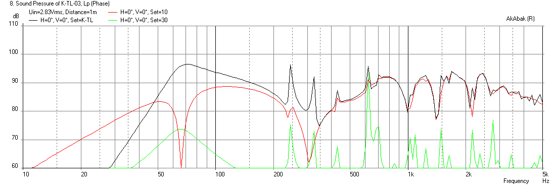

The NS525 is posted above. The sims for the FE206E are below. First plot is full size Karlsonator with 1.0X scale on top channel. Next plot is with 0.35X choke factor to bring tuning down - it reaches the 30 Hz range. Fourth plot is impedance and last is displacement of the cone. It looks like it can work but may sound bright or 'shouty' as some people call it.

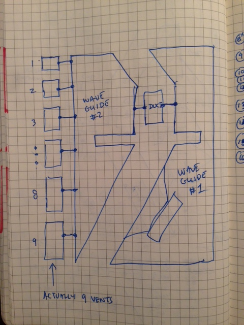

Not even a hint at how the script needs to be arranged? 🙂 I guess that's the hint.
TB46,
I can help you with how the script goes, I just didn't have time. It is described in earlier posts on the Karlson thread here (http://www.diyaudio.com/forums/full-range/213594-karlson-10.html#post3528706). Basically, I fitted the Karlson aperture curve to a non dimensional function as y= f(x) for x[0,1], and y[0,1]. The function is given by Y=0.974X^2+0.00874X+0.0207. This is for X=0,1 and Y=0,1. Simply scale function for any slot based on max height and width at Y(X=1).
Using that function, I can then apply scaling of any arbitrary K slot final width and length, and also an offset which determines initial gap width. Having this function, use to specify the width and height of a series of rectangular ports (vents) located along the front. The width will be given by f(x)*Y_scale, the width height will equal front panel height/number_vents. I used 9 vents for the front K-aperture. I tried 14 and found negligible difference. So step through the 9 vents and adjust the port width for each successive one according to the equation. You need to model the front chamber as a series of waveguides (following the cross sectional area profile of the front chamber). I chose 9 because that is how many segments were required to model the front chamber to include all the expansions, contractions, vent tubes, etc. The distance of each segment actually determines the height of the vent. At the node connecting each waveguide segment on the front chamber, connect that node to a duct leading to a front radiator associated with that duct. See diagram here
The tricky part is to code each duct radiator so that it is appropriately physically located in the correct place on the front panel relative to the driver position. Also, you need to specify the extent of the baffle width and height at the position of the duct vent radiator. All this is rather tedious coding and much of it is manually done. I figured out how to link it all together to the non-dimensional X and Y positions of the individual Karlson ducts.
I hope that helps. Think about it some and let me know if you have questions.

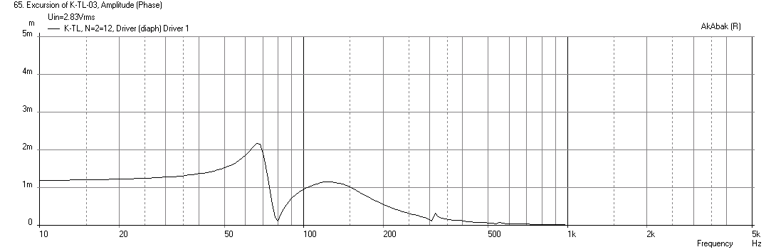

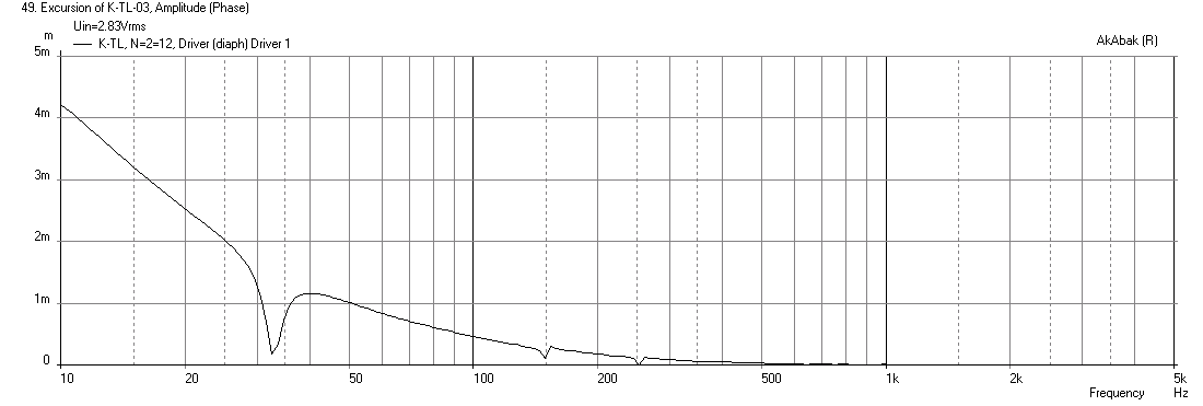

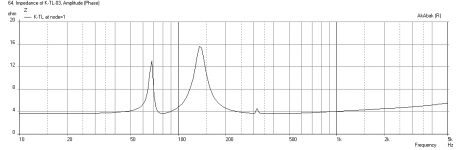

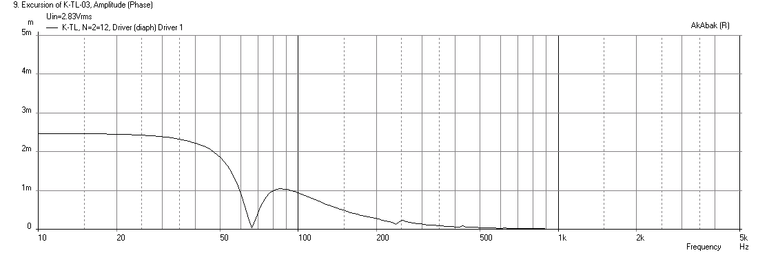

Steve,
The FRS8 can work very well doubled-up in a 0.47X scale Karlsonator with the vent scaled further by 0.7X. Pretty good bass extension and good impedance curve. First is 0.53X scale, second is 0.47 scale, third is impedance, fourth is cone displacement.
Looks like fun.
