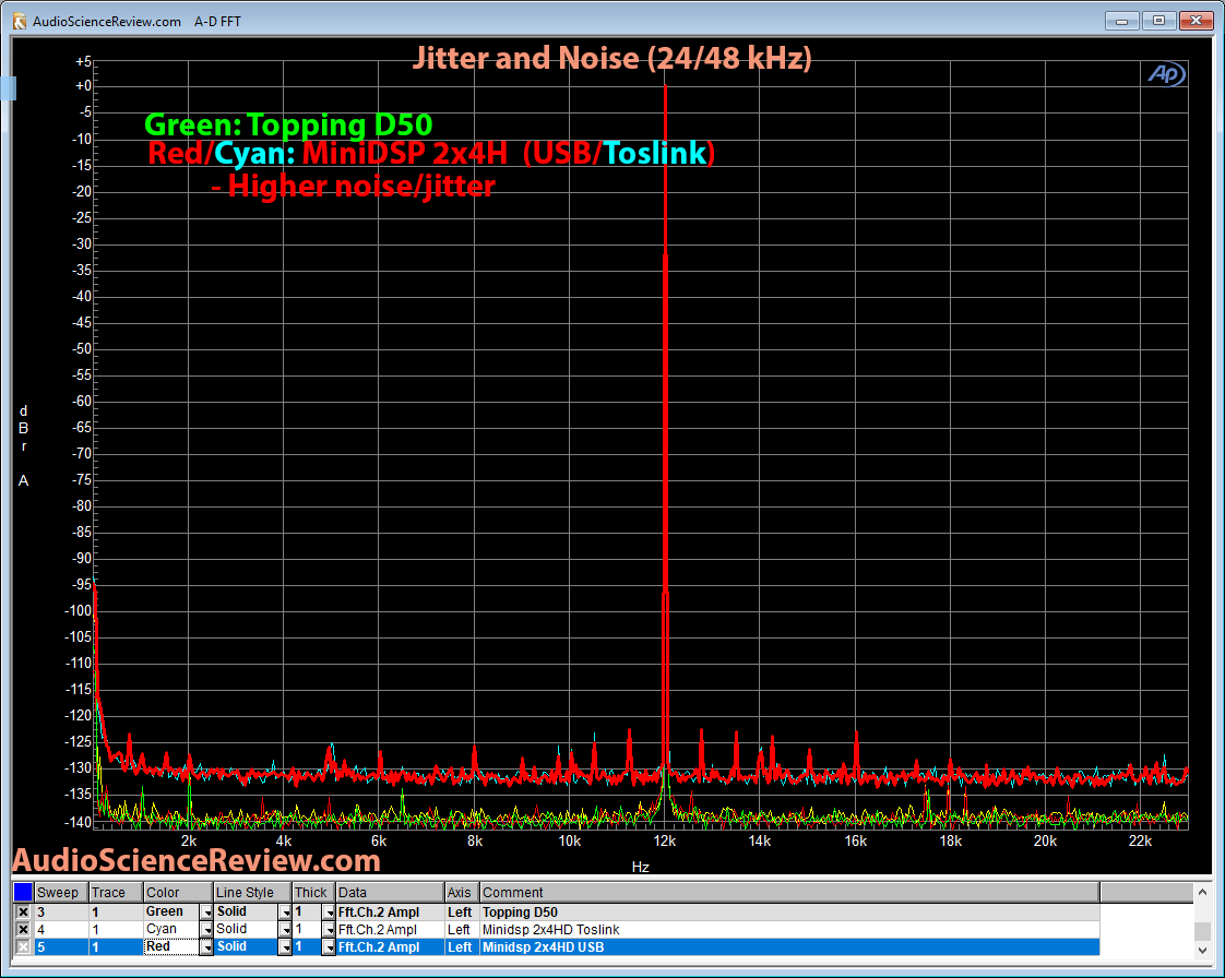

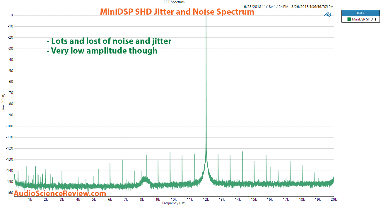

SHD tested by Amir shows jitter at -123dB level https://www.audiosciencereview.com/...sp-shd-review-updated-dsp-dac-streamer.18681/
2x4HD has jitter as well at -123dB https://www.audiosciencereview.com/...urements-and-minidsp-2x4-hd-dsp-and-dac.2674/

Long time SHD owner here. I have a very early unit so your mileage may vary. It's stashed in one of my three equipment racks. I have found the DACs and ADCs to be quite competent, but will admit to wondering whether things could be better. (I recently bought a pair of TD-4001s so that should give you an idea of where I am at.) Mine has 32 bit AKM DACs and ADCs, and has an internal 32 bit signal path. The ASR review is extremely incomplete and I recommend ignoring it.
