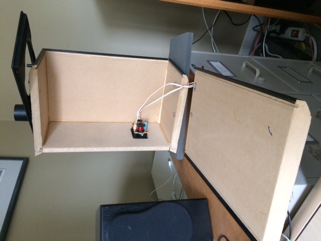

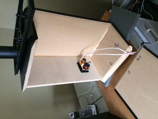

repairing Mission 701 baffle rattle
I was given a set of Mission 701's with the baffle rattle. The drivers are perfect; if you "hug" the speaker during low frequency rattles, the rattles stop.
A t-15 Torx wrench removes the 4 screws holding each driver in place. The wire clips on the drivers are colour coded- Blue for the Woofer and Red for the tweeter-and the + and - connections are different sizes. In theory, it's impossible to reconnect them wrong, but I label them all anyway.
A razor knife down 2 edges of the box separates one of the wood side panels nice and clean. Take your time, and repeatedly run the razor knife along the edges, and apply a bit of pressure to pull the box apart. Once the wood panel is off, the black plastic baffle was clearly loose and slid right out.
A small flat head screw driver is perfect for cleaning the old glue out of the wood panel channels.
I used LaPage 100% contact cement (for all plastics and wood), to secure the baffle to the box, then used Elmer's wood glue to replace the wood side panel. Be patient- glue the baffle back in, wait 24 hours, then glue the panel back in place.
Yes, the box edge is no longer perfect, but they sound terrific.

Just joined for this thread! I'm about to do this same procedure for my Mission 700LE bookshelf speakers, and I wanted to ask about the process you used here. How did you glue the baffle back and wait 24 hours before you glued the panel back on? Did you only glue 3 sides of the plastic to the wood?
Also I'm having trouble sourcing Lapage contact cement locally, you have have any suggestions I can use to re-glue the plastic panel to the MDF box that is available at hardware stores/walmart/etc?
Thanks!
Yes, only 3 sides get glued to the plastic baffle, then wait for the glue to set. The final wood panel then goes on with any good wood/plastic glue.
In Canada, an option is Gorilla Glue- it's awesome and is the go-to glue for Contractors; available in any Hardware/Walmart.
Aah ok good to know. After that you didn't have any problems with rattling of the plastic panel within the unglued section of MDF? I was planning on trying to glue that fourth edge at the same time as putting the MDF panel back, but will skip it if that's a better approach.
Both gorilla glue and goop are available in my area, so I'll pick one of those up for the plastic, and then some Elmer's wood for the MDF.
