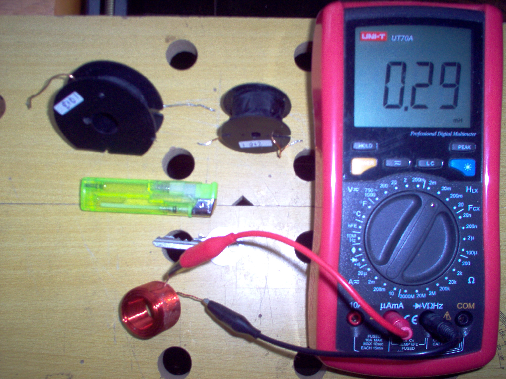

What you need is a multimeter:
This allows you to test for basic electrical continuity. Look for 6 ohms.
Tweeters are simple things:
Trouble is, often, they are fitted with ferrofluid. Dries out after 20 years. Clogs up the voicecoil.
Sonitus Audio Ferro Fluid (ferrofluid) 0.5ml PS4.99 IN STOCK (21 May 2021)
Seek the cheap fix first. 🙂
