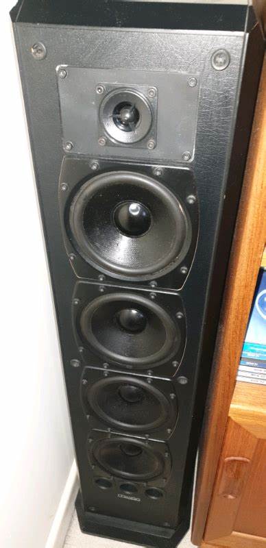

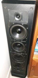

Hi - I am looking for a pair of working tweeters for the earlier ( non freedom) version of the Mission 753. Anyone aware of an equivalent size, shape tweeter perhaps from other Mission speakers that would fit and perform well?. I am aware of a company that will fit a new tweeter to your housing but a previous owner seems to have glued ( very solidly) weird small silver tweeters in there that cannot easily be removed ! Any help/advice would be welcome
Looks like a proprietary neo tweeter with WG. Maybe one of the many available Tymphany flangeless tweeters will fit with some trimming, depending on how butchered yours are.
On second glance it appears the frame of this tweeter originally held an older version Peerless or Vifa tweeter with snap in mounting.

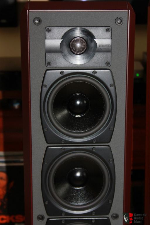

Tweeter faceplate is 118mm x 73mm
My first attachment shows that the 73 mm dimension is critical, and I can't find a substitute tweeter with a rectangular faceplate so narrow.
It looks like you may have to become creative and mount a smaller tweeter on a diy aluminium faceplate as shown in my second attachment.

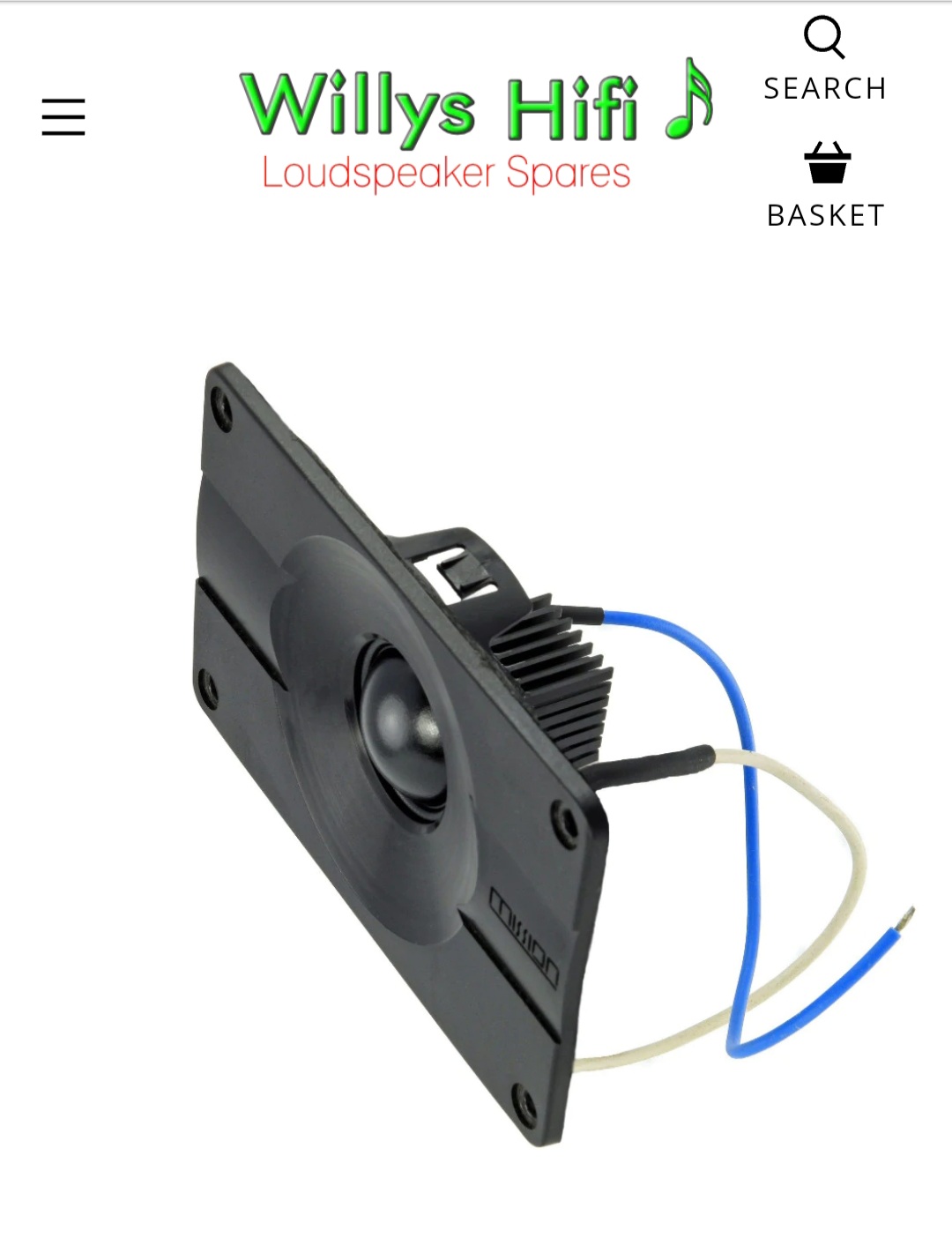

Have you seen this web page:
https://willys-hifi.com/collections/mission/products/mission-753-tweeter
I think the price is reasonable for a repair of a pair of tweeters. Maybe communicate with them and discuss options.

I do get a few of my components and drive units from Willys Hifi, as well as the odd chat. They have been in the business for a long while and have been used by several UK loudspeaker companies.
Obviously I am biased but I do not think they will let you down. Also they have knowledge of why the original fails. I am at a bit of a loss to know why the tweeter Xover component overheats?? Which suggest poor design, but it was from the 90's I guess.
Actually on your point of tweeter power rating, once behind a sensible network 75 watts or more can be easily fed to the loudspeaker and the tweeter will only be receiving one or two watts of that. Some data sheets qualify the tweeter power rating by by giving a recommended Xover frequency and slope 2.6kHz/12dB. Maybe slightly unfortunate that Willy wont reveal the exact combination if that's what you need to feel comfortable with to go ahead for a purchase.
I'd like to see a photo showing how the previous owner has modified the original Mission tweeters using those "small silver tweeter" inserts.
As far as finding a matching tweeter, we have already ascertained that the 73 mm faceplate dimension of the original is critical to fitting the tweeter on the baffle.
I can't find a replacement tweeter that matches that top to bottom dimension, so you may have to become creative in one of the ways suggested earlier.
