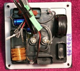

Be worth checking the crossover too. It may have been modified ineptly. Don't forget that if the speakers are wired out of phase, the bass gets a bit vague too. 🙂

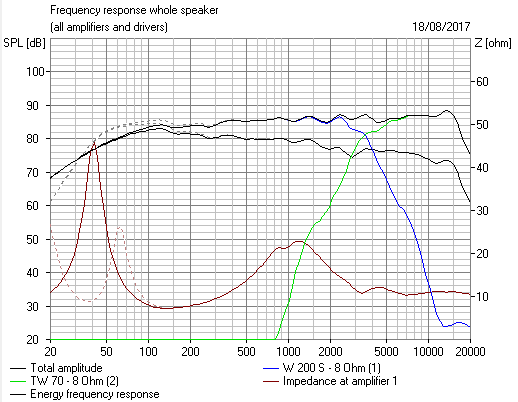

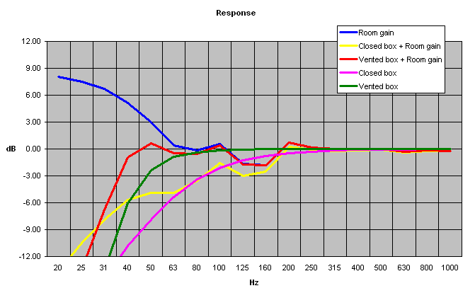

Let's just do a review. Somebody has ditched the 30L reflex cabinet in favour of 64L of closed box. That's easy enough to model with a typical reflex unit: W 200 S - 8 Ohm
Shouldn't lack bass at all. I think you just don't like the closed box sound, albeit it is what is called overdamped here.

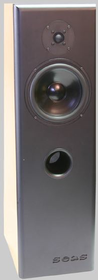

Adding a port, well, I thought 2.5" by about 6" would be about right. But the port is adjustable. It can't be far away from the SEAS Njord, in fact. For sure that would get you even more bass than the 30L reflex original. But who knows what your particular room is going to add in terms of room gain, and also affected by positioning near the wall or floor.

The electronic answer for more bass is a bigger bafflestep coil, which reduces the midrange by 2-3dB. This is what I adjust to my taste. You can see from the frequency response of something I built, I prefer a lifted midrange giving LESS perceived bass, so I'm not in the thunderous bass camp at all.

I'm really just guessing 2.5" x 6" is about right for a 30Hz Fs 8" woofer in 63L.
The W 200 S - 8 Ohm box data comes up with something like that.

Maybe the port is a bit long, and maybe 10cm or 4" would be better. But I really don't know. If it was me, I'd just leave it alone. Once you cut it, there's no going back! Anyway, there isn't any correct single bass tuning. Just variations. You can even fill a port with drinking straws or line it with felt or carpet for the damped aperiodic approach too. That ends up between reflex and closed box at 18dB/octave.
Edit: I just looked up the Vifa polycone P21WO-20-08 sheet which I have on file. Qts 0.33, Fs 28Hz. They recommend 10cm dia x 17 cm long for 60L and Fb of 35Hz. Well, that's saying you could fit two 6cm dia ports really. But all a moveable feast. LOL

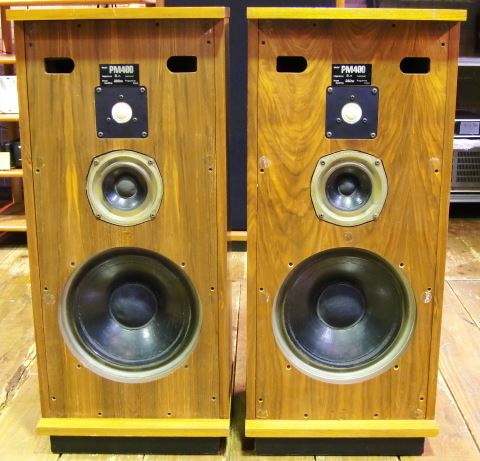

I'm a bit of a closed box fan myself. TBH, and this might be my own opinion, a big box in a small room is a boomy disaster. All down to a thing called room gain.
I used to have a pair of BBC Chartwell PM400 monitors, which never lacked in the bass department. This was the early days of reflex. I bought them just because of their amusing ability to blow a cigarette lighter out when placed in front of the simplistic damped holes in the baffle and hitting a deep bass note! 😀

No doubt that a reflex driver in a big cabinet sounds better with a port. It goes deeper. But only in a big room. Otherwise the bass becomes a bit excessive.
