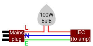

A warning before powering up old amplifiers and equipment: Always power up the first time using a current limiting device like the cheap and simple "Lightbulb Limiter" or Dim Bulb Tester that you find easily with Google. Care though - it's a mains power connected device and due safety measures with correct regulation wiring and insulated parts like a case, sockets, switch etc.necessary.

I have a bulb lamp voltage limiter connected 🙂

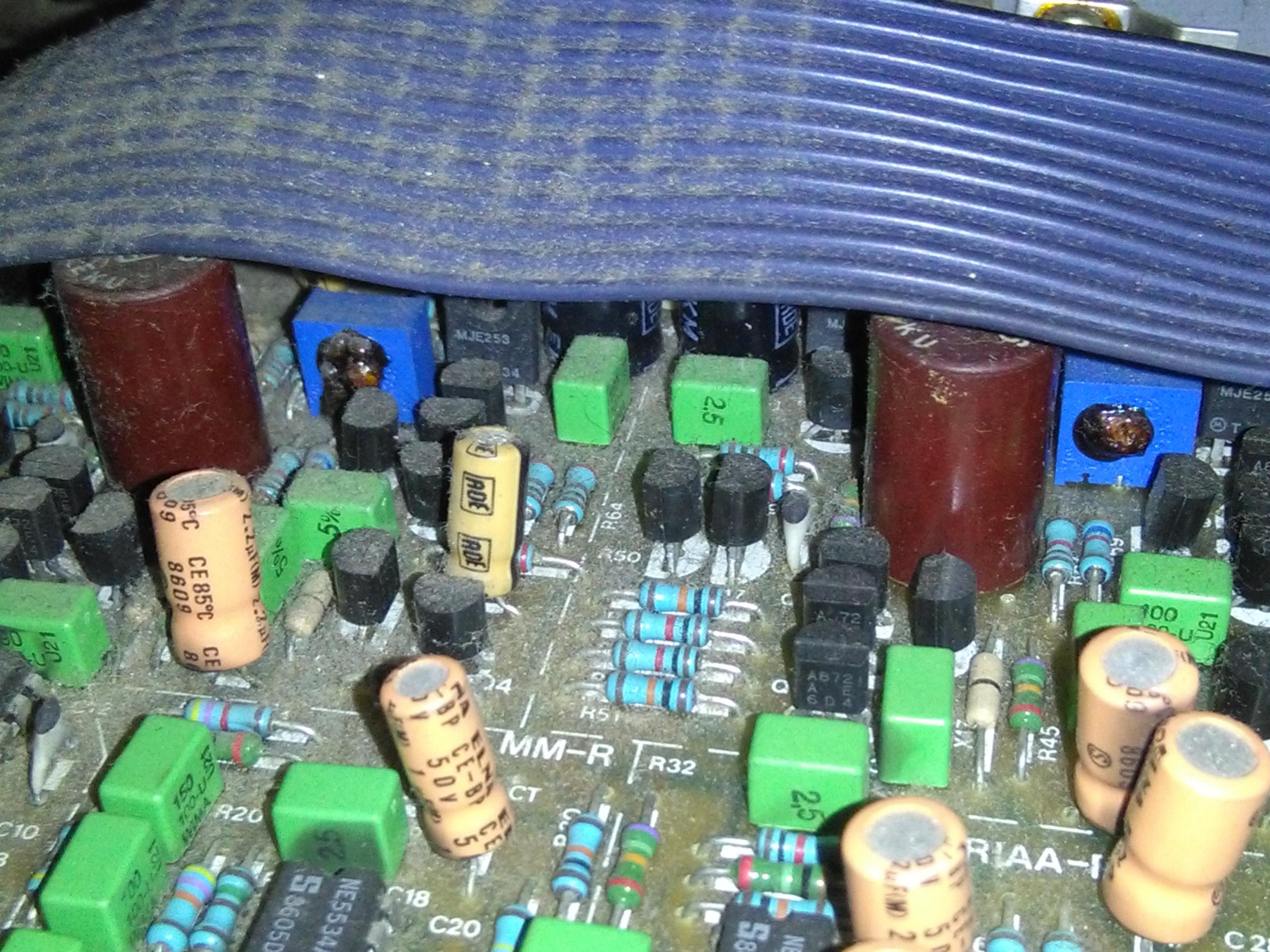

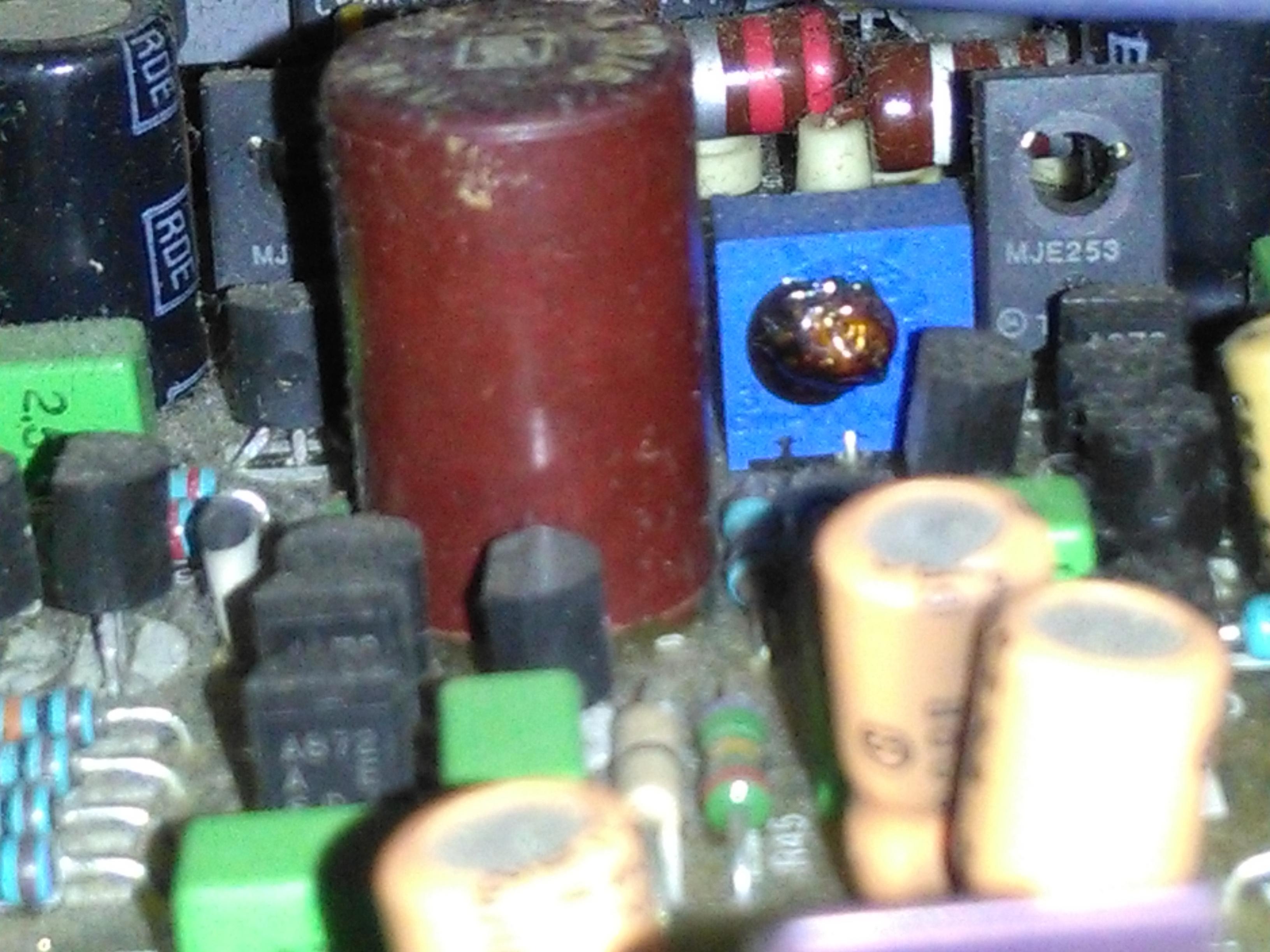

On further investigation, I noticed that there are some visual damaged components:
RV2 and RV3 seem blown. Could this be just the culprit? What more to look for?

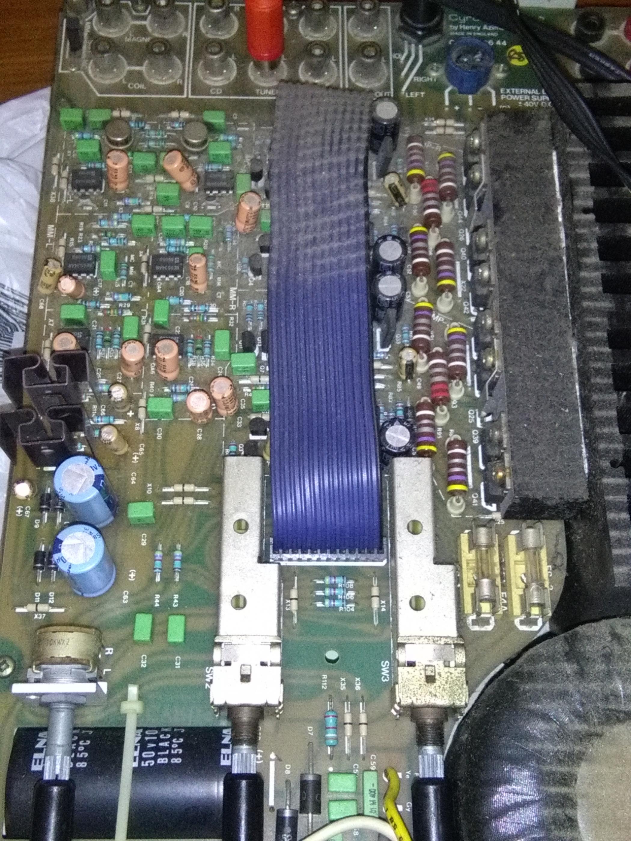

I attached some photos, sorry about all the dust...

Those large brown capacitors are known to get bad (from what I saw on the web), could they be the culprit for all things wrong?
I doubt it. Yes, these Roedersteins are known for cracking and then drying out, but that wouldn't mess things up like what you're seeing.
I'd say give the thing a good cleaning and start poking around with the multimeter. Fuse continuity, shorted output transistors or drivers (basic santify checks using diode test), ground continuity, stuff like that. Then measure power amp supplies at the fuses, you should have found a grounded spot to measure against at this point.
One more thing you could do is verify that the phono stage works over the rec-out. Then your +/-15V supplies are probably good.
The brown ROE caps like to go open circuit which messes up the feedback loop of the power amp. Replace them with good quality 470uF capacitors, ideally nonpolarised ones, but regular electrolytics with at least 25v rating will do.
The output transistors often fail in this amplifier when the amp is pushed too hard. They are labelled PT7, which is actually a BUV28 remarked. Unfortunately the BUV28 is now obsolete too.

The PT7 output transistors are in parallel pairs, 4 per channel. You cannot test individual transistors when they are in parallel so removal of at least one transistor of each pair is necessary to check for essentials like a Collector-Emitter short or the base emitter voltage (Vbe). For a complete test of all possible faults, you certainly have to remove any TO220 transistors.

A good thing to check just in case would be continuity between R67/68/69/70 ground side and small-signal ground at power amp input, at the volume pot and at the inputs. Things are not going to work well if there's a break in there somewhere. Likewise, verify continuity from 470 µF caps to Q9/10 base. And of course, make sure the actual signal doesn't get lost in transit.
Assuming your multimeter is OK to less than about half an ohm, rough in-circuit testing even of your output transistors should be feasible. Speaking of half an ohm, do check the 0R47 power resistors.
