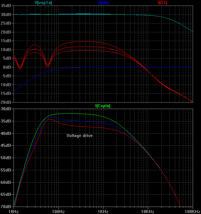

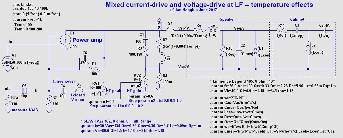

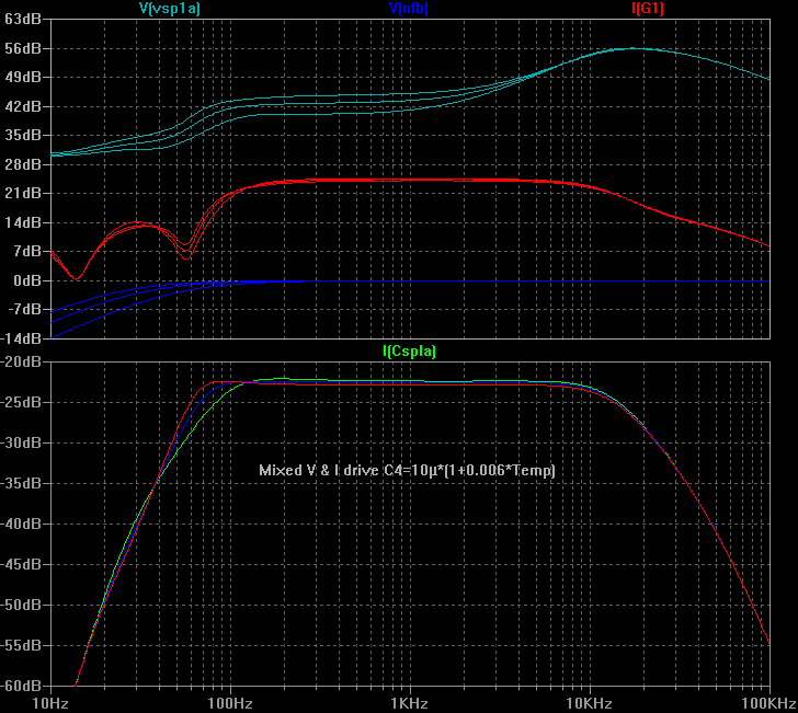

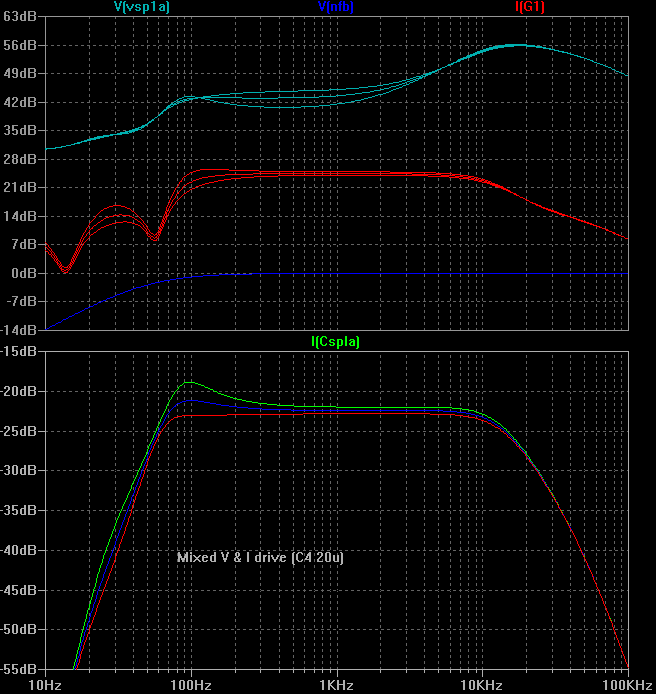

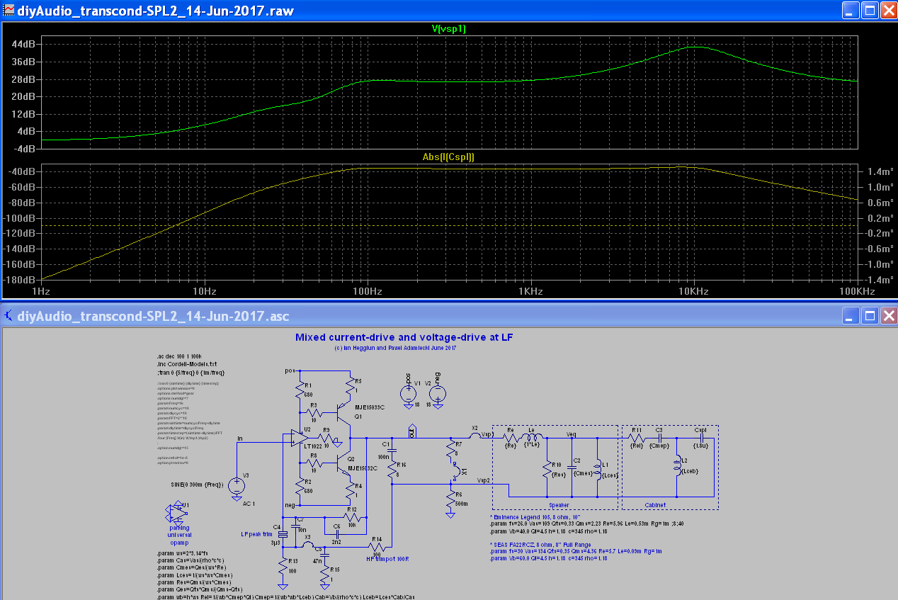

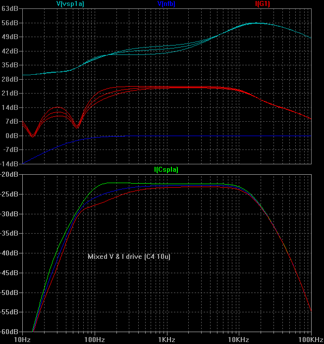

Simulation example for Vdrive at LF & Idrive at MF+HF
Hi All,
Here's a simple PA to show Vdrive LF and Idrive mid+HF.
You can damp the bump at resonance with C4. You can trim the HF end 'lift' with R14 (an idea in my Speaker feedback article - see my previous post for link)
It includes a speaker and box model so you can get a rough idea of the SPL and LF and midF. The HF end of the speaker is not modeled (for the cone) but it still gives an idea of the HF lift R14. There's a second speaker, just uncomment it and comment the other to see it.
The idea of rolling off current feedback at LF has been mentioned in various threads eg http://www.diyaudio.com/forums/chip-amps/270956-lm1875-transconductance-amp-5.html#post4423509
and a similar circuit appeared in Lenard Audio article here http://copyright.lenardaudio.com/laidesign/images/a12/a12_cd-management.gif
I haven't built this amp, Pawel ('padamiecki') said the circuit is from Elektor. It needs heavy compensation to be stable, eg when overloaded. A second (universal) opamp is in my sim circuit so you to check the effect of a higher GBW opamp; swap the opamps then enable the .trans, then reduce the compensation cap C4 with clipping until ringing starts.
I hope this is helpful.

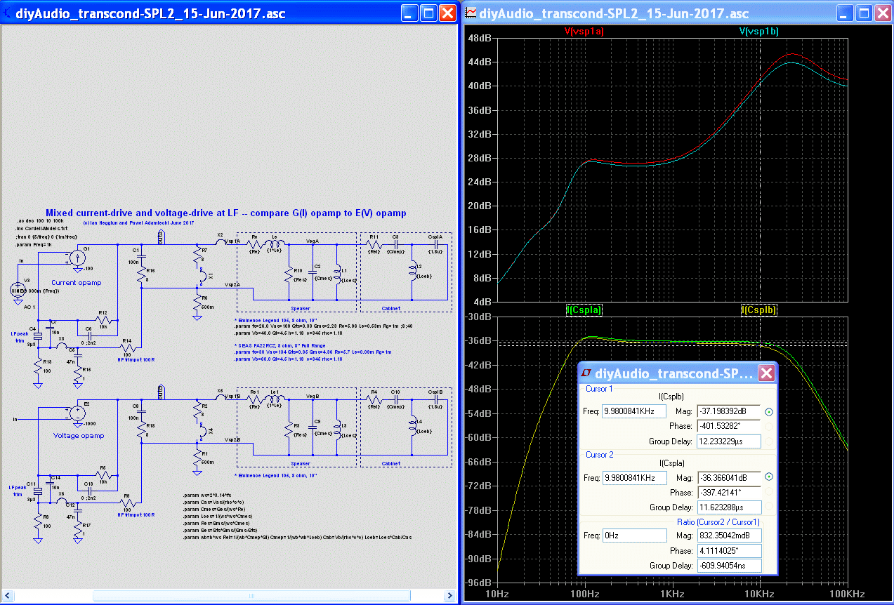

Is a voltage PA or a transconductance PA better for mixed V&I?
Other current drive circuits using clip amps, like the LM1875, are voltage output PA's; the current sensing resistor (in the speaker cold side) converts a voltage PA to current drive for the speaker.
So is a voltage PA or a transconductance PA better for a mixed V&I speaker driving? I didn't know the answer so I simulated the two types of PA's using the same demo circuit with the same open loop gains (where Av~gmRL for the transconductanve PA), both at once to plot the result. No compensation is used for this test. An Avol of 1000 (60dB) is used (most solid-state power amps can give this).
As you can see there is only 0.8dB difference at 10kHz -- so either a V or I power amp works much the same.
Did you notice the previous demo circuit shows a transconductance PA?...Here's a simple PA to show Vdrive LF and Idrive mid+HF.

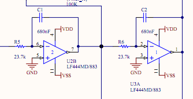

A variation on speaker transforms rely on state variables filters.
Albeit having a quite lot of op-amps, it has the advantage that the parameters can be set are independantly (initiel fo, Qo and target fp, Qp).
A circuit example has been shown by french excellent youtuber Jipihorn
Schematics :
https://jipihorn.files.wordpress.com/2013/06/linkwitz-variable-state.pdf
Film with full explanations in french.
https://jipihorn.wordpress.com/2013/06/03/linkwitz-et-filtre-a-variable-detat-mise-en-oeuvre/
I beardborded it only to check its noise, which I feared a bit because of the amount of op-amps. It is not audible.

Re - https://jipihorn.files.wordpress.com/2013/06/linkwitz-variable-state.pdf
I had a quick look at the above circuit, & thought that the filters around U2B & U3A seemed odd. They are the same so i simmed one of them & it didn't work. On closer inspection they seem to be 9.87 Hz 6dB Oct LPF's = 23.7k + 690nf. So i added a 23.7k resistor in parallel with C2 & it now worked ! The same would apply to C1.
Anybody notice this, & have you found any other issues etc ?

Simulating voice coil compression with mixed V & I drive
Hi All,
With voltage drive voice coil resistance changes with temperature which causes volume compression, changing damping and crossover alignment.
With pure current drive all these unwanted effects are eliminated. But with current drive we get that undamped bump at resonance that needs equalisation or motional feedback to flatten it.
This thread discusses mixed voltage drive for damping resonance & current drive at HF. But with mixed drive (Vdrive at LF & Idrive at HF) we bring back volume compression, changing damping and crossover alignment when the voice coil temperature increases.
Here's some simulations with mixed drive to see how much voice coil temperature affects the frequency response.
The 1st attachment shows the circuit. It is the one in my previous post.
The 2nd plot shows standard voltage drive (jumper X3 open). SPL gain compression is 5dB from 0C to 200C. Damping changes by 3dB giving peaking at 60Hz at 200C. F-3dB stays about the same with temperature at 40Hz.
The 3rd attachment with mixed drive shows the frequency plots when Temp=0, 100 and 200. The voice coil resistance changes by 1.4 and 1.8 times, or 6 ohms at 0C, 8.4 ohms at 100C and 10.6 ohms at 200C. RV2 has been trimmed to get the HF gain the same as the LF gain. BTW this setting usually does not need to be changed when a different speaker is used.
With mixed drive the LF end is noticeably affected by voice coil resistance changes. There is about 4dB of gain compression at 200C (max at 150Hz). F-3dB SPL rolloff is 80Hz at 0C, rising to 150Hz at 200C. At 200C from 150Hz to 80Hz the roll off rate is gradual (-3dB/octave). At 200C this is probably less noticeable than voltage drive since peaking occurs (from 150Hz to 80Hz at +2dB/octave).
This shows mixed feedback has less negative impact on crossover alignment than voltage drive at high temperature. But the LF end rolls off sooner with mixed feedback when set for maximally flat at 0C (same as voltage drive), as mentioned 80Hz at 0C, rising to 150Hz at 200C.
The 4th attachment with mixed drive shows the frequency plots if we change the value of the V/I crossover capacitor (C4) from 10uF to 20uF giving flat at LF end at 200C and we get a consistent f-3dB of 55Hz, but now have 3dB peaking at 0C.
The 5th attachment shows the crossover capacitor changing from 10uF at 0C to 22uF at 200C, effectively reducing the V/I crossover pole frequency as the voice coil heats up. It stays almost flat but the low end f-3dB frequency still changes with temperature. It's shown here as a possibility -- it's not easily achieved in practice.
Finally, if you change the speaker you can see there is negligible difference in the plots. Fantastic! (BTW the simulation circuit attached zip includes parameters for a second speaker with a different cabinet.)
A simple mixed drive circuit like this would appear to allow plug-and-play of random speakers (within reason, nominal 8 ohm woofers and wide-range) and with minimal negatives. Fantastic! With this amp there's no need to tune an equaliser each time you change a speaker.
Also you can easily switching from standard voltage drive to mixed drive so your amp can do regular voltage drive speakers as well as current drive speakers.
With this amp current driven speakers could be passive, but it is far better to go active. And for an active system you don't need to mount the amp in the speaker enclosure because this amp can now drive 'random' speakers...
I know, all this is just simulations. But it's looks very promising so far. I'd like to make a system to see if it works as well as it simulates. Anyone else interested in making one?

...Anyone else interested in making one?
Ian Hegglun
Yes me. I have also played with mixed amps but unfortunately I can't hear a difference between current or voltage drive in mids or hights. The difference seems to be very small. So the most of manufactures takes the easily voltage method.
The mixed one sounds like a voltage driven.

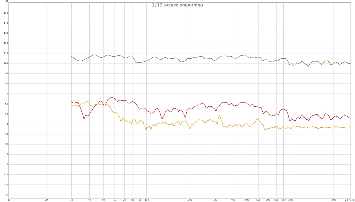

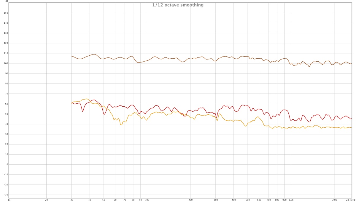

I have been playing with VFET single ended amp (output impedance = 7 ohm) for a month.
Attached 2 charts are measured with VFET SE and IcePower(Damping Factor=very high). The whole speaker is multi amp driven. The woofer is JBL 1400ND, crossover at 650Hz. The impedance peak is around 50Hz, and the peak is roughly notched out with a digital EQ when measure with VFET. The SPL number is wrong, since I don't have a SPL meter. They were measured at around 1 watt.
The third harmonics are much higher with IcePower above 70Hz. Second harmonics get high around peak resonance with VFET, and I guess it is mostly due to the 0.1H choke loaded output.
VFET sounds much cleaner, has much more resolution. Bass pitch is much easier to follow. However, modern studio recordings with loud and tight bass and kick apparently show the shortcomings of the low damping factor amp even after frequency compensation. They do still sound neutral and musical, but something is wrong or missing. We must remember that the today’s producers are making music with voltage driven speakers, and they sculpt the music for those speakers.
Well, I have no conclusion at this moment. I am still experimenting different amps. Currently, 1 ohm amp for 1st woofer, and Icepower driven 2nd woofer is staggered below 80Hz. It sounds OK at its best. If I could completely give up playing back the modern studio recordings, I would just go for VFET.
