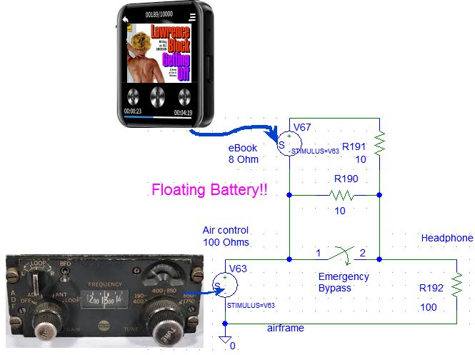

The rig must fail-safe and preferably no-hands. The BlueTooth receiver probably has more power than the headset needs (I've driven dozens of David Clarks on a part-Watt amplifier). If we impress eBook audio across say a 10 Ohm series resistor, about the worst can happen is a constant 1dB loss of volume (which I assume can be made-up in the aircraft radio). Even this can be taken-out by shorting it. Another 10r protects the eBook source.

Thanks for the circuit diagram. I'm going to order a cheap intercom unit to start testing circuits on. That way I can really test everything out before plugging it in to a real helicopter. I totally agree with you about the need for safety and simplicity. I really appreciate you taking so much time to discuss this with me, it's given me a ton of things to learn about and explore.

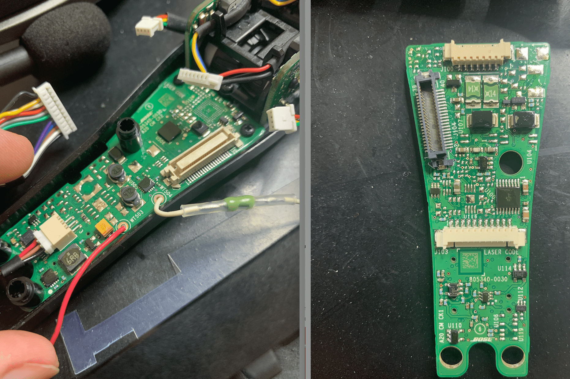

Dear all,
Hope to find you well.
I am new here. I am a comercial pilot and also work with program languages.
At the moment I am developing one interface, similar to that one that was discussed here, but with a different propose.
However, I am having the same problem that creates this topic, mixing amplified signal or create a true bypass line with some IC.
Below I attached two photos from the Bose A20, where is possible to see on the top 4 big components combine with some transistors?? that make exactly the same.
What I pretend is exactly the same, maintain a safe amplified line to my headset and mix the audio from the interface. Or create IC switch that changes the input from both signals.
