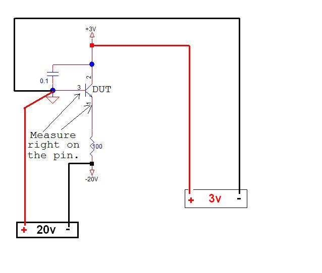

I just tested over 50 MJL3281. I set up to run about 194mA through the transistor with Vcb=3V. I ground the base and use a 100ohm resistor to pull the emitter to -20V.
I bought from different three different vendors so they are likely not from the same lot. I got deviation from 0.636V to 0.639V in all 50 of them!!!
majority of them are group into 0.637V and 0.638V with a few 0.639V and 0.636V.
Wow!!!! This is tight matching. Even 4mV difference in the 50 is not bad at all. I saw 7 to 8mV difference in my stock Acurus power amp. I assume they had tried to match the transistor before putting in. I can easily match to 1mV with the MJL3281.
I first did about 20 with 100mA bias, they are just as tight. I decided to up the current to 200mA as this is the bias I will run my transistors.
I am going to do the MJL1302 next as I have about 40 of them. I'll report back.

I tested 45 of the MJL1302 at 196mA. They are from 0.622V to 0.626V. So it's still 4mV.
I don't remember are they two different badges of single. More likely two different badges. they are really good!!!
FYI, I try to do it as consistent as possible.
1) I keep the power supply on through out. I measure direct between the Base and Emitter pin of each transistor. This means I eliminates the contact resistance between the transistor pins and the socket. This turned out to be a big problem, I had to redo over 20 of the transistors as I notice if I measure at the socket, I got about 20mV drop and vary when I jiggle the transistor to change the contact surface. so I finally had to probe directly on the pin of the transistor, then it's much more consistent and repeatable.
2) I even make sure the time between plugging in the transistor to measurement is roughly the same so the transistor do not heat up differently from part to part. Of cause it is only accurate in terms of " one seasamy, two seasamy " counting from the heart only!!!

Can you post a draft schematic?I just tested over 50 MJL3281. I set up to run about 194mA through the transistor with Vcb=3V. I ground the base and use a 100ohm resistor to pull the emitter to -20V.

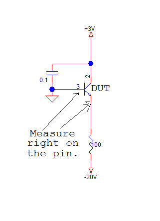

The measurement MUST be measured directly on the Base and Emitter pin of the transistor. When I use breadboard that I can plug in transistors, too much voltage drop across the contact between the pin of the transistor and the socket. I measure up to 30mV just across the contact and it changes when I jiggle the transistor. So it is a must to measure directly on the pins.
I pull 194mA as this will be my bias point, increase the resistor to lower the current.
Keep the -V at 20V to null out the contact drop.
2 separate power supplies ?The measurement MUST be measured directly on the Base and Emitter pin of the transistor. When I use breadboard that I can plug in transistors, too much voltage drop across the contact between the pin of the transistor and the socket. I measure up to 30mV just across the contact and it changes when I jiggle the transistor. So it is a must to measure directly on the pins.
Your results look very good.
4mVbe variation across a batch of 50 seems exceptional.
But it makes me wonder if the feedback across the 100r of Re is masking some of the variation.
Looking at the two extremes:
20V across {100r+622mVbe} compared to 20V across {100r+626mVbe} indicates a change in current of only (193.78mA-193.74mA) 40uA (0.02%) and seems to be inconsequential. The method has ensured the power dissipated is substantially the same and thus Tj is substantially the same.
Would it be too much to ask that you assemble a selected pair that appear to be identical (both Vbe and hFE) using your matching and set up two in parallel.
Use a small value base resistor (1r0) and a zero value emitter resistor.
Add a pair of collector resistors so that you can measure the current down through each device. 1r in each collector allows good resolution using the 199.9mVdc scale of your DMM. (match all your 1r0 resistors before the jig assembly)
Apply a Vbe from a voltage source to both of those base resistors. 4mA with an hFE of 100 gives your 2times 200mA outputs. That 4mA could be from your 3V supply via a single resistor (3-0.62}/0.004 = 595r Use either 560r or 620r. You don't need a dual polarity supply. A trimmer either in parallel, or in series, with the 560r can be used to adjust until the total collector current is exactly the same as in your first matching method.
If the previous matching is as good as the results indicate, then the collector currents should be very close between the parallel pair.

I don't think the collector current is necessary matching. That, really depends on the beta of the transistor.

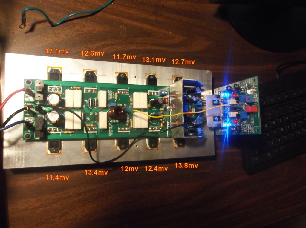

unmatched -
There are two on this amp I am tempted to replace , but it does not
seem to be too bad.
Stays close to these readings cold startup to after heavy use.
ON is pretty consistent , devices are njw1302/3281 -72V rails/.22R re.
Edit - same outputs were about 1mv spread @ 45V rails.

From my experience, watch out the PNP. There were 4 of them that the beta are way off. The beta was only 96 to 100 compare to the rest that mostly are over 125. That's a big difference. I bought in two separate batches, meaning they are mixed into the the batches, it's not like I have 20 of those that you can say one batch is 125 and the other is 97. So even if you buy one batch, there might be a few that are way off.
Now I have 4 of them, not enough to make up a set of 5 for my amp.
The Vbe do match very tight.
Yes , that bottom row is the P's notice the 13.8/11.4mv readings.
