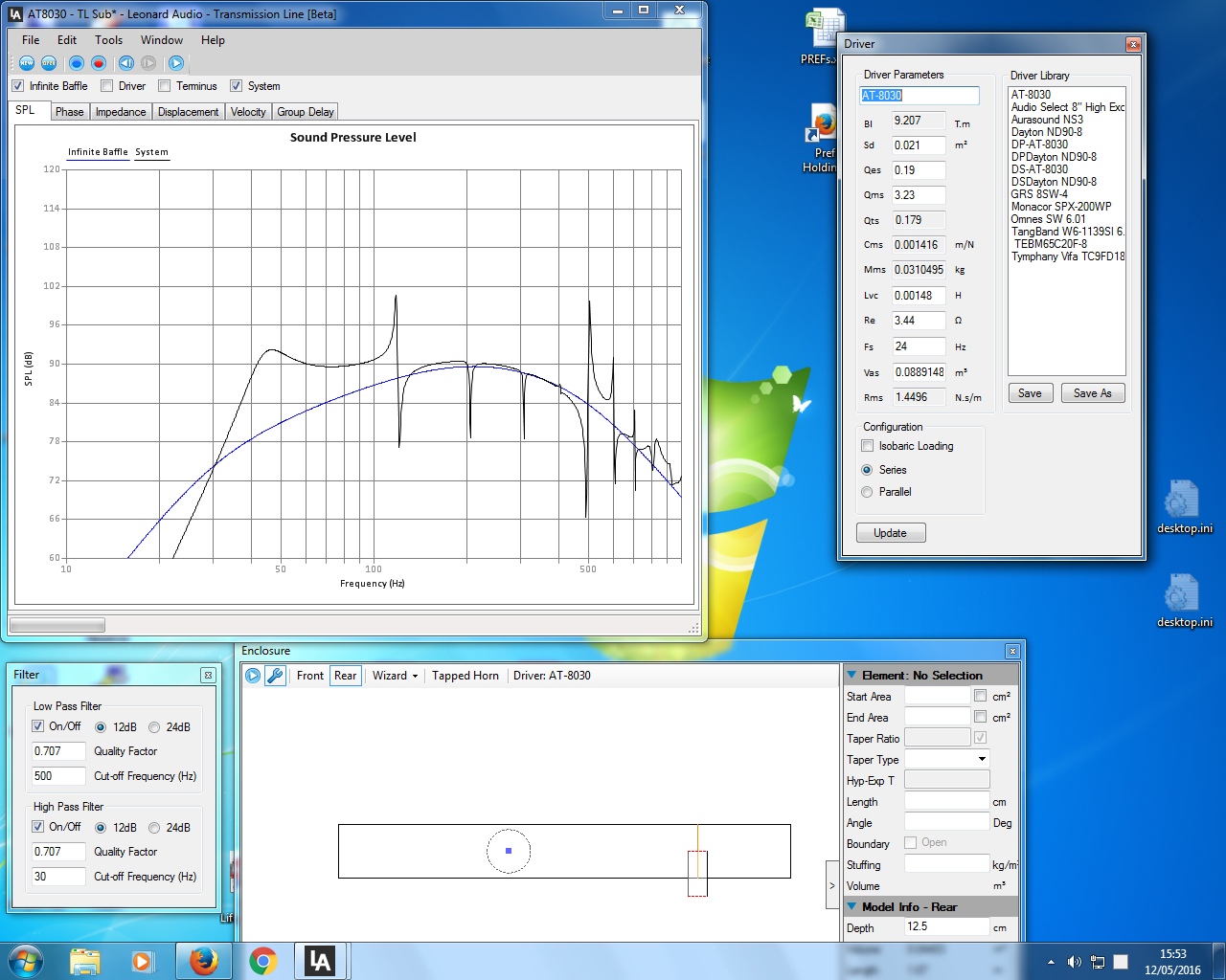

Creating an MLTL in TL software has been interesting.
170CM line length. Driver at 60-66CM, port at 135CM
This is where I've got to.

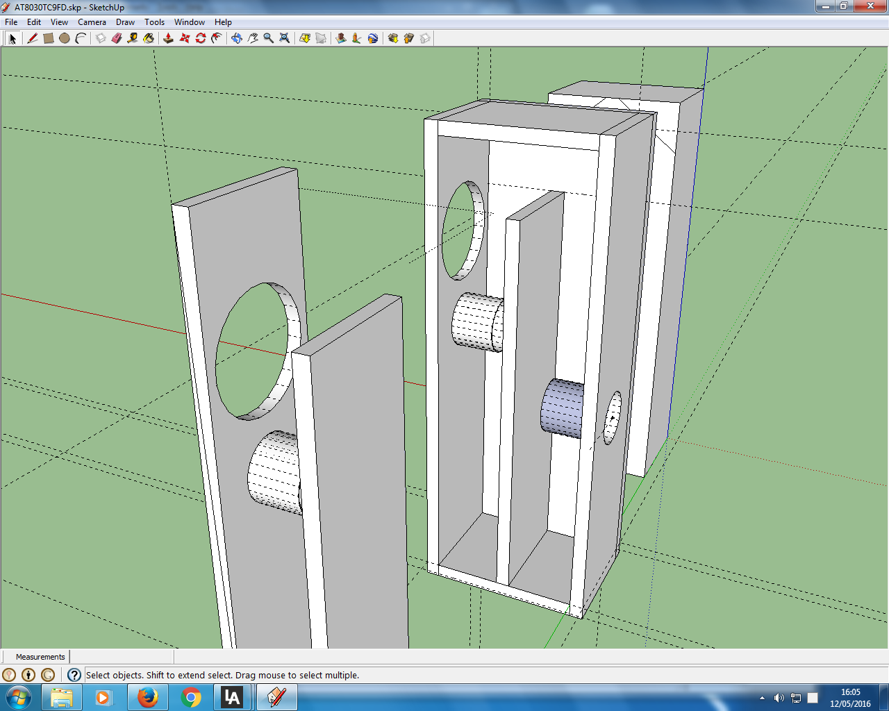

And in Sketchup...

I haven't shown the modelled the Vifa, but it's going in a 1/2 -1 litre enclosure of "pipe". Crossover frequency is somewhere in the 300-400hz range.
Port is also currently a pipe... What can I say, 4" pipe is cheap.....
Nothing is set in stone yet. I may mount the Vifa on top in a triangle. Also mooting a slot port rather than the pipe. Pipe is going to be easier to tune though, I think.

This can work well as a MLTL FAST with 8in woofers. The MLTL you have shown can probably be made to have a smoother response with a bit less volume to reduce that bass peak bump at 45Hz. Try placing the 8in driver about 1/3 distance from the closed end and put the vent a little closer to the "open" end maybe 5 in or so. The TC9 can go in a Dagger (a 3 sided tall pyramid stuffed with wool or fiberglass). A Dagger has no parallel walls and sounds less boxy with no resonances. About 1.5L would be a better volume to let its soft suspension breathe more and reach the lower 150Hz region smoothly to do a XO at say, 350Hz to 500Hz. The 93dB senstitivity sounds exaggerated for a buyout woofer. Probably closer to 91dB or 90dB, in which case well matched after 4-5dB baffle step loss. Use a 1mH and 2R to 4R shelving filter on TC9FD to balance the response above 1kHz with the 300Hz to 1kHz output.
I can shrink the volume but to keep bass sensitivity above 90, I lose 5hz+ on the bottom end.... I can extend the line to get some low end back but I still get a "scoop" in the middle. Maybe I'm aiming too low?
Yep, the woofer models as a 90-91 sensitivity driver. So unless the T&S are way out....
I may see if I can build a long tapered dagger into the top of the line. One less wall to build for it and the initial corner is dead space anyway. Though to get the voice coils lined up I may end up burying it deeper. That was one reason low mounting the TC9 seemed a good idea.

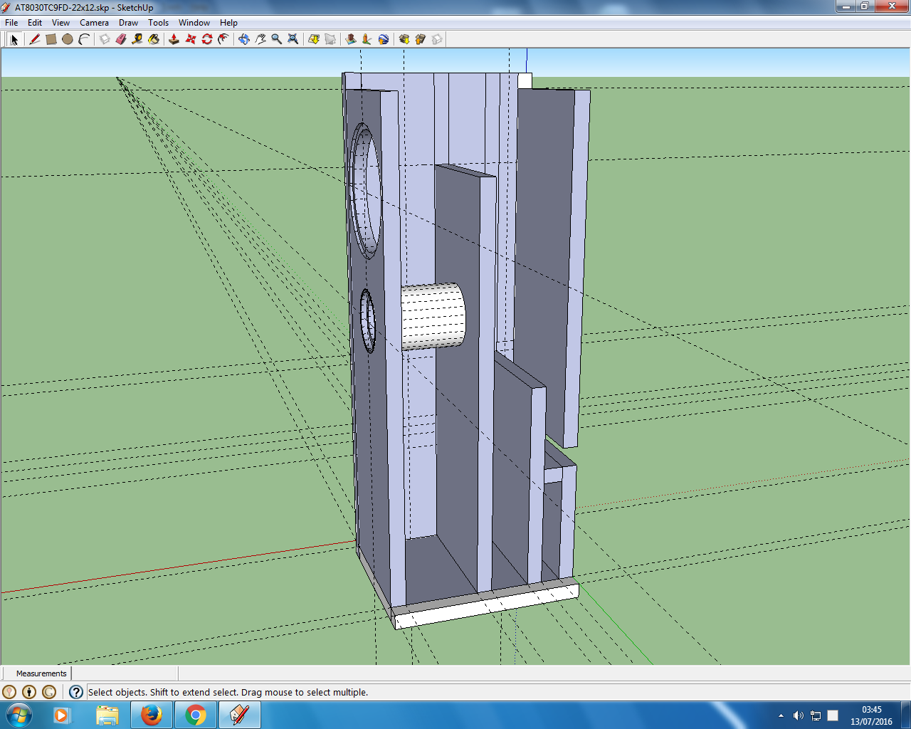

A slight update on this....
It's evolved a little....
- TC9 will sit in 120mm diameter PVC pipe of about 1.5L.
- Rear slot port used.
- Cabinet cut from 25mm MDF. Most parts cut by B&Q for free. Router table used for exact (!?!) thicknessing.
- 8" to run from around 40hz to above 300hz.
- Baffle step F3 is 430hz.
As implied, Parts have mostly been cut and assigned to spkr 1 or 2. Lengths need a little trimming and I need a hell of a lot more clamps and glue.

I tried the fit of the PVC tube today... 120x350mm from Screwfix.com. Wall thickness is about 1mm. Cut it using the router fence as a guide on the router/saw table.
Front baffle and separator have close tolerance recesses for mounting the pipe. It feels VERY rigid when held between those two panels. It'll have an amount of flashing tape on it to reduce panel vibrations and about 20g of wool inside to damp the driver.
