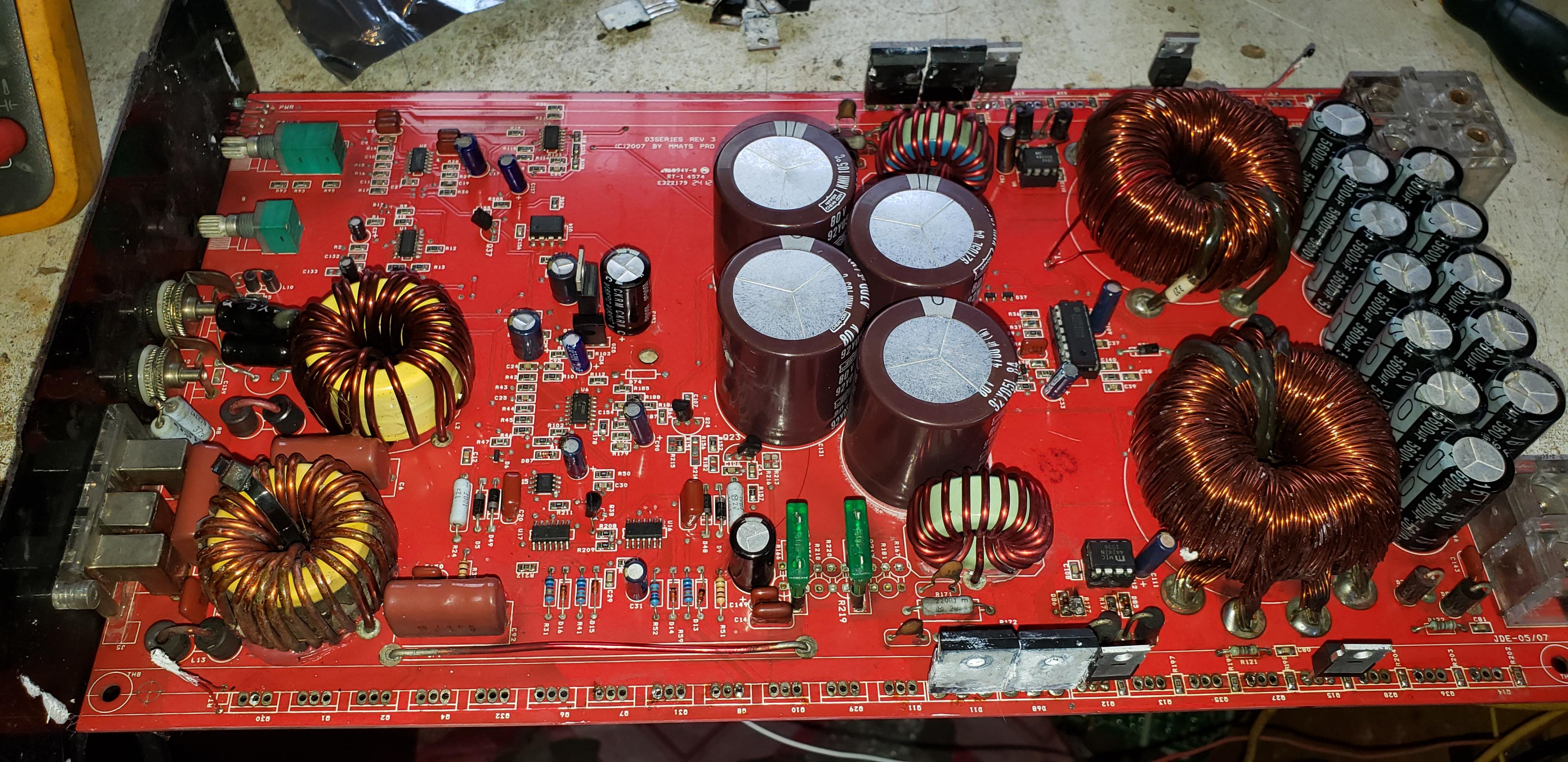

Hi all

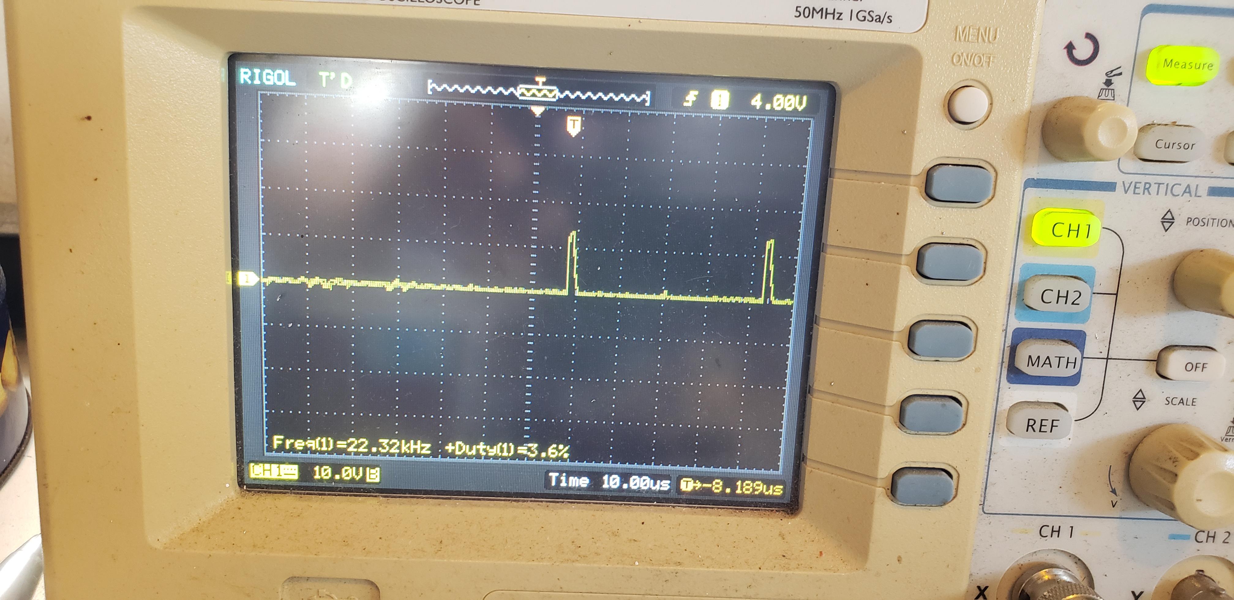

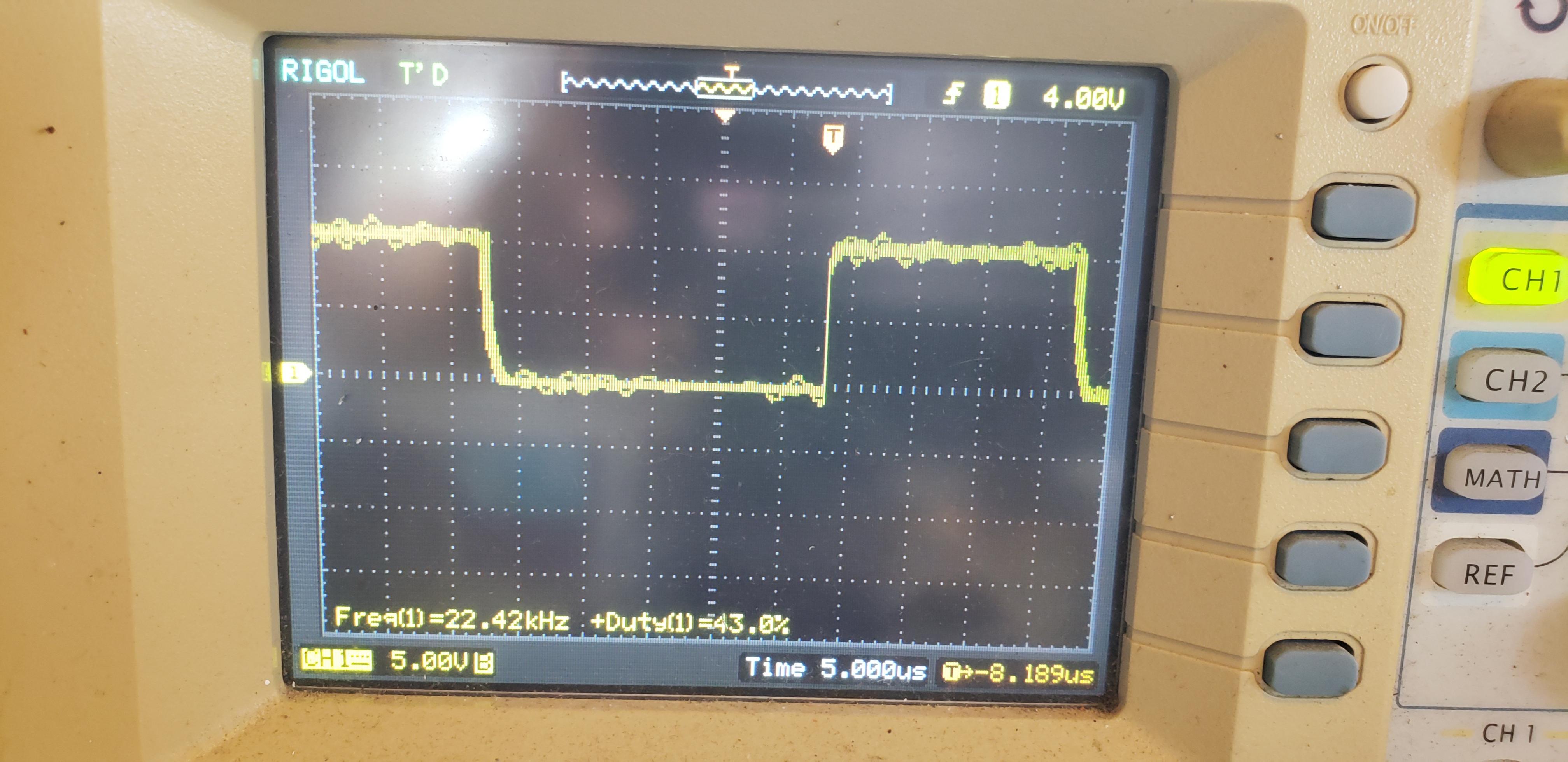

The above mentioned amp blew all the power fets and half of outputs. I fixed the amp and again customer returned blowing the power supply. On observation without output fets the amp comes on but with 3% duty cycle when the voltage is 12.5v. When I reduce the voltage to 10v then I am getting good 45% duty cycle and it pulls about 0.6amps current. Is this have to do with repeating power supply damage?thank you.
So is there a possibility that if he did not had enough current i.e. weak battery that might have cause power fets to burn?
This amp looks like a MMATS amp. The MMATS amps are a lot like Earthquake amps and the diagrams of the Earthquake amps show over and under-voltage protection.
The attached amp is a 4080 amp but the supply may be similar to what you have.
