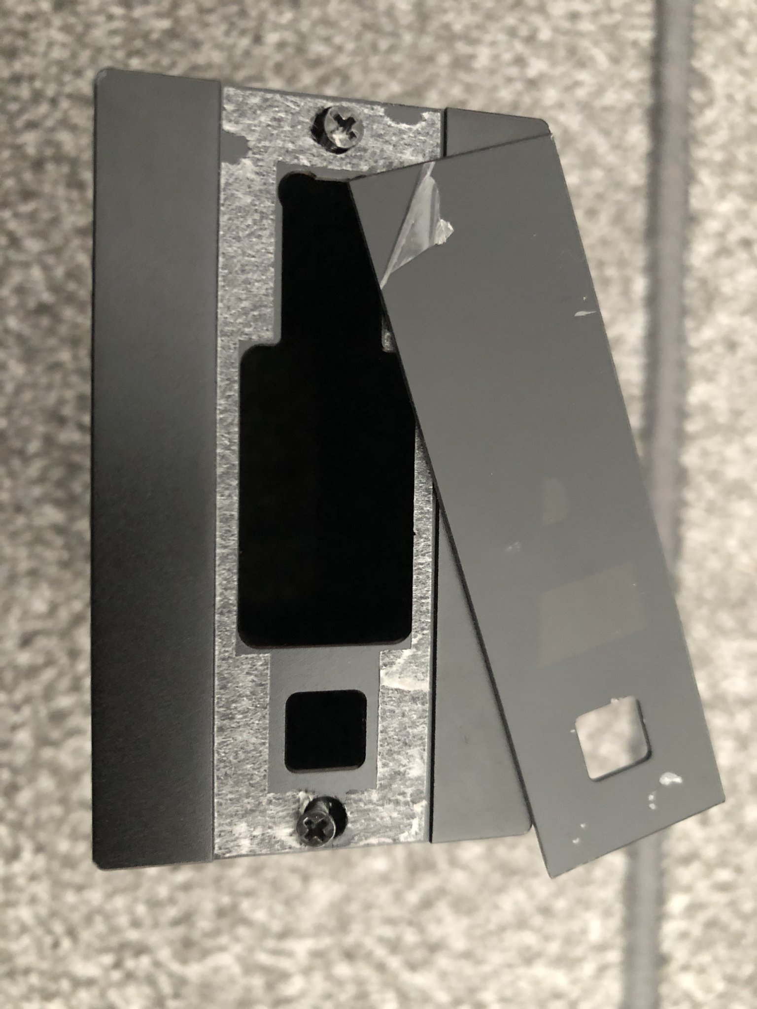

Just disassembled a defective 10th MKII (not mine). It had a defective AK4493 with crackling left channel probably because of static/too high voltage caused by an external linear PSU that had floating PE and no reference of Audio GND to PE. There was around 30V AC both on + and -. Yes I know I am supposed to speak in terms of leakage current but as it was a goner anyway I leave it at that.
The SPDIF receiver is a LC89091. As I now dissected the device I noticed there is a stepup PSU compensating the Uf of the “best battery” diodes that are between buspower and aux power. It does not care much about either 4.7 or 5V input voltage and produces 5.6V. The 5.6V is made 5V again. Right … The miracles of ChiFi are mysterious.
Also see the front cover construction which is typical for SMSL. Once one pulls the flexiprint connecting the front PCB to the main PCB there is no easy way to assemble it again.
