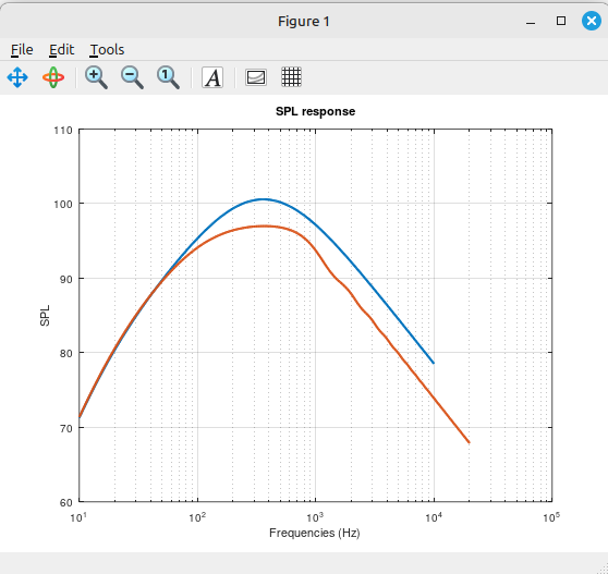

Hi everyone,
I am trying to make my own simulating tool using GNU Octave and transfer matrices methode. I am encountering difficulties in validating my simple model (infinite baffle) because it does not match hornresp results. i think i am not that far from a correct model but not here yet. as you can see phase and SPL are not the same as hornresp.
below is the code with some comments. Note that i do not think problem come from my radiatoin impedance since i used this function for analytical modeling and results mached hornresp with my analytical model.

Parallelpen, did you try if Large Language Model ( AI ) could help?
Out of curiosity tried whether Grok understands any of it, and it spit out following.
I cannot comprehend what you do there so no idea whether this worked or not, but the result seems plausible so thought to post.
Problems in the code
After analyzing your code, I noticed the following key issues:
- Missing voice coil inductance in the transfer matrix chain
You have defined the voice coil inductance matrix tle = [1, 1i*w(k)*Le; 0, 1], but you do not use it in any chain (tdr or Tt). The voice coil inductance (Le) is an important part of the speaker's electrical impedance, and omitting it affects the results, especially at higher frequencies. - Incorrect calculation of input impedance and current
You calculated the input impedance zin = t12 / t22, where t12 = tdr(1,2,k) and t22 = tdr(2,2,k), using only a partial chain tdr (the electro-mechanical part without the acoustic load). This does not take into account the entire system's load, including the radiation impedance (zar). Furthermore, the input current iin = ein / zin is based on this incorrect impedance, which distorts subsequent calculations. - Incorrect calculation of far-field pressure
You calculated the acoustic pressure at distance r using the formula Pa = pout ./ (4 * pi * r), where pout is the pressure on the membrane surface (pout = zar * uout). However, this does not correspond to the far-field pressure in an infinite baffle. The correct far-field pressure should be calculated from the volume velocity (uout) and not from the membrane pressure, and there is an error in the coefficient (you use 4 * pi * r, when it should be 2 * pi * r for the infinite baffle case). - Uncertainty in phase calculation

thank you for answering,
I was not clear in my first post. i am not asking for someone to debug my script but to explain to me how it should be done, like what is the correct way to calculate the input current, matrices order of multiplication and things like that.
octave is the same as matlab so i was hoping some people could be able to understand my code wich is here to show how i understand the concepts, i am not waiting for someone to send me a corrected script but someone to explain to me what is the correct way to use the matrix method for loudspeaker systems.

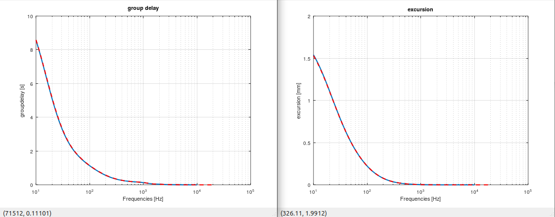

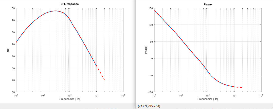

I wil try to explain what i am doing without codes maybe it is better.
I am trying to implement a simple model loudspeaker in an infinite baffle using trassmission matrices. I have to implement it correctly so that it represent accurately the physics of a loudspeaker in all three domains (electrical, mechanical and acoustical).
In a more concrete expression i want to use the following relationship to compute output pressure and volume velocity :
[pressure ; volume velocity] = Tinverted * [voltage ; curent]
So i need to know the correct voltage (here it is just a constant input voltage eg), the input current wich i need to calculate accurately and the inverted matrix reprensenting my complete model Tinverted.
. Electrical domain :
There for i am computing the electrical matrix buy multiplying the restance with the inductance matrix.
Telec = TRe * Tle
with TRe and Tle the resistance matrix and the inductance matrix created like stated in bjorn kolbrek book for impedance matrices so Tz=[1,Z ; 0,1]
In the code i sent i am not adding the inductance Le but this is not where i am mistaken, adding Le as stated above with does not make my results correct.
. Mechanical domain :
I am using the resistance (Z=Rms) giving me the mechanical resistance matrix TRms, the mass impedance (Z=j*w*Mms) giving me the matrix for the mechanical mass TMms and the compliance (Z=-j/w*Cms) giving me the matrix for the mechanical compliance TCms.
then i multiply those matrices in the following order : Tmech = TMms * TCms * TRms
My complete electromechanical driver matrix is then : Tdriver=Telec * Tem * Tmech
Where Tem is the electricomechanical coupling matrix Tem=[0,Bl ; 1/Bl,0] also taken from Kolbrek book.
. Calculating input current I :
Once this is done i am assuming i have a correct model of the electrical and mechanical sides so i calculate the input current. To compute the input current i am using the transmission matrix propriety wich is giving me the electrical impedance shorted output by using the driver matrix Tdriver components :
Zin = t12 / t22 where t12 and t22 are the Tdriver matrix components (Tdriver can be writen as : Tdriver = [t11,t12 ; t21,t22])
Once i have Zin i can calculate the input current :
I = eg / Zin where eg is the input voltage and Zin the previously calculated impedance seen from the source.
. Acoustical domain :
Now the last component missing is the inverted matrix Tinverted wich is just the inverse matrix of my complete system in all 3 domains. So i need to add the acoustical domain to my Tdriver matrix to create the complete system's matrix T :
T = Tdriver * Tma * Ta
where Ta is the matrix for the acoustical side, i am using the same method as for electrical and mechanical domain expect here Z is a radiation impedance calculated from bjorn kolbrek book section 14.4 for those who are curious.
Tma is the mechanoacoustical coupling matrix Tma = [Sd,0 ; 0,1/Sd]
. Final Computation :
so now i have a correct input voltage : input voltage = eg for all frequencies, a calculated input current I, and a inverted matrix Tinverted = invert of T.
My problem is by doing so i do not have the correct output pressure nor the correct output volume velocity comparing to my analytical model nor the correct phase and spl compared to hornresp.
I hope those precisions can give you a more clear picture of my problem and my current understandings.

1. The first point is not one of importance here i was voluntarly neglecting Le in the code i sent.
2. That is one thing i am not sure about, but what i can say is when calculating impedance Zin with the complete chain matrix T i don't get anything close from reality but noise. maybe i am not doing it the right way, an expert explanation would be really appreciated here.
3. In fact when using volume velocity (uout in my code) to compute the pressure my curve matches hornresp for the low frequencies but not for the active frequency range (see figure below). i decided to use pout in my code because i am assuming this is the way but again an expert explanation here about why the output pressure i am computing is not the correct one and how i should do it would be great.
4. I also tried but since my acoustic pressure is not correct it is not a solution for me, maybe when i will compute correct pressure and volume velocity. here also an expert poit of view can help me.

SPL, phase, excursion and group delay can be calculated from uout easily.
some curves bellow, in red Hornresp and in blue my model, we can observe a perfect matching !
thanks to everyone who took time reading this thread.
