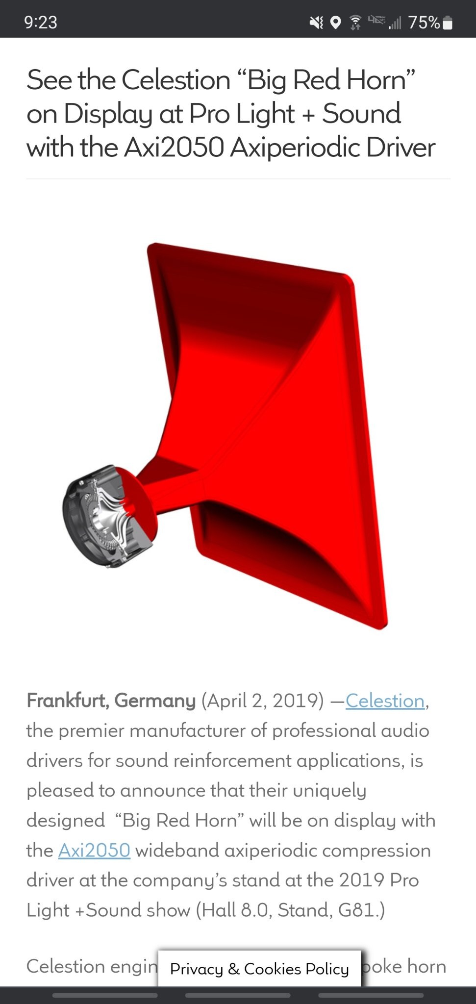

Celestion 'big red horn' (2"):
Celestion Features Big Red Horn for Axi2050 Axiperiodic Driver at Prolight+Sound 2019 | audioXpress

Anyone have any feedback on someone who's actually used the Celestion Big Red Horn with their Axi 2050, and who is actually selling them and what is the current MSRP?
