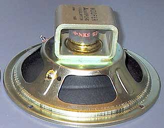

Are the drivers alnico? Can you post pictures?

How do I tell if they're alnico or another type? Sorry, I'm not only a newbie to the DIY scene, but Vintage speakers as well.
I do know that the magnets looked awfully small to support a 12" woofer the last time i had them out. I'll see if i can get some pics to show you.
Cam94z28 said:How do I tell if they're alnico or another type? Sorry, I'm not only a newbie to the DIY scene, but Vintage speakers as well.
An alnico magnet is smaller than an equivalent ceramic unit.... i've attached a pic of a typical alnico magnet (some look a bit different -- ie soupcan units).
dave
nope, these are the standard style magnets, they look like the magnets on any modern subwoofer, only they look to only be 10oz or so.

Cam94z28 said:nope, these are the standard style magnets, they look like the magnets on any modern subwoofer, only they look to only be 10oz or so.
Sounds like a typical mid-late 70s Japanese, high-Q, smallish box, ported yields big lump in the upper bass design. Try stuffing the port to do a quick experiment to see if you can get better bass....
