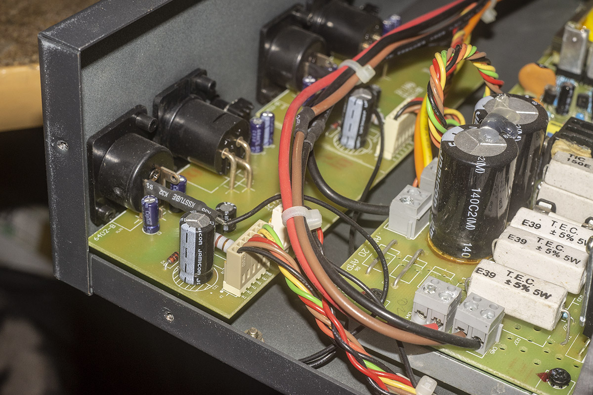

There are very few caps in it, so I don't think there's much need to upgrade any of them, other than the four 2200uF 63V Jamicon smoothing caps in the power supply stages that appear to have leaked electrolyte and have been discussed here:

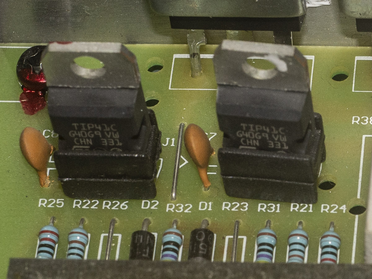

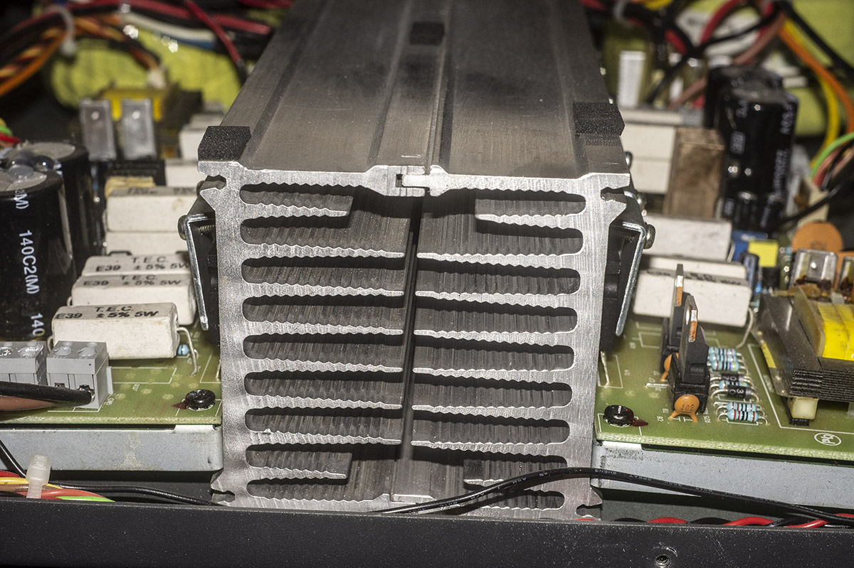

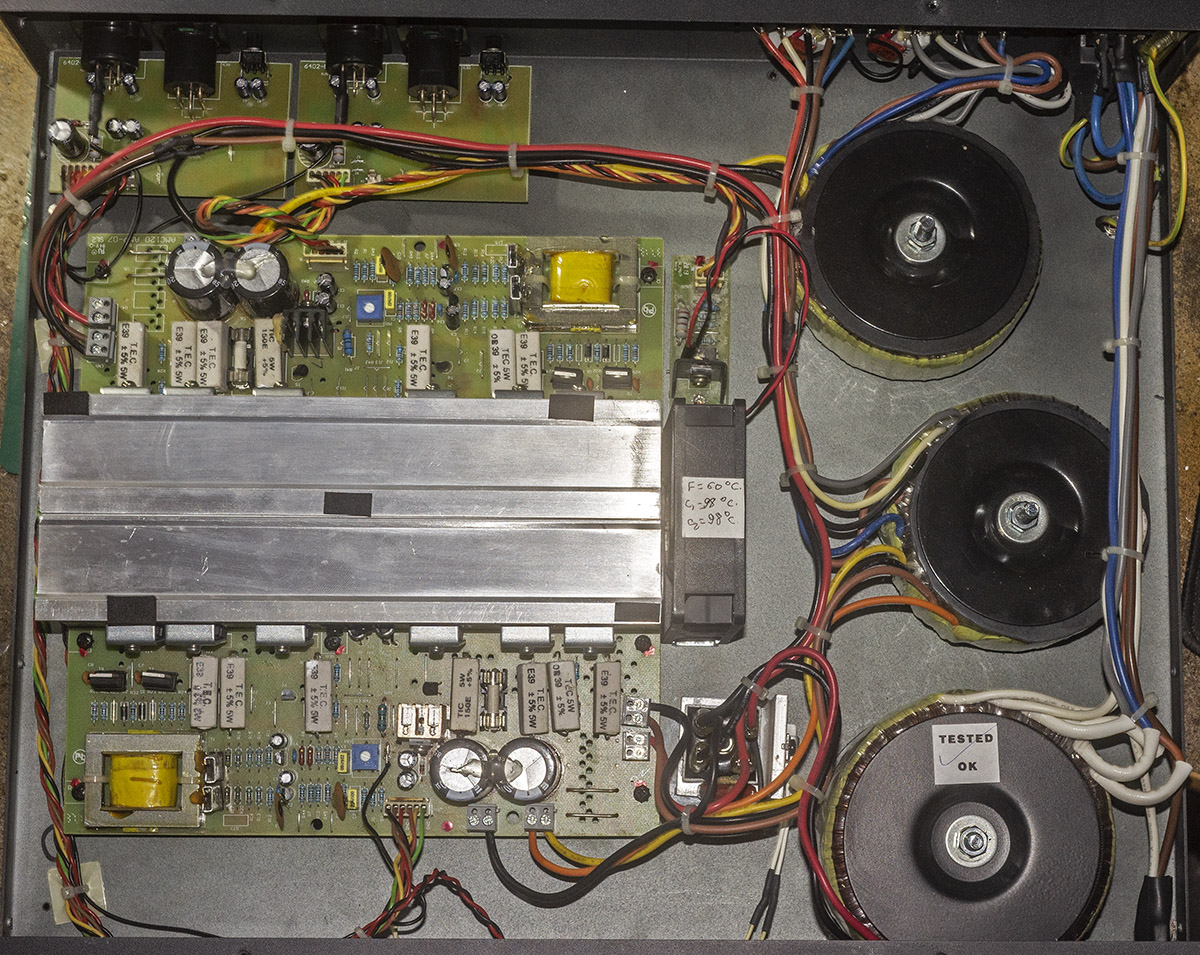

Here's some pictures of the innards, any suggestions for mods/upgrades are much appreciated.
It's biased as a class B device, but for my purposes, I won't be using more than maybe 15-20w max per channel rather than the 60wpc it is capable of, so I'm wondering, could the bias be adjusted so it runs class A for the first few watts in order to make it sound a bit better? The heatsinks are quite substantial and it has thermal protection circuits, so I doubt it would melt.

While its built to a high industrial spec. this LINE ( factory broadcasting ) amplifier does not lend itself naturally to "hi-fi " .
It wasn't designed for high quality audio.
It does have quality expensive parts including the high quality metal film resistors /heatsinks etc .
Its extremely well built to industrial standards and must have cost a lot new but ---personally-IMHO --I would use the case and parts and build an audio power amplifier of low distortion.
I know that's not what you want to hear but if anybody thinks that you can use the same circuit for real hi-fi ---well I am willing to be impressed as long as they give a detailed explanation ?

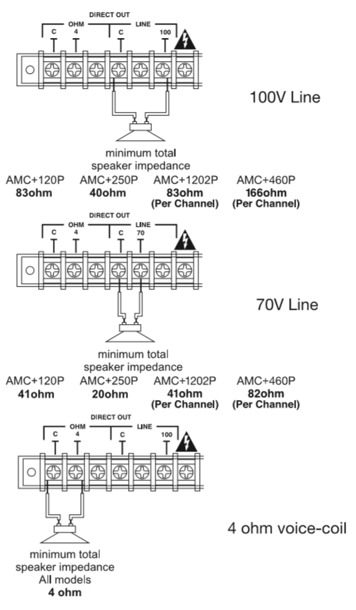

Sorry Ian, but you're not correct about the output of this amp. Take another look at the specs and photos - it has both line outputs (100v and 70v) and low impedance 4ohm outputs, which are for connecting normal speakers.
It does, like most high power PA systems have but not many 4-8R monitor windings are capable of the the full power of the amplifier, as I found many years ago when I blew the 4R windings on a customer's amplifier and it cost me a lot more than the job was worth. So much for trying to be clever.....
This is a specialized amplifier with a transformer at the input and output of a powerful stage. Monaural (1 channel joins 2). HiFi quality does not provide - tweaks will not help. Only complete rework using parts, power supply, heatsink and box. New PCB.
