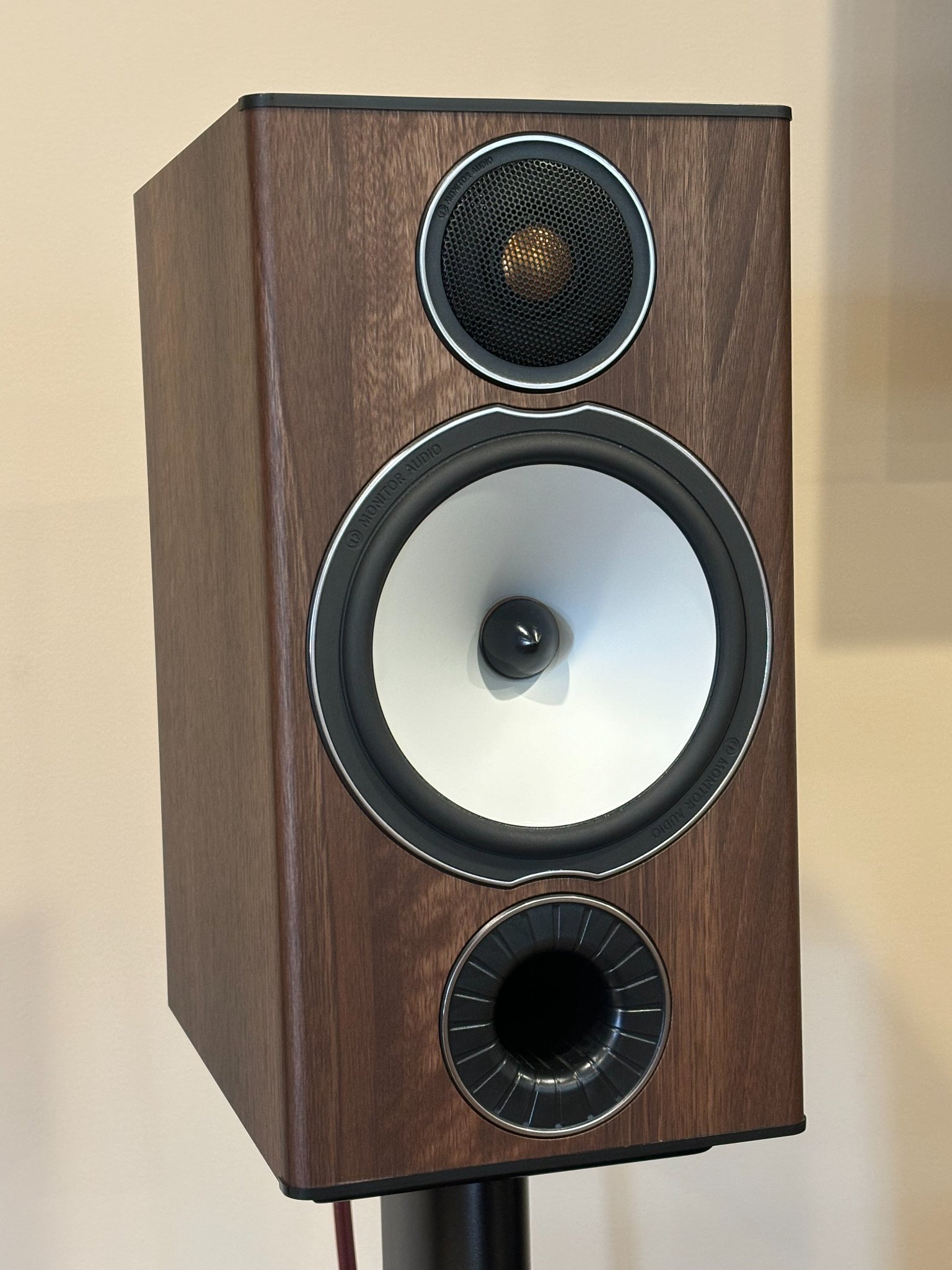

Speaker Details:-

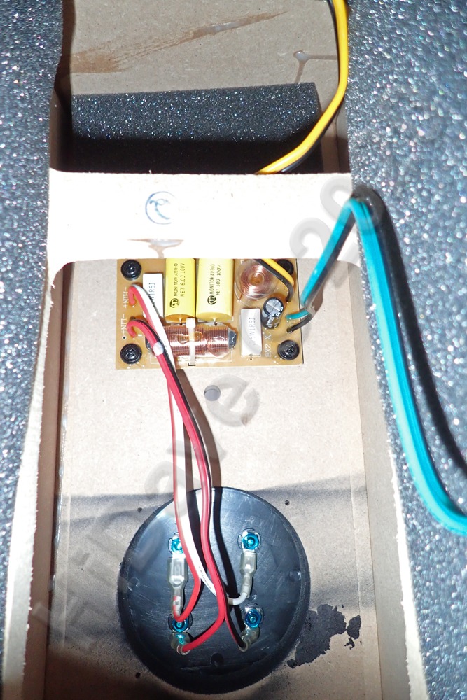

The cabinet itself has radiused front vertical edges, close spacing of the tweeter to the mid/bass driver & is front ported, with a large plastic panel on the rear for the four bi-wiring binding posts.

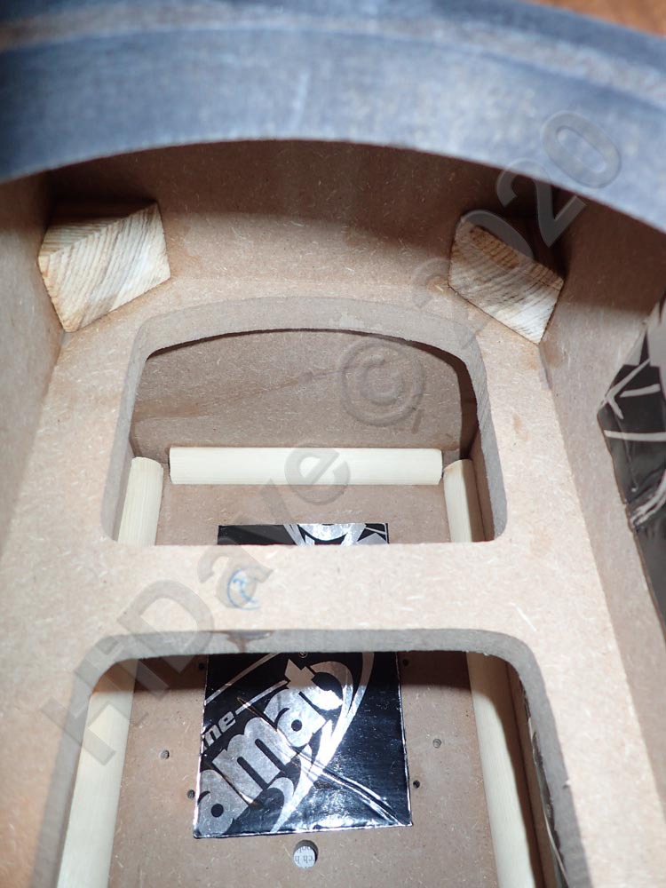

Inside the cabinet there were four blocks reinforcing the corners on the front panel, & one block on the full height figure of 8 brace mid depth in the cabinet. However, the back panel was not corner reinforced, & the cabinet was made using thin 15mm MDF. Grey foam sheet, 35mm thick, was used in the front section as sound damping & was stuffed around the mid/bass driver basket suffocating it, which is not good!! The crossover was mounted internally & high up on the rear panel.

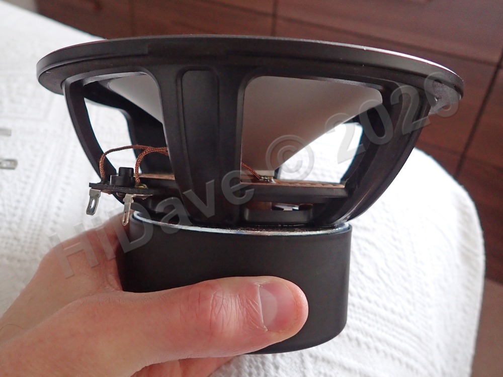

Of note is the unusual way the mid/bass driver is mounted, via a long furniture assembly bolt, through the back panel & into a threaded hole in the back centre of the driver/magnet. This supporting the driver’s heaviest mass & actually clamping the front & back panels together. However, the tightness of the bolt is critical as it affects the sound!
The 165mm mid/bass C-CAM (ceramic coated aluminium/magnesium material) drivers, marked 3 Ohm, have an ABS/polycarbonate basket, vented voice coil, shielded magnet, butyl rubber surround, & a pseudo phase plug/dust cap. The 25mm C-CAM, gold anodised dome tweeters, marked 4 Ohm, are fully back sealed. The drivers being better quality than I thought, in perfect condition & warranted keeping!

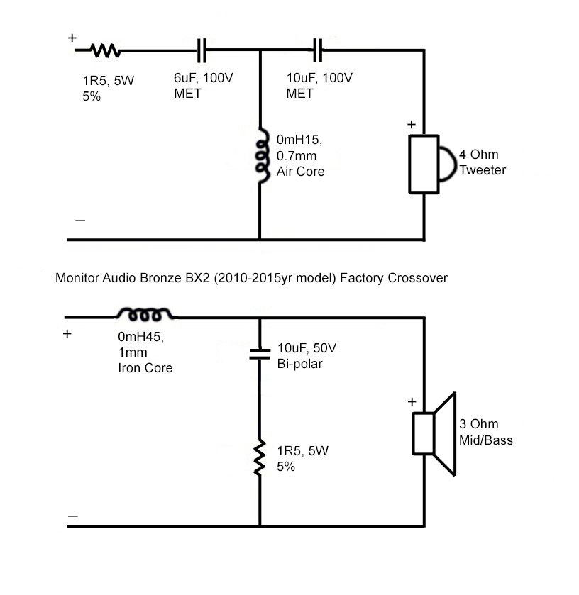

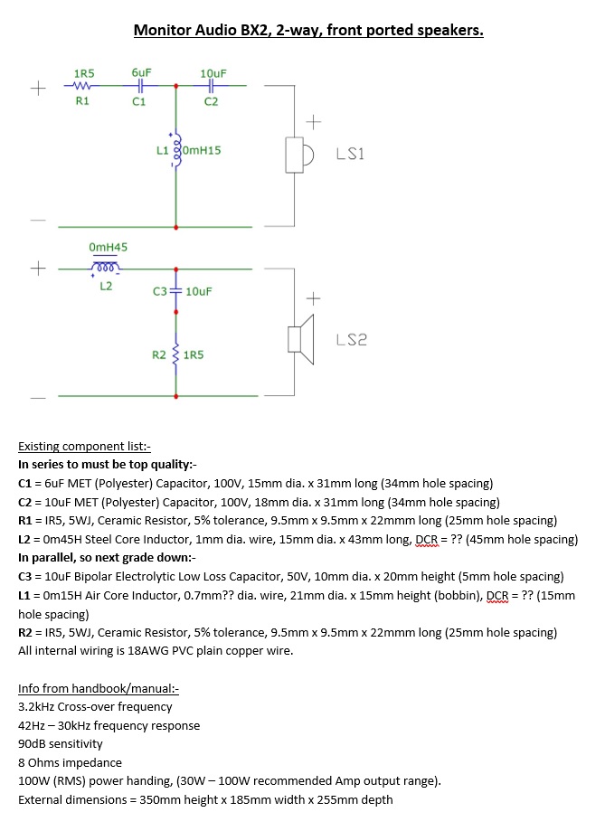

I manged to get the inductor values & crossover frequency (3.2kHz) in a technical drawing from Monitor Audio (I attach my redrawn version).

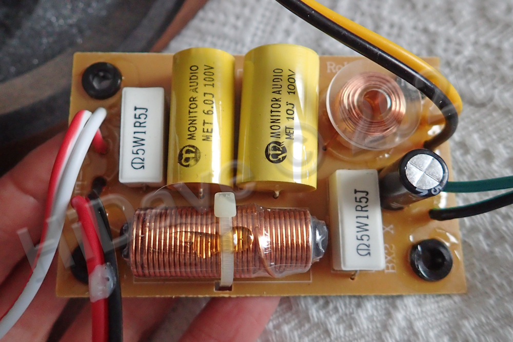

The crossover LF section is a 1st Order with Zobel network, & has an iron cored inductor, bi-polar electrolytic capacitor & a resistor. The HF section is a 3rd Order with a single series resistor beforehand (basic L-pad), & has an air cored inductor & MET poly caps. Both inductors were placed at 90deg to each other. However, basic sand cast resistors, & thin wire inductors were used, & the internal wiring was only 18AWG, with the components tightly packed onto a small board. Overall, good construction & decent speaker components were used, considering they retailed for only £250-£290 a pair!

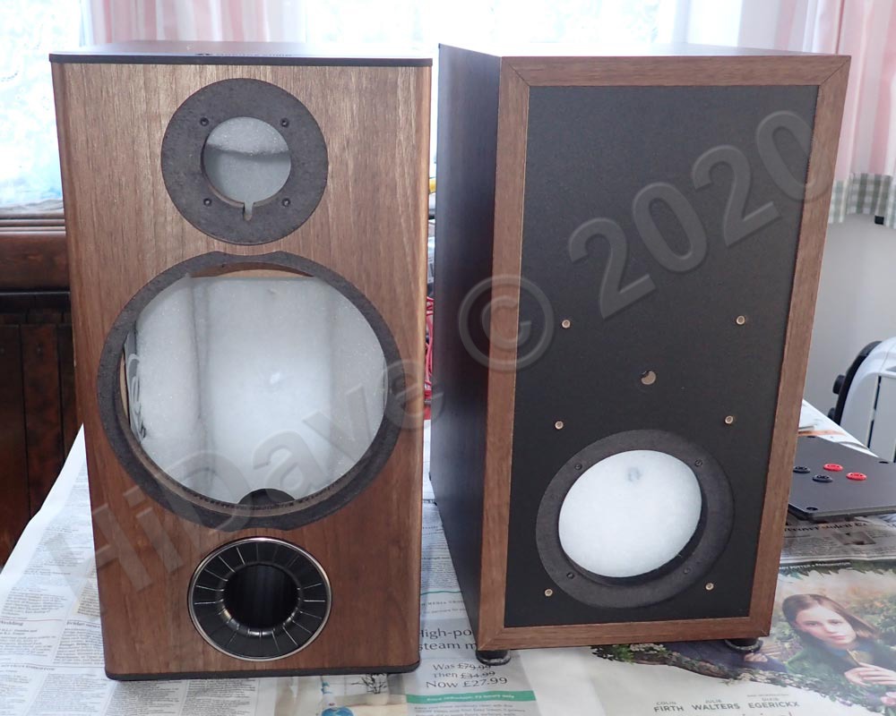

Modifications to the Cabinets:-

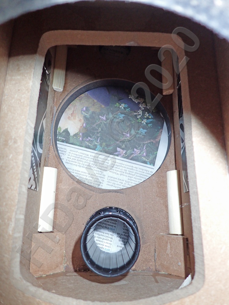

All components & sound damping were removed & all internal surfaces cleaned. Primed the MDF with diluted PVA, let dry, & applied Dynamat self-adhesive bitumen sound deadening sheets to cover the middle half of each section on each side & the back panel of the cabinet. I then made & glued three more wooden blocks to reinforce the corners on the full height figure of 8 brace. Pine quadrant beading (12mmx12mm) was glued to reinforce the whole way around the inside of the back panel, & parts of the front panel.
The sides, top, rear, & bottom panels were lined & glued (PVA) with standard 35mm thick white polyester wadding. The sides immediately next to the mid/bass driver & the bottom near the port were not lined to allow free air flow.

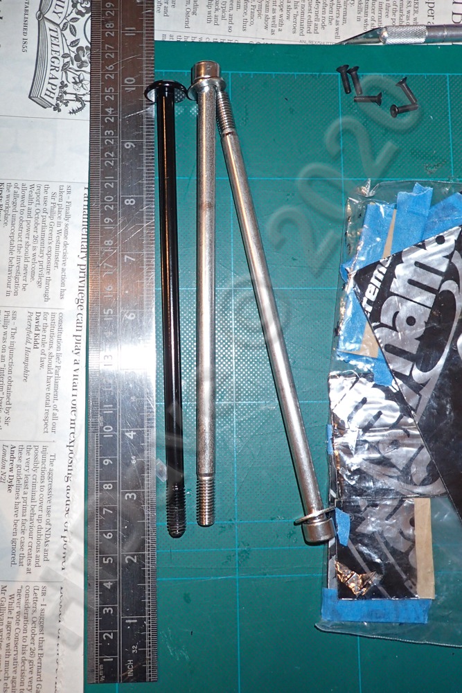

The highly magnetic furniture assembly bolt that fixes the mid/bass driver to the cabinet, was remade using a longer non-magnetic stainless-steel bolt, cut down, with a matching washer. When fitted, correct tightening is:- tighten to seat driver, holder driver in place, then undo just enough to cause the bolt to be loose, then re-tighten until it just stops wiggling then tighten a further 90deg turn.

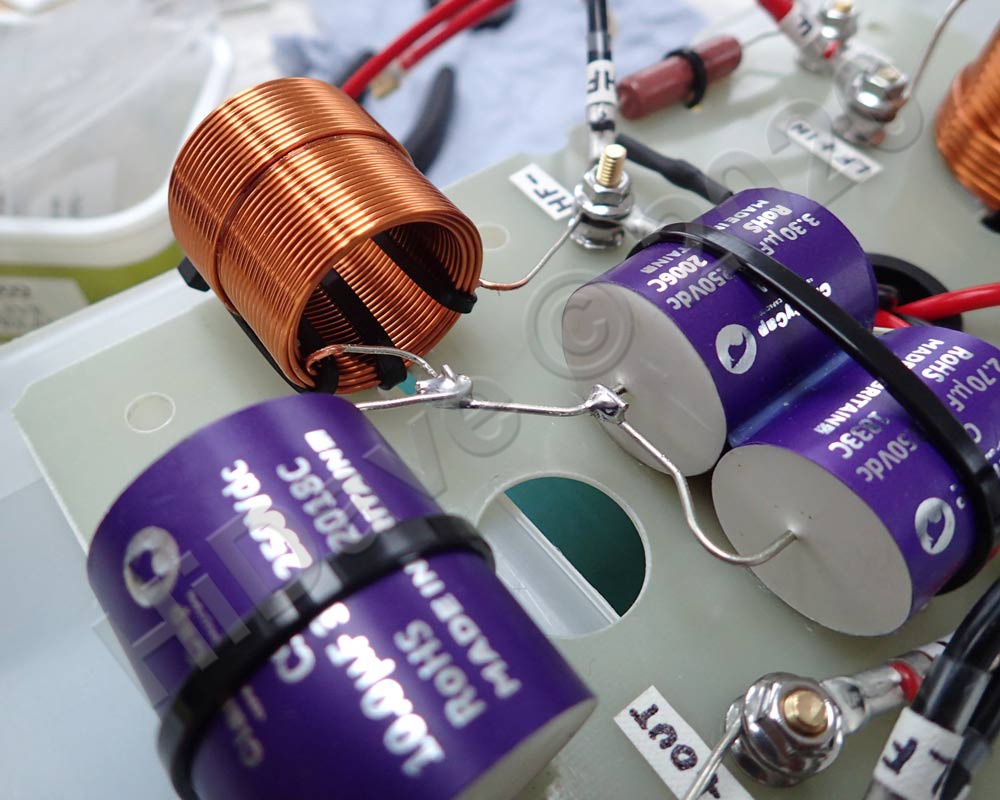

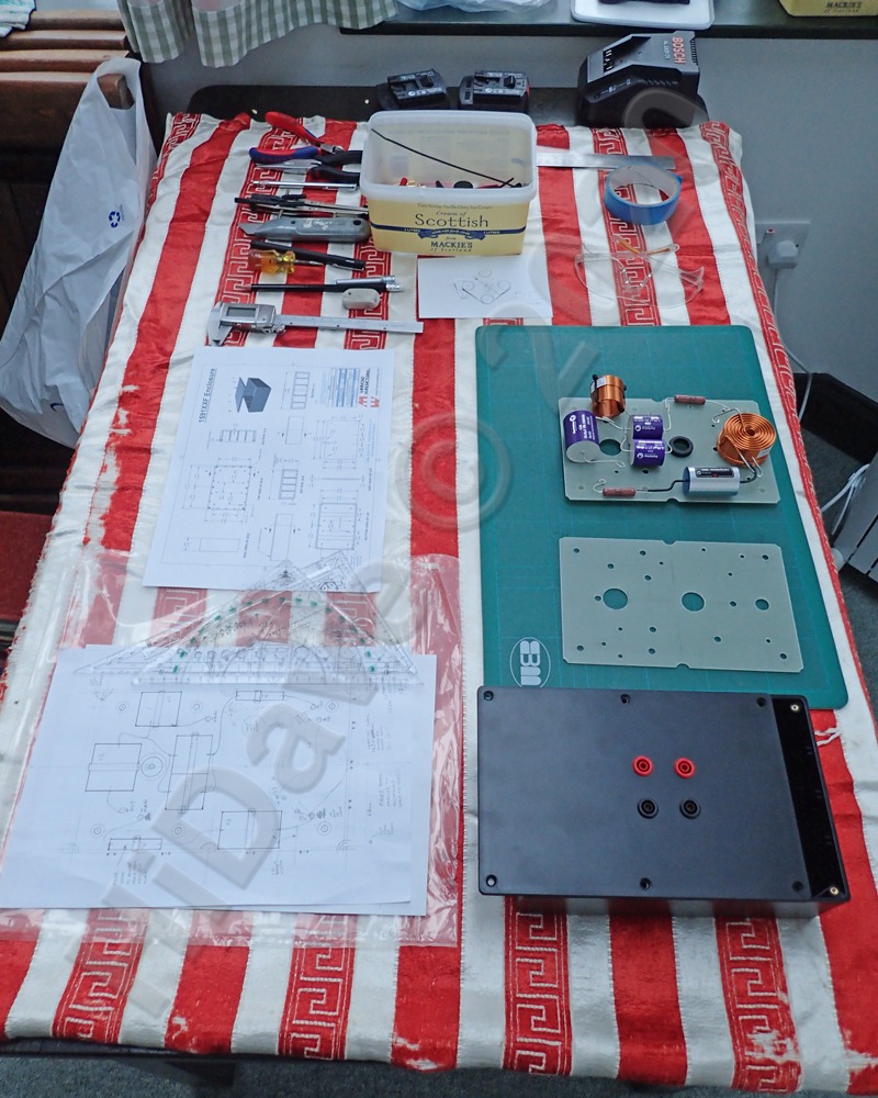

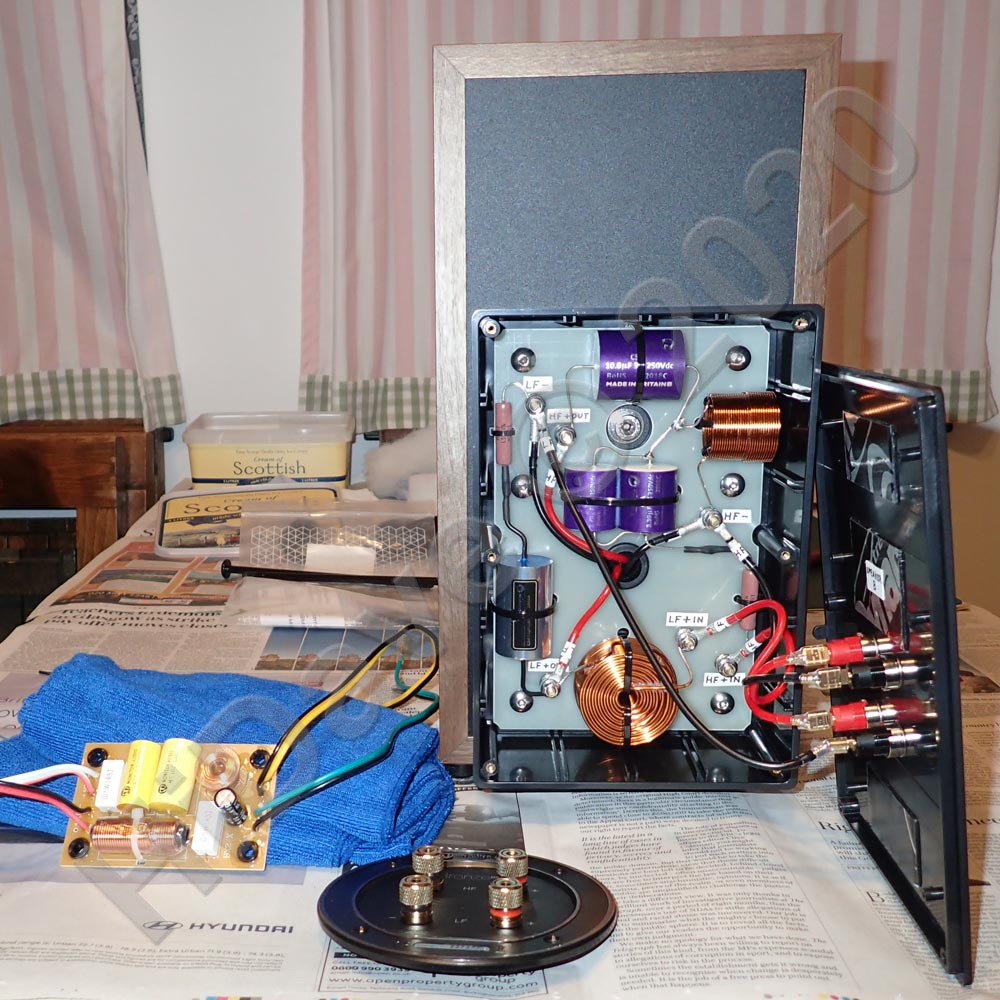

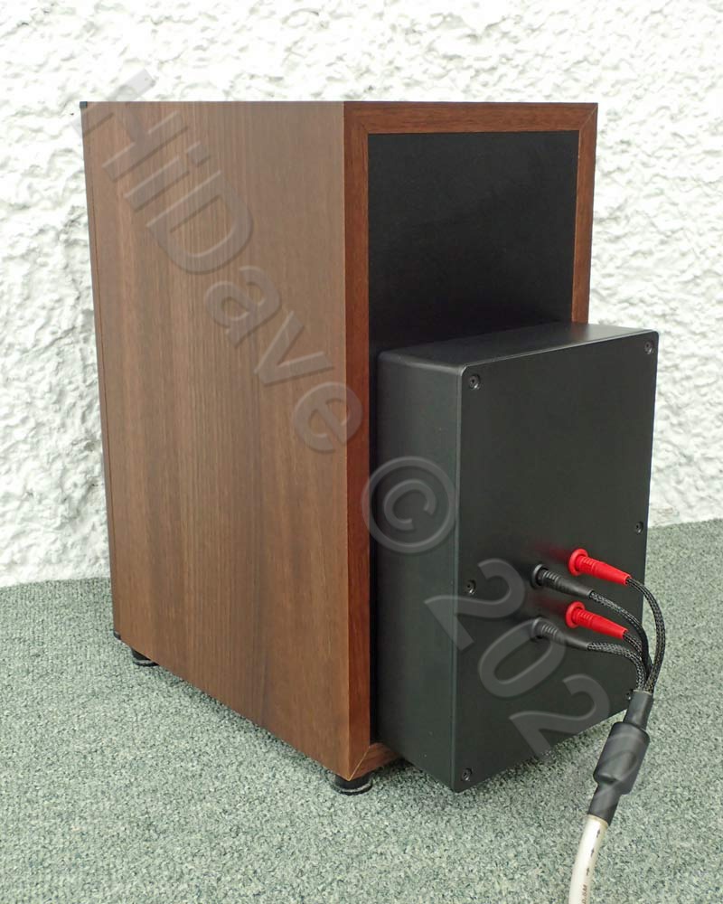

New Crossover Network & Box:-

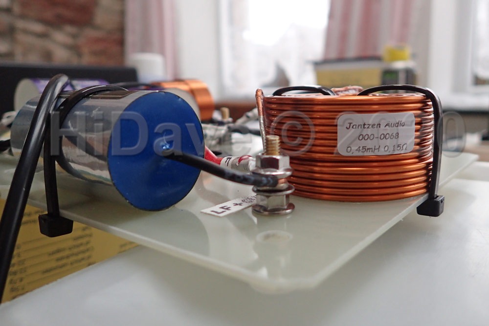

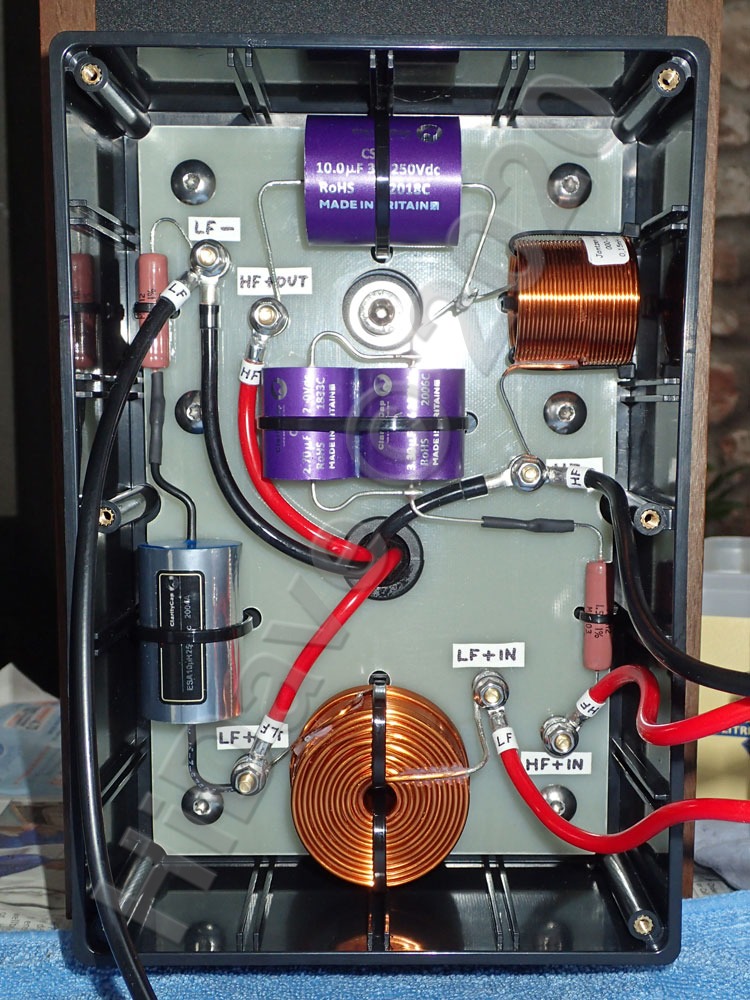

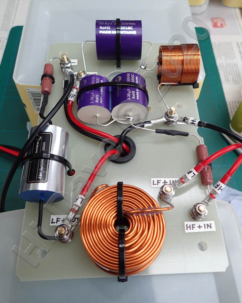

In order to space the components further apart, away from the drivers for less interference, & to cover the hole left by the binding post panel, a suitably large flame proof ABS box made by Hammond was chosen to mount externally on the rear panel.
The capacitor/inductor/resistor brands (ClarityCap, Jantzen, & Mills) were chosen as they repeatedly get good reviews, plus the caps were made in the UK where I am! The 250V CSA & ESA caps were chosen as both have a similar construction, low ESR, 3% tolerance, with the cheaper ESA version as the mid/bass shunt cap. Unfortunately, I couldn’t find a 6uF cap so had to parallel a 2.7uF & 3.3uF on the HF section! Due to the high 3.2kHz crossover point, I chose Jantzen air core inductors with a low DCR of 1/20th of the respective driver stated impedance & placed them at 90deg to each other with at least 10cm of separation. The AWG of the new LF coil was 14AWG with 18AWG for the HF, this up from 18AWG & 21AWG respectively! The Mills resistors were chosen due to low inductance & are the 12w 1% tolerance versions.

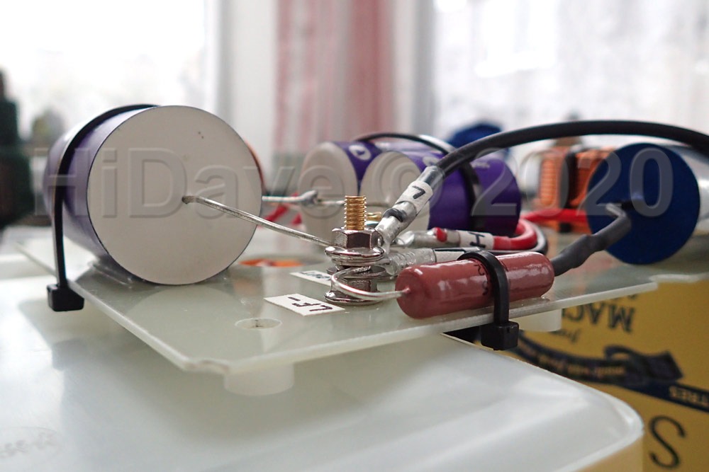

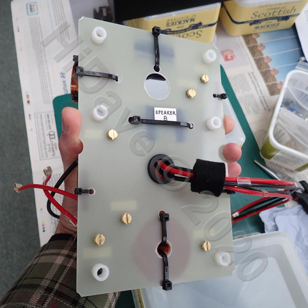

I mounted all the components on a sheet of flame resistant, no holes/no clad, FR-4 PCB board, using the correct neutral cure clear silicone sealant & heat proof cable ties. I made certain in the design of the layout that I was able to join all the components directly to one another’s leads & soldered.

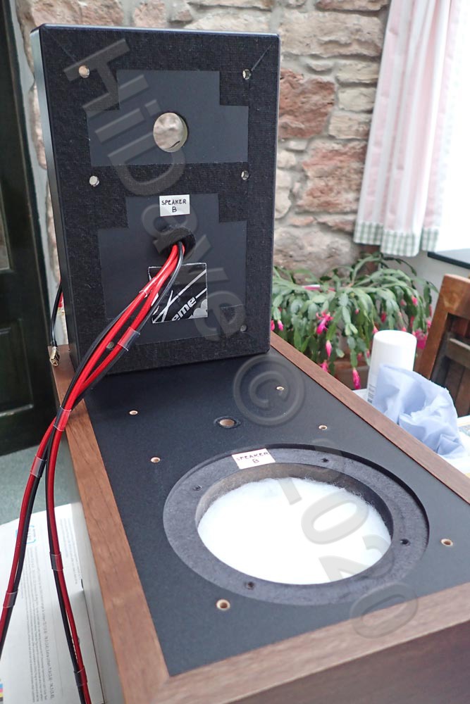

For the main cable connections on the PCB, a M4 brass machine screw with a stainless steel serrated washer was placed through from the reverse side of the PCB board & a stainless steel serrated flanged nut was screwed down tight from the front side making a fixed “stud”. A plain stainless steel washer was placed over this, then the capacitor/resistor/inductor lead was wound once around the stud, then the cable M4 eye(s) were placed over, then another s/s serrated flanged nut is used to clamp everything together. This making maximum clamped surface area contact, as used in many other electrical situations!
Plastic spacers, 10mm high, were glued (Superglue) to the underside of the PCB board for clearance of the screw heads & cable ties. Six mushroom head wood screws were used to go through the PCB board, spacer & the ABS box, to securely fix the whole lot to the back panel of the speaker. A small sleeve of heat shrink was used around the top of the screw shank to fill out the tolerance gap between the screw & the inside of the plastic spacer.
The rear face of the ABS box has a wide strip of thin felt (self-adhesive on one side) Tessa tape, to air seal the box to the speaker panel. Where the cables go through the ABS box into the speaker, I made a big felt sleeve to air seal them.

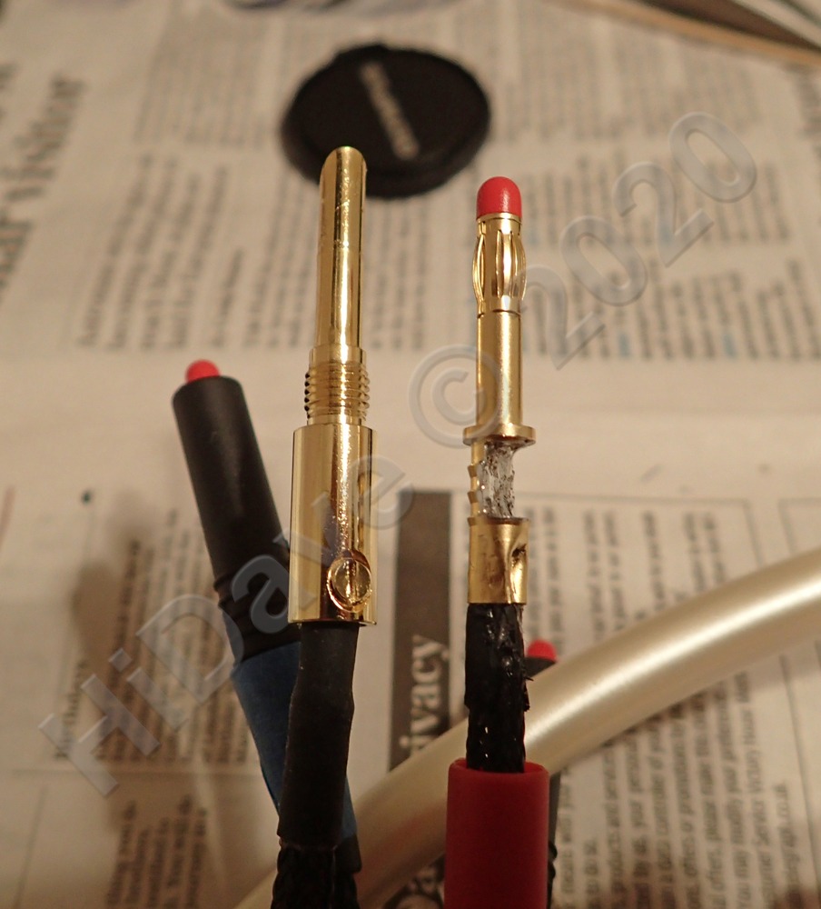

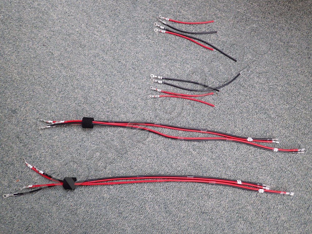

For internal wiring I used silicone insulated, 1000V, “test/measurement” OFC multistrand wire called “Silivolt-1V” made by MC/Staubli as its highly flexible & soldering iron resistant. Initially I used the 0.75mm CSA version, it being a similar CSA to the original 18AWG wiring, & to test a theory regarding cable CSA. These cables were terminated at one end with tinned M4 eyes with grips & tinned push tabs at the other. The wire was tinned & connecter was crimped, & all had clear heat shrink sleeving over them. (Later on, all the internal cables were “upgraded” & remade, see “Further modifications”)
I used MC/Staubli, gold plated brass connection, 4mm diameter shrouded test/measurement back panel sockets (with 6.3mm push tabs) on the box lid. The existing external speaker cables to the amp received the matching MC/Stabuli gold plated brass 4mm plugs & the cable ends were tinned/crimped/soldered. These 4mm test connectors were chosen as they have very little extraneous metal in them (compared to the previous Furutech ones), are non-magnetic & as these & the above cables are used in highly sensitive electronic test equipment, surely, they’re good enough for this use?!

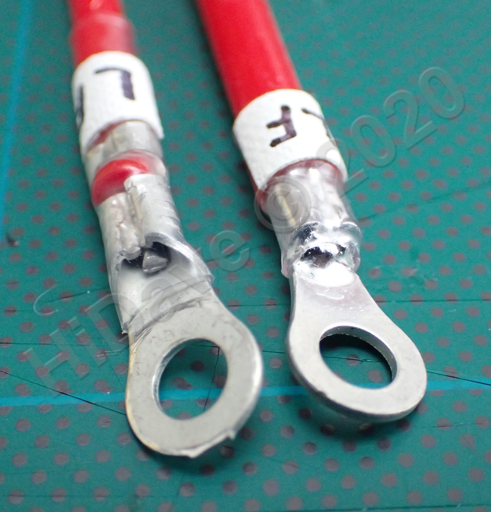

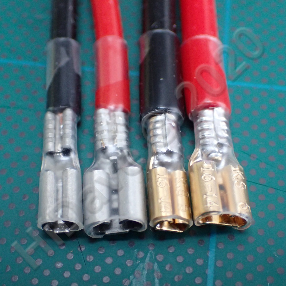

As I initially used 0.75mm CSA (18AWG) cable I did notice that the much lower bass/drum notes, although very clear, lacked body, or “oomph”. So, I remade all the internal wiring with the thicker 2.5mm CSA (13AWG) version & retested. Now the lower drums & bass guitars had the required conviction they needed without sounding “boomy”! I did not notice any difference to the mid or higher frequency notes with this cable swap, which was to be expected. As the maximum total length of internal wiring on any driver is 800mm, the resistance of the 0.75mm CSA is therefore 0.0208 Ohm, & on the 2.5mm CSA its 0.006384 Ohm, according to the manufacturer’s data sheets. These seem insignificant amounts, but there is an audible difference!
When I remade the cables, I now used Molex OFC M4 tinned eyes without cable sheath grips at one end, & gold-plated push tabs at the other end. The wire ends were tinned & connectors were crimped as before. However, now I fed solder into the wire/crimp. All ends again have clear heat shrink sleeving over them. Again, the push tab ends were all carefully compressed to be a proper tight fit on the speaker tabs, due to “odd” sizing on the driver tabs.
I also shortened some of the longer brass screw “studs” on the PCB board. These alterations to lessen the amount of unnecessary metal in the signal chain even further. I have also altered the positioning of the wadding near the drivers & port, several times to fine tune the “slam/attack” of lower notes.

CORNELL DUBILIER 940C Film Capacitor 3000V 0,01µF (Tony Gee)
Shunt position 0.15 mH air coil reused
Round speaker terminal assembly reused
Very pleasantly surprised (I actually never listened to them stock).
Really nice deep & tight bass, slightly warm (compared to my main monitors), no harshness in the treble.
Quite a bit of space and air.
Total cost Euro 210 for the speakers with stands, and about an additional Euro 200 for all parts

@speedmadness, If you want to reuse the existing board in its existing place, & thus keep costs down, I had thought of this scenario!
I would remove all the components from the original board & replace with better ones that fit in the spaces.
- You could use the Mills resistors or similar, you might have to have them standing up from the board instead of glued flat due to their length, but please bin the cheap resistors!
- The electrolytic cap, use 105C full size Panasonic Audio grade caps, or similar which would be a direct fit, but much better than the originals.
- The MET Poly caps, again you should be able to fit a better cheap set of similar size.
- The inductors, you would have to use an iron cored for the bass/mid section, but you should be able to fit one that has a thicker wire. The tweeter section, keep to air cored, but again use one with a thicker wire.
- Cables, you could leave the tweeter section cable alone, but you need to use thicker cables on the bass/mid section.
@speedmadness ...I attach as a JPEG the specs & existing component dimensions & hole spacing for the factory X-over. This should help you when looking for parts when reusing the factory PCB. I also re-attach my photo of the factory Monitor Audio X-over from the BX2 speakers.
