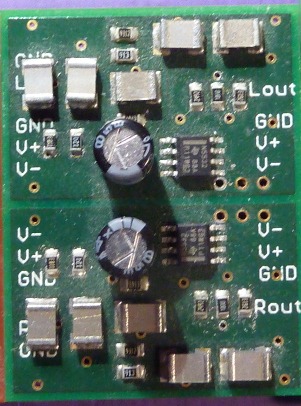

I've just finished the build for the first pcb of my modular phono preamp project.
It does RIAA compensation and basic amplification suitable for an MM input.
I intend to design an MC stage pcb, an input connector pcb, an output connector and power pcb (perhaps with battery option), a rumble filter pcb. They will slot together with dupont-style edge connectors, allowing various configurations.
The two channels are independent in this pcb, roughly mirror-image, allowing a star-ground to be used at the power supply end.
SMT is used where possible to keep size down. PPS capacitors seem to be the best compromise for low distortion and SMT availability - here a single value, 10nF, is needed.

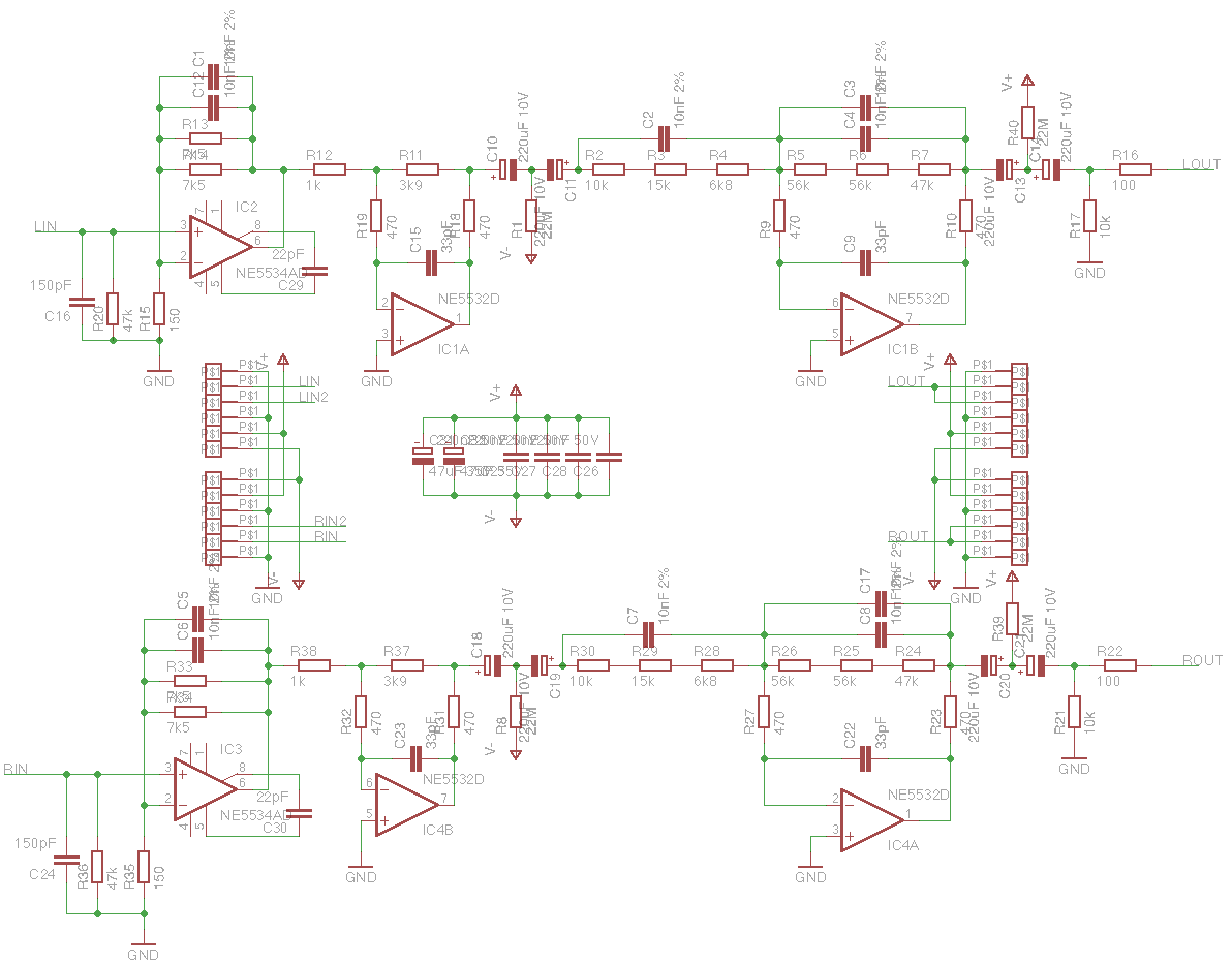

The RIAA circuit topology is slightly unusual in that each of the poles and zeroes is an explicit separate RC pair. Care has to be taken to keep the opamps stable into capacitive loads in this topology (the 33pF capacitors and 470 ohm resistors).
The nominal component values give exactly 75µs, 318µs and 3180µs time-constants. Alas I could only source 2% PPS capacitors, but 0.1% thin-film resistors are used throughout.
Where DC-blocking is needed I used back-to-back electrolytics of high value with a centre bias to keep them formed over time. The 22M resistors were a guess for this purpose - the time constant is measured in hours so in theory won't have any impact audibly.
There is no input DC-blocking capacitor, as my calculations show the tiny bias currents of opamps are not going to have any effect on a MM pickup (despite what a lot of people glibly state). 500nA in a 1k5 winding gives an offset of a fraction of a mV, and a few mA-turns of magneto motive force, insignificant compared to signal levels, especially when the inefficiency of the MM cartridge as a motor is considered. I think I'd need to see some hard evidence to the contrary, such as a plot of THD v. offset current.

Looks good Mark, have you listened to it yet? measurements? nice that we can make cheap high quality pcbs for our protos. looking forward to your MC implementation.
I remember one of my first phono amps I built, using a NE5533 dual as shown in the Signetics app note.
What do you have for RFI filtering at the input? I see that Self does not use any either in the Elektor 2012 phono design.
One thought you could combine MC/MM on one pcb since your are isolating channel grounding.
I am not sure of the advantages or finding a way to demonstrate that some of your design choices have merit for but hey why not experiment.
Do not think I have ever seen a audio design where they bias an ecap such as R39,41

The whole point of modular is not to combine functions on one pcb!
The unusual filter topology was just conceit really - its not efficient in opamps, but does make the component calculations trivial. It would be more rational in a general purpose equalization unit as each pole and zero can be individually switched/controlled. Of course the idea is limited to real poles and zeroes only.

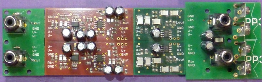

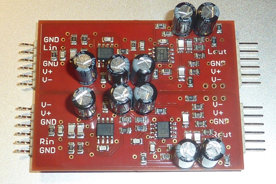

An update on the modular RIAA amp. I added a rumble filter module and input and output modules (the latter with PCB connectors for two 9V batteries) to make a complete working system.
The rumble filter is 10 pole Salen Key Butterworth:
The full suite of boards:
And the flat style SMT pin header connectors:

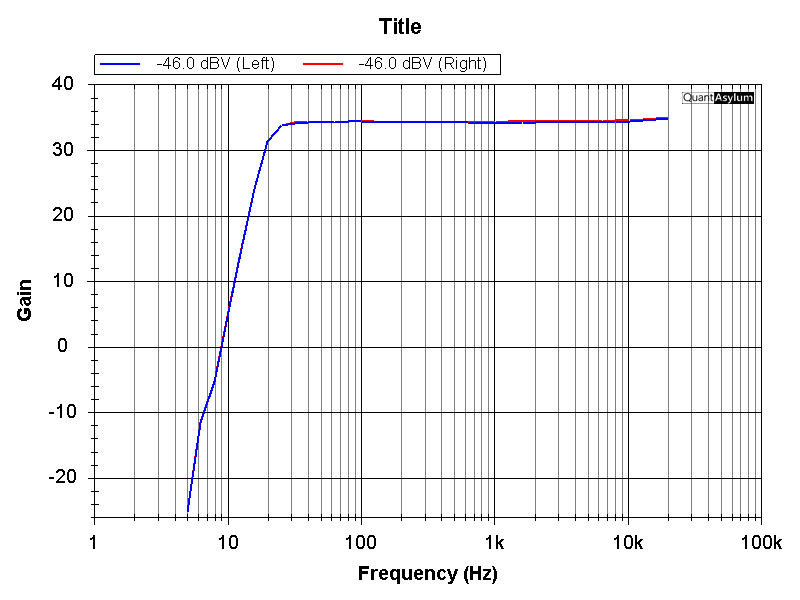

I've put together a simulation of the rumble filter to show its response, and this version of the schematic has readable resistor values (!)
[BTW I meant 5 pole above, not 10 pole, ie 30dB per octave]
This is a 3rd-order Salen Key highpass followed by a 2nd-order Salen Key high pass.
Which is a nice 30dB down by 10Hz with a -1dB point of about 23.5Hz and -3dB at 20Hz - possibly slight overkill but only 2 opamps and the caps are all identical (I used PPS 100nF 2% (Panasonic ECHU) for the surface mount board).

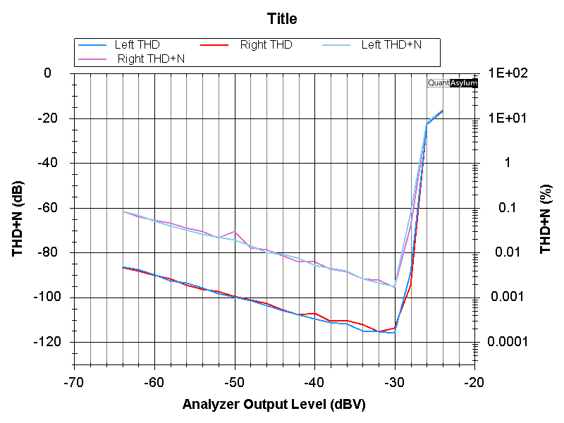

I recently measured the performance of this preamp, and also realized the images have gone away so first I'll repost the images:
RIAA preamp:
And the rumble filter:
The schematic of the RIAA preamp section:

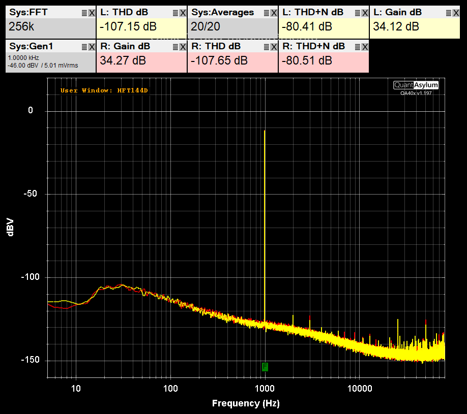

So now the measurements (with RIAA plus rumble filter, power +/-9V), 5mV input yields:
And plotting THD and THD+N against input level:
And frequency response weighted by RIAA inverse curve:
RIAA preamp:
