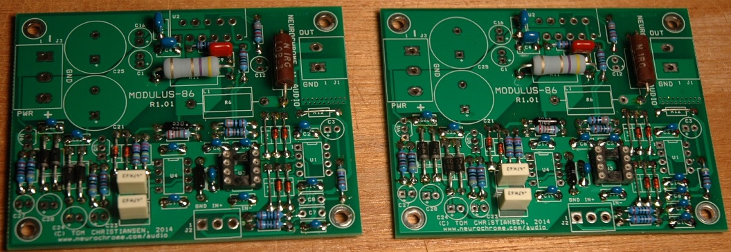

Show and tell; excuse the table background. First pic shows the boards. Not the smallest 3886 PCBs out there, but pretty compact. And the box of components from Mouser. Never used the project ordering system before, but it's worked perfectly and all components are labelled by location to make it almost idiot proof. The heatsinks are £10 each off ebay. they need a clean up, but should be more than adequate for my needs.
Still not 100% on the rails to use. The heatsink is around the 0.5K/W mark, so with 2 boards mounted on it could run at +/-28V rails, but as the ribbon tweeter is 3.8Ohms current is king. I need to measure my incoming AC under a couple of situations then will decide on either 18 or 20v secondaries on the toroids. 18V is the current fave as that will give me +/-22V rails. if you look at figure 4 of the LM3886 spec sheet you will see that you benefit considerably in current capability at the limit dropping a few volts. Does that really matter? Unlikely, but as I am right at the limit of impedance that the chip is designed to drive it can't hurt.
Some my comment that my heatsinking is OTT on 22v rails. Possibly, but I know I will be able to add a 3rd board on each side if I need that as the speakers evolve with no worries on thermals.
Doing a sanity check on the power required, the speakers when new have their max output specified with 100W/4Ohms and recommend 150W/4Ohms. The crossover point (750Hz) means that around 40% of the music power is to the ribbon and the rest to the woofer. As I have a sub for the bottom octaves its nearer 30% to the woofer. So 40W/4Ohms into each is fine? In fact that's more than you need. When you go active the splitting of the spectrum gives you a doubling of effective power. so 2*25W/4Ohms into the active system will give me the same as 100W into the Passive version. I will be around 40W/4Ohms per channel, so considerable headroom. If I wasn't needing to add some boost to the bass to compensate for baffle losses I could drop to 20v rails no problem.

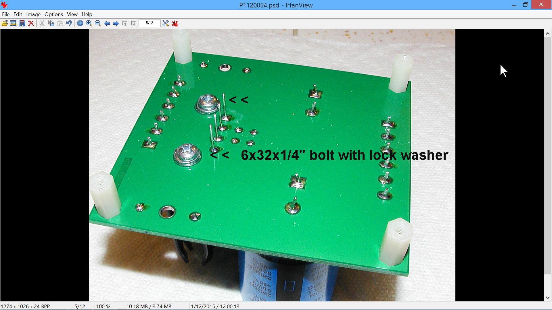

Modulus-86 Power Supply

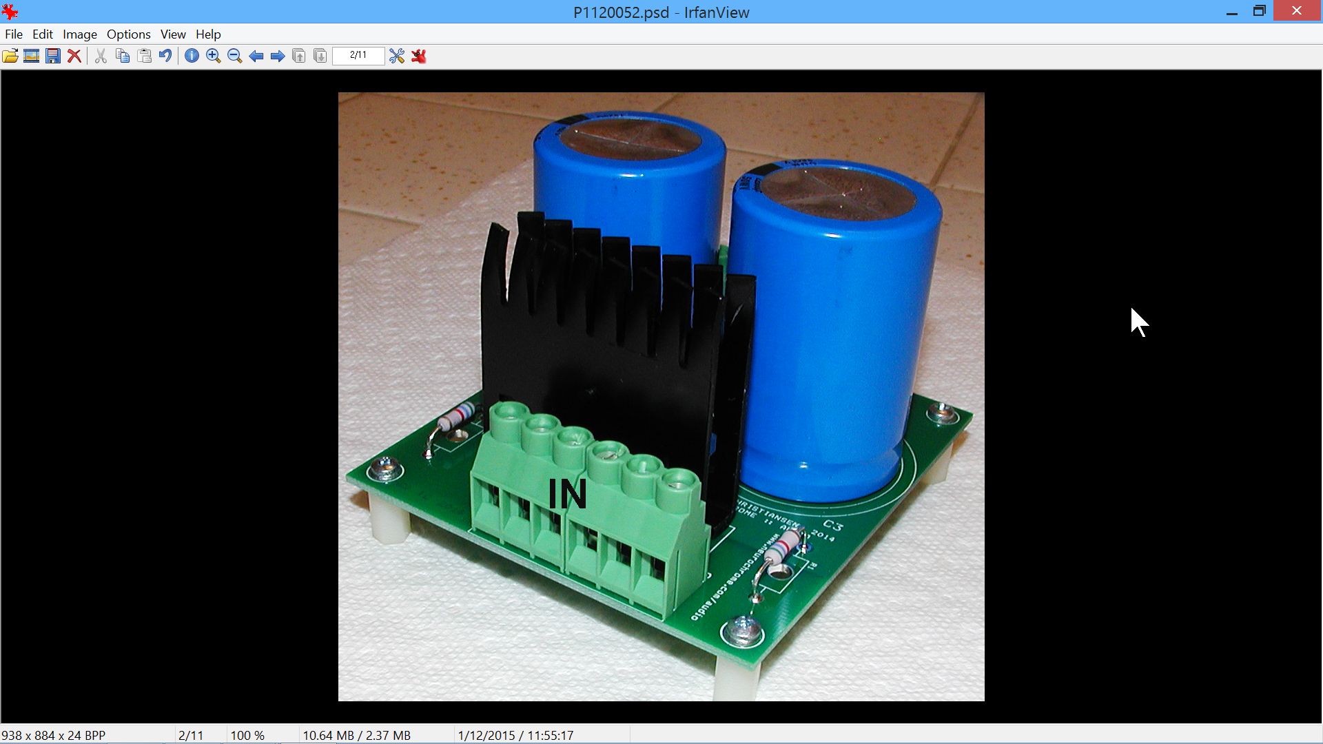

Couple of photos of my assembled power supply.
Since both in and out connections are very similar, I marked a photo
of the side where the transformer connects to avoid possible confusion.
I had the hardware on hand & decided to attach the heat sink with bolts
& washers instead of solder. (Bottom view.jpg)
Some of the leads haven't been trimmed in the photo.

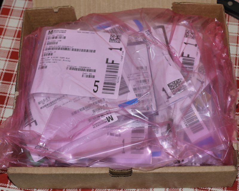

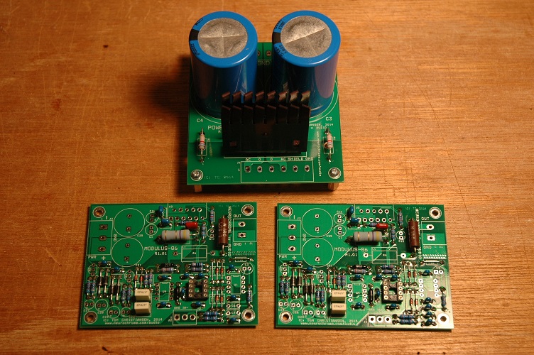

My Power86 is done, the Mod-86s are 2/3s done.
Some ideas I thought of so far:
1. Add "C22 and C26" to the customer part number on the Mod-86 Mouser project list so it gets printed on the part envelope (0.1uF ceramic.)
2. Maybe put a project name or prefix in the cust part# to help with sorting the parts when different projects are ordered together in one big box.
3. The TDK caps' tolerance isn't great. C15, nominal 150pF, parts were actually 214pF. C10, nominal 100pF, parts 164pF. Other TDKs similar, but they are pretty!
You may want to check the calibration of your capacitance meter. Usually there's a knob that you need to turn to calibrate out the test lead capacitance when measuring small capacitances. The caps are ±5 % tolerance as I recall. TDK is a reliable manufacturer and I expect their parts to meet the published specs in the data sheet.

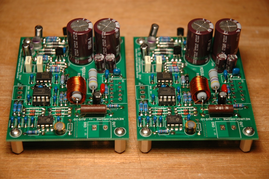

Almost finished the amps today. Last remaining step is soldering the 3886 after the box is built. Next up is the box, then IC cables.
The Modulus-86s took about 6 hours to build both boards. The Sympaticos went together in about half hour because much of it is SMD, presoldered to PCB.

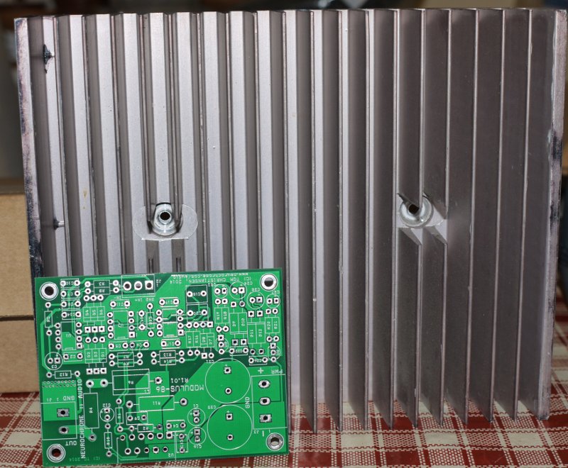

I already have big heatsinks so I'll diy the box with wood and aluminum sheet to fit the heatsinks. Not designed it yet.
Eventually I'll need two boxes with 3ch amps in each one, for active crossover speakers. For now I'll make stereo amps to audition the amps with passive crossovers.
