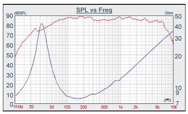

Hello, has anyone ever had experience with Monacor SPH-220HQ 8'' woofer? Here specs and measurements.
The declared response:
and the measured one:
It seems to me a good woofer, with extension in both low and high regions and i'm wondering to use it in a 2 way system.
What do you think about?
What may be a suitable tweeter to use with?
Thank you very much!

Yes, it's quite a nice driver of the type. Motor isn't the most advanced, but it's well made and the ones I had experience with were fairly accurate to the published data. Little bit of energy storage around 1KHz, but not as much as some. I made the mistake (I really should have known better) of running it with a ribbon tweeter -don't go there, most simply can't get low enough for the polars to align without distortion on the ribbon rocketing. It wasn't bad, but not as good as it could have been with different design choices. Useful learning experience. It'll work well with any number of decent domes, from budget to quite expensive ones. Depending on where you cross, I wouldn't have much hesitation in partnering it with, for e.g., a Satori, a Scan Illuminator, or Bliesma at the pricier end. Plenty of cheaper options too from Seas, Scan, SB, Peerless etc. Since it's an 8in, if you're going 2-way I'd generally try to cross lower rather than higher so you've got a decent off-axis; that means the tweeter does need to have reasonable LF distortion performance.
Well, how is your German? Otherwise use Google Translate for this design. Whereas I don't think it's a drop-in, the high section with waveguide matches the 8" woofer very well (look at the dispersion plots). I haven't met him around here, but Alexander is quite competent on designing loudspeakers.
That woofer looks like it would make a very nice sealed bookshelf speaker. F3 arounf 54 Hz. Thank you for bringing it to my attention
I've found this driver looking for a gear to use in MTM (WTW of course) configuration, my ideal loudspeaker if able to go under 30 hz. Unfortunately this woofer has a high VAS and QTS so probably I'll go to a classic WT and use a quite net 70 liters cabinet, even in TL or TQWT, ML or not; unfortunately bigger cabinets aren't allowed by muscle capacity of my back..
Of course if I'll find a 8'' able to reach the lowest frequencies with a good response in the cross area like this but having a lower VAS and/or QTS I'll certainly return to my original WTW loved idea, but 'til now I wasn't able.. any suggestion about this please?

A Qts of 0.4 is not high IMO and, in fact, an almost perfect value for good performance in a tapered TL or ML-TL. For this woofer (a single woofer) I modeled an ML-TL with a net cabinet volume of 65 liters. The cabinet's internal height is 40", the woofer's center is located 10" below the internal top, the mass-loading port's center is located 4" above the internal bottom, the port has a 2.5" diameter and a 5.5" length and the top half of the cabinet is stuffed with polyester fiber at a density of 0.75 lb/ft3 requiring a total of ~14 ounces of poly fiber. The modeled width and depth are 9" x 11". This resulted in a system tuning frequency of ~27 Hz, a predicted f3 of 30 Hz and an f6 of 24 Hz with a 2.83v/1m sensitivity of 89.7 dB SPL. Increasing the input power to 15 watts into the woofer's nominal impedance of 6.1 ohms increases the output SPL to a smidge over 100 dB with the woofer first reaching Xmax (3.9 mm RMS) at 40 Hz and again at 22 Hz, then exceeding that at all lower frequencies. The peak port air velocity is 13 m/s and occurs at 20 Hz. The only negatives regarding this woofer are it needing a large volume to be able to get down to and below 30 Hz with reasonable output and its somewhat limited Xmax which ultimately limits its maximum SPL. Using a WTW format would solve the Xmax and SPL limitations at the expense of needing a larger cabinet. I've attached 3 of the resulting modeling graphs.

Okay, I found time today and modeled an ML-TL WTW for the Tang Band woofer (woofers wired in parallel). The internal cabin dimensions I modeled with were 9"W x 13"D x 46"H for a net volume of 88 liters, but you would build it with a width of 9.5" (93 liters of gross volume) in order to provide compensation for volumes consumed by drivers, port, braces, etc. The tweeter's center is located 11" below the internal top and is the TL's design center, with the woofers located close to the tweeter. The port's center is located 5" above the internal bottom. The port has a 3" diameter and a 5.5" length. The top half of the cabinet is filled with polyester fiber at a uniform density of 0.75 lb/ft3 requiring a total of ~18 ounces of fiber. The resultant tuning frequency is ~28 Hz. The attachment shows 3 of the modeling graphs with an input of 20w/1m into a nominal impedance of 3 ohms. F3 is just a hair over 30 Hz. The 20-watt input causes the woofers to reach their specified Xmax of 3.9 mm Peak (2.8 mm RMS) at just over 40 Hz and again at 21 Hz. The port's peak air velocity of 11 m/s occurs at 20 Hz. The 2.83v/1m sensitivity modeled at 94 dB SPL.
Paul
Paul
Keep in mind that my modeling used published specs for both woofers you listed and won't necessarily be optimum if the woofers you use differ significantly from the published specs. I do appreciate your compliment.Many many thanks Paul! And I've just now realised who you are! It's my lucky day : )
Without a doubt, certainly, as soon as I'll have four and measure them.Keep in mind that my modeling used published specs for both woofers you listed and won't necessarily be optimum if the woofers you use differ significantly from the published specs. I do appreciate your compliment.
However, I would be happy to know why your choice on the woofer loading system often fell on this particular type of TL, and what are, if possible, the differences in terms of sound between the possible variants (straight TL, tapered TL , TQWT and 'bass-reflex like' as yours), referring for all to ML types.
I really thank you.
I consider a straight TL (not tapered and not mass-loaded) as an essentially useless design. Unless you stuff the life out of it, it has numerous dips in its response, and if you do stuff it heavily to minimize those dips, you've killed the bass response significantly. An equivalent negatively tapered TL, with a taper ratio of at least 8:1 to10:1, very effectively minimizes those dips, and minimal stuffing is required, resulting in a line that's 40% or more shorter than the straight line. I've designed and built tapered lines having taper ratios of 16:1 to 25:1 that performed quite well. I'm not sure what a TQWT really means and I think this nomenclature is sometimes misused. It could be a Voight-type pipe where the line has an increasing area and the driver is located around halfway along the pipes length, and either a port or hole beyond the driver to complete the system tuning? Quite frankly I can model two longish lines with the same length and net volume, one negatively tapered at 10:1 and the other mass-loaded with a port and the results will be very similar. The tapered line will have a much lower air velocity in its terminus, while the mass-loaded line will have a bit lower F3 as well as a bit smoother response about 200 Hz or so. Also its a bit easier to tweak the system tuning in a mass-loaded line with the port's dimensions, but to my ears these equivalent lines sound the same for all practical purposes (unless you're an audio magazine reviewer😉 ).Without a doubt, certainly, as soon as I'll have four and measure them.
