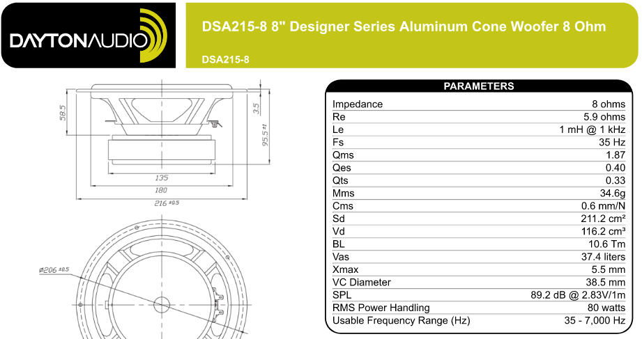

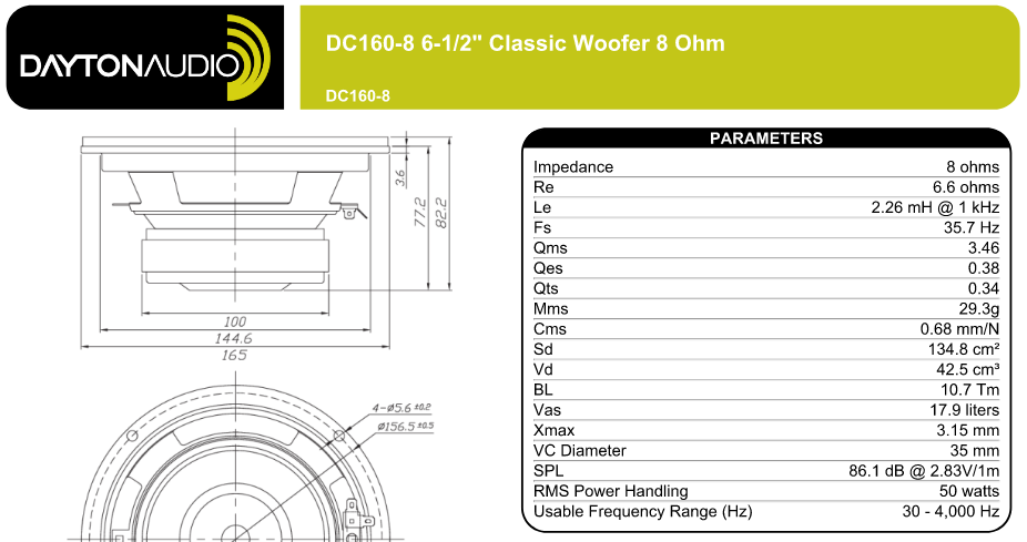

You talk of two smaller woofers vs one larger. Here I have found specs on two commonly available 8 ohm woofers.
The first is 6.5" and the second is 8". Both have fs and Qts around 35Hz and 0.35, and the smaller ones have Vas half that of the larger. This means both options will give a Qtc of around 0.7 at 70Hz working into 12litres.
The sensitivity of the 6.5" drivers is 86dB and of the 8" is 89dB. Since the 6.5" would be used as a pair, they will give 92dB, but will also use 3dB more power.. so dial it back by 3dB.
Each option gives you the same sound out for the power in, in the same volume for the same response.

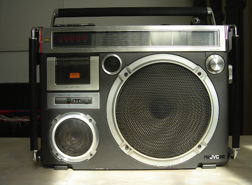

Sure but, have you see those old humongous boomboxes with a single 8" woofer?
