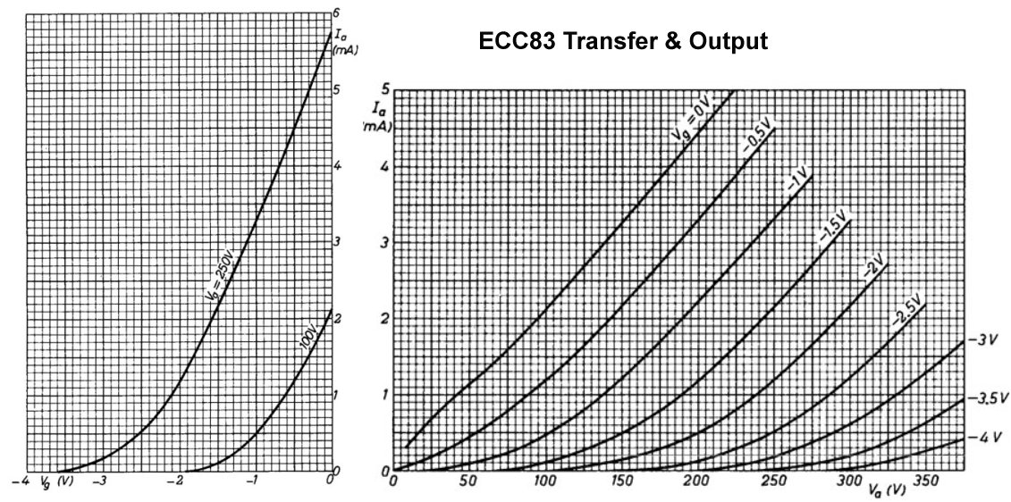

I read that a MOSFET can simulate a Triode to produce even harmonics, said to give a more pleasing listening experience. As a Source Follower a massive 3rd harmonic is produced, but as a Grounded Source the harmonic is the 2nd. Your comments, please.

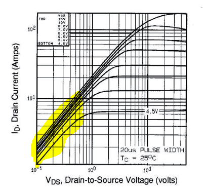

https://www.vishay.com/docs/91202/irfp140.pdf
The idea is to force the mosfet working in non linear region highlighted below.

Notice the output swing (volts) - a 'semi-triode' would do 1/10 of the tube range and be very happy.
A triode has concave curves, whereas without adjustment gear, semi's have convex curves.
Also, the triode (or a 'triodized' semi) has a 'moving' transfer characteristic, due to the anode (drain/collector) voltage.
Without the exception of V-fets (and comparable devices), no other semi's exhibit this behaviour.

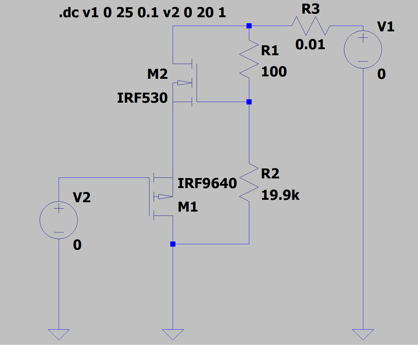

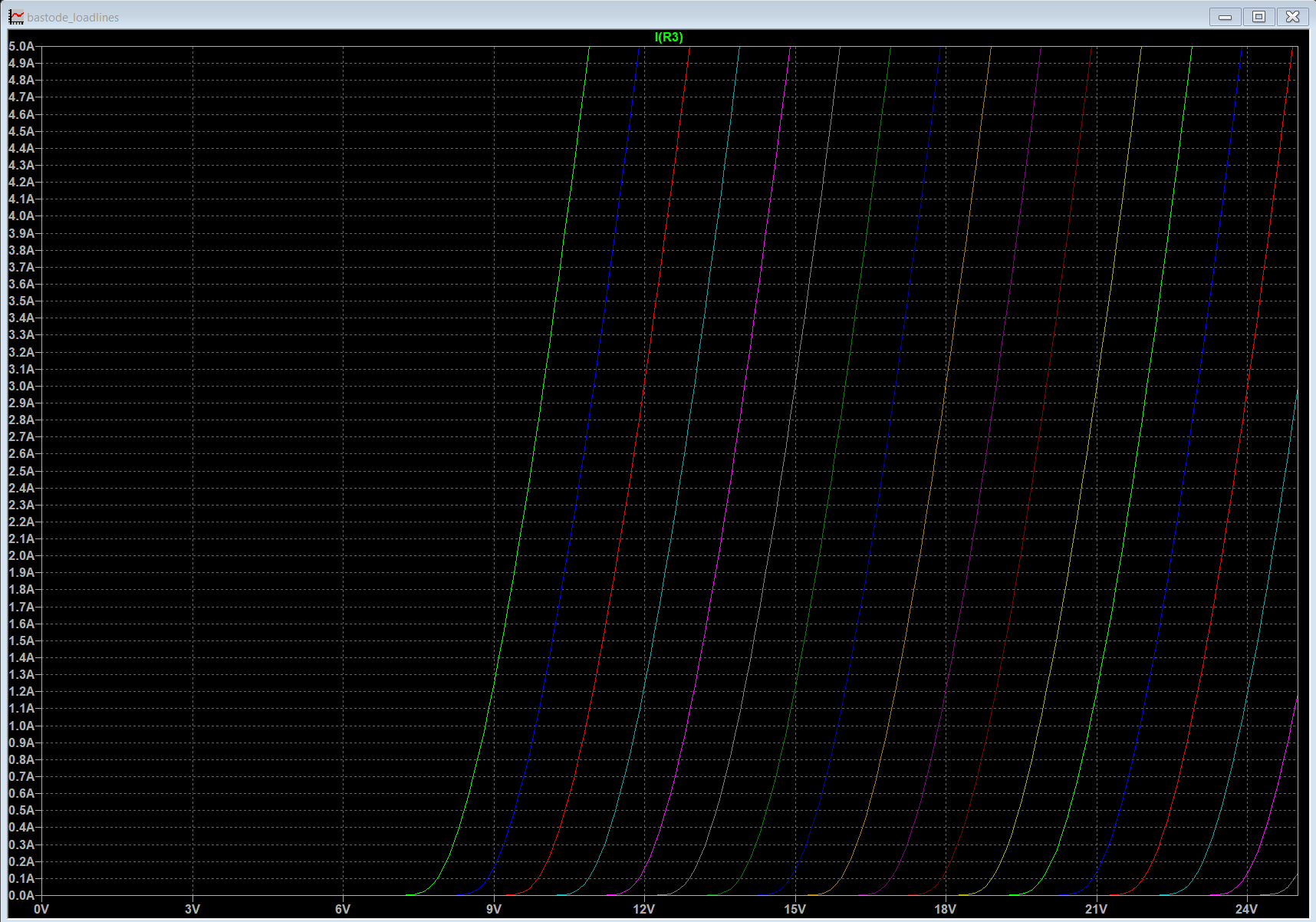

Do you think mosfet arranged in bastode connection's loadline "triode" enough?I read that a MOSFET can simulate a Triode to produce even harmonics, said to give a more pleasing listening experience. As a Source Follower a massive 3rd harmonic is produced, but as a Grounded Source the harmonic is the 2nd. Your comments, please.
