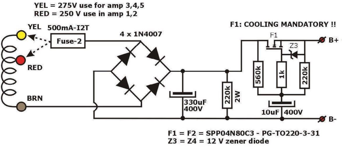

I plan to use the attached circuit from Menno van der veen's article on AudioXpress in the power supply of a single ended EL84 amp. The voltage after the rectifiers will be 320V. The current is around 100 mA max.
I found this MOSFET IPAN70R450P7S from Mouser. The datasheet link is here https://www.infineon.com/dgdl/Infin...N.pdf?fileId=5546d4625f2e26bc015f499adf55405f.
What are the specific requirements for the MOSFET in this circuit? Is there any concerns on using IPAN70R450P7S? Since this part has built-in protection diodes, do I still need Z3? What will be the voltage drop across the circuit?

L2 series is better, in therms of power handling.
Requirements are 1: very old mosfet with a big die, or 2: Linear FBSOA optimized mosfet.
Modern switching mosfets just wont survive.
Why won't switching mosfet survive? For instance, STP11NK40Z.
I would definitely use a gate-source zener and a small series current limiting resistor.
IXAN0068 is the IXYS application note that explains this better, IXY's L2 optimized parts are much better at surviving DC operations as found in a cap follower.

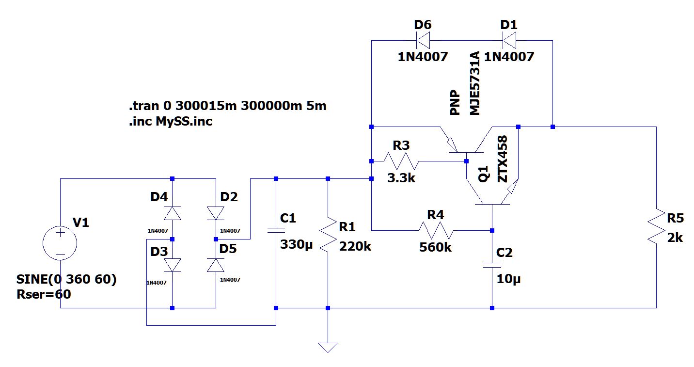

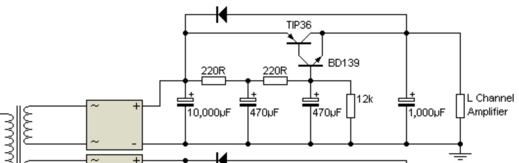

A BJT drops 0.55~0.60V, while the MOSFET will drop at least its Vgs which can be a few volt to many volts depending on the device selected. On high voltage rails, a few or dozen volts loss might not be problem for the fed circuit, but the dissipated power (dVxI) will be much higher when using a MOSFET.
TIP36 ---> MJE5731AG qty=1 price USD 1.36 at DigiKey
BD139 ---> ZTX458 qty=1 price USD 0.65 at DigiKey
BUT... please add two reverse VBE protection diodes, and also please add a non-infinite collector load resistor for the NPN. 3.3K would be a nice choice in my opinion.

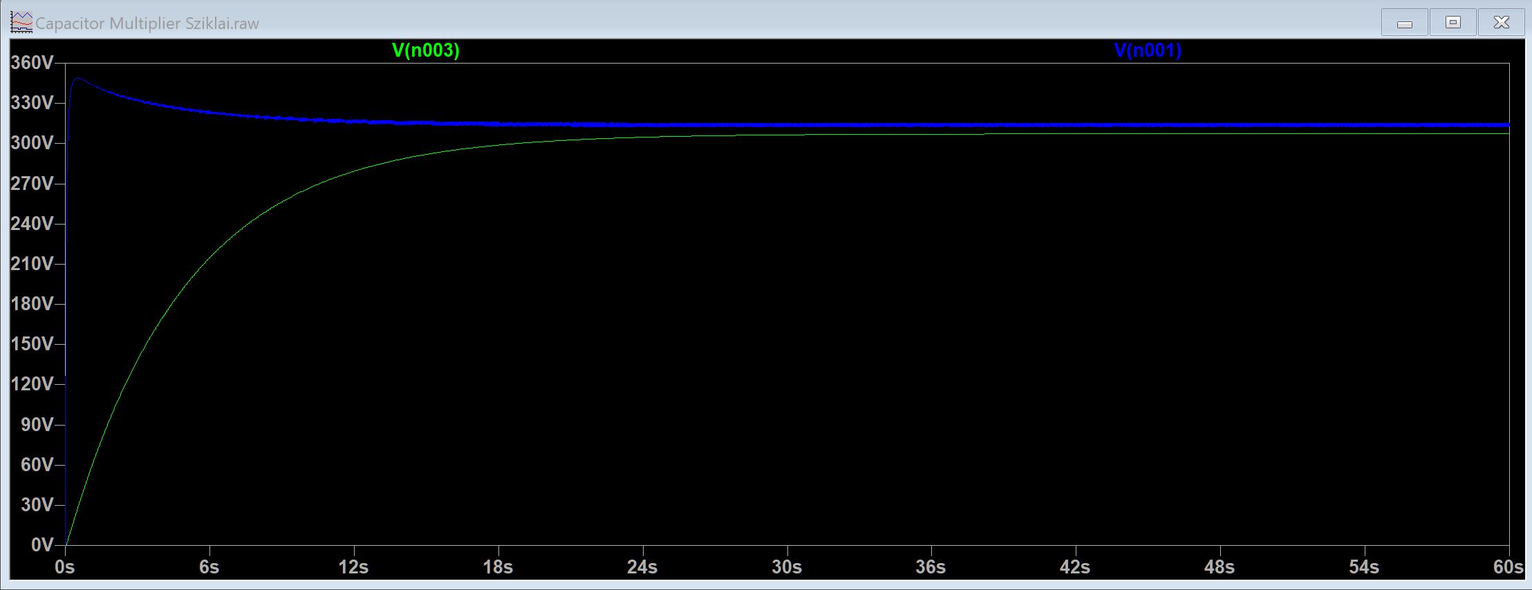

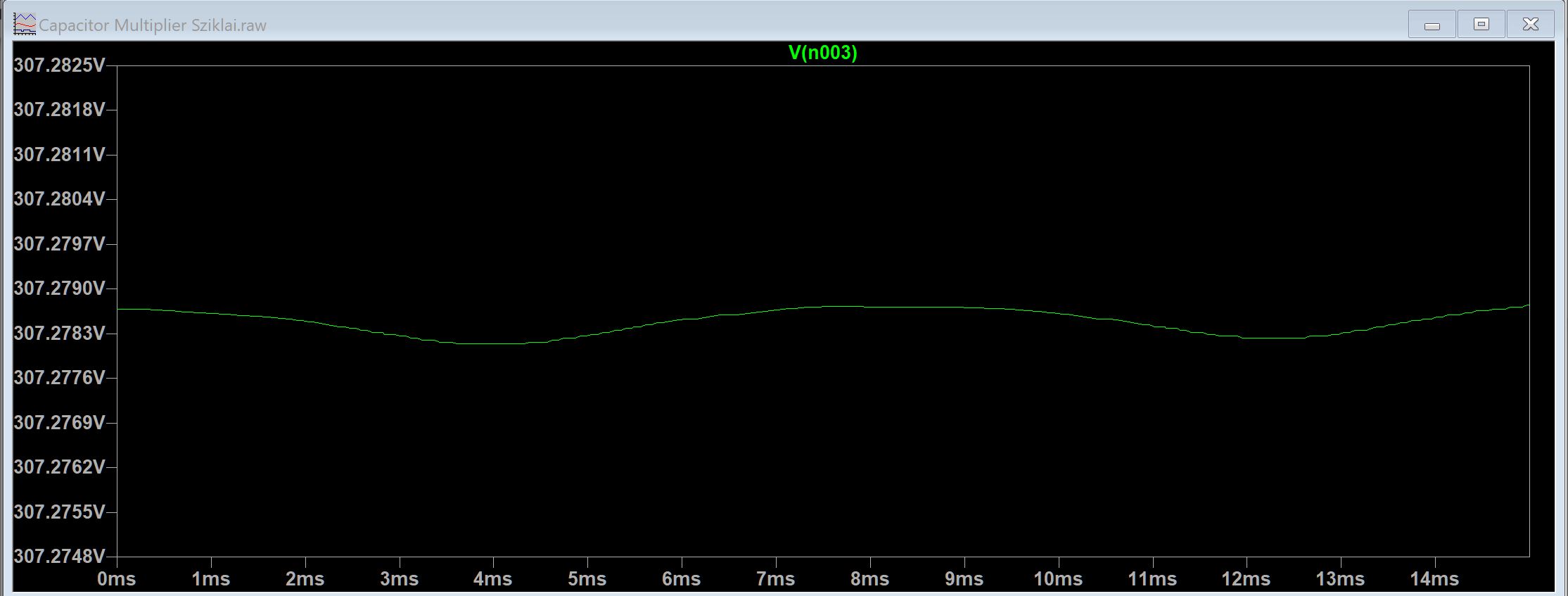

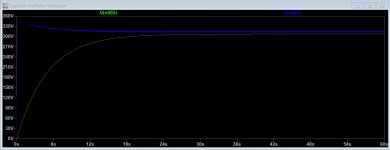

I put together a LTspice simulation based on Mark's suggestion. Mark, please make sure the schematic below is accurate.
Attached are the startup behavior and filtering result. Very nice!
