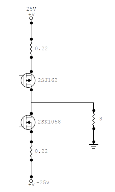

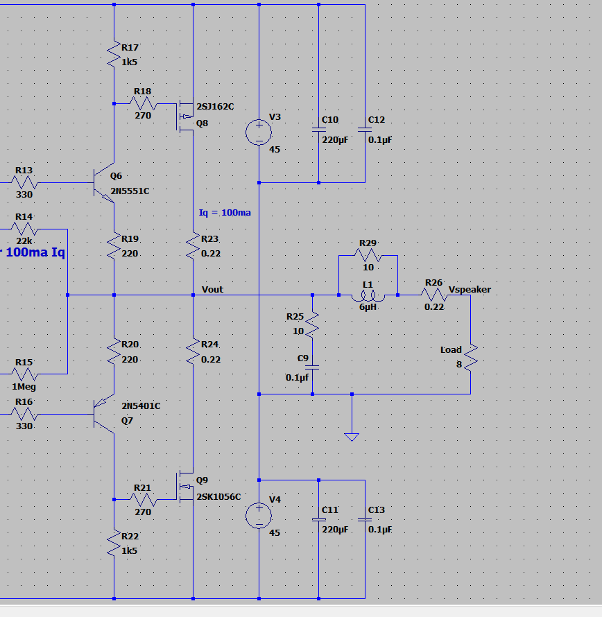

I am designing a push pull audio amplifier with 2SK1058 and 2SJ162 mosfets.
Normally they are used with a 0.22Ω source resistors.
What about to put these 0.22Ω resistors connected to the drain?
The lateral FET's which these types are do not normally need the source resistors for stability and control of quiescent current. Even with parallel pairs of FET's (only applies to laterals) and its questionable whether to use them. You can happily omit them for a single pair.
I also would not add them to the drain in that configuration, hazy thinking but they could compromise stability adding impedance at HF to the drain terminal and isolating the drain from the low impedance supply rail.

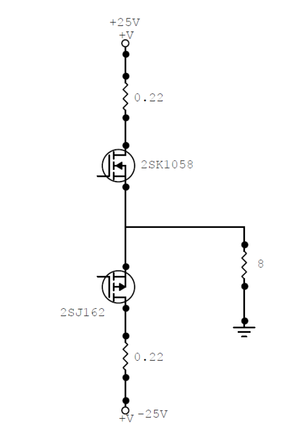

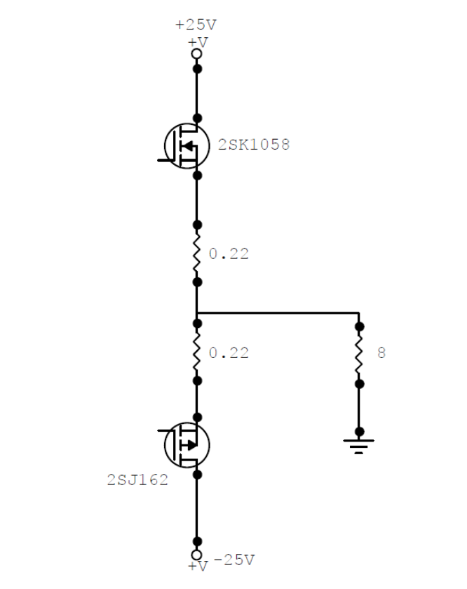

If I would use them, is it better to use them on the source also in the following configuration?
I would recommend to use source resistors if you put devices in parallel, it will help to equalize the currents in despite of the mismatching characteristics of the FET's
Well I used resistors in a CFP configuration in my own amp but I suspect if I were designing this again I would not use them. It can be argued they also reduce the overall transconductance of the FET which is already low enough and we don't want to make it worse.

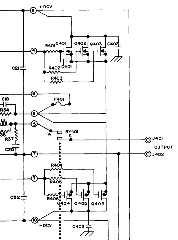

Noted thank, but these resistors are always to be put on the source, independently from the mosfet configuration (see the above pictures)?

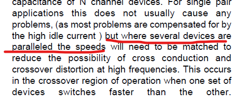

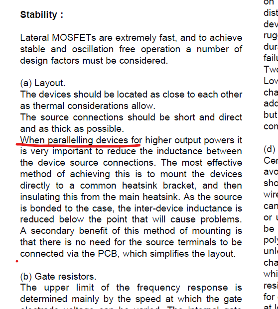

I'm going to have to say I disagree on that one at this point 🙂 Laterals can be paralled with ease and with no special precautions.
I found this from nearly 20 years ago but I'm sure I've seen similar info direct from manufacturer application notes. Post #31
All MOSFETs have an inflection in the gm vs temperature graph. Lateral MOSFETs have this at about 20mA per A of Idmax. So, Renesas/Hitachi 7A devices will exhibit about zero Tc at around 100-150mA. Semelab will be slightly higher because they have higher Idmax - the reason for this is simple, the MOSFETs themselves are constructed as arrays of cells in parallel - BUZ types, being 8A (IIRC) are a bit larger. It is a nice convenience that this current is very close to what could be considered optimum bias for these MOSFETs (*)

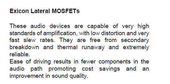

Latfets have negative (or at least non-positive) temperature coeeficient. They differ in this aspect from BJTs and vertical mosfets.
Thermal runaway doesn't happen to them (in 'normal' temperature ranges).
Hitachi 2SJ162 and 2SK1058 do not need any source or drain resistors but 220-330 series resistor on gates to prevent oscillation during amplifier turn on sequence.

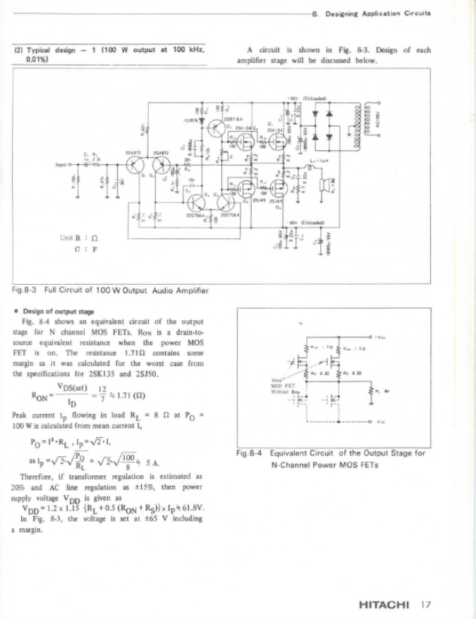

On the Hitachi Mosfet data sheet (Hitachi was one of the first, maybe the first, company to have introduced on the market this kind of components) they use a 0.2Ω resistor on the source of the MOS, so there must be a reason.
Anyway my first question was: if I would use these resistors on the CFP configuration (two couples of MOS) should I use them on the source or on the drain?
There may or may not have been a valid proven reason. This was new technology at the time and balancing resistors in parallel pairs of transistors had always been used. Maybe they just played it safe thing that to include them removes any doubt....
That there must be a valid reason for a design being the way it is doesn't always compute... think of all the vbe multipliers in commercial designs with the preset in the 'wrong place' such that failure of the wiper connection causes destruction of the output stage whereas if it were in the 'leg' of the resistive divider it would always fail safe to no current. They must have designed it that way for a valid reason... or maybe not.
The Hafler DH500 is a highly regarded lateral FET and that uses three pairs of outputs with no resistors.

No, they are not exactly the same and perfect. They just tend to be self-ballasting.
If someone had parallel “LatFets” that one hogged current and fried the first thing I’d suspect is FAKES. A standard switching hexfet stuck in a package and marked with a very desirable (usually unobtainium) part number.
Also with a poor enough match one could hog enough current to be a problem before the tempco became negative enough to cause negative thermal feedback. If you are going to parallel, buy them at the same time. They will be uniform “enough”.
