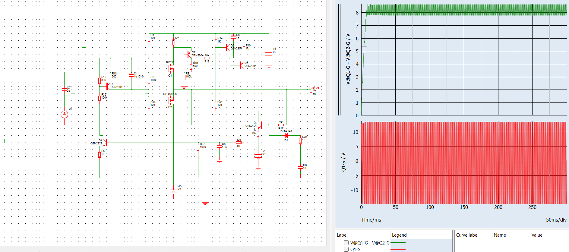

Is there any advantage to using mosfets over bipolar in a class AB low voltage (+/-40V) design?
Haarder to bias and significant headroom limitation.
I suppose there are the more desirable MOSFETs -- especially having a lower threshold.
I got one designed in simulation but headroom limitation in truly sad and took some real effort to get a good bias technique going well

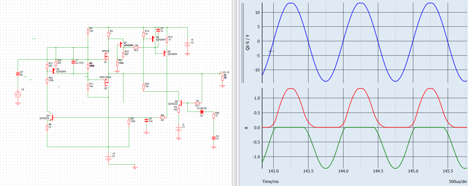

I am using current sensing on one side when it is off the adjust bias for mosfet and works.
If power stage is open loop then i suppose you get more tube-like clipping as a possible benefit for guitar

This board has a number of threads on auto-bias. On class AB, fast auto-bias works but slow auto-bias is nearly impossible (i.e. no-one has gotten satisfactory results as far as I can tell).

That waveform looks interesting for guitar. Could you explain roughly how the circuit works? I am not familiar with this kind of circuit, but it makes me curious.If power stage is open loop then i suppose you get more tube-like clipping as a possible benefit for guitar
My variant is "Audio power with a new loop", Electronics World February 1996, pages 140...143, https://worldradiohistory.com/UK/Wireless-World/90s/Electronics-World-1996-02-S-OCR.pdf
I will make a report --That waveform looks interesting for guitar. Could you explain roughly how the circuit works? I am not familiar with this kind of circuit, but it makes me curious.

Making the feedback loop fast enough for audio frequencies will result in the output transistors running in class A.This one is fast -- just a question of how much bias ripple - a matter of sizing C1

Does it also clip 'tube like' ?My variant is "Audio power with a new loop", Electronics World February 1996, pages 140...143, https://worldradiohistory.com/UK/Wireless-World/90s/Electronics-World-1996-02-S-OCR.pdf
And what if you would run it open loop?It clips very hard, like any amplifier with lots of feedback does.

I doubt if that is even possible with my amplifier. It was never meant to be a guitar amplifier.
I think we are nit-picking. The context is the OP's circuit, a source follower.Indeed. If you had written 'For a class-AB complementary emitter or source follower topology driven from a low open-loop impedance, BJTs are better from the point of view of distortion', I would have agreed, but the way you phased it in post #4, it could be mistaken for a topology-independent conclusion - if someone would read it without looking at the link, that is.
Okay, I see why: the sensing is shut off during positive halves. That assumes the load is not reactive.It runs AB -- has very graceful overlap near zero crossing.
