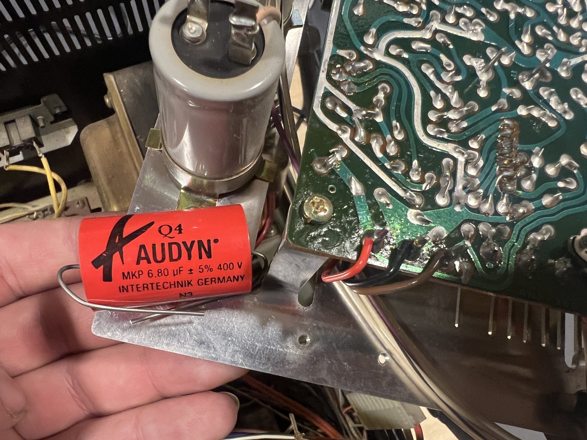

Very early on in my electronics heyday, I was replacing some capacitors in an old RTR I had and I replaced the electrolytic motor capacitors with other electrolytic, of same value. After I was done rebuilding it I ran it and a few seconds later I heard a big pop. That is when I learned that you can’t just put regular old electrolytic capacitors in place of ones rated for motor use. is the case the same for polypropylene? I see that many people now use poly propylene for the capacitors, do they need to be rated for that or pretty much any poly propylene work in that position?
I have a 2.5 µF at 250 V AC and a 6.8 µF at 125 V AC. I know that capacitor is ready for 400 V DC are also rated for 250 V AC, so could I just swap something like this in? Or is it absolutely necessary I get one rated for motor use.

The reason for using a motor type film is the current handling capability as well as the overall power dispersion capabilities. A small electrolytic or film won't last long in such applications.

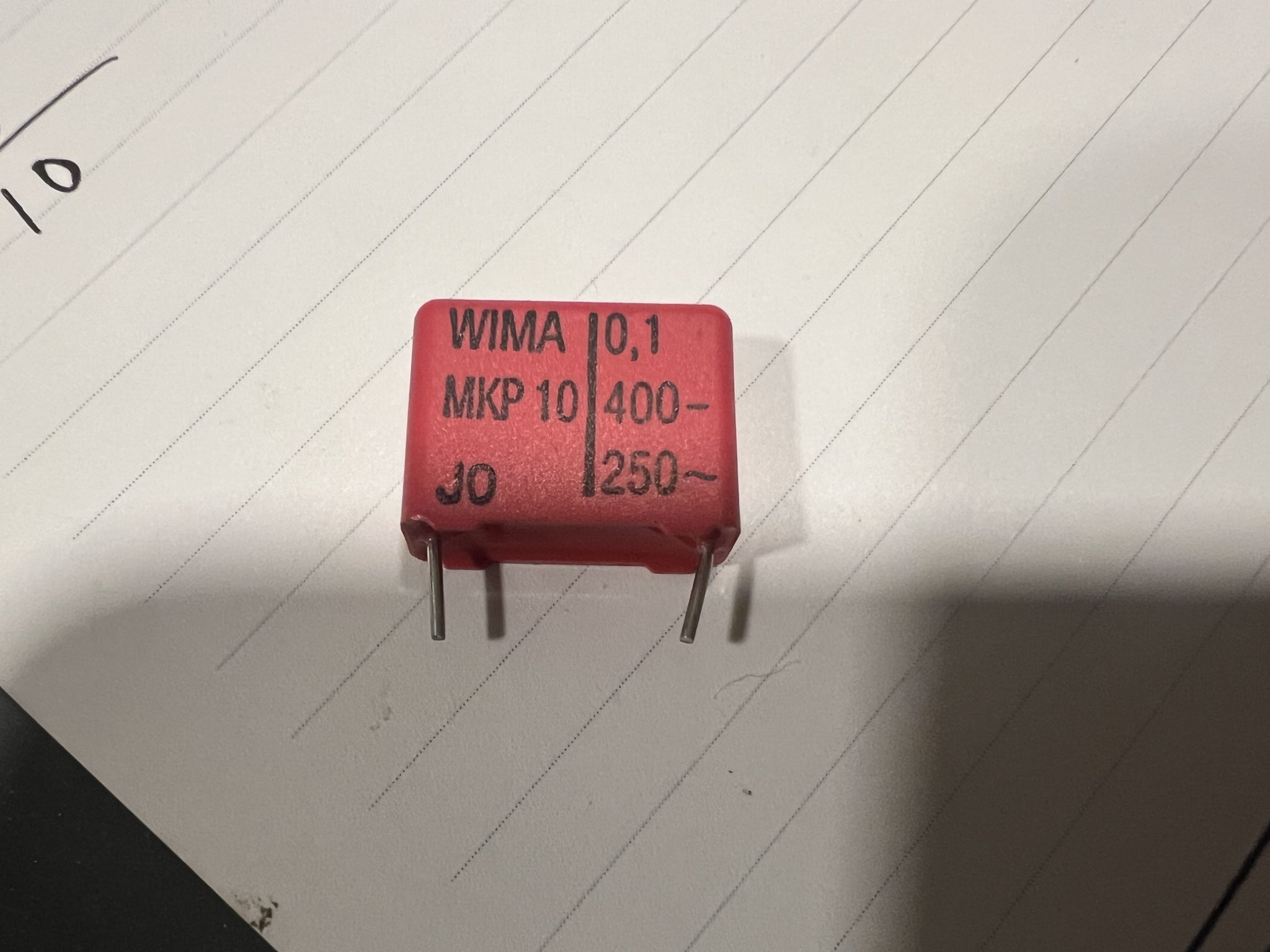

That was in reference to this, this is one of many films I have
where it clearly states it is rated at 400 Vdc and 250 Vac. Spec sheet says the same. What would make these capable of only 400 dc vs needing the 1500 dc? Are they just massively underrating the dc limit? The 400 rating on this cap and the polypropylene I took a pic of earlier would both be assumed to handle the same 400v.

This particular cap carries both ratings, Wima factory decision, and applies to this ..model only, unless also specified in others.where it clearly states it is rated at 400 Vdc and 250 Vac. Spec sheet says the same. What would make these capable of only 400 dc vs needing the 1500 dc?
And is guaranteed 'user' voltage, actual test conditions may be much higher (and they are), only that datasheet does not include them.
But you can not infer that "all" 400VDC caps are 250VAC rated, by any means, which is my point.

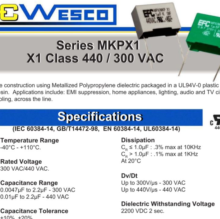

Can't find now the datasheet I checked earlier but this one from a very similar, also high quality product says:
(One detail, this is the 300VAC rated cap, feel free to derate that test voltage by 250/300 or a 0.83 factor.)
Notice scary 2200VDC dielectric test voltage, way more than 1000-1500VDC I had seen in other datasheets, specifically discussing "RU/UR" rating.
Point being: nominal 125-250VAC mains lines can actually get 1000-1500V peaks (what I mentioned) often
In electrical storms lightning hits transmission lines regularly.
Companies add voltage limiters, maybe spark gaps, maybe huge varistors, gas discharge tubes, etc.. but even so peaks I mentioned appear at home lines
.So a "VAC" specified cap expects them and is properly rated and tested (meaning a lot of "headroom").
