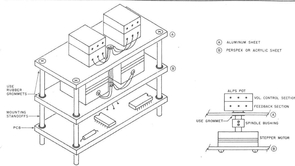

That's exactly what I want to do, but I'm looking for a potentiometer with a motor and a "high" rotation speed. As the digital consoles have motorized faders (fast recall of their positions), I need pots with fast rotation recal. It's an untraditional solution, I did not see it on any device. If I select some channel (for example), I need to get the actual position for these knobs for selected channel (instead of lighting some LEDs around).
If you only need a single channel then a dual gang pot backed onto a stepper motor will work. One of the wipers can be used for sensing the current position of the pot.
It is much the same as the system in low cost RC servos, but with the stepper motor the force applied when the motor isn't driven is much more manageable.
If you wanted real fancy then a much more advanced servo like the ones made by Dynamixel can be programmed to act in all sorts of ways.
EDIT- if the pot is only giving out a static DC value for your use anyway, then don't you have the position of the pot already? In that case a single channel pot would already be fine. But I suppose there are more dual gangs out there with a hex already exposed at the back end for you to couple to.

Yeah, that's it. I need only the static DC value, only the position of the pot. I got the idea of rotation with potentiometer using bottom hexagon, but I dont know, how the hexagon is robust. A lot of potentiometers (alpha) are relatively stiff in terms of rotation, the force required for rotation is too high, I guess. Thats pretty cool for manual and correct control, but not for fast change of position. I'm worried about the lifetime of this solution, but if any potentiometer can rotate really easy, it would probably be the most ideal solution for me. Any tips for small stepper motors?

I think I have done something that could help you. I only have a pdf scan (it's a VERY old article ;-) so I need an email address to send it, it's to big to add here.
Send me your email via PM.
Jan
Don't bother - I posted it on my website: A motorized remote vol/bal controller | Linear Audio NL

Yeah, logic can be solved by uPC, position from AD converter (8 or 10 bits are sufficient), the system si elegant. I will try to find a suitable potentiometer 🙂 .
