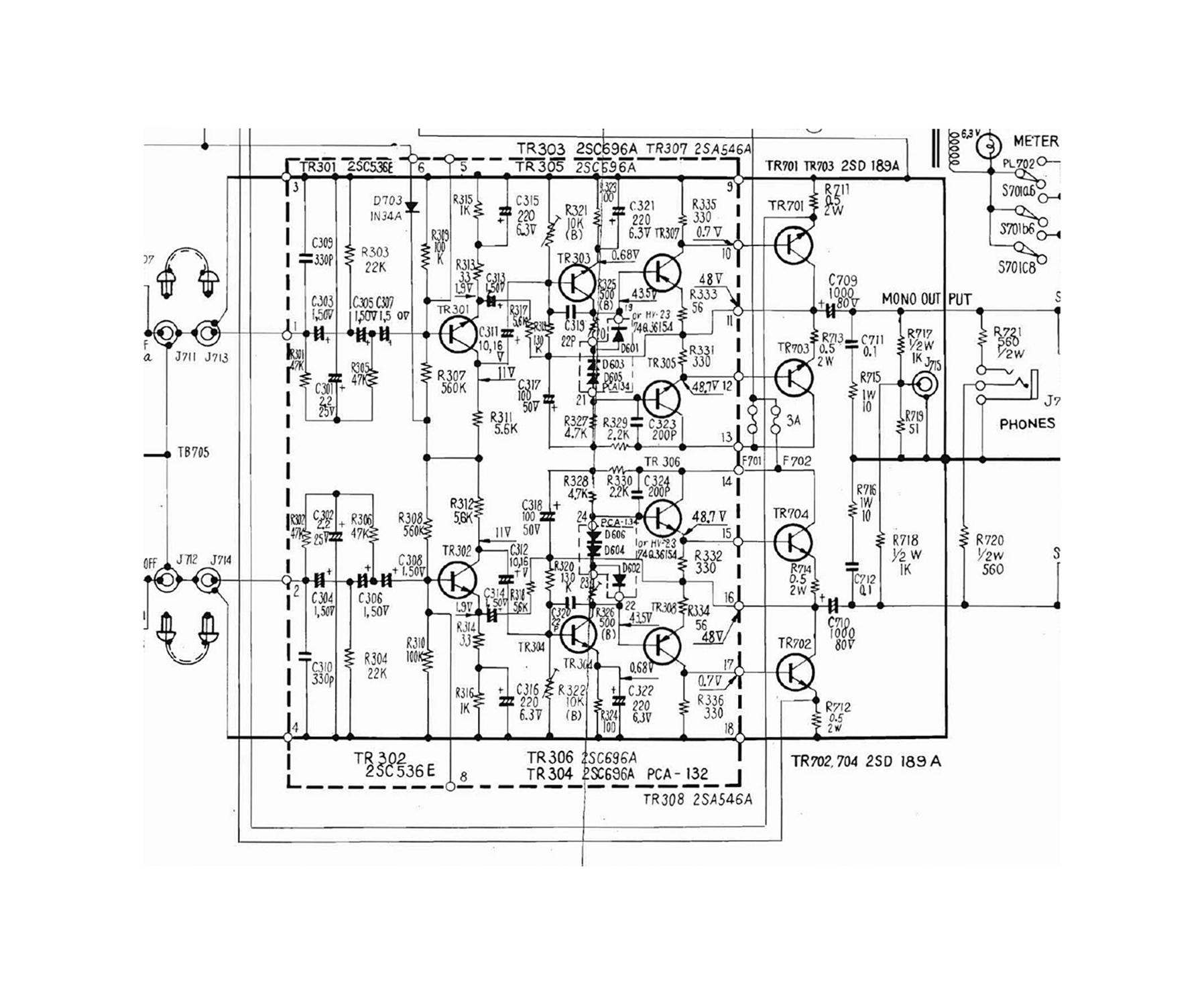

Thanks. I ordered a set of 4 TO-3 transistors to replace a mis-matched set on a Dokorder 800X receiver. Great sounding receiver, but having 2 different pairs means that one channel is louder than the other, in this case the right channel. Not sure why it was done that way, but I suspect that the owner or repairman just wanted a quick fix and the particular transistors were available.
Mismatched output transistors in nearly all amplifiers will
have no effect on the output volume. Sorry to say but
it is unlikely you are fixing the problem.
rgds, sreten.

Thanks everyone. I just might mount the 4 output transistors onto a pair of extruded aluminum heatsinks as the Dokorder has them mounted directly onto the back panel with a shield over them. I have a Sansui 3000A that does the same thing, and it conducts heat everywhere on the back panel. Not a good design but typical of the 60s.
Here's the power amp part of the schematic. All 4 output transformers are NPN. And when's the last time you saw a mono speaker out? I could run it to an EV corner speaker if I had one.
The best solution is no mica washers and put the output transistors on two heat sinks to separate collector voltages. But use thermal grease to fill in gaps. I tend to use wooden chassis for my amps so can get away with two isolated heat sinks.
I did this on old Maplin 225WRMS amp and it barely ever got warm even when thrashed.
Nigel, thanks. I would have never thought about isolating the collector voltages. It makes sense to me. I found a little raised TO3 heatsink on eBay that should do nicely:
